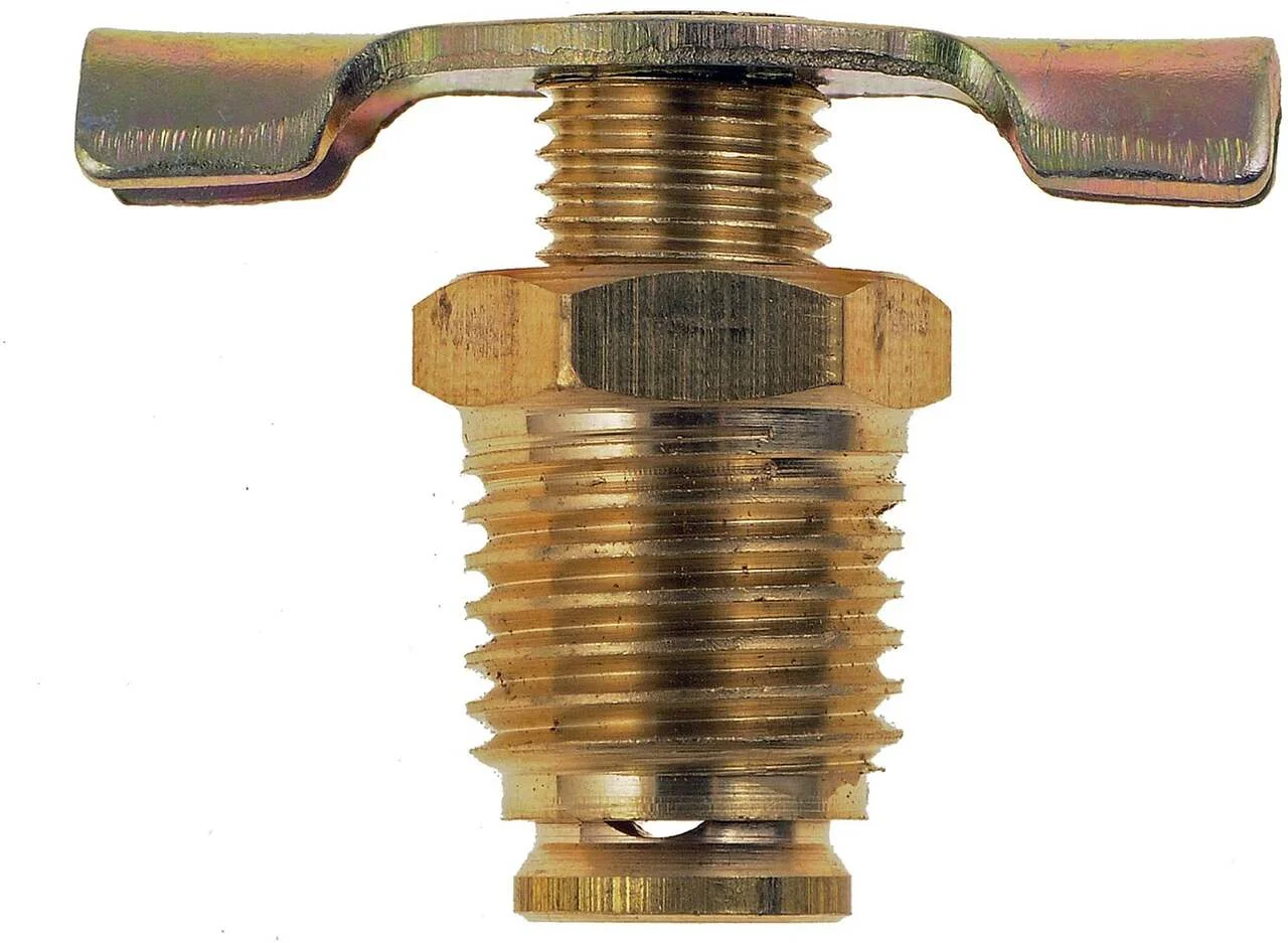

My aluminum radiator has been working well for a couple of years but the plastic drain cock is a known issue. Mine did the continuous turn trick after I had to drain some coolant to mod my fan clutch. I finally settled on a brass unit. To minimize galvanic corrosion I used some Teflon tape on the threads and will keep an eye on it.

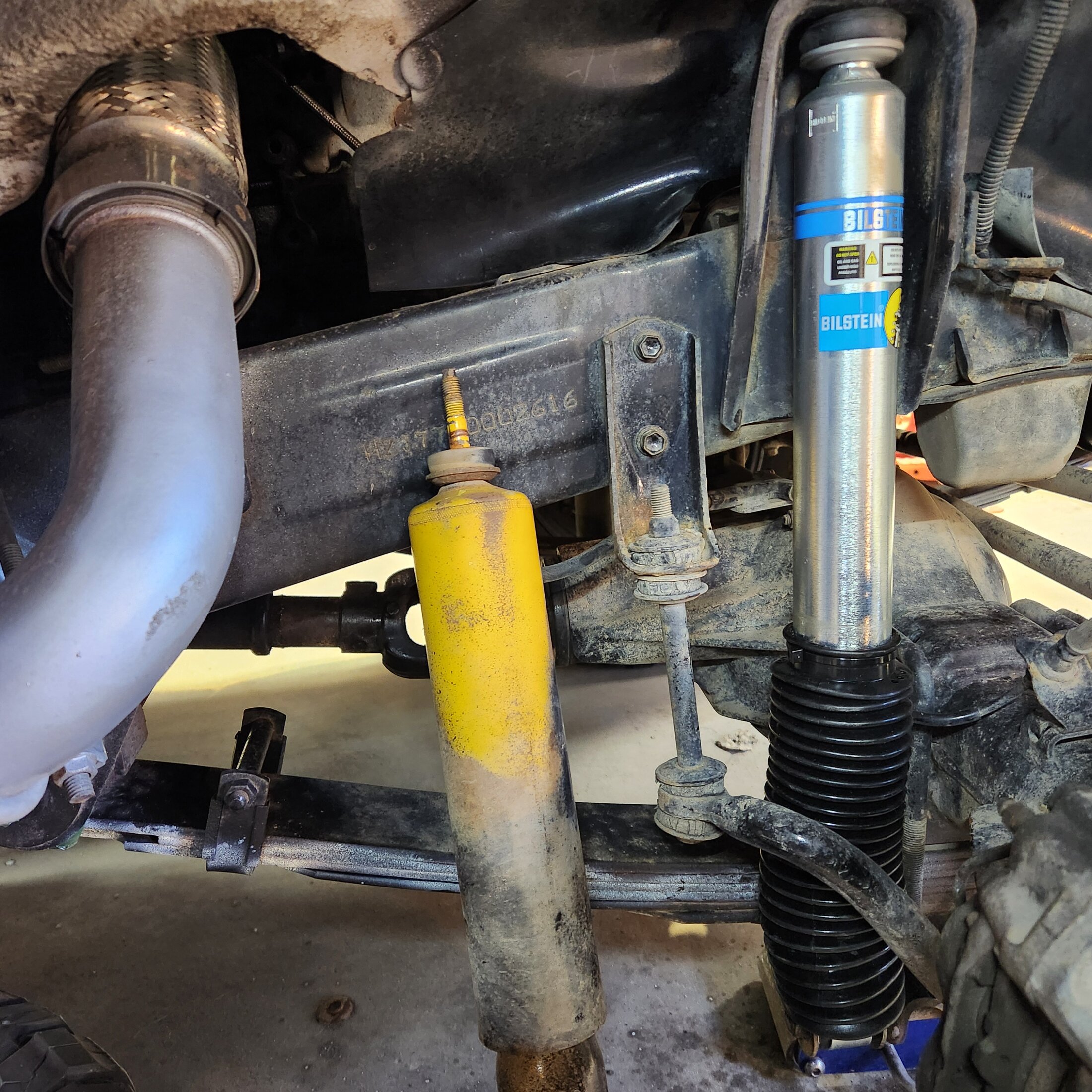

Finally got the chance to replace my front shocks. They were OME but getting old and worn out. This time around I went for Bilstein 5100's.
I only have one installed so far (had to go out of town for work for a few days) but should make a noticeable difference to ride quality on those washboard roads...

You have lift springs or stock height? The Energy Suspension links are a nice, quick and cheap swap while you're up in there. These were the right length for my lift.
Energy Suspension 9.8121G Suspension Stabilizer Bar Link – Energy Suspension - https://teamenergysuspension.com/product/energy-suspension-9-8121g-ford-mercury-suspension-stabilizer-bar-link/
Nothing like a pending trip to motivate.
Those were the ones I used as well 👍👍
Excellent feedback guys. Thank you!
2 inch OME lift springs on mine. I won't have time to do the links before I go but will put them on the list for my return.

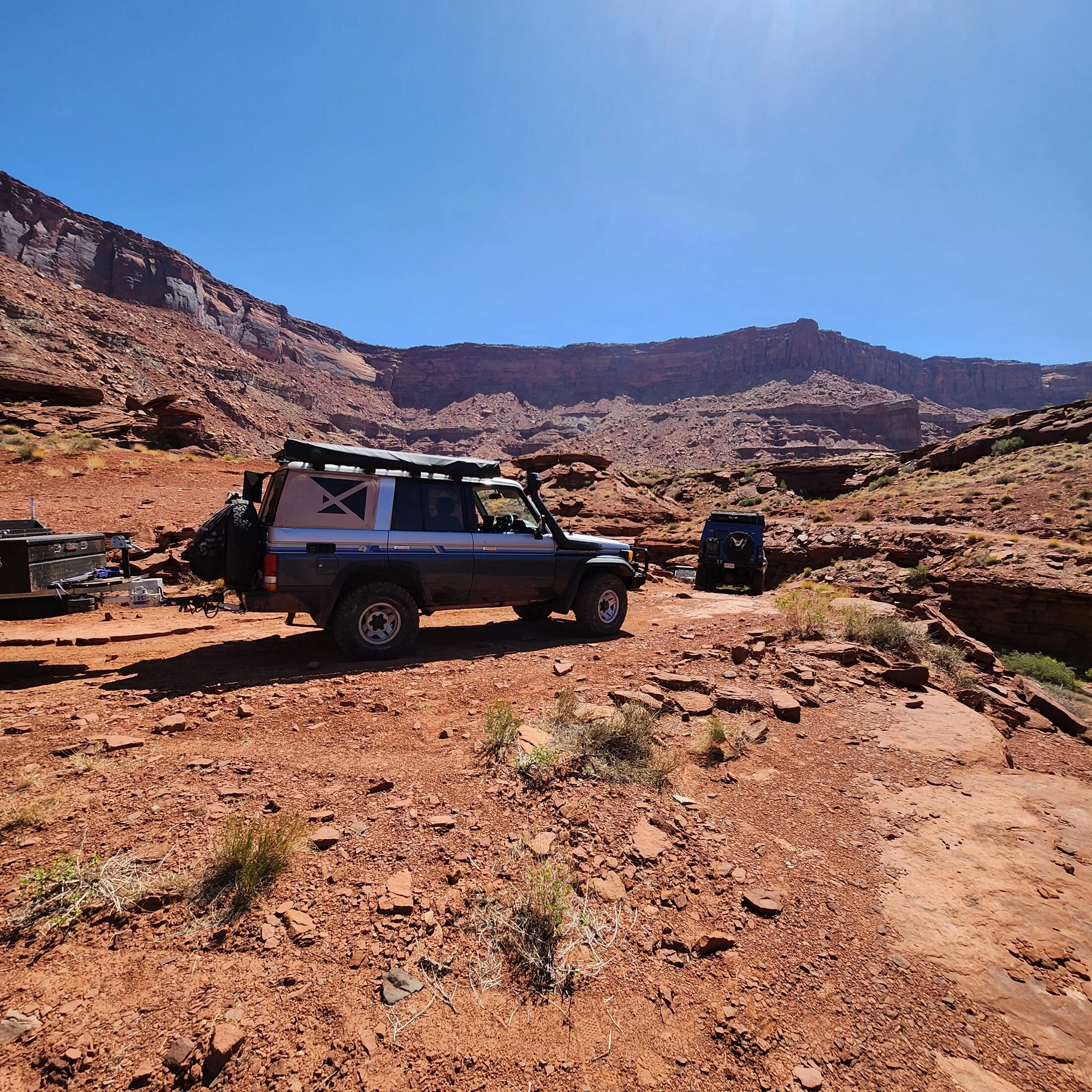

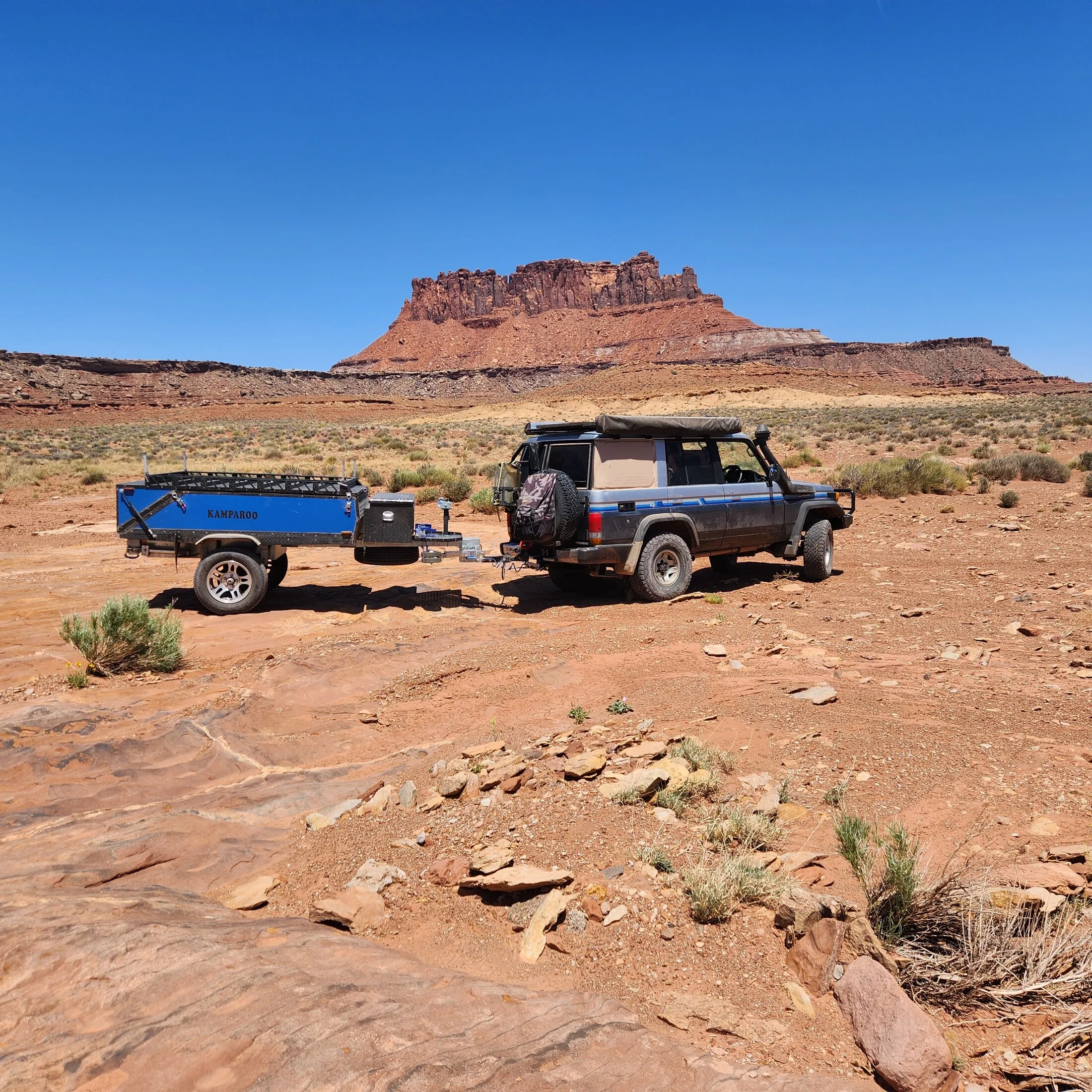

4310kms total, pulling a trailer from Calgary, Alberta across the continental divide. down to southern Utah, into canyonlands, Lockhart basin, all while pulling a trailer, and back.

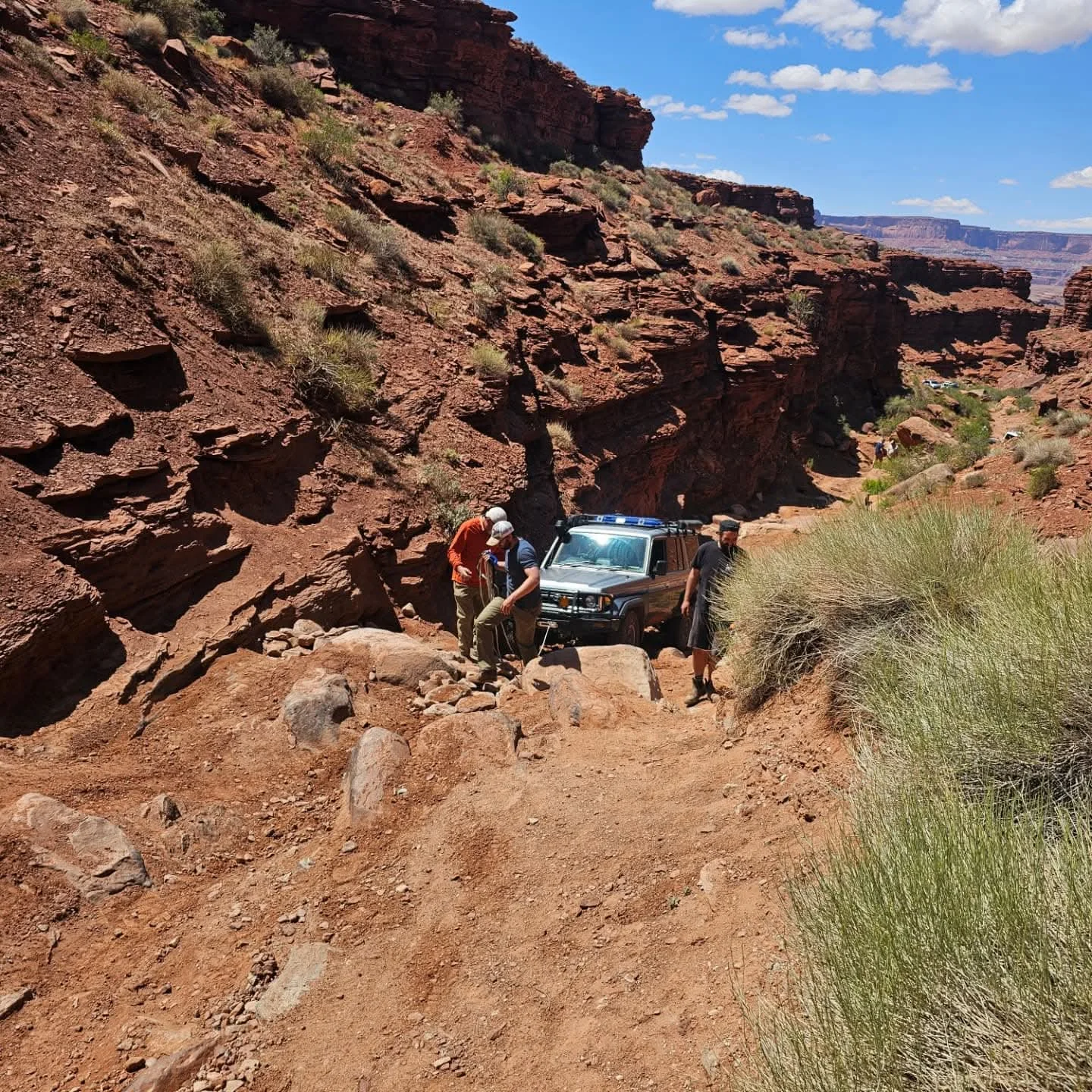

Everything worked flawlessly except... Once we got down into the depths of the basin I realized 4wd was not working so the rest of a very hard day was spent in 2wd, winching myself and friends, getting the trailer over obstacles, etc. Lockhart was in bad shape and we did a lot of rock stacking. During the course of the day my rear end hopped and an outcropping contacted a rear quarter window. So some duct tape saved the rest and kept it in place...
I actually broke the shear pin on the PTO during a hard pull. Had spares and fixed on trail and then used a snatch block for double line pulls to reduce the load. PTO was amazing.
Once I got back to camp I started with hubs, realized one wasn't locking so did it manually for the next days trails...
Kamparoo pulled flawlessly. Truck worked without a hiccup. Torque from the 1hz in 1st/4low really is like an easy button...

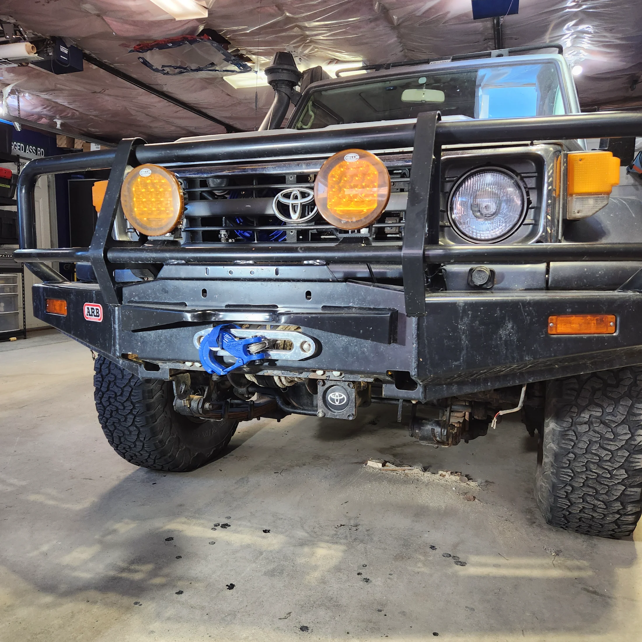

I see your rocking the PTO winch with the ARB bar. Any more pics of the mods you did?
Lol. You miss nothing sir. I was at the Oregon Overland expo a few years ago ('22) and sat in on your recovery presentation for a brush up. You were hoping to get down to my campsite to see it that night but I think Lexus was keeping you hopping!

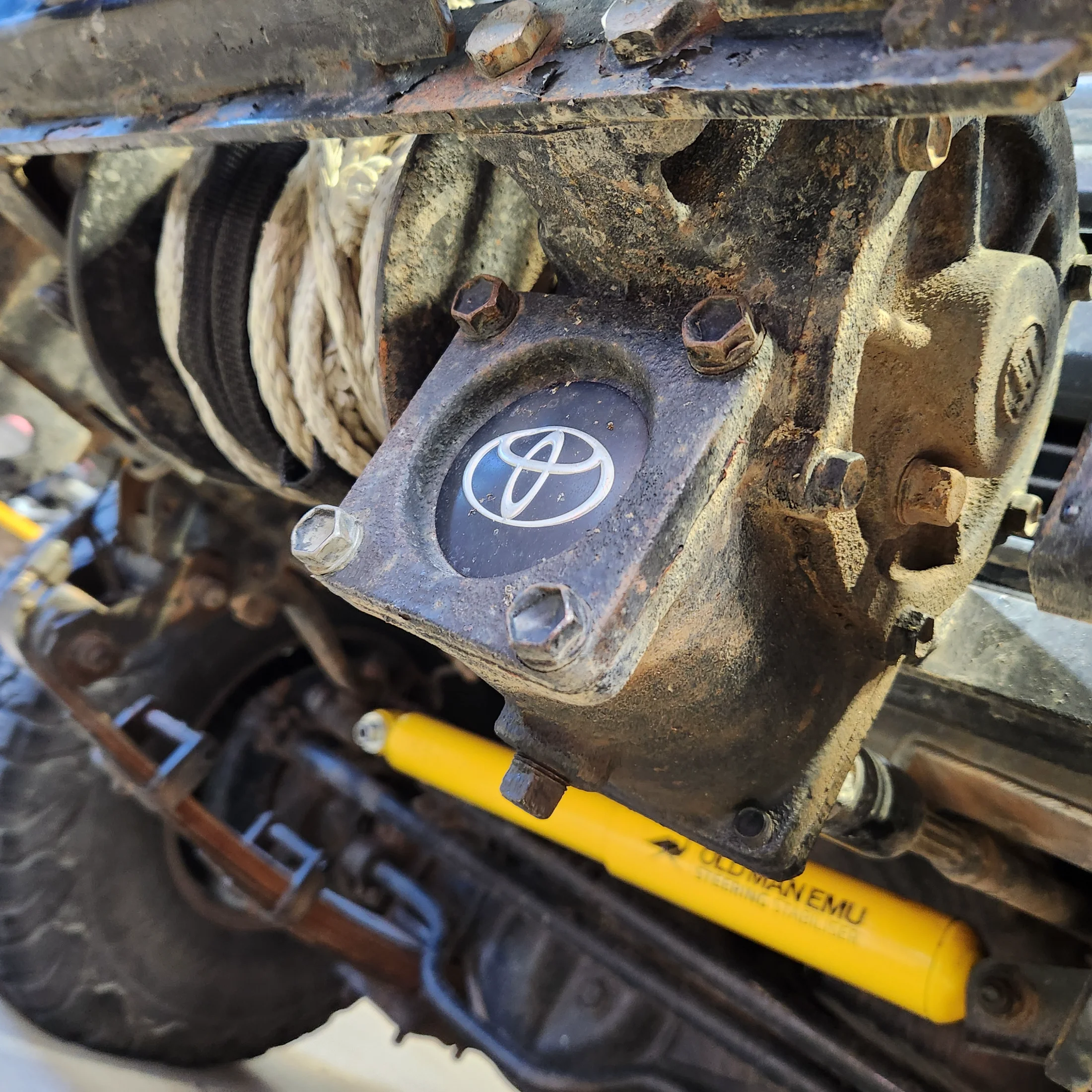

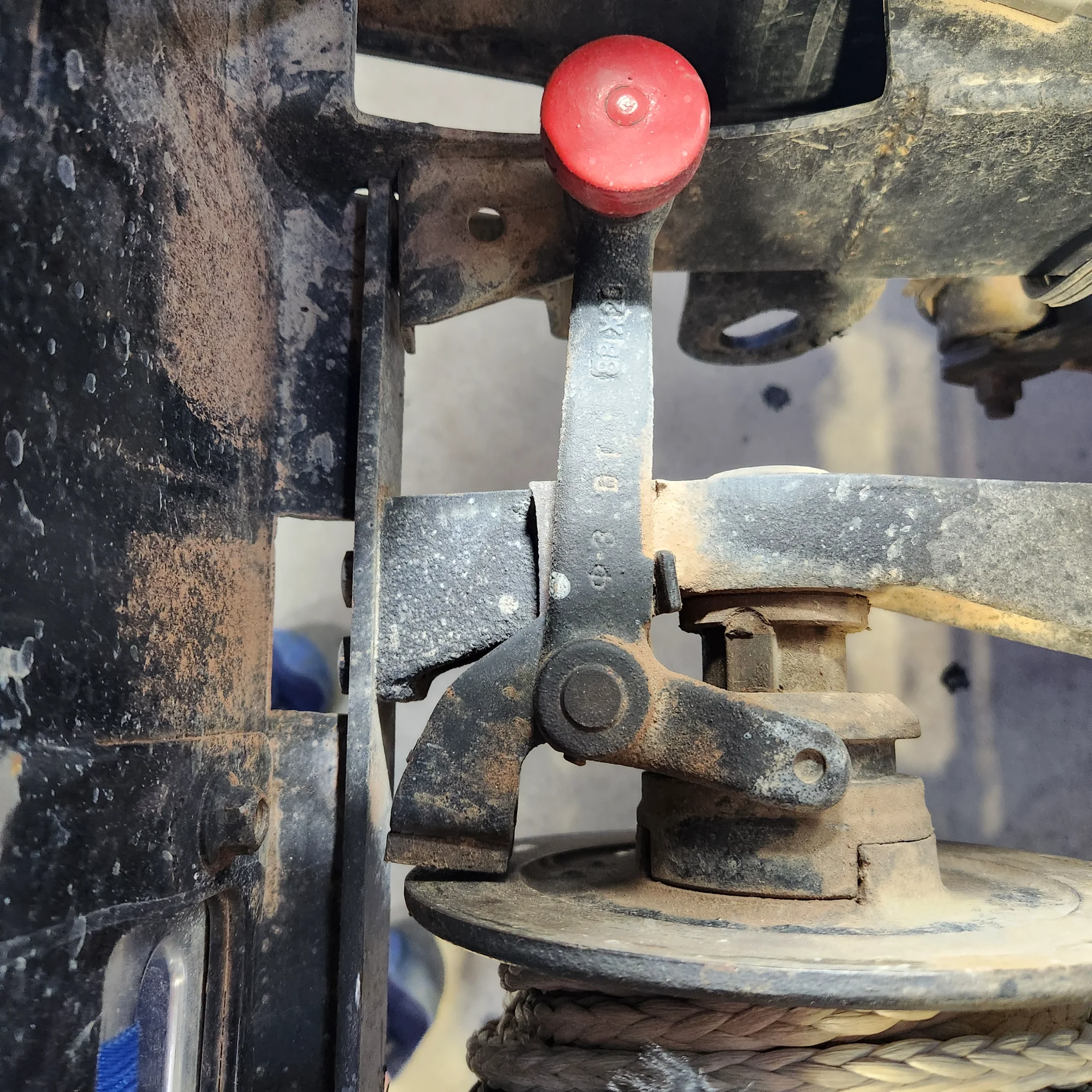

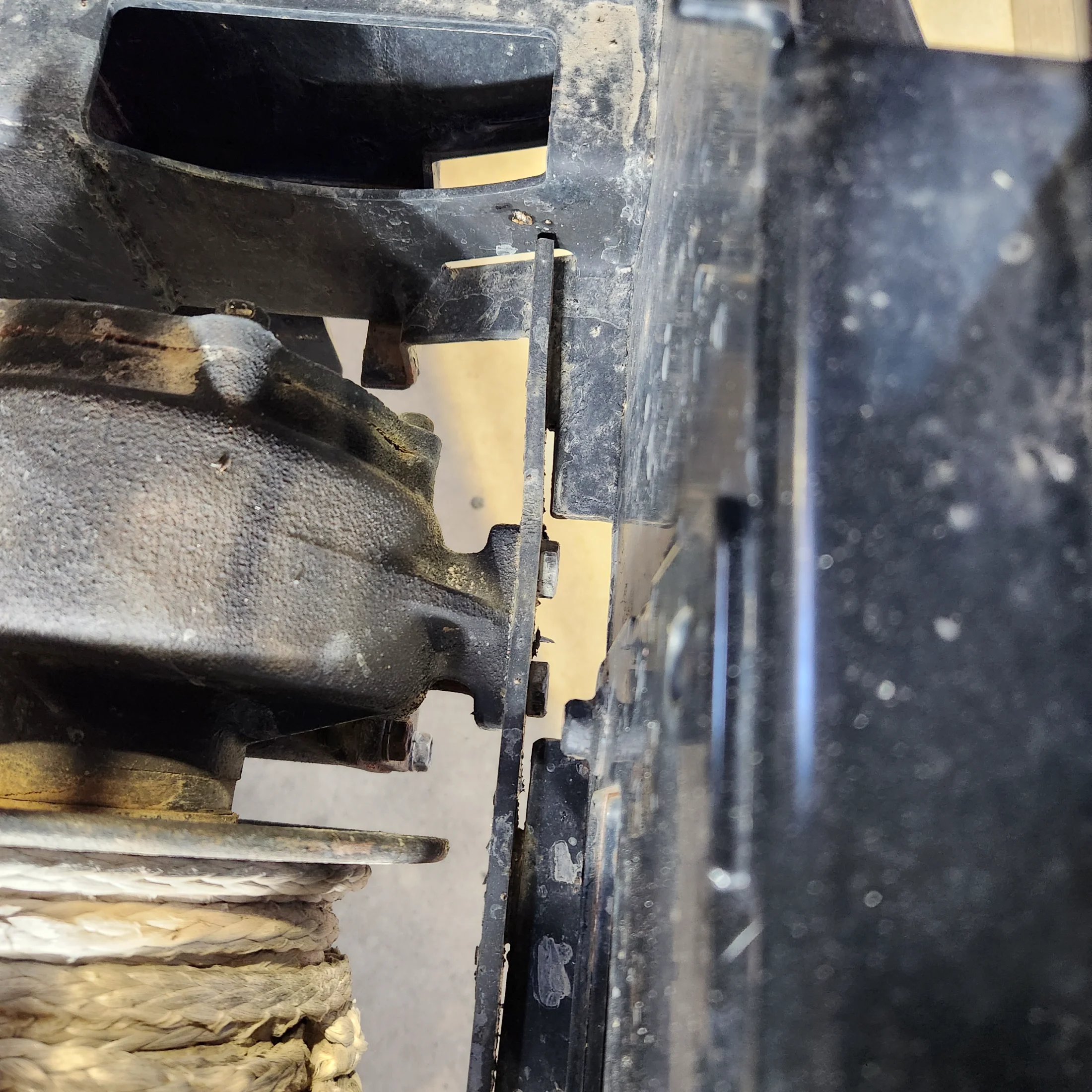

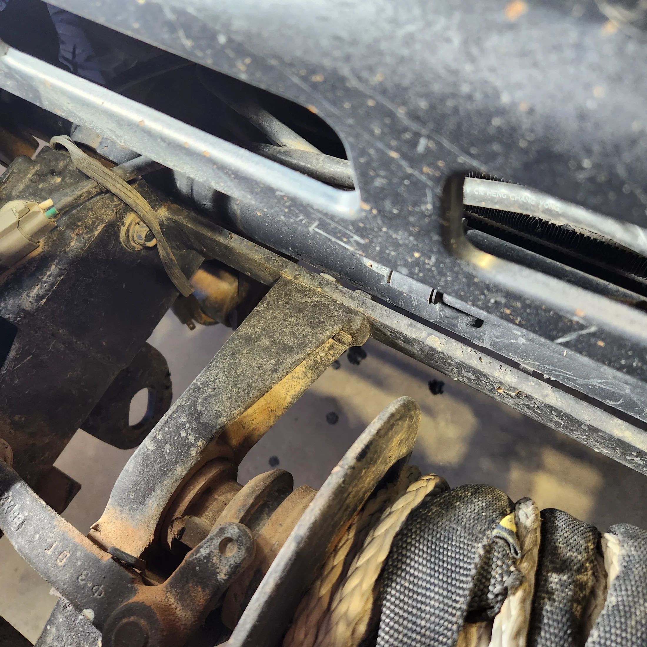

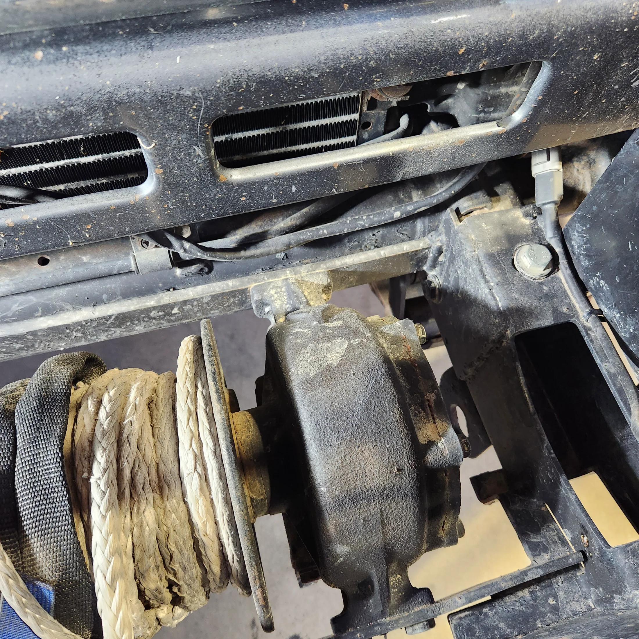

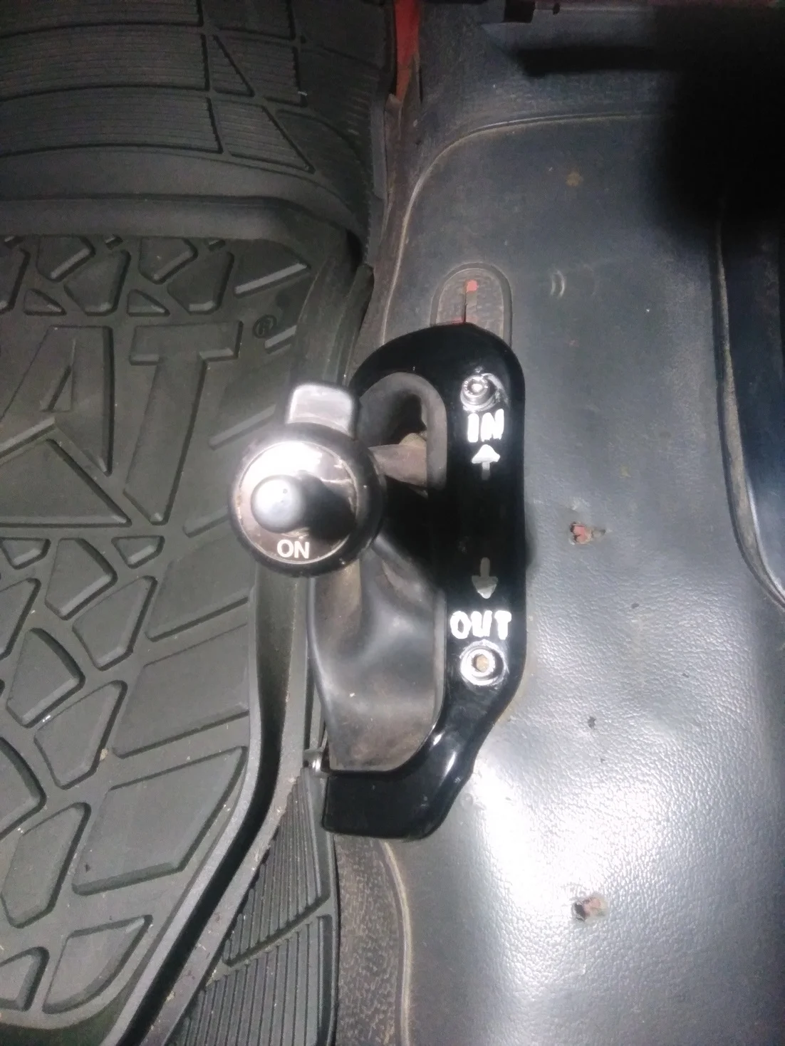

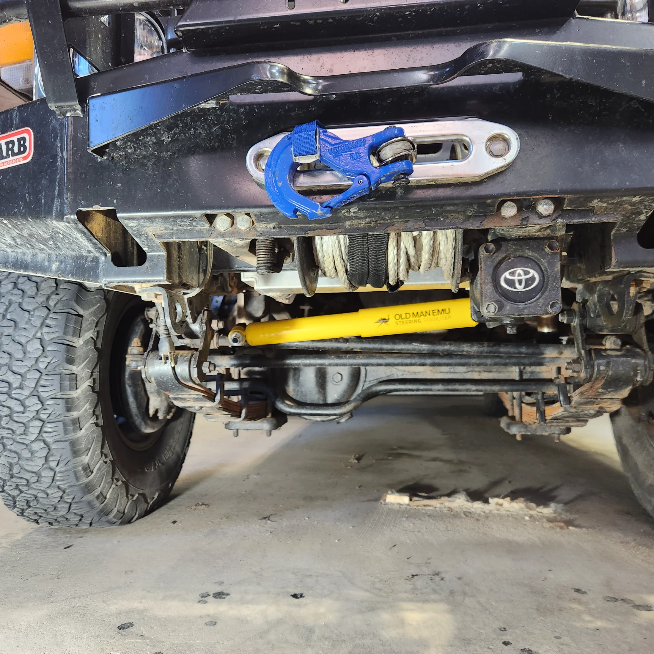

Back a few dozen pages I think there are more details. I'll find you a link. But essentially we cut the bar out of the center. Then cut some out of the plate that wraps down from the front. Then welded in two pieces on their edge, vertically. The PTO then BOLTS on to those strips front and back so it's still removeable if necessary. PTO lever simply needed the little tab welded in the right place.
We still plan to fill in the open front part eventually. But it's been there for 3 years now and we still haven't gotten back to it yet.
Close up on front bolts (rhs)
Right side contd
Back left:
Control lever:
Excuse the Utah dirt. We were down in your neck of the woods in May and did a bunch in Canyonlands. As well as Lockhart basin. I had my little trailer behind me and this winch pulled me (and some buddies) over some large rocks. After a quick primer from me with how it differed from the electrics they were used to... Amazing pulling power and 5 forward speeds!
Right side contd
Back left:
Control lever:

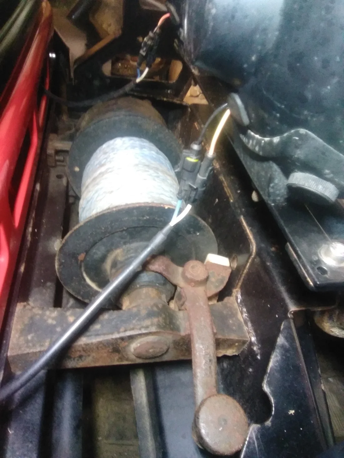

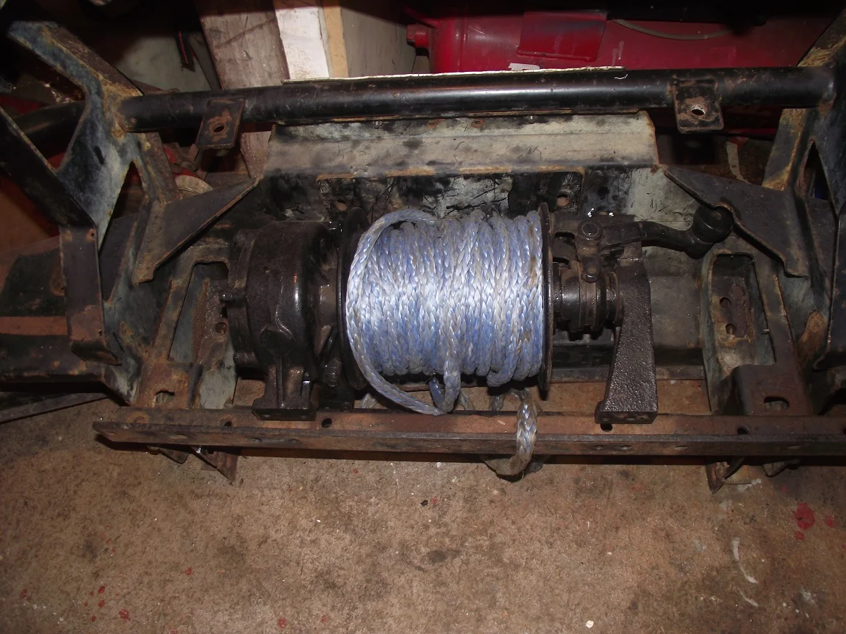

I also noticed the PTO winch in that ARB bar back a few posts and know how hard they are to fit into ARB bars, mine is done quite different, my truck has a 50mm body lift and the ARB bar is also lifted 50mm. I got my winch mounted right up inside the bar without cutting anything and run it in reverse (spooling off the bottom of the drum) with a bi-directional PTO, I can spool in and out in gears 1 to 5. With everything lifted my PTO shaft sits above the tube crossmember at the front, I remounted the PTO shaft pillow blocks to suit, I had to jiggle everything around the exhaust for the engine swap anyway, I had the bar sandblasted and re-powdercoated after the winch was fitted but that was 15 years ago and it's all looking pretty old again now, sorry if I've cluttered your thread with unnecessary photos and info
