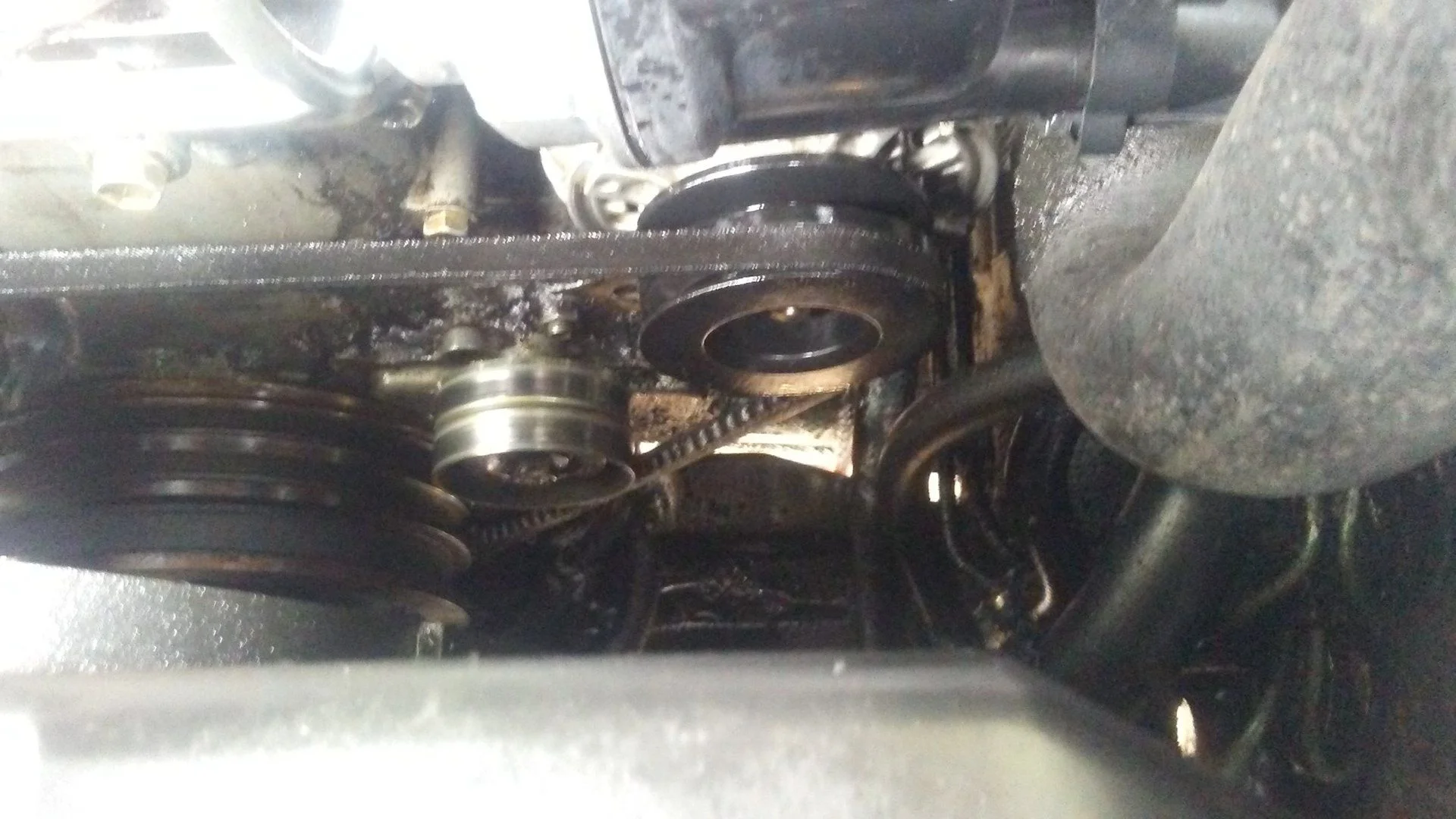

A front main seal can cover the entire engine bay pretty quickly with the pulley and fan throwing it everywhere

With wind pressure and fan activity I would agree with an earlier post that it was something on the front end of the engine spraying into the fan. That would scatter, cover and smother your engine bay pretty good.

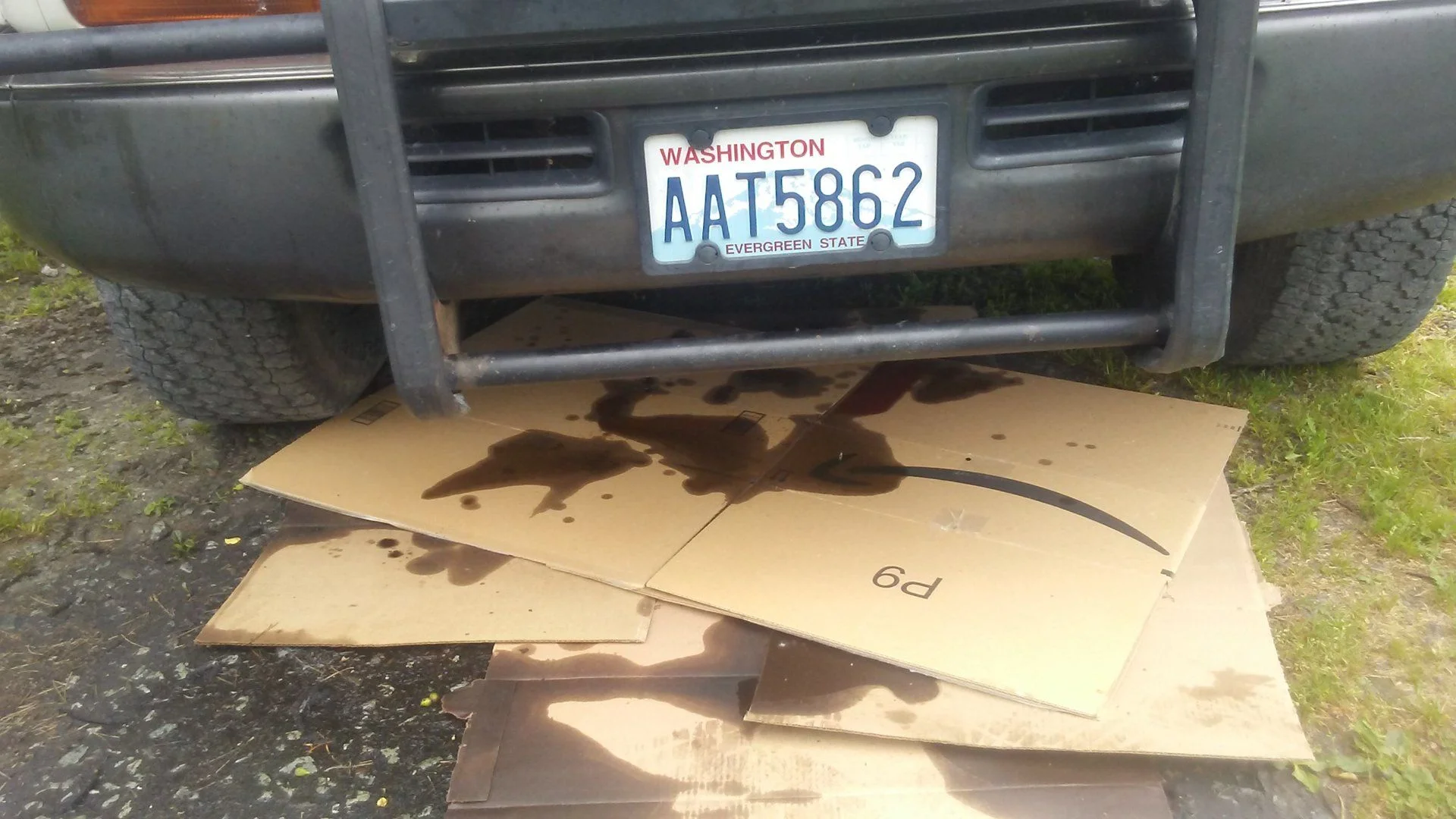

He came out and took another quick look at it and pour the oil in the engine. It immediately started dripping from the front of the engine which was never turned on. He was on his way to pick up another car to bring into the shop and he told me he would call me back to discuss repair options and pricing but I haven't heard from him yet. He mentioned something about possibly having to take off the timing cover or something like that? I thought I was going to talk to him again right away so I didn't ask very good questions. What would cause the oil to run out when the engines not even turned on?

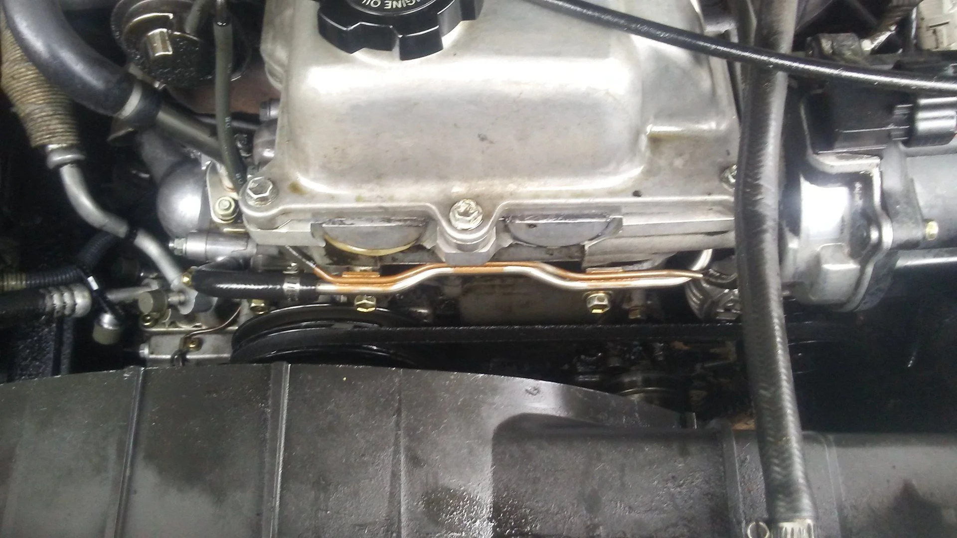

Check these:

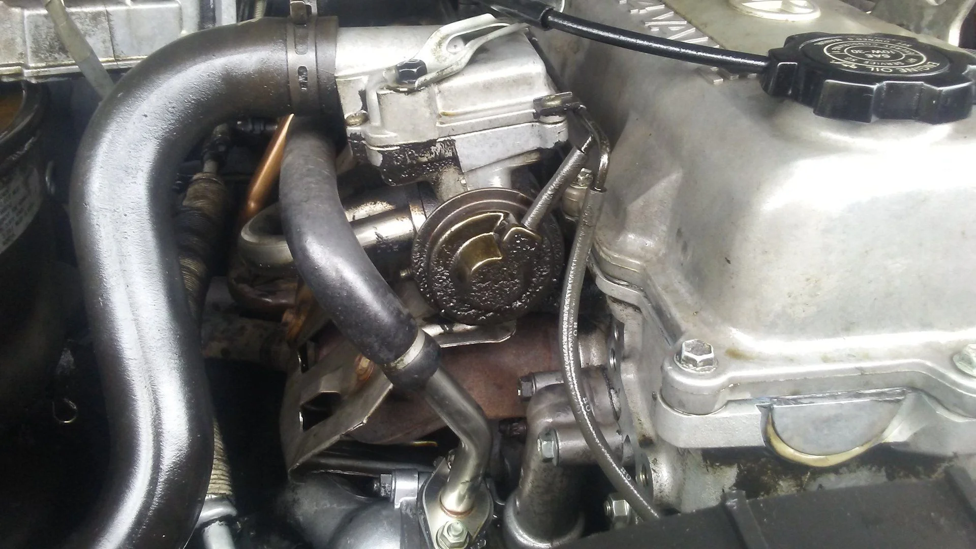

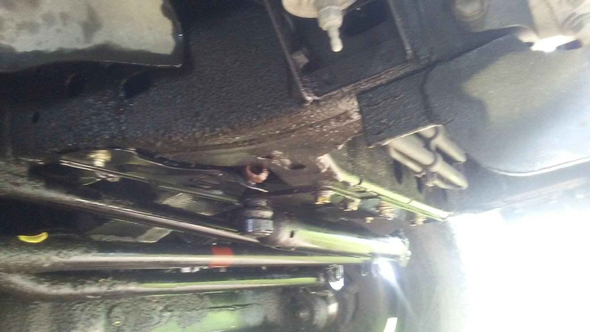

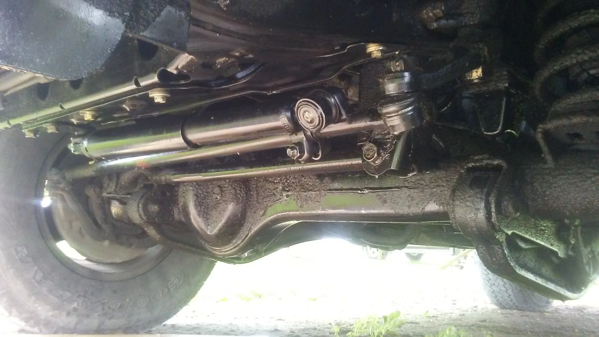

Take pics of the front and the sides and the bottom, let us tell you what needs fixed, then find a different mechanic.
the oily puddle on the back right is power steering fluid leaking from the pump. The other kind of horizontal line in front of it is what leaked when the mechanic poured oil in it this morning.
The engine had been degreased after they finished the valve cover seal. It was driven about six miles after that.

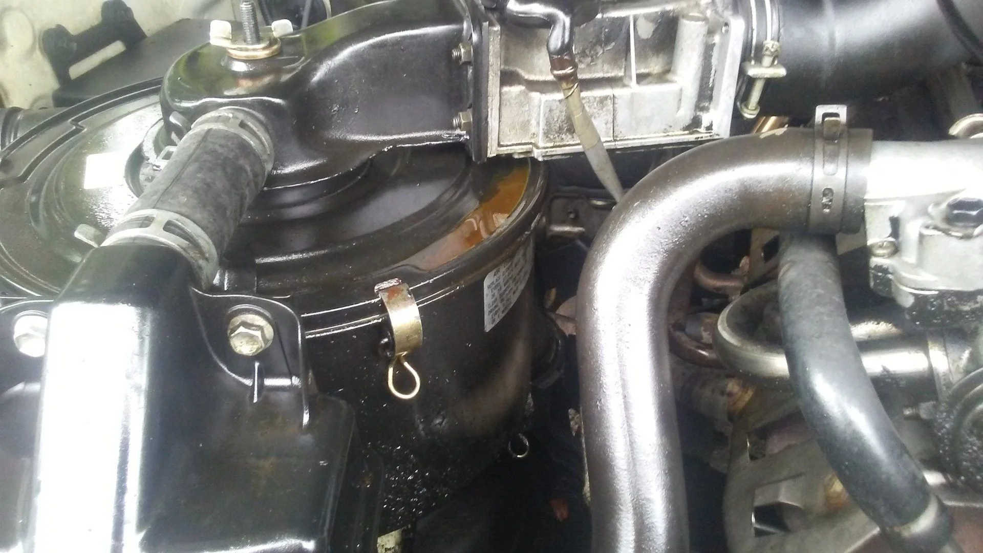

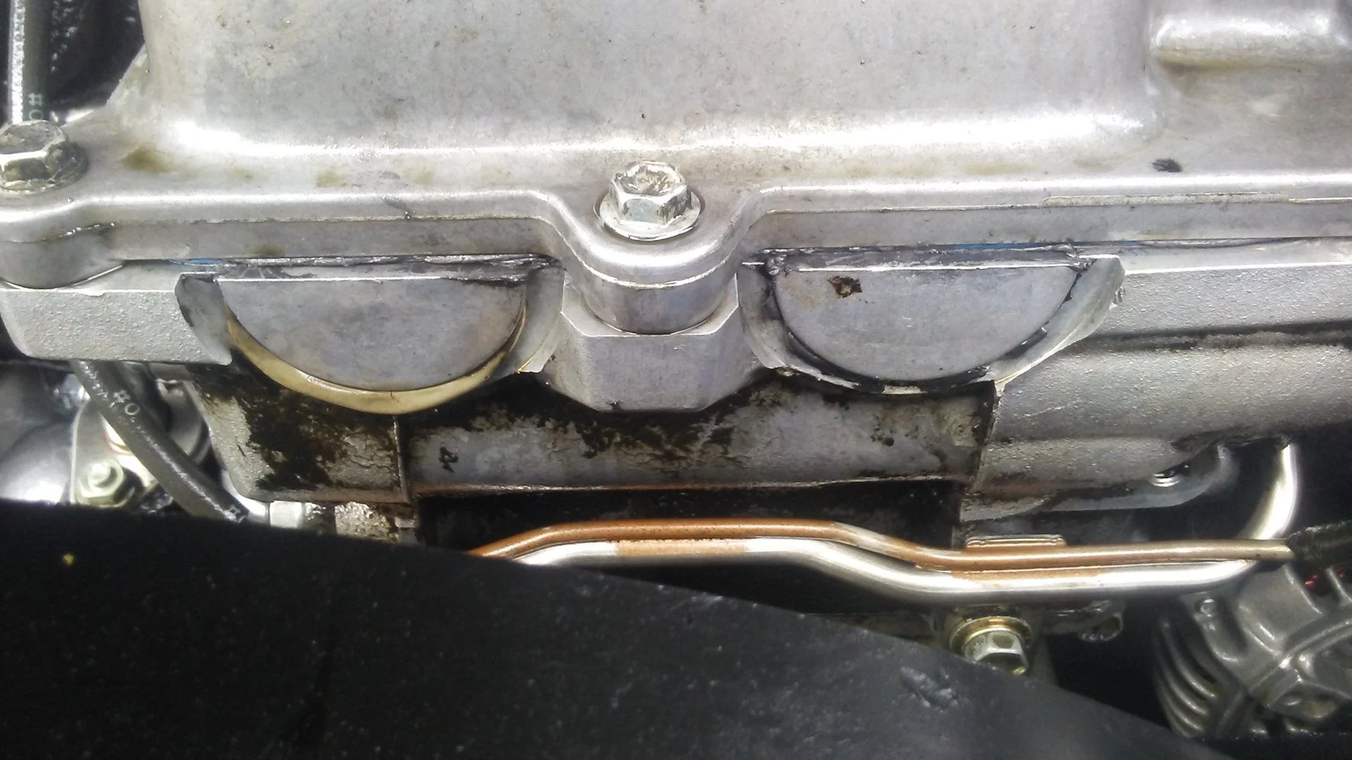

As mentioned above, looks like the half moon plugs may not have been resealed
properly. Also, is that water/coolant mixed with oil sitting on top of the air filter
housing??
Does your overflow tank (radiator) have oil in it, or does the coolant in the radiator look like it has oil in it?? Does the oil in the engine look milky??
