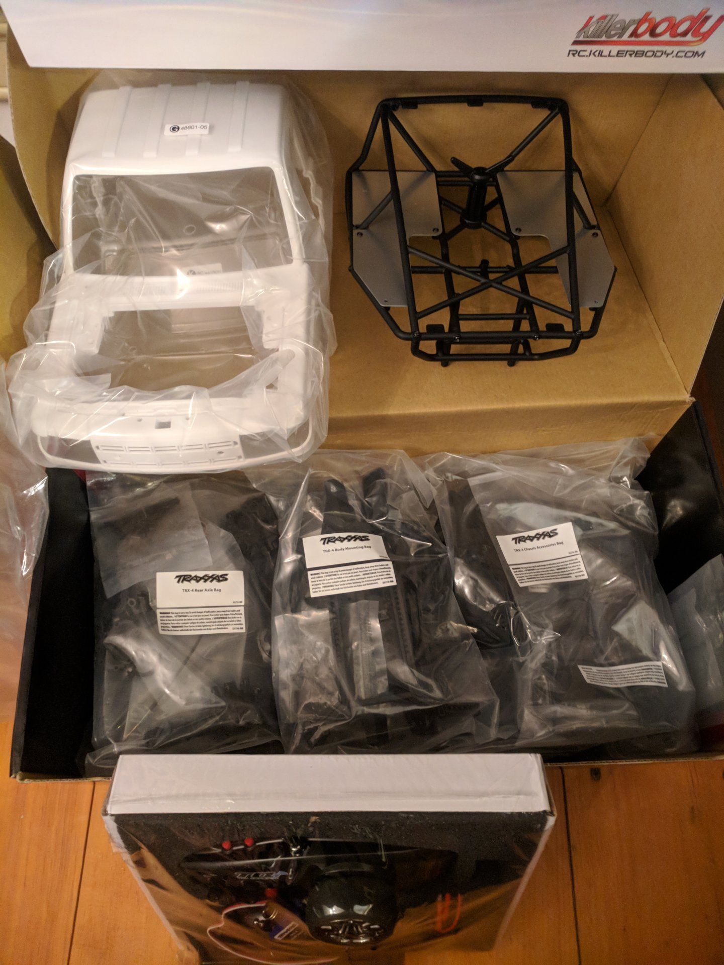

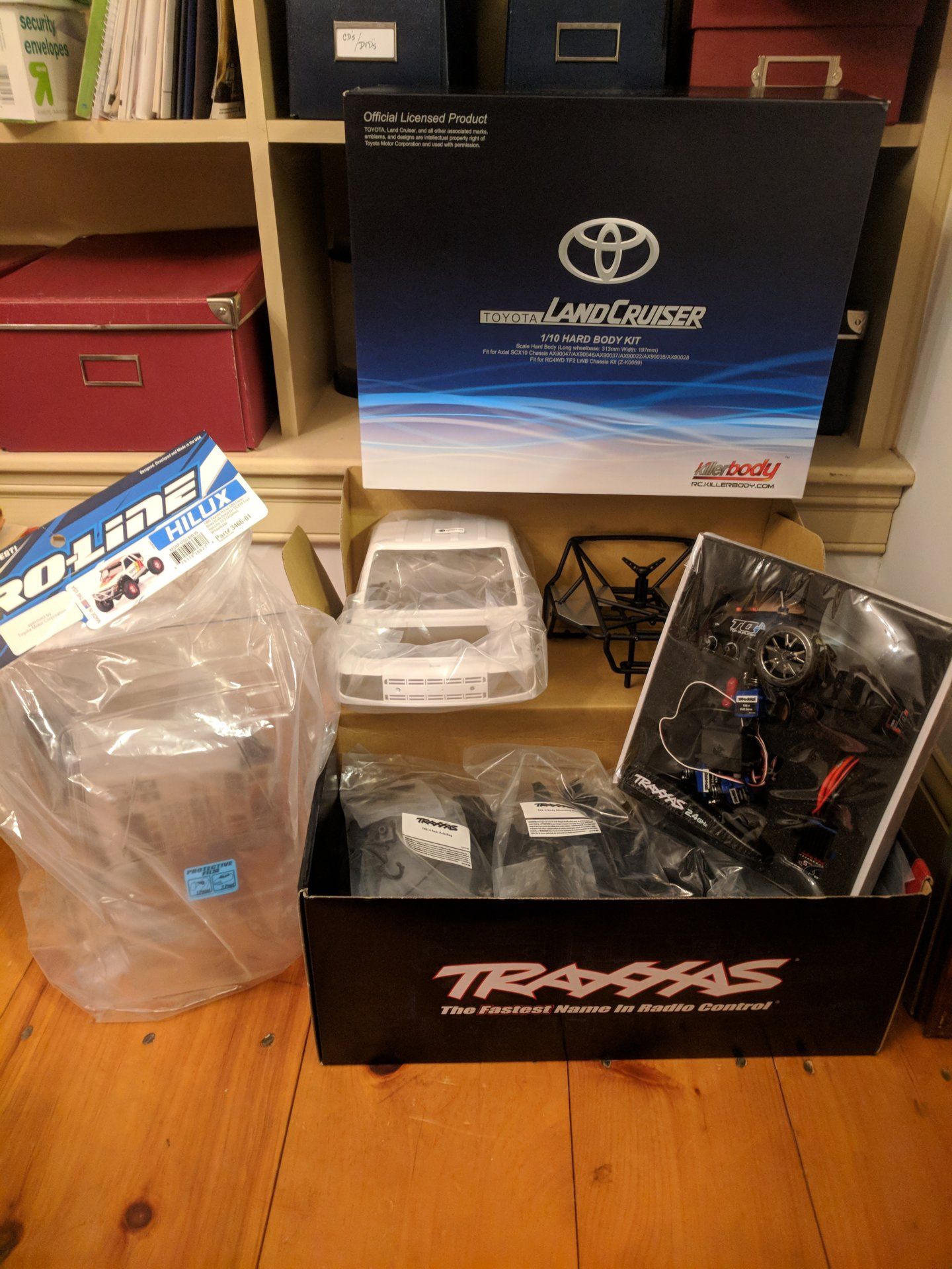

It is the whole body, bed and all. I will have to fab a panel for the rear of the cab from styrene.
I think it will be cool... I'm hoping it ultimately looks as cool as it does in my head.
