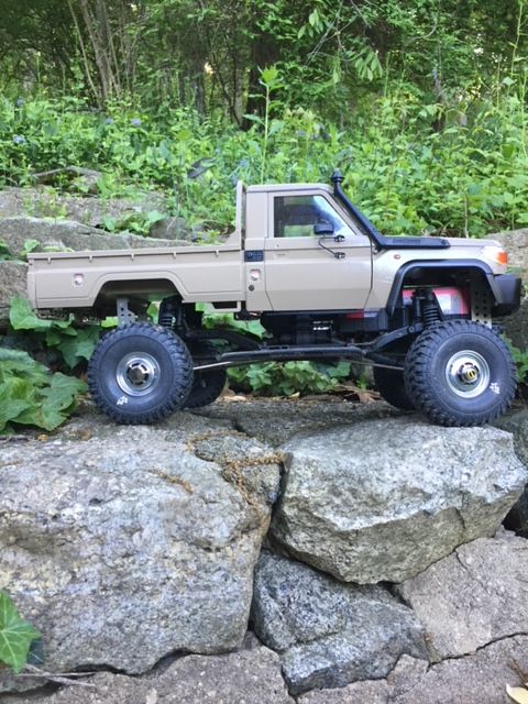

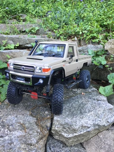

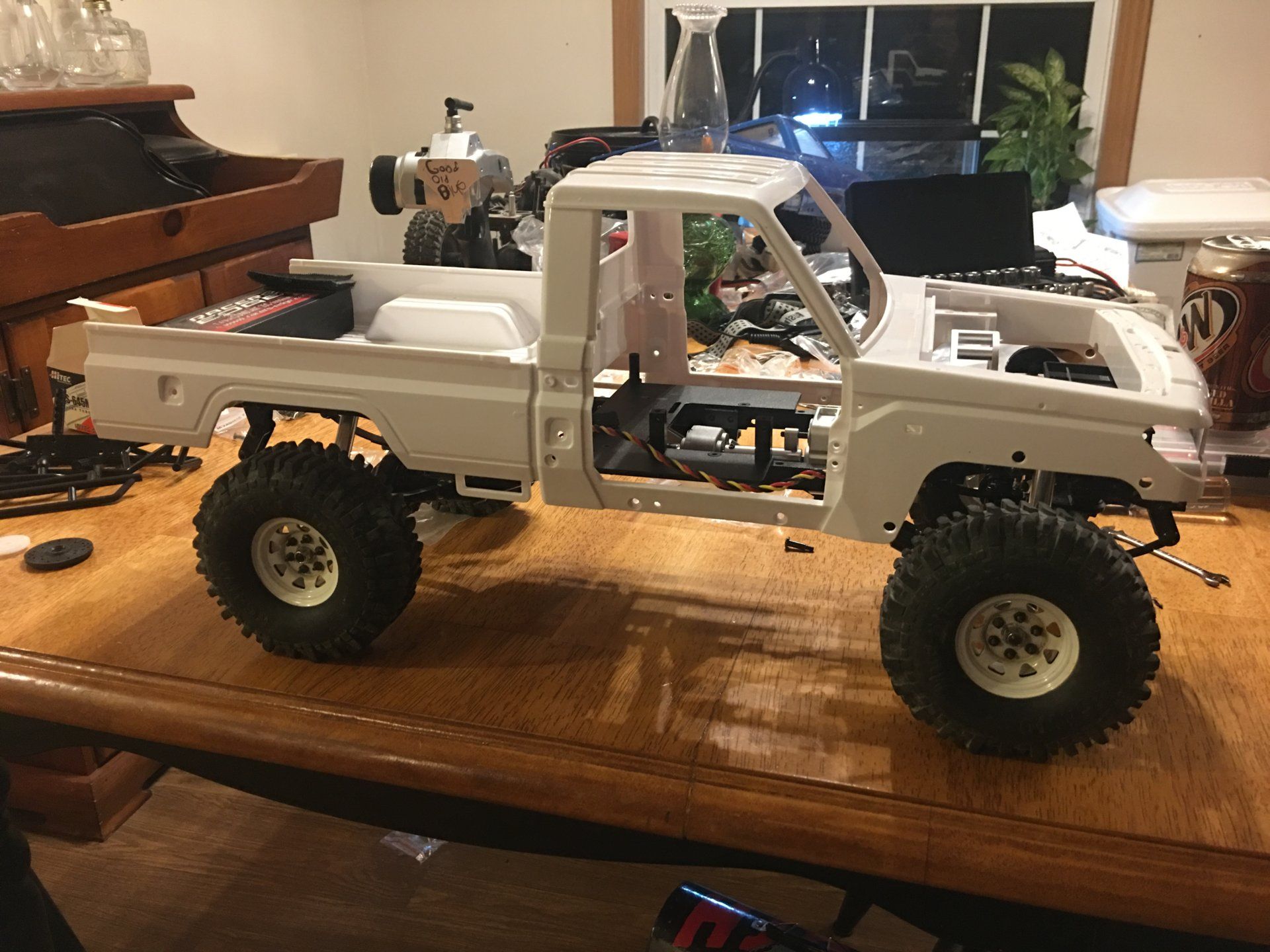

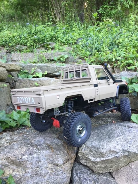

SOLID pick, well made, easy enough to assemble, looks so awesome! I built mine last year.
The body mount plates are weak. I broke mine...but I'm good at breaking stuff. If you want it to sit lower to look more scale, you'll have to cut holes in the bed for the rear shock towers, or use a cantilever shock. I built mine and put it on my SCX10-2. You may have to play around with the links to have the wheels line up on the Traxxas.

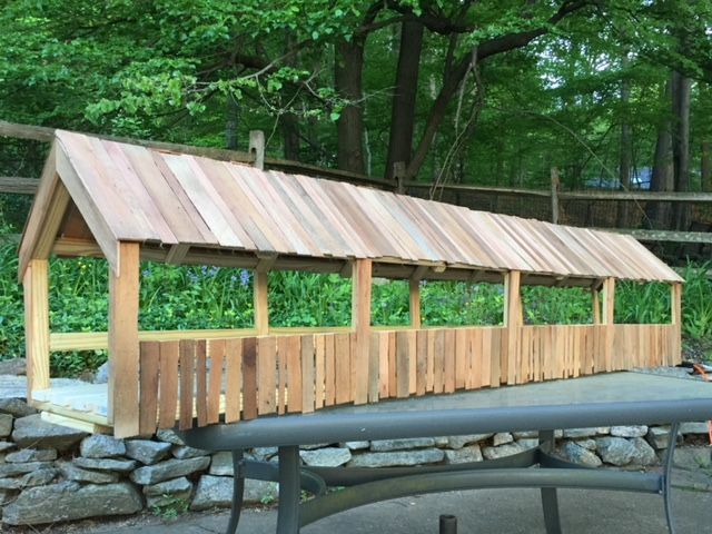

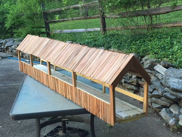

Around the same time, I built this eight foot long scale-ish covered bridge out of $20 in lumber and some cedar shake roofing shingles I had laying around.

Asiatees.com is the place to go. They sell body mounts specifically designed to mount the LC70 body to the TRX chassis. Check out their site and if you want a set of body mounts, let me know and I'll ad them to my order.
