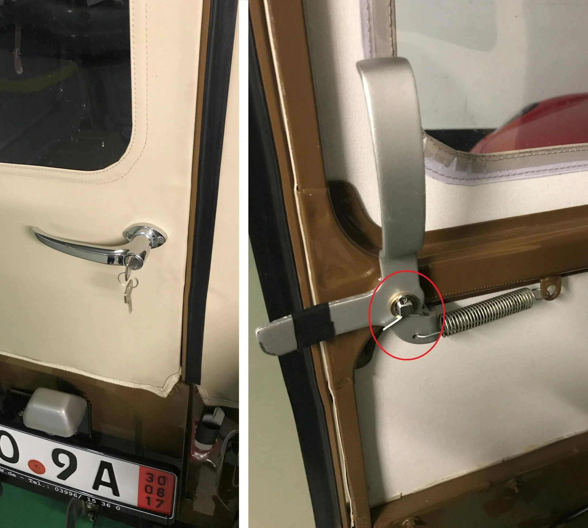

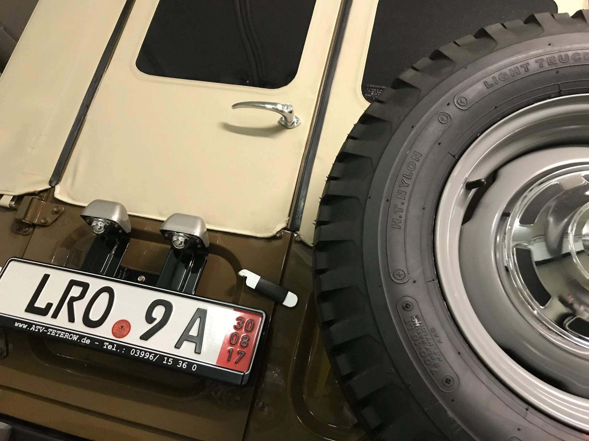

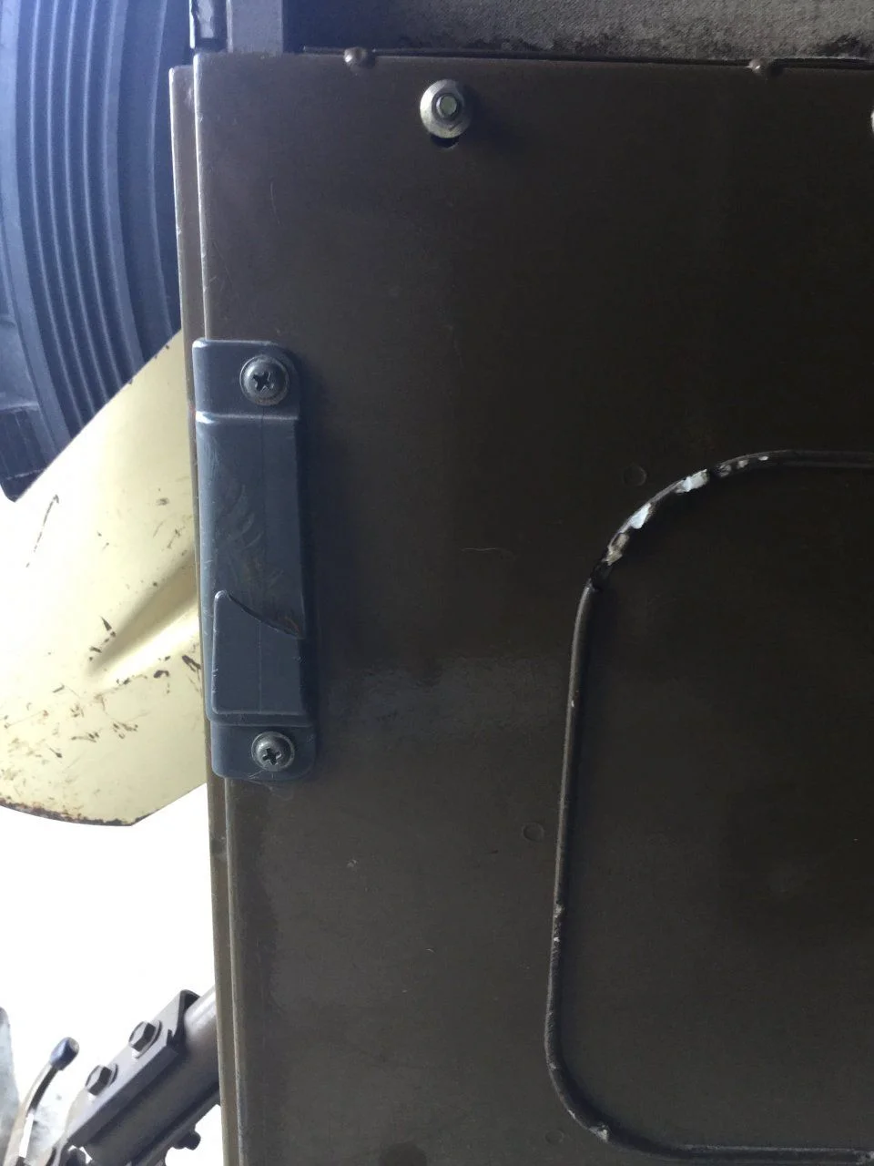

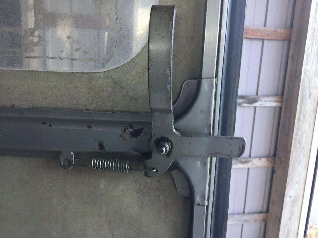

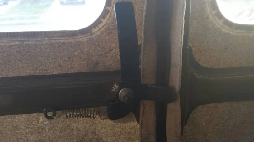

My upper outer hinge is not stock but you get the idea. The inside upper one is bent a little too - it should be straight where it latches against the door
Cool, thanks. I can see the Flicker photos now too. Looks like they made the upper, inner part the lower and fabbed a handle for the outside.
Not that I'm that concerned, a motivated person can get into a soft top rather easily, but were there provisions to lock the rear doors?

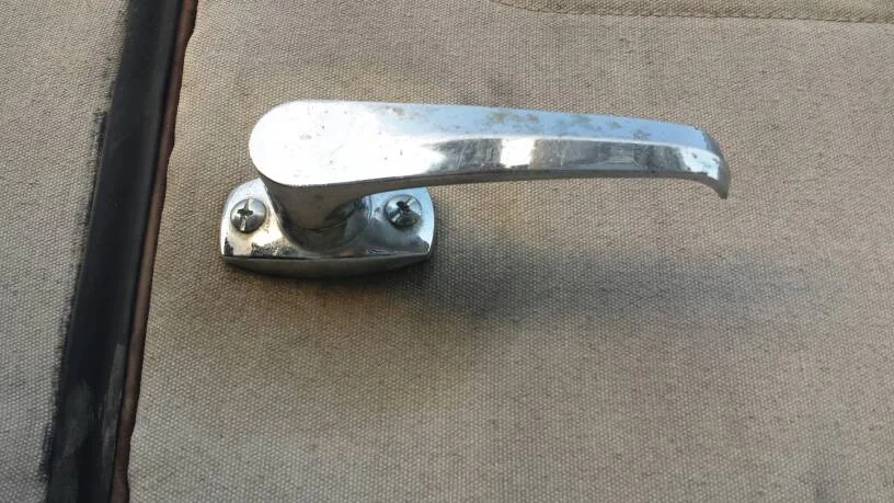

They came with locks too. 1984 bj46.
I looked into those both here in Japan and they're NLA.

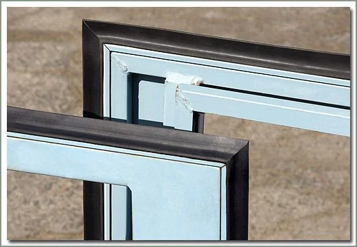

And does anyone know a good way to weld/join the corners like oem? my stock doors are very clean at the corners with zero evidence of having been glued.
Pete
@whitey45
I used spray silicone to get the weatherstripping in ... And another time I used Palmolive dish soap ... Both worked well but only one worked makes my hands soft and smelling fresh :meh:
@peteinjp
I think I used rubber cement (stuff for inner tube patches) the first time I did it ... It did last for awhile ... But it did split eventually ... Never tried to do it after that ... They are pushed very close and my oem gasket wasn't attached either

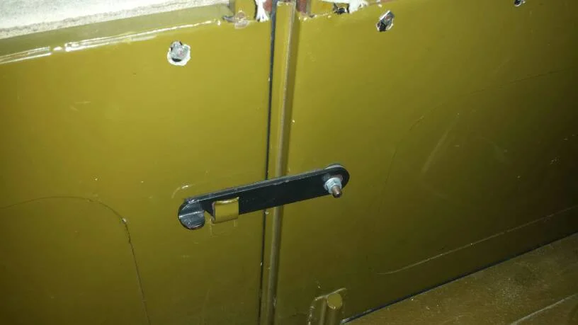

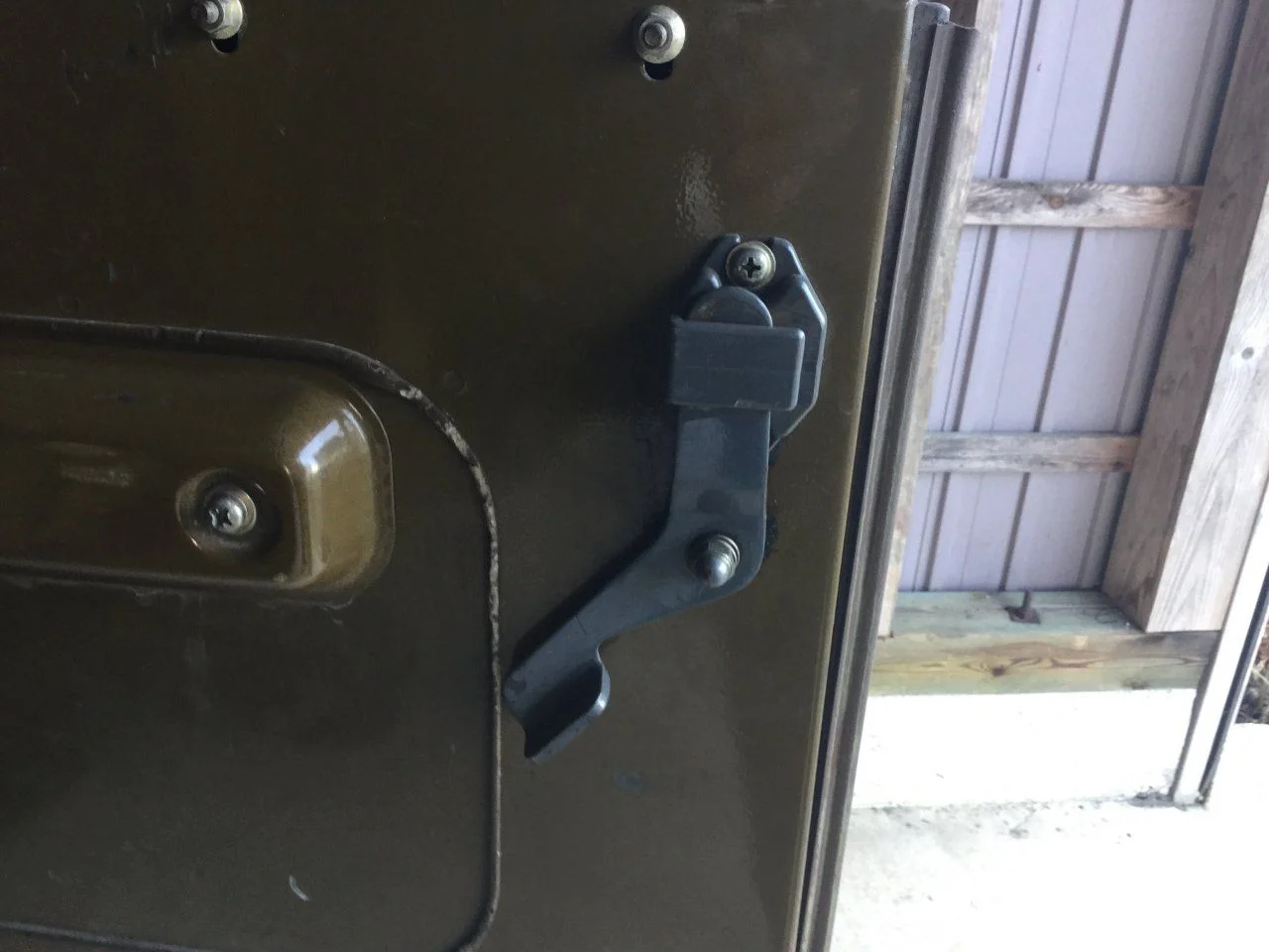

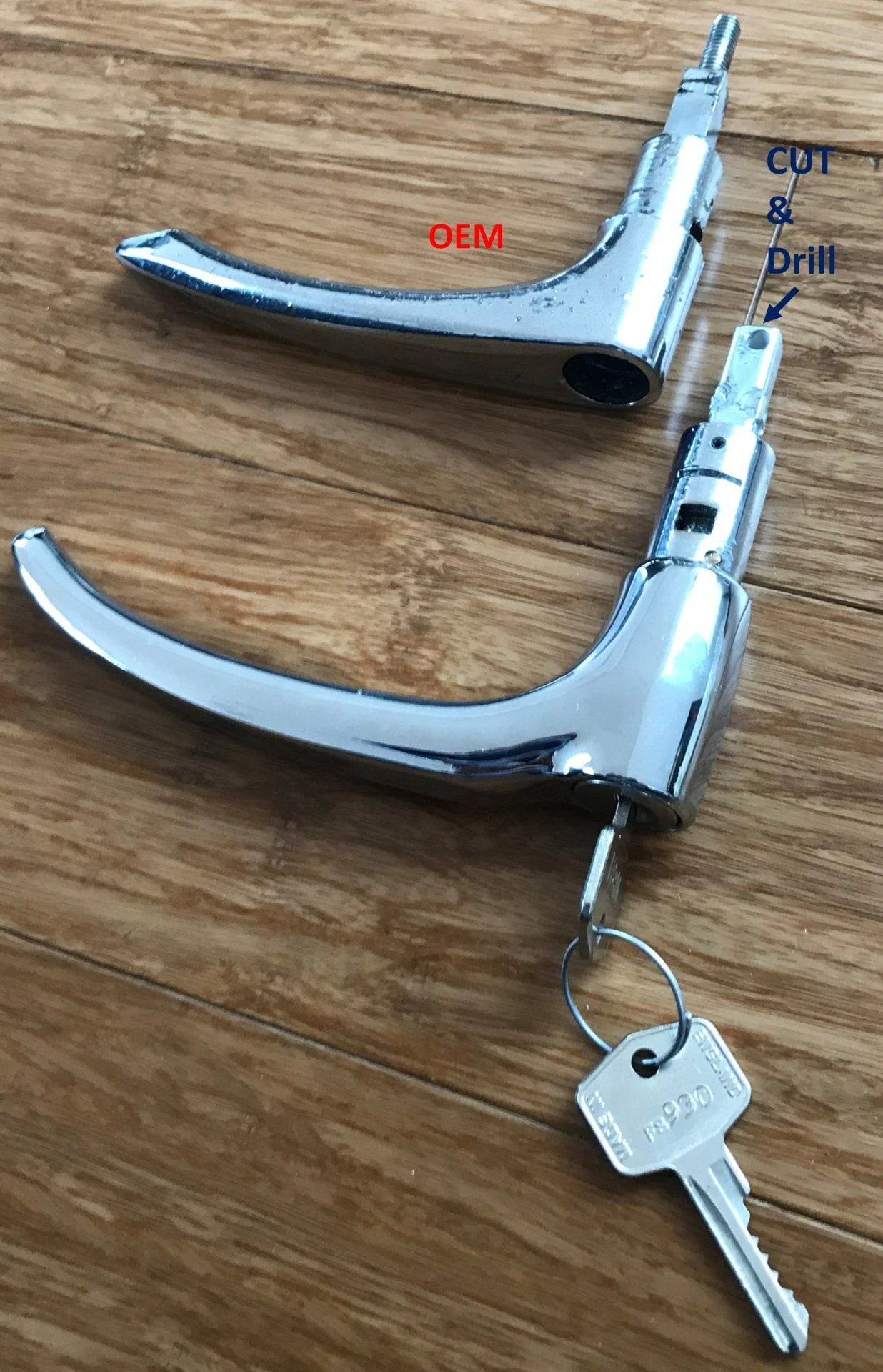

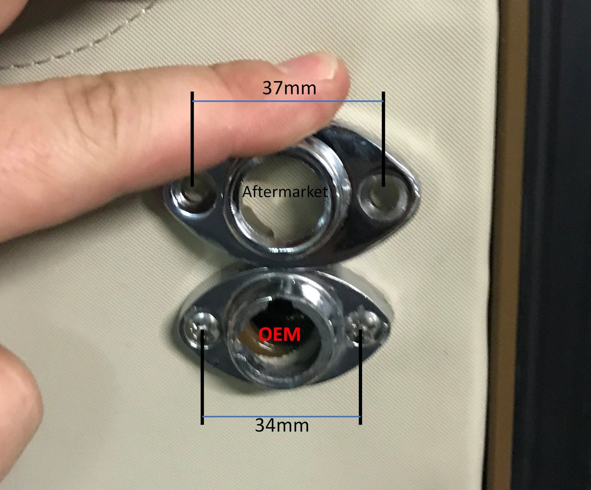

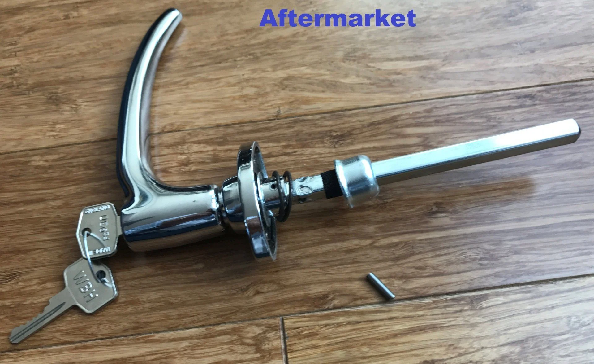

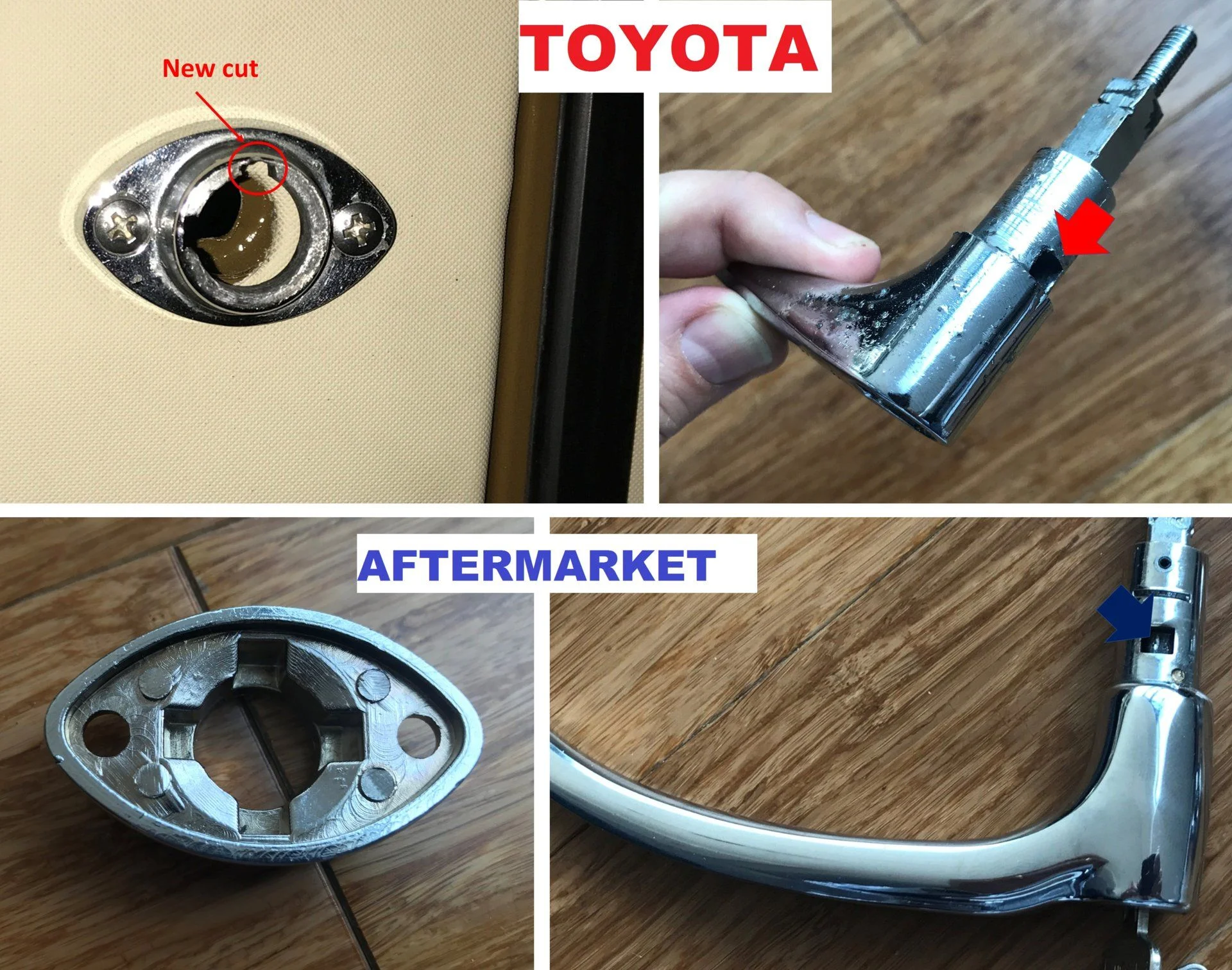

I decided to use the oem bracket and new aftermarket handle
First problem is that the lock in the aftermarket handle goes in another direction.
You need slightly adjust an OEM bracket
Thats how you can reassamble the aft handle
Plus you need to cut the aftermarket handle and make a hole for the fixation
After assamble
Final picture. Looks OEM for me
