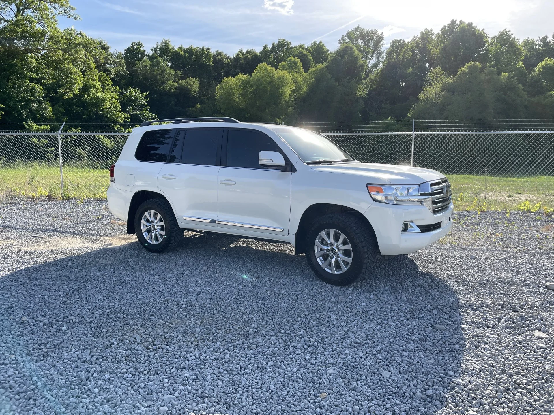

No spacers of any sort, 100% stock suspension and offset
Did you experience any rubbing?

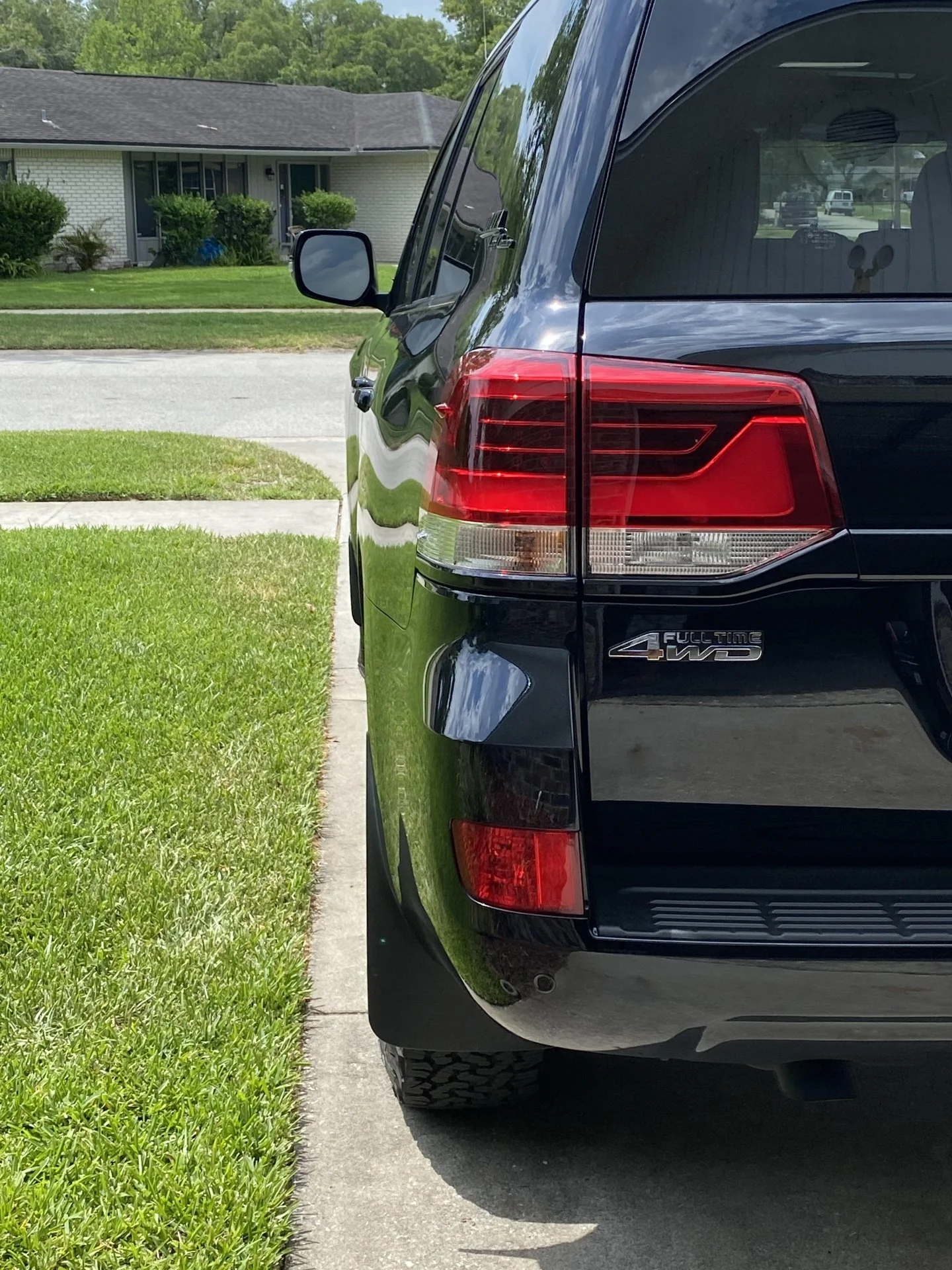

@SidZer0 Could you post a pic from the front to see the outer position of your 275/70/18 KO2's? I'm thinking of doing something very similar. Thanks.
Here ya go. Sorry for the late response.
Also for those wondering. I picked up a 5th tire for a spare today and a 275/70/18 fits underneath perfectly.

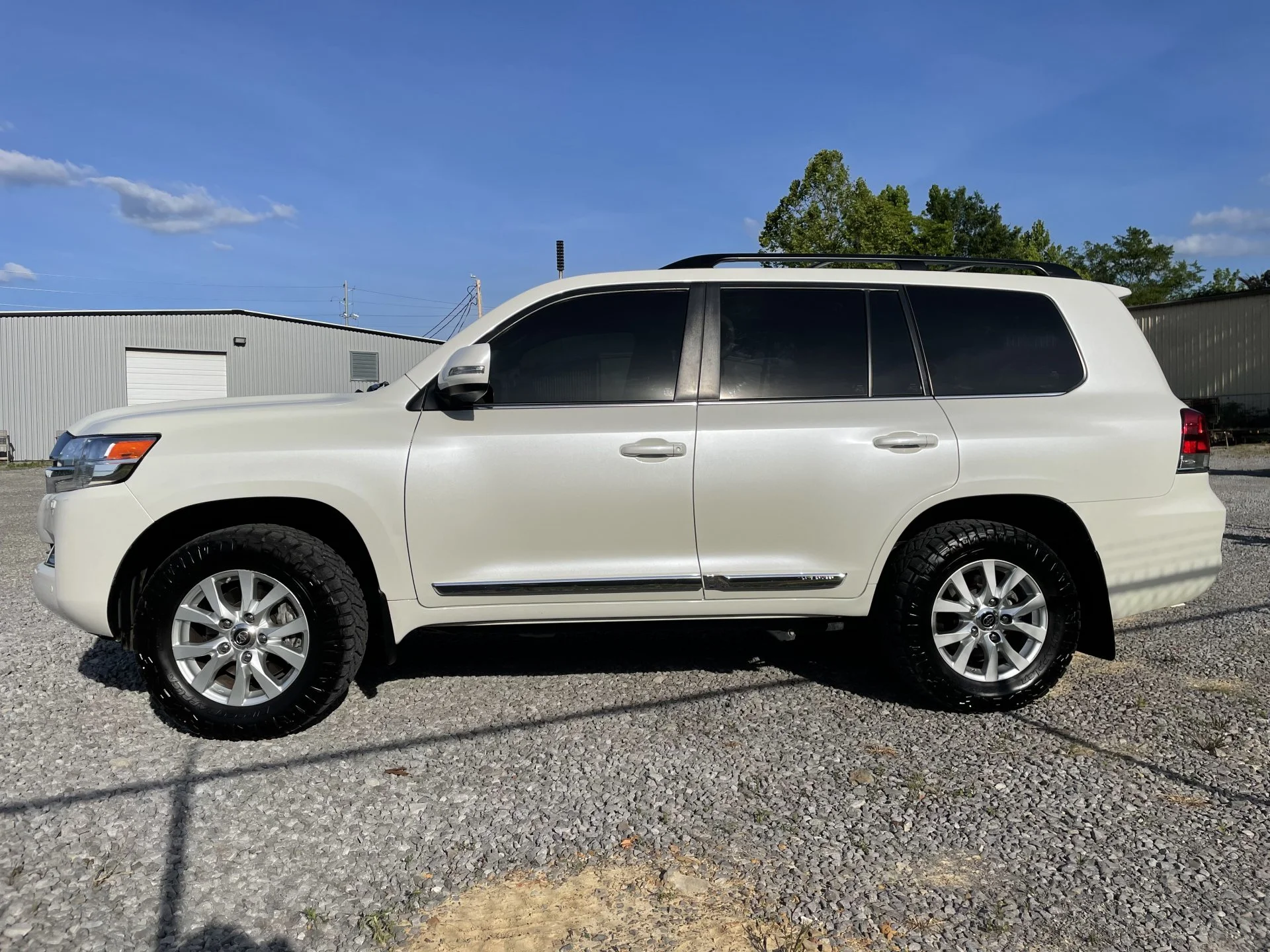

I installed the spacers on my wifes on Tuesday and added rear bilstein coils while at it. 1 banana job. Just follow @OTRAMM video. Honestly it took me 2 hours for the front and an hour on the back.. I am pleased with the lift but the wife doesn't like the rake. Probably going to add the ironman foam cell fron struts to even it out.
I had one of the Toyota Dealerships about an hour from me install the spacers on my wife's 2016 a couple of weeks ago. The owner of that particular dealership is supposedly a big land cruiser guy and their master mechanic exclusively does the work of any Land Cruiser that comes in, so I felt "reasonably" comfortable letting them have our baby. Overall I am very pleased with it. I will eventually upsize tires to 33's but am fine with these stock size Nitto RG's for now.

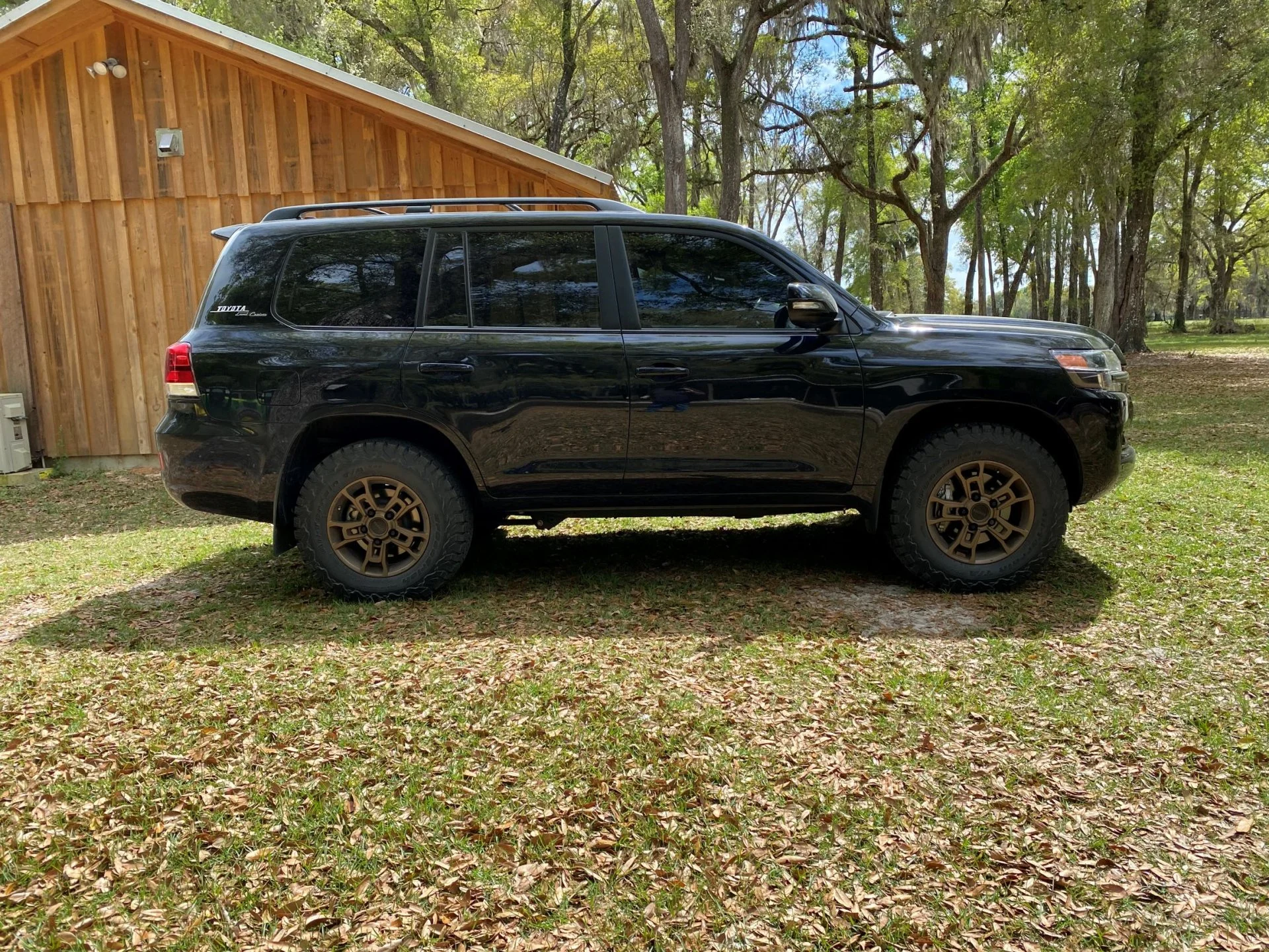

They are, pretty perfect tire size for a 200 - if the KO2 is ever made in a 285/70r18 I’ll switch though, the 275s look pretty narrow compared to the 315s I run on my 80 series.
I’m looking at 285/70/r18 AT III’s on the ‘18 I just bought last week. Any issues you’re aware of with rubbing on this size?
Hopefully I'll have mine on in the next week or two. Already running 275/70/18's on stock wheels with 1.25" Spidertrax wheel spacers.
