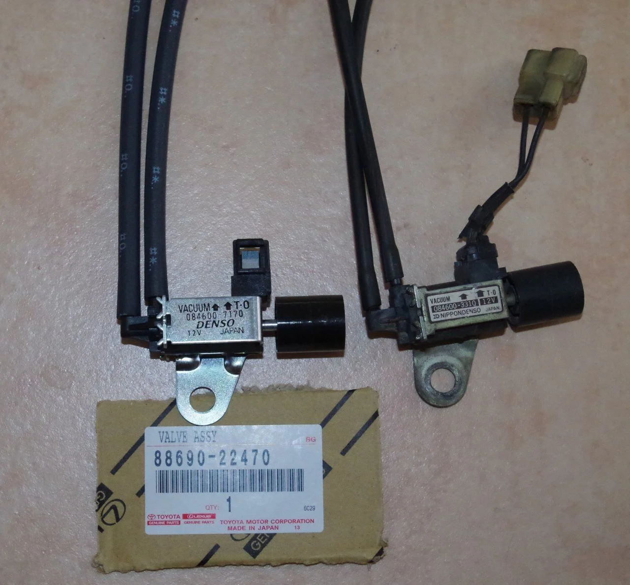

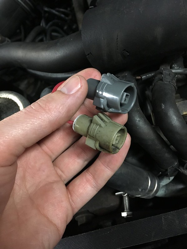

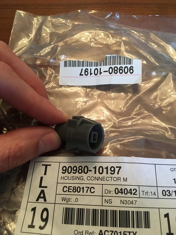

FOR IDLE-UP VSV :
88690-22470 (early 4Runners). Has a different connector, but otherwise identical function.

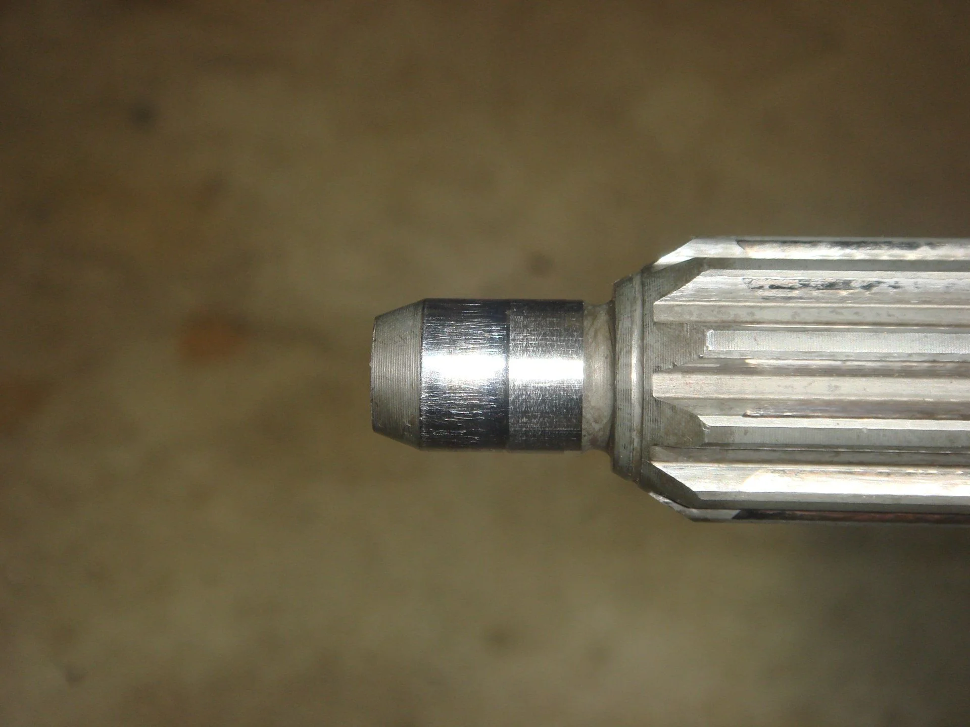

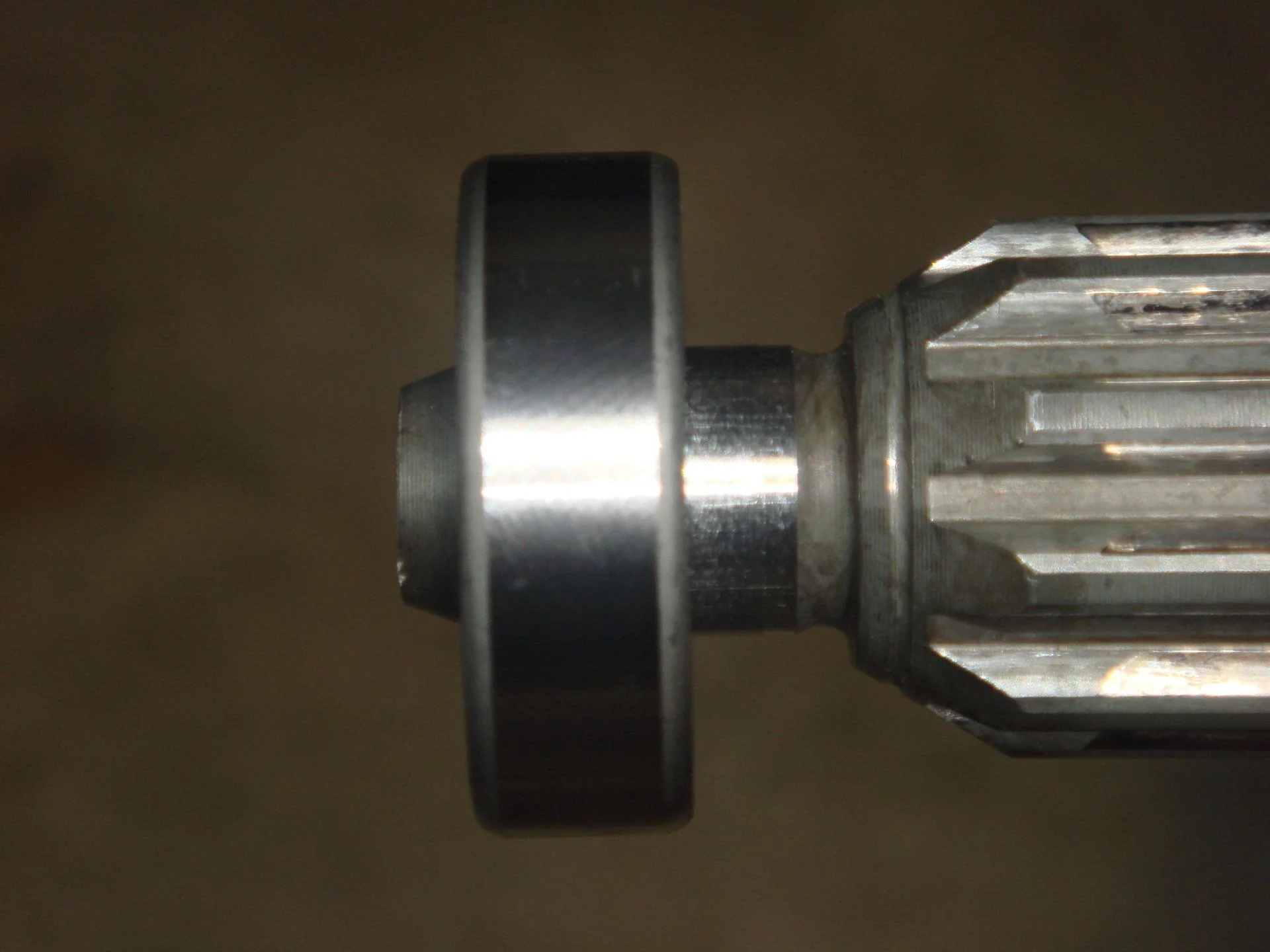

Ok, I have one but it's not so much an OE to AFT swap as its an excellent workaround to a potentially expensive disaster: A spun transmission input shaft tip.
As I've mentioned in other posts, If the clutch pilot bearing wears out and creates too much friction, the tip of the transmission input shaft can break free of the friction fit in the pilot bearing race and then begin grinding itself down. At that point, swapping in another Toyota pilot bearing won't help because the tip won't be able to hold on to it.
The 'proper fix' is to replace the whole input shaft with a new one (H55F available only). If you've got a 4 speed, you're SOL cuz they're NLA. Replacing an input shaft is a daunting and expensive proposition and really isn't something a non hard core home mechanic should get involved with. Best left to a transmission shop that has the experience and correct pullers.

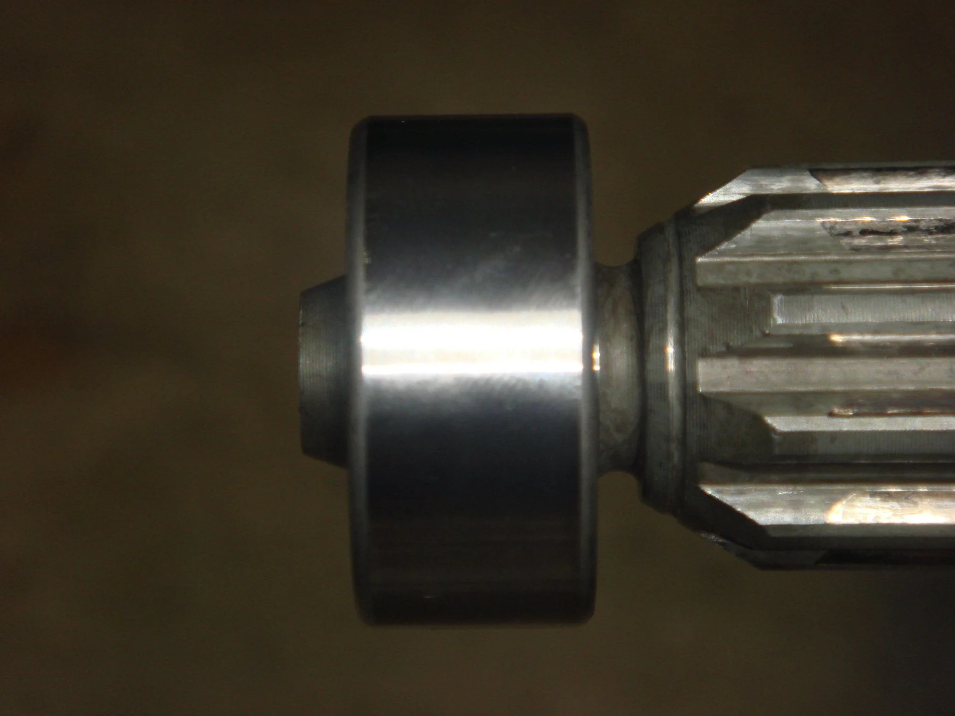

The other option is to use a deeper pilot bearing than the original that will grab the good part of the shaft that has never been used.

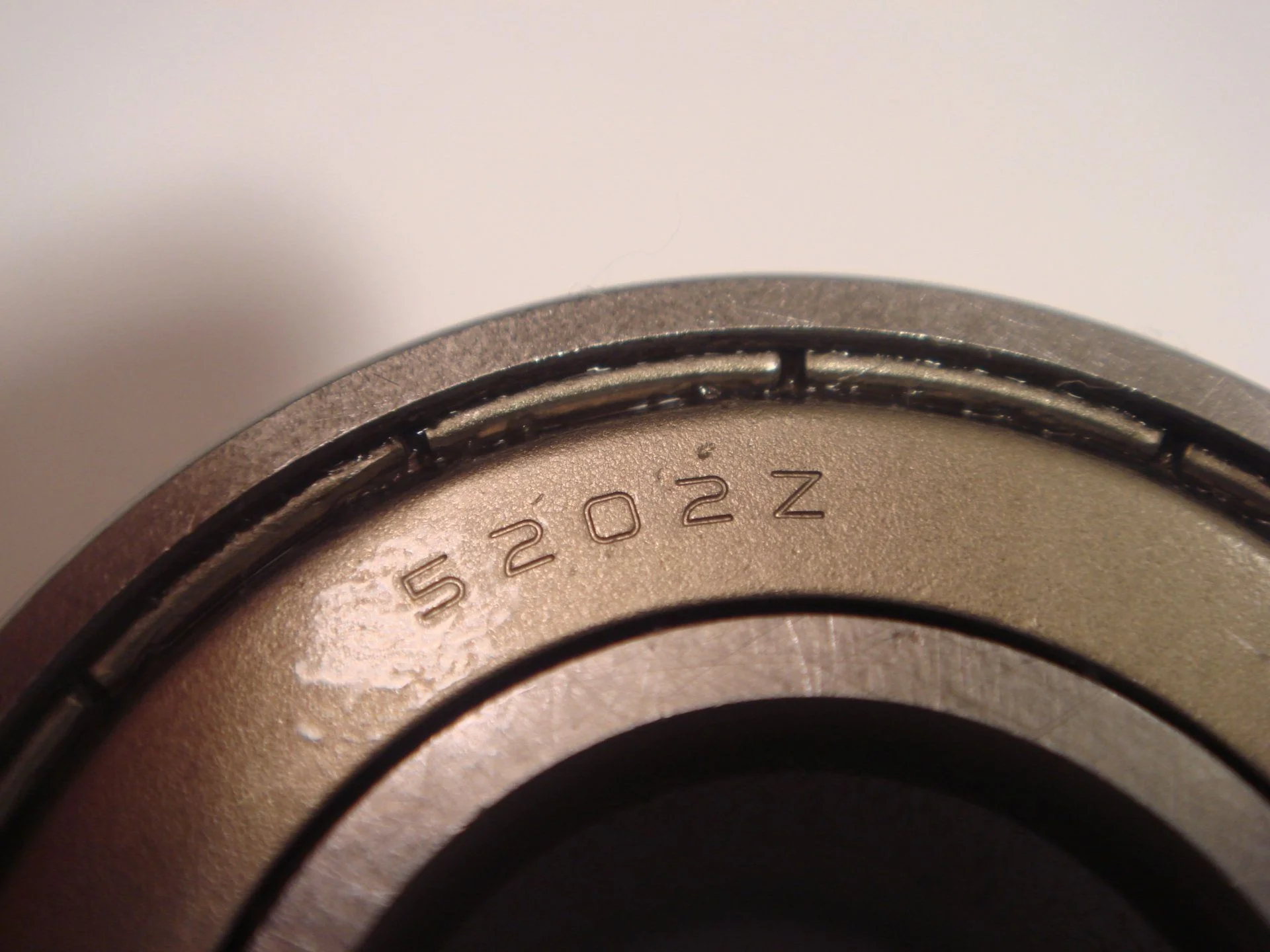

That magic bearing is the Nachi 5202Z.
It's the the exact same dimensions as the Toyota bearing, (Nachi 6202NK) just deeper. It works perfectly. Perfect fit. No problems.
My other OE to OE discovery that many people now know about is the EVAP and distributor VCV replacement. There's a big write up I did about that part over in THIS thread.
5202Z below
Toyota 6202 bearing below
Worn input shaft tip won't grab standard bearing. But deeper on the shaft is untouched metal.
5202Z below
