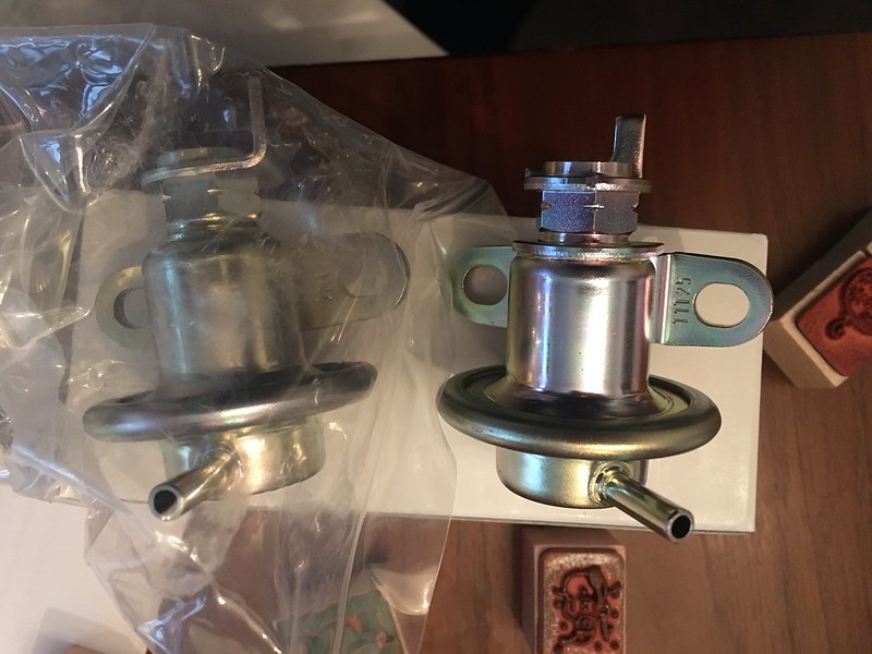

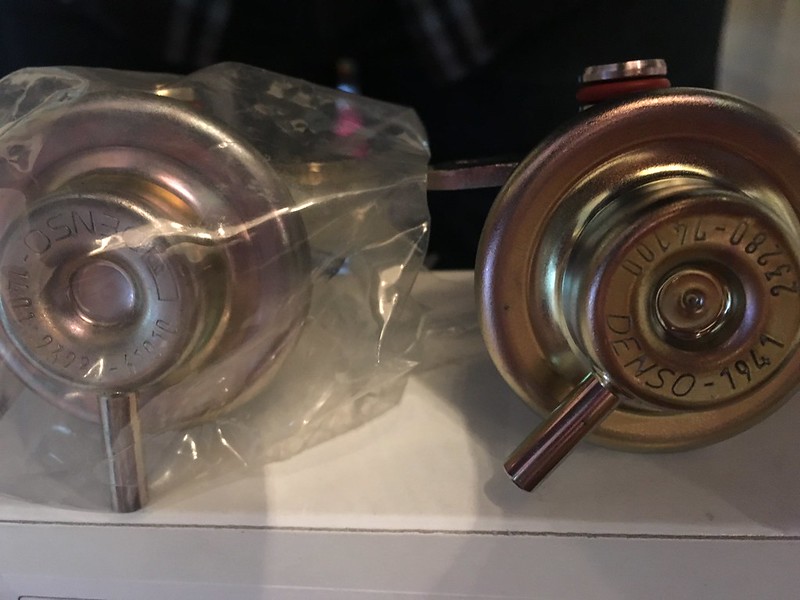

So I ordered a FPR from partsgeek for a 1995 Toyota MR2 (PART # W0133-1743784 Kyosan )
What arrived was a nice DENSO product almost identical to the OEM FJ62 FPR. Again, haven't had time to test it but if someone needs one ASAP, give it a try. They are only $27 at time of order!
FJ62 on left, MR2 on right:
@c2dfj45 has already shown that it bolts up no problem. Someone just needs to test it out now.....
Good dig. That might be some real gold, right there. Be worth ordering 2, if it works...
