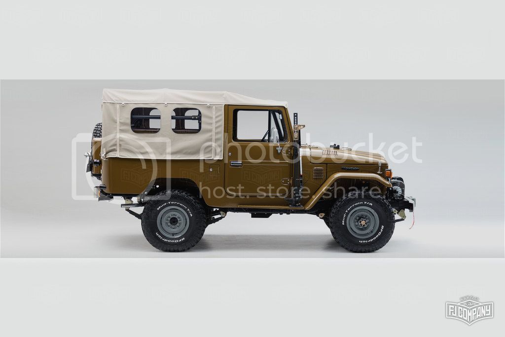

This is the color I am planning on going with: Olive 637
Thanks; I'm in love with it
