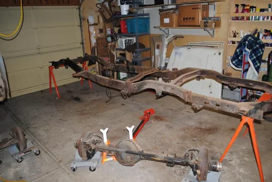

More work today... :wrench::wrench::wrench:
... frame stripped of axles and assorted bracketry...
... axles stripped of springs and wheels...
... everything labeled and moved to the shed...
Thanks to the wife for letting me play in the garage all weekend!!!

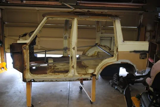

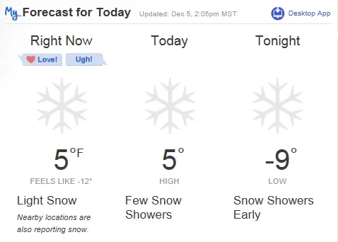

Nothing like working in an unheated garage in winter...
Amazing though, how fast some welding really heats thing up. Used some square inch tubing to brace the body (what's left of it) so I can cut out and replace the rockers and floor boards. Hopefully when all is completed, the doors will at least sort of line up. :D
Only problem I see is that I hope I left enough room between the tubing and the body to get tools in there to work easily. We'll see...
