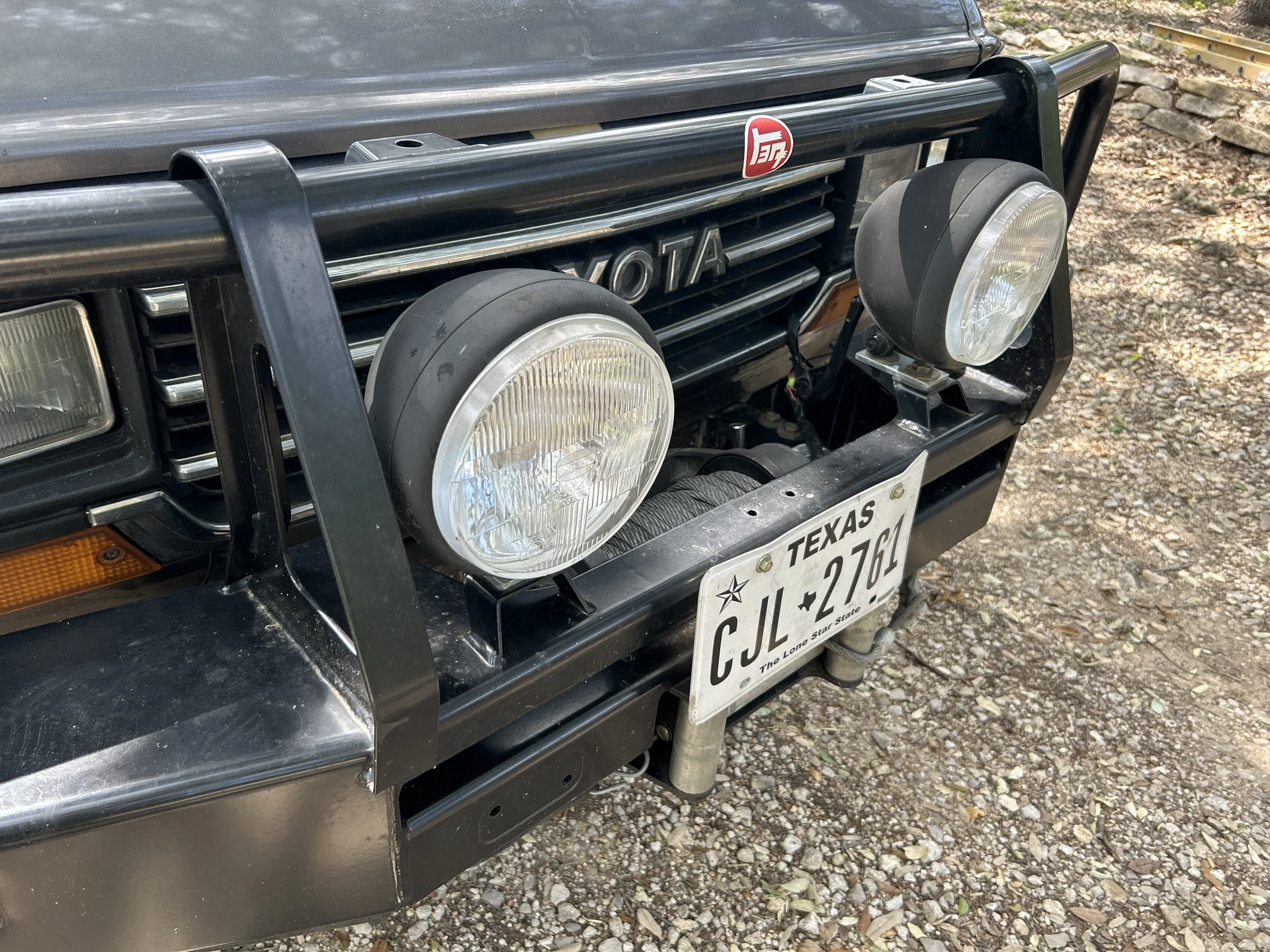

I made my own H4 lights out of the insanely cheap Toyota kit (get it from @CruiserTrash or your friendly dealer) and some generic motorcycle buckets.
They aren't iris melting LED like every Ford truck on the road these days but are very plenty bright with low and high beam.
That was a cool project Ian. The look is perfect. Unfortunately I want iris-melters :(

Can you give more details on how you made these lights?
They look pretty good.

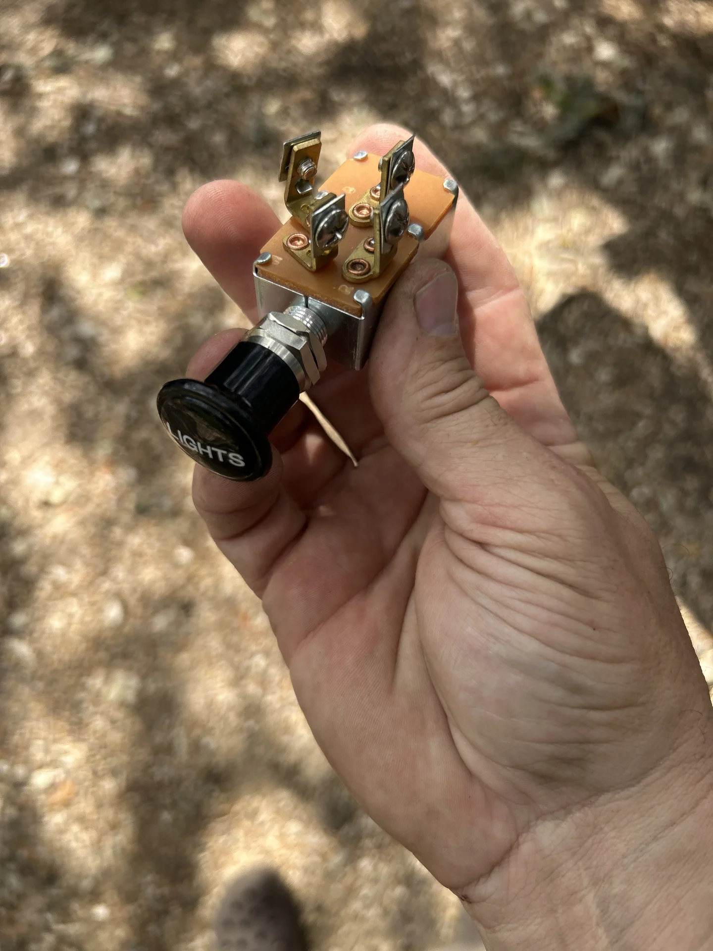

Thanks.
I got these bottom mount, 7” motorcycle headlight buckets:
And inserted the crazy good deal OE H4 light kit into it:
And wired it into this switch to use low and and high beams:
Thanks.
This right here is damn brilliant.
