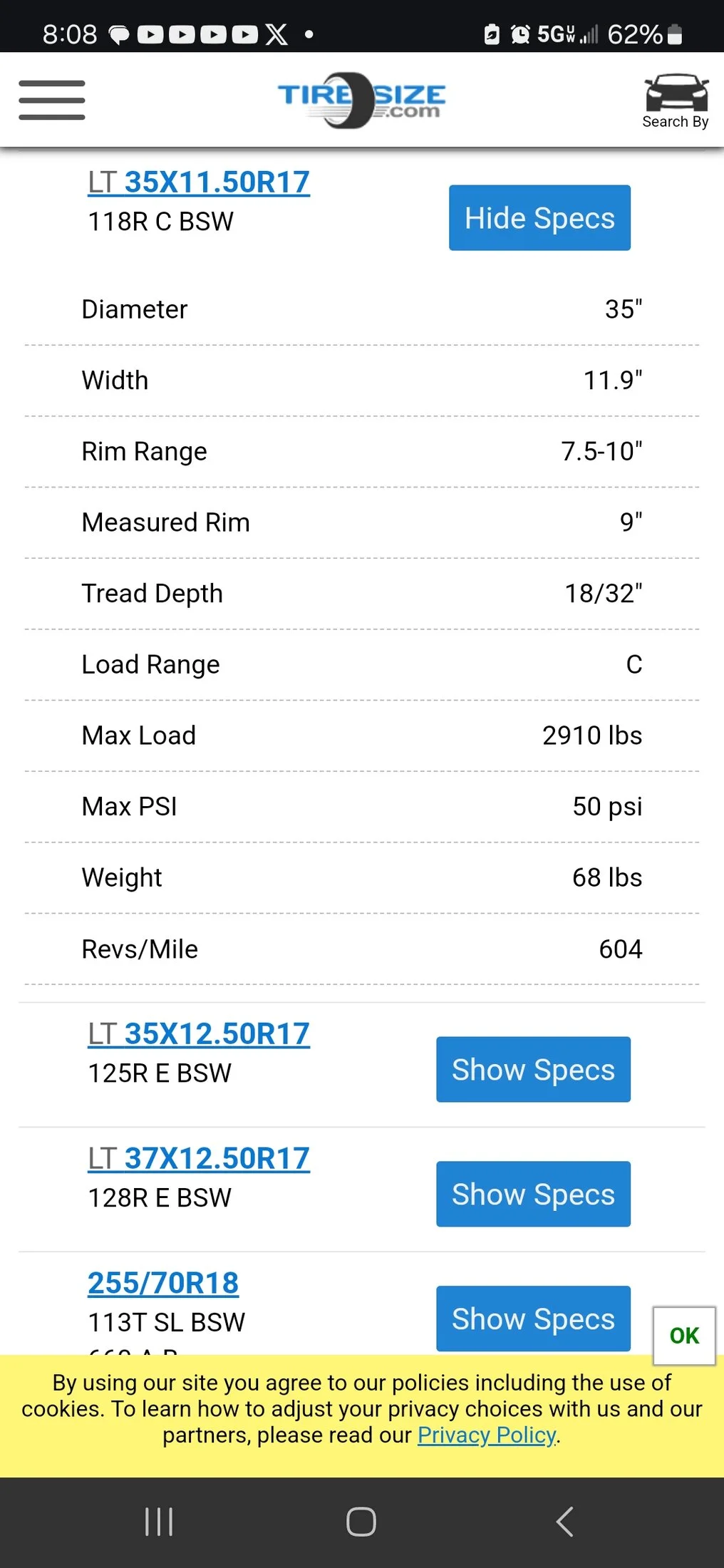

Got some new shoes for Nola. Wanted to find the lightest and tallest wheel tire combo with a 3 peak rating for 17 inch wheels. Wheels only weigh 26 lbs. Didn't want balloon tires but not pizza cutters either. Sidewall is supposedly pretty good on these ATW4s which eill be mch better than the current GY Duratracs. Handling should be improved too.
Got one more mod to do before I put these on.
Should drop my revs when I'm on the highway too
Can you share wheel and tire specs? Looks great!
Wheels
Tires
New Tires weigh 68 lbs which is pretty good for a 35 inch 3 ply tire.
New Wheels come in at 26 lbs. My old wheels are 25 and current tires are 65 lbs.

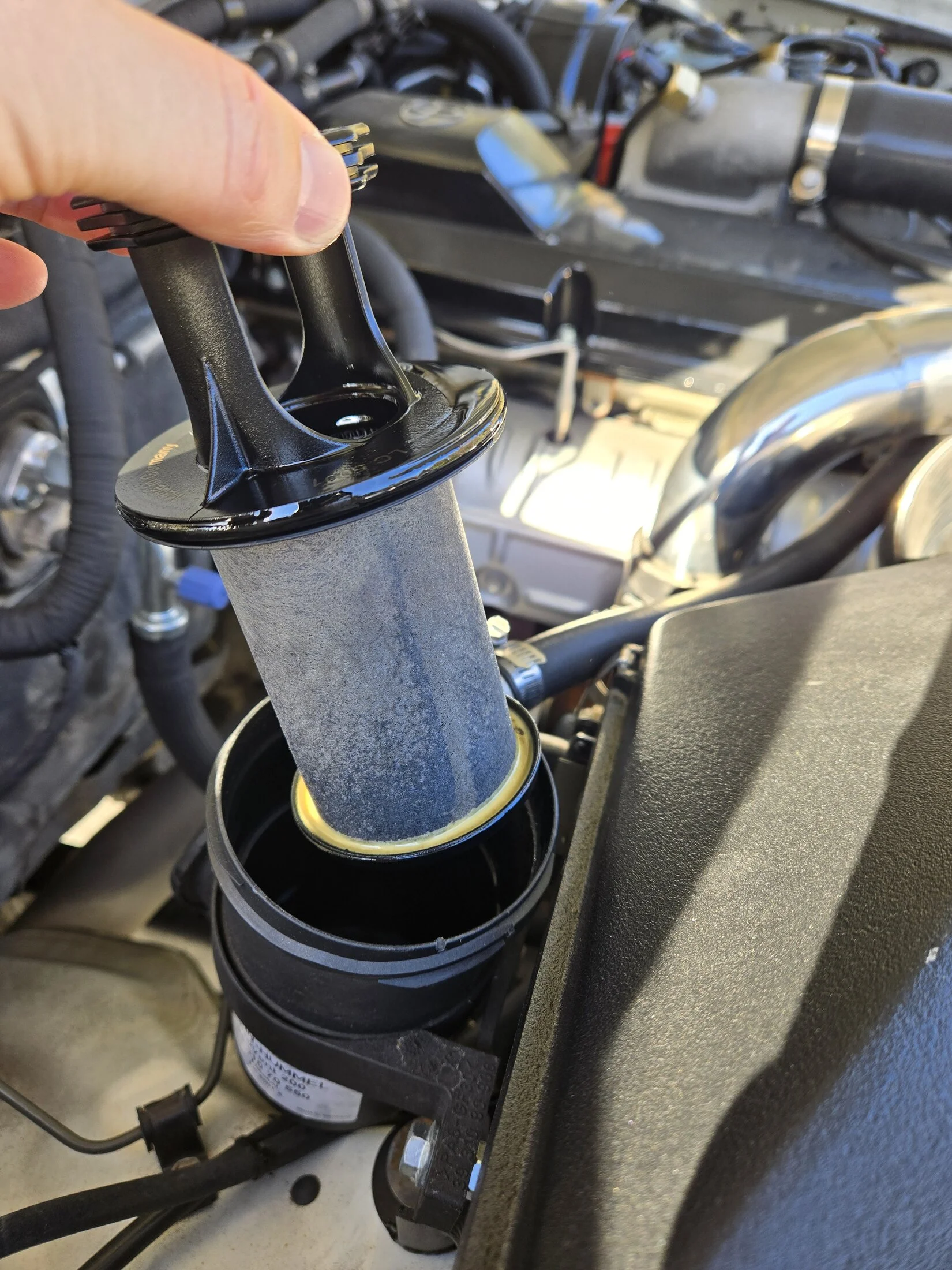

Tested for blow by using the loose oil cap method and nary a breeze. Provent catch can only had a little over a ounce of oil but since this is the first oil change after the engine swap I'm sure the saturation of the filter has a couple ounces.

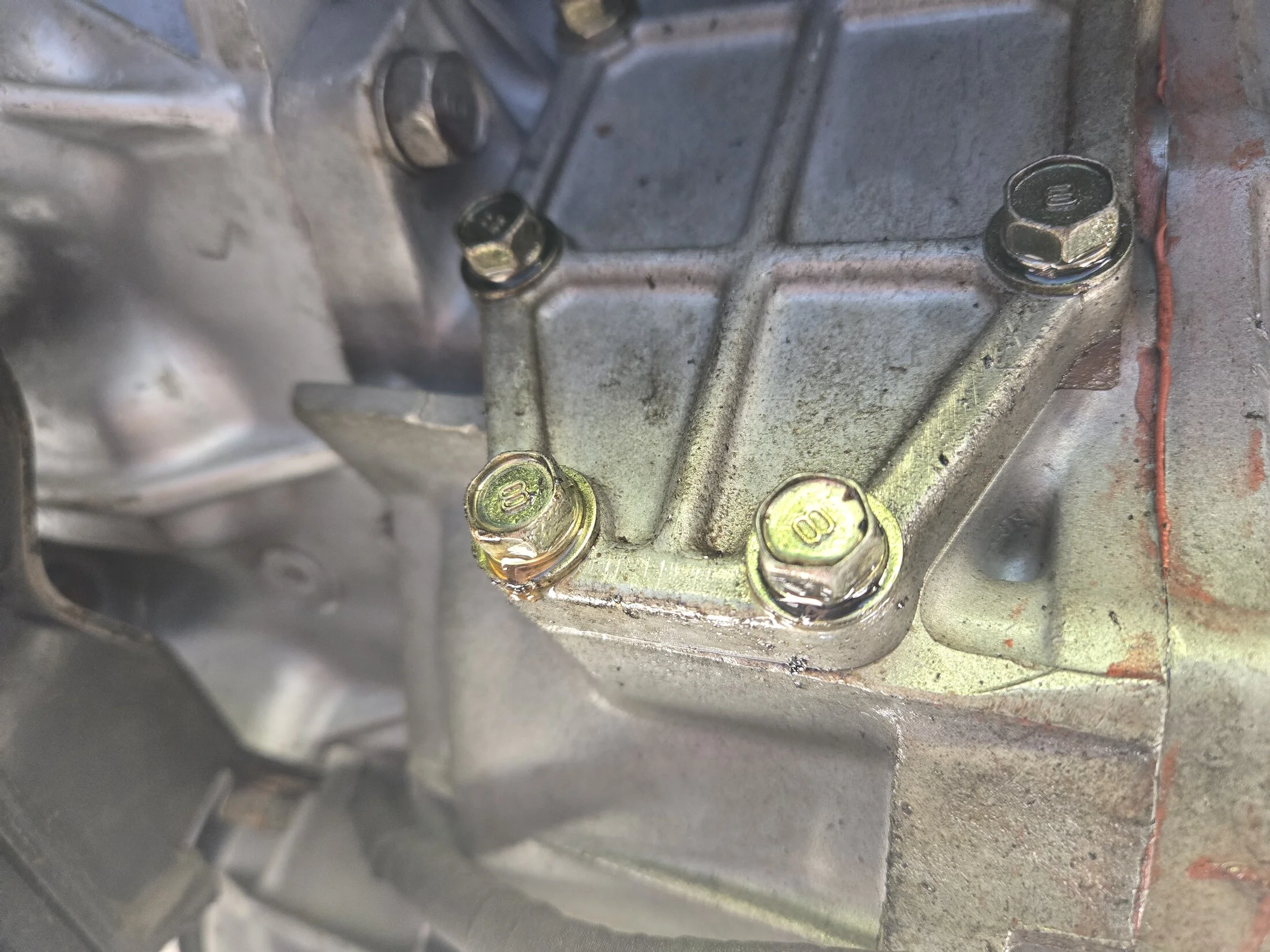

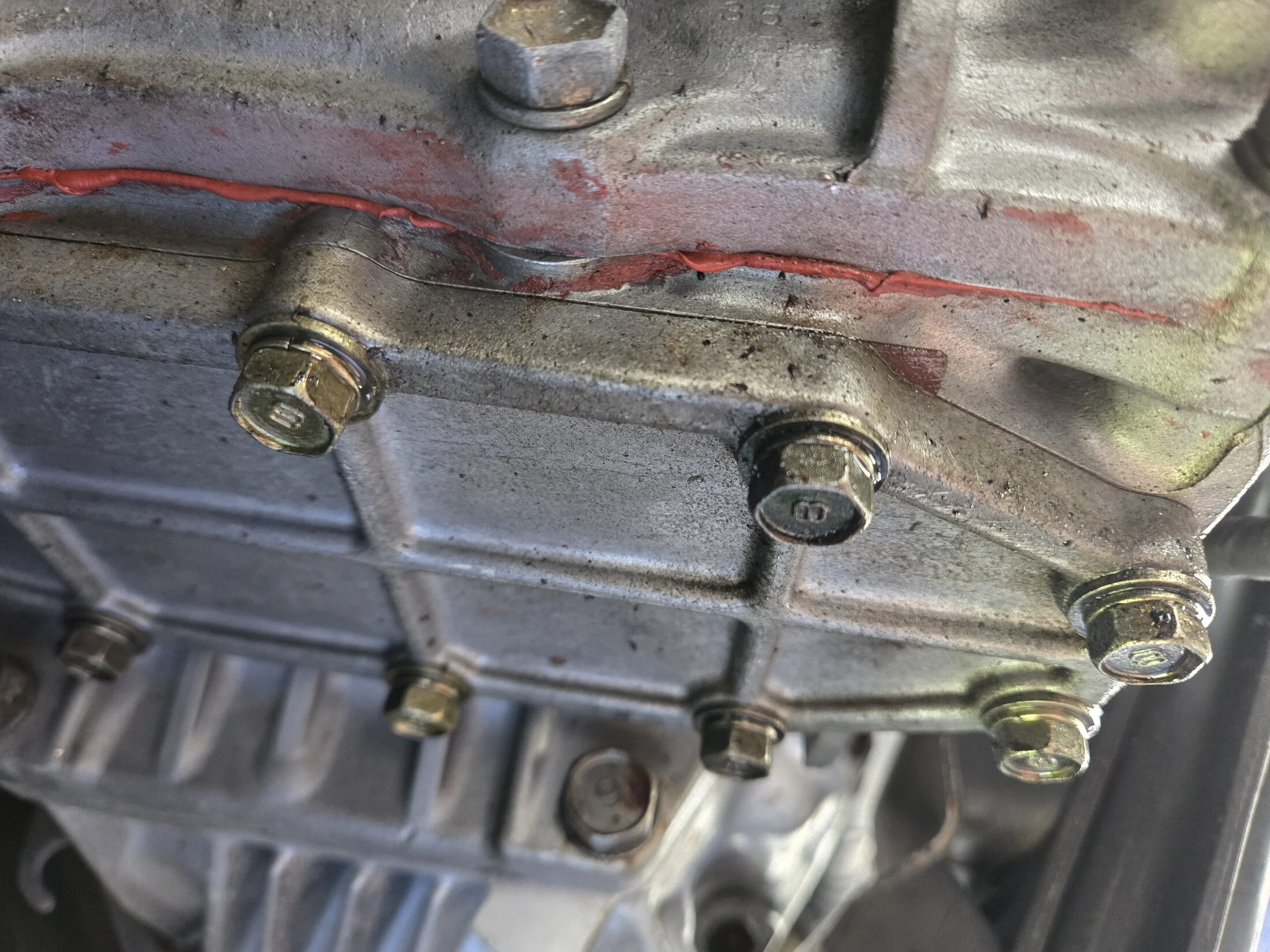

Doing an inspection around the rest of the truck, I found some light colored oil dripping from the transfer case. It's looking like the paper gasket might be leaking. I'm going to clean it off and see if I can locate it. I'll use a flashlight and look for some some at night. That might help to locate it.

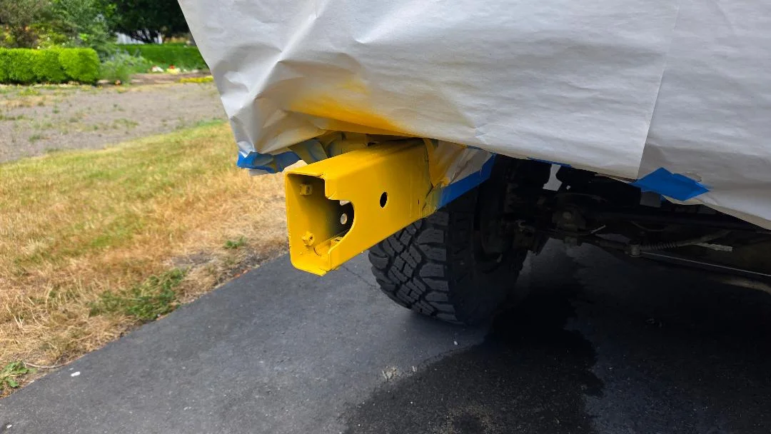

Summer is a time in the northwest to paint parts. With humidity down to a much more reasonable 25%, painting in a day or two with primer is a real treat. That means I can pull off parts, rebuild, and have them back on the truck within a few days. My goal for the rest of the summer is to get everything on the undercarriage done leaving me with all interior mods (Seat brackets, window runs, stereo upgrade, roof sound deadening, winch, lights etc) for the winter.

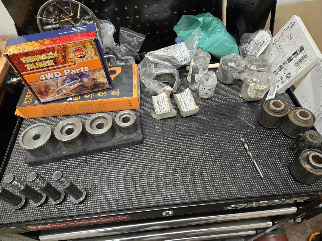

For the undercarriage, I am starting with the bushings. Ordered up all the necessary parts from cruiserparts (great shop to work with, fantastic support before and after purchases) and got the stereotypical Harbor Freight 20 ton press. I also got Trail Tailors bushing press kit, I highly recommend it, made everything go a lot faster.

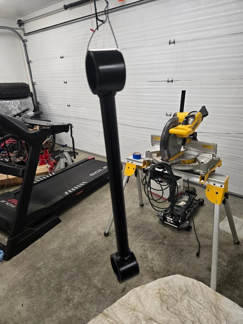

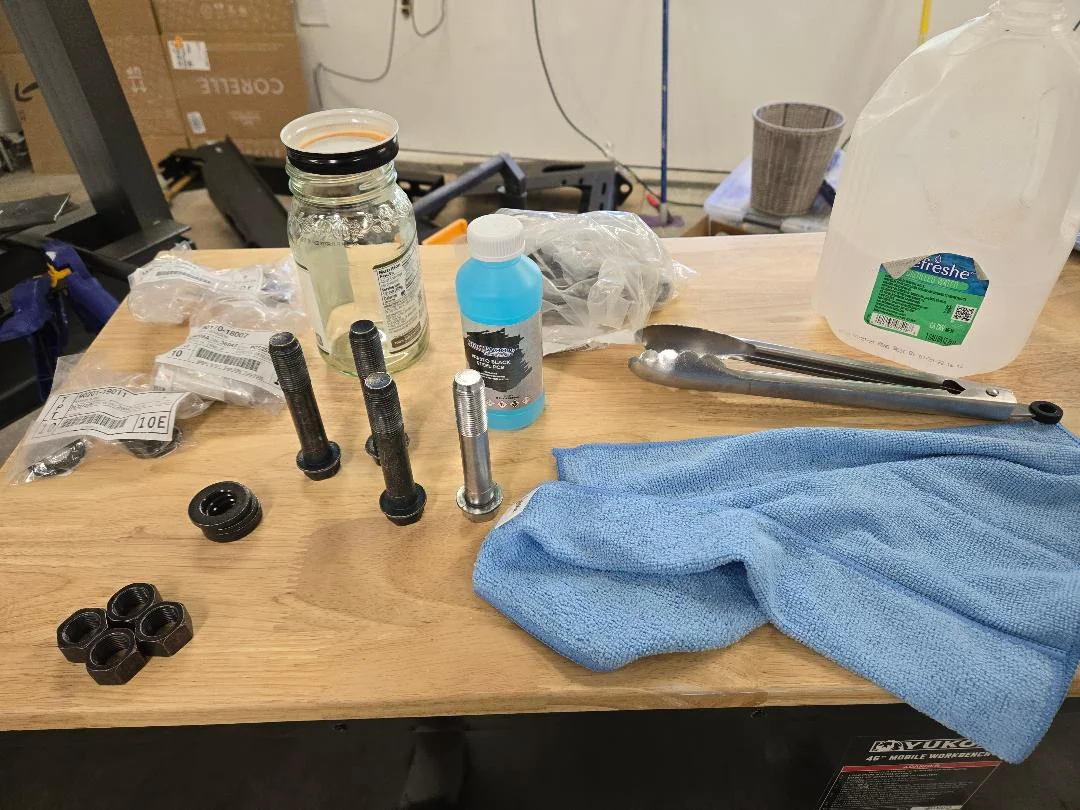

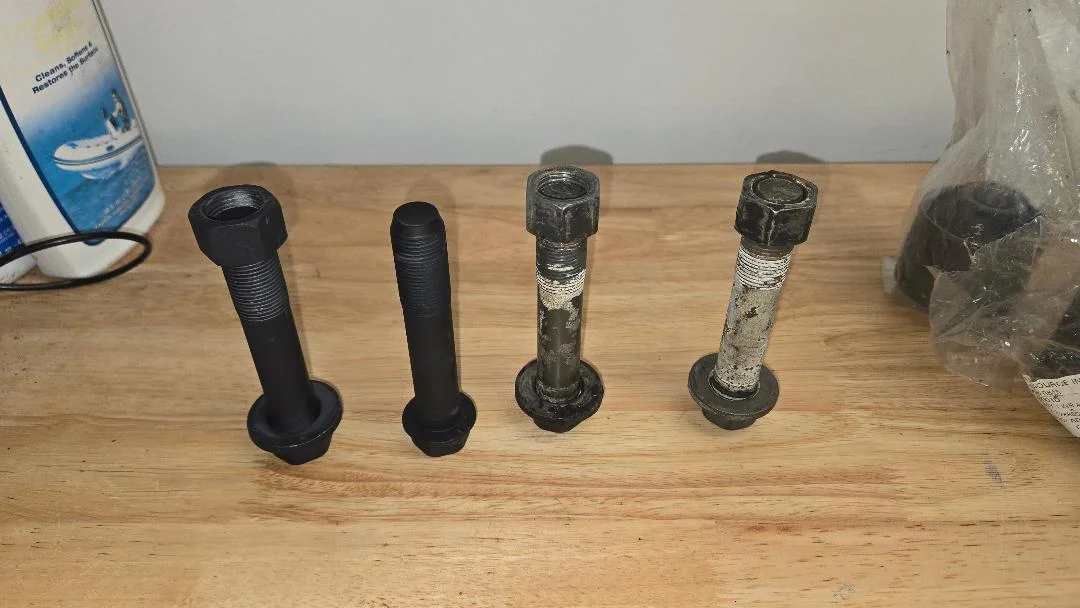

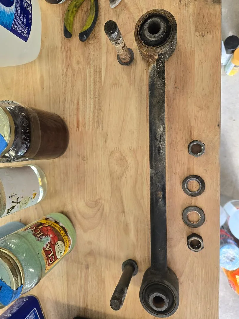

The bolts were worn, and while I am sure they were fine I went ahead and followed the FSM and replaced them. At the same time, I took the new bolts and tried a new anti corrosion technique for me; black oxide. I’ve wanted to do something about the recent rust that has started showing up on my truck. I’ve got some good $$ and a lot of time and some good memories in this rig and it would be a shame for it to start having rust issues in 5 or 10 years.
The black oxide worked pretty well but you had to be very thorough in your assembly line like treatment. ANY left over soap or oil would distort the finish.
After doing a couple sets a few of the bolts immediately got surface rust/flashing. Tried a specific finishing oil for black oxide parts and while it helped, it missed on a few parts. So I decided to up the anti-corrosion properties and had a shop cerakote all my fasteners. They blasted them and cerakoted in a satin black that matches very well. I also did the fasteners for some interior panels, brake parts, rear tie downs, and other bolts. All it all it was the best $300 s I spent for just time alone let alone the durability properties. I ended up doing over 60 parts and fasteners done because it was cheaper to do them in batches.

After the upper control arms were done, I moved on to the lower control arms. Those were a little bit easier but I had to jack up the truck higher and use straps to pull the rear axle forward a bit. This video helped me quite a bit: Timmy the Toolman Lower Control Arm Bushing replacement

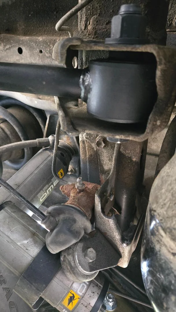

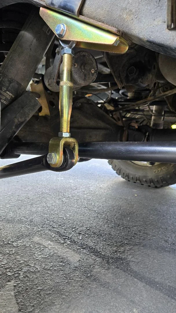

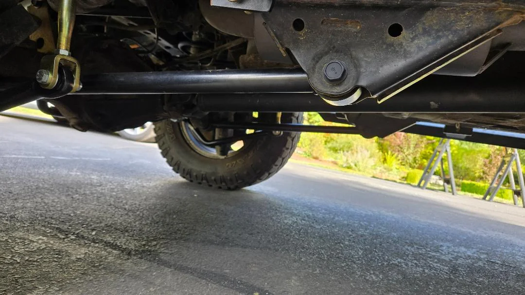

Spent a couple weekends here and there doing some more work on Nola. I had already replaced the upper and lower control arm bushings, next up was rear pan hard and installing Land Cruiser Phil's upgraded Heavy Duty Sway Bar Links and Whiteline rear sway bar. The Whiteline bar and heavy duty links really tightened up the rear end. Felt 20% better on the road with near zero rear end wiggle. Truck was a lot smoother on the highway as well.
Also put new cerakote coated fasteners on each suspension component. Really glad I did this extra step as the old fasteners were pretty corroded. I am going to keep this truck forever and it would be a shame to have things rust up and rot away over the next 25 years.
I did have to shave away part of the LSVP bracket to get the bolt back in. Someone before me had already bent it over but I couldn't quite get the bolt in without hammering on the end. LSVP is pretty rusted, might end of rebuilding that with new parts once I get going on the hubs, rotors and calipers. Might as well. I have to bleed the system anyway.

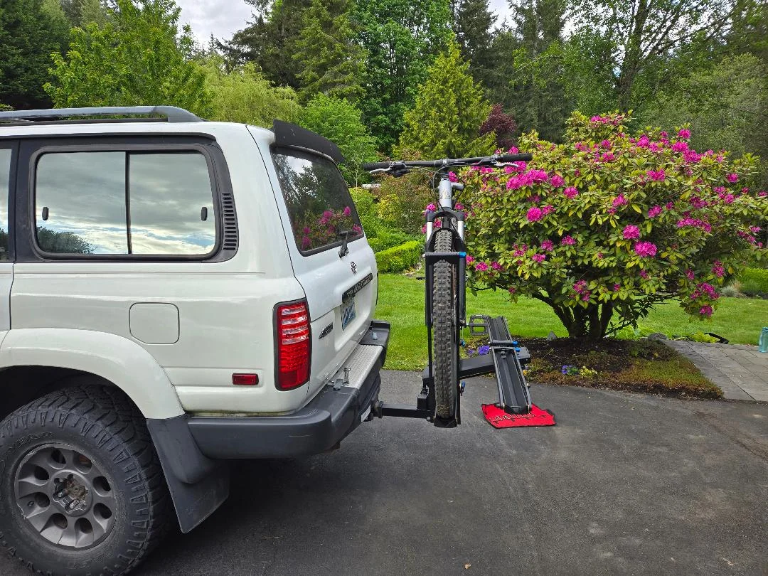

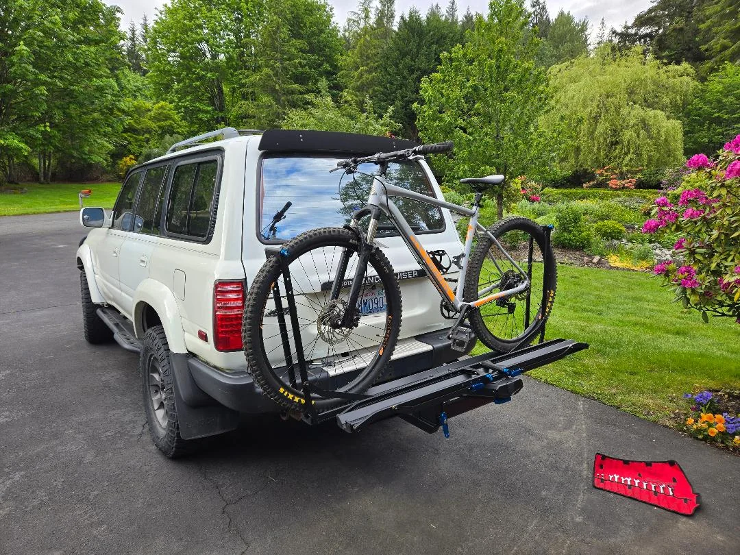

Also installed my new bike rack. Ended up with Rockymount Afterparty after using a Labor Day weekend 20% coupon off on Backcountry.com. Glad I did because steel prices are about to start climbing again. Really happy with this bike rack, I looked at the one up but for less money I got a rack that has an integrated locking system on the hitch and the bike and it swings all the way out from the truck so I can still use my tail gate for prepping for rides. I highly recommend this bike rack.

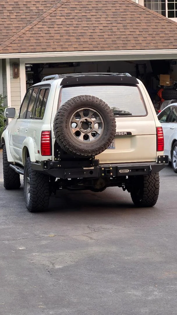

Got another upgrade done on the cruiser this last month. Finally got around to installing the rear dissent bumper. Man what a superb product; super tight tolerances, great fit and looks great. The only critique I have is that I wish the trailer pin had a bit more room behind it so I could put in a locking pin. If anyone knows of a pin that has lock that can fit please let me know.

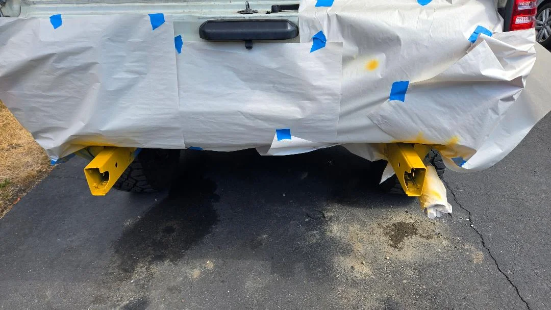

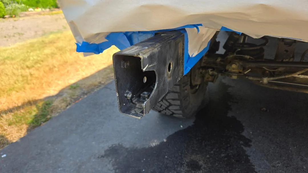

Took my time with the chassis and carefully cut away all the frame pieces and then used a flap disc to grind down the welds and tag ends, came out super clean. Also, primed and painted the frame. Came together pretty well but wish I had a second set of hands to help with aligning the corner/wings. Heavy and not easy to balance by oneself. And I still have to hook up the 7 pin harness and the license plate locator.

Did run into one issue; one of the blocking plates for light cutouts didn’t fit. At first I thought it was me (it usually is) and I just wasn’t aligning it correctly. Then I got a bit smarter and tried to mount it from the outside but that didn't work. Odd since the first plate was no problem. So I assumed that the plate was off by a bit. Contacted Dissent by email and got fantastic service and reply within 24 hours. Really top notch response time and they were very thorough even asking for me to send some pictures to make sure they understood the issue. Dissent sent a new plate to me asap.
Got the new plate, but it too didn’t fit. Then it dawned on me, it wasn’t that the plate was off, it was the mounting inserts in the bumper. To solve this, I am going to have to round out one of the holes and get some stainless locking washers and nuts to keep it in place since the hole will be too big enough to keep the plate from falling off the back without nuts.

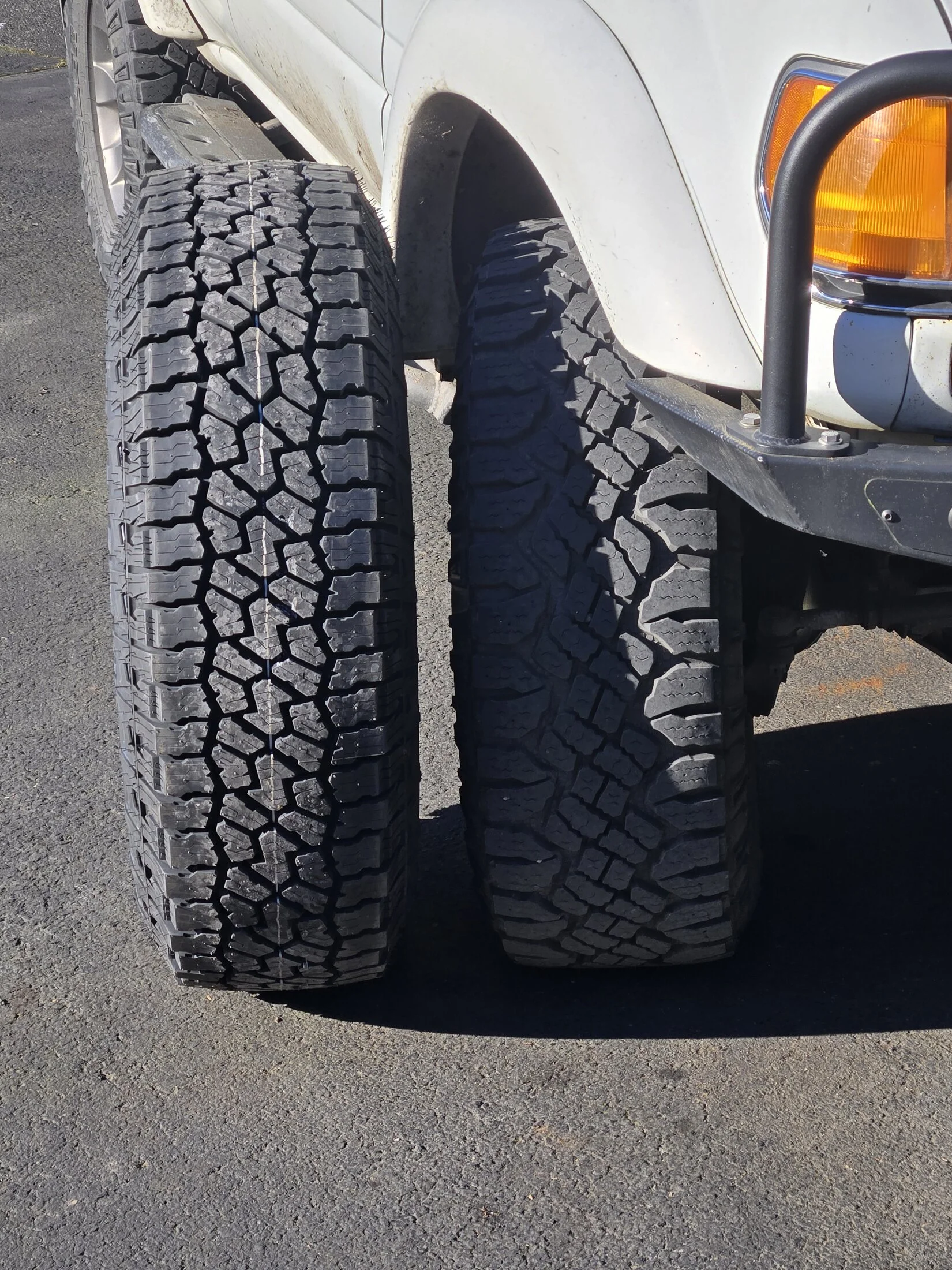

Been able to get some miles on the new wheels and tires. The RRW wheels and Falken ATW4 tires have made notable differences in the truck. Tires are a true 35 inch weighing 68 lbs and wheels come in at 26 lbs so unsprung weight is only 10 more lbs than my last set up and I don't feel any loss in power transfer. Body roll is less; I am guessing due to the stiffer side walls on the new tires. Traction in the rain is excellent even with all the torque I've got, looking forward to trying it the snow.
Tires are quieter on the freeway but tough to tell how much as I mostly hear my diesel engine particularly at higher RPMs. Prior to the new taller tires I was running 285/70/17 which came out 32.7 inches and at 70 MPH the motor would run at about 2,900 RPMs. With the new 35s my RPMs are now 2,600 at 70 mph all GPS verified. In the future, I will be looking at a Transfer Case overdrive mod to get this down a little further. All this really helps when going up longer grades and running freeway speeds. Boost comes on super fast so having more RPM band makes it easier to get more air and fuel in. It also means no downshifting. Blip of the throttle and I am up and going with no lag.
