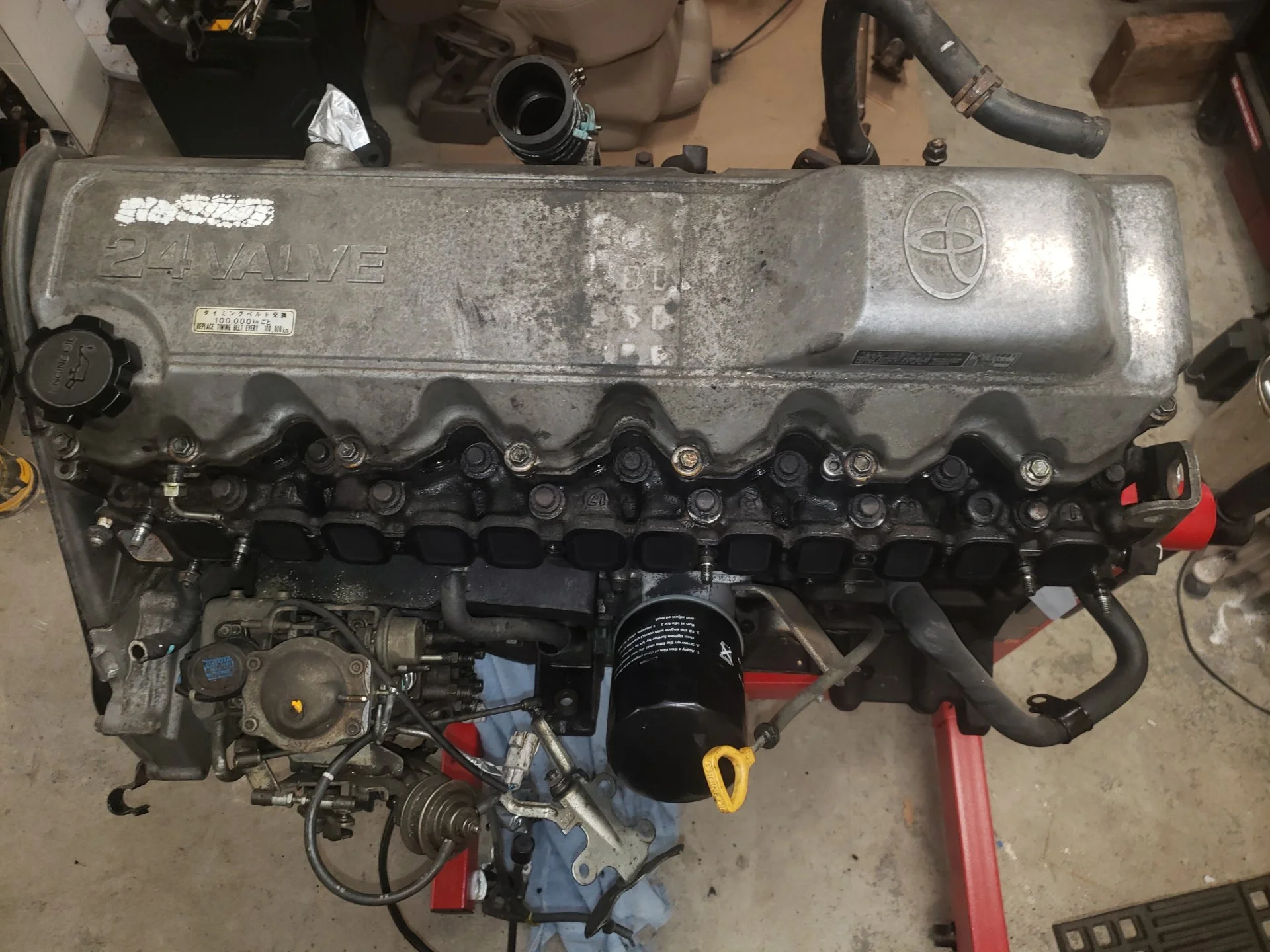

Thanks! I have a plethora of desire, some good space and not too much time.Awesome that you have the time, space and desire to dig into the engine yourself. So many things I'd like to get into myself, but I just don't have the time or space (sometimes also finances). I haven't driven a gas 80 before, but I love my diesel. However, I wouldn't call it fast even with all the upgrades I've done. Looking forward to seeing how you progress with it and your before and after thoughts![]()

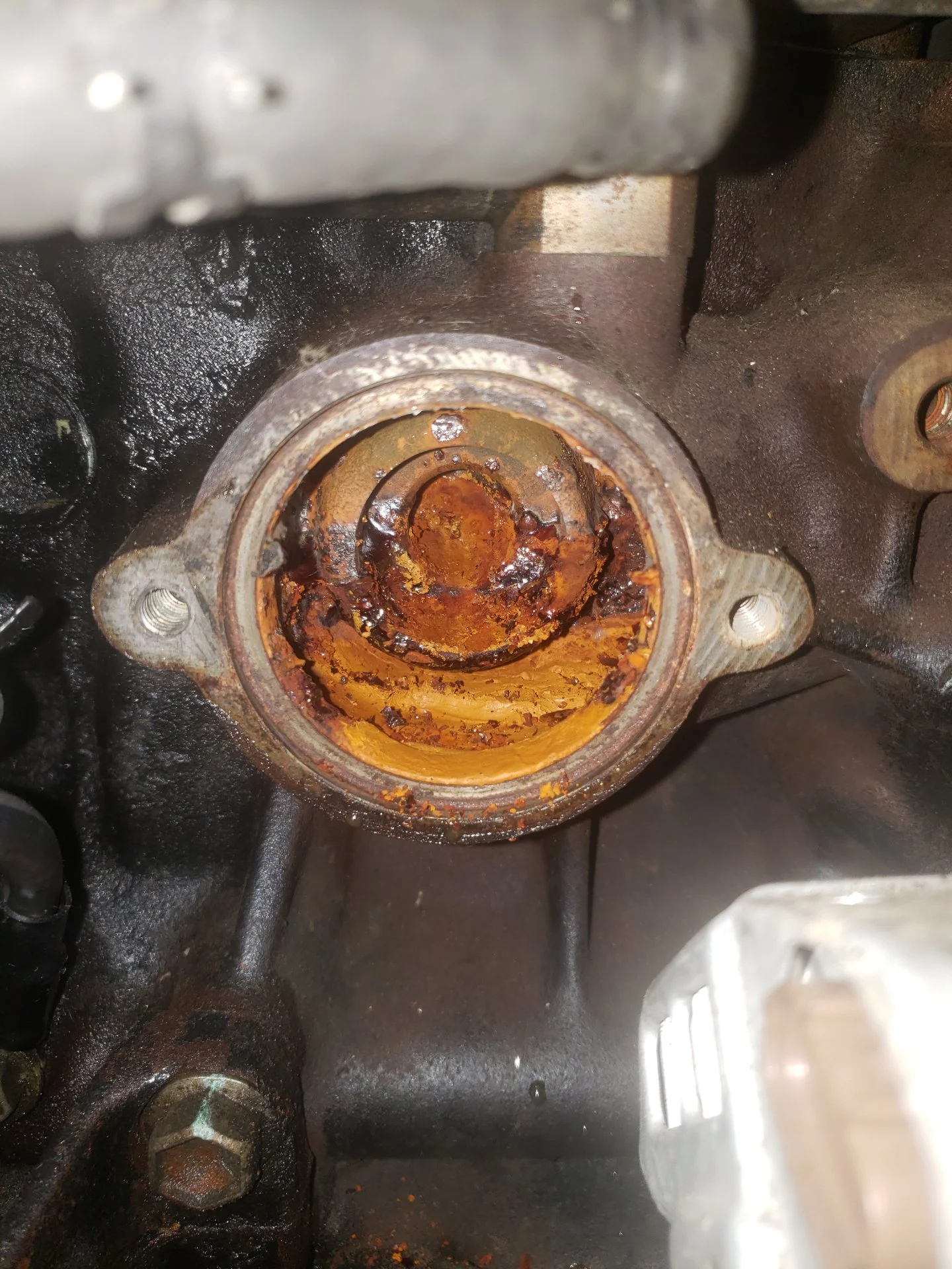

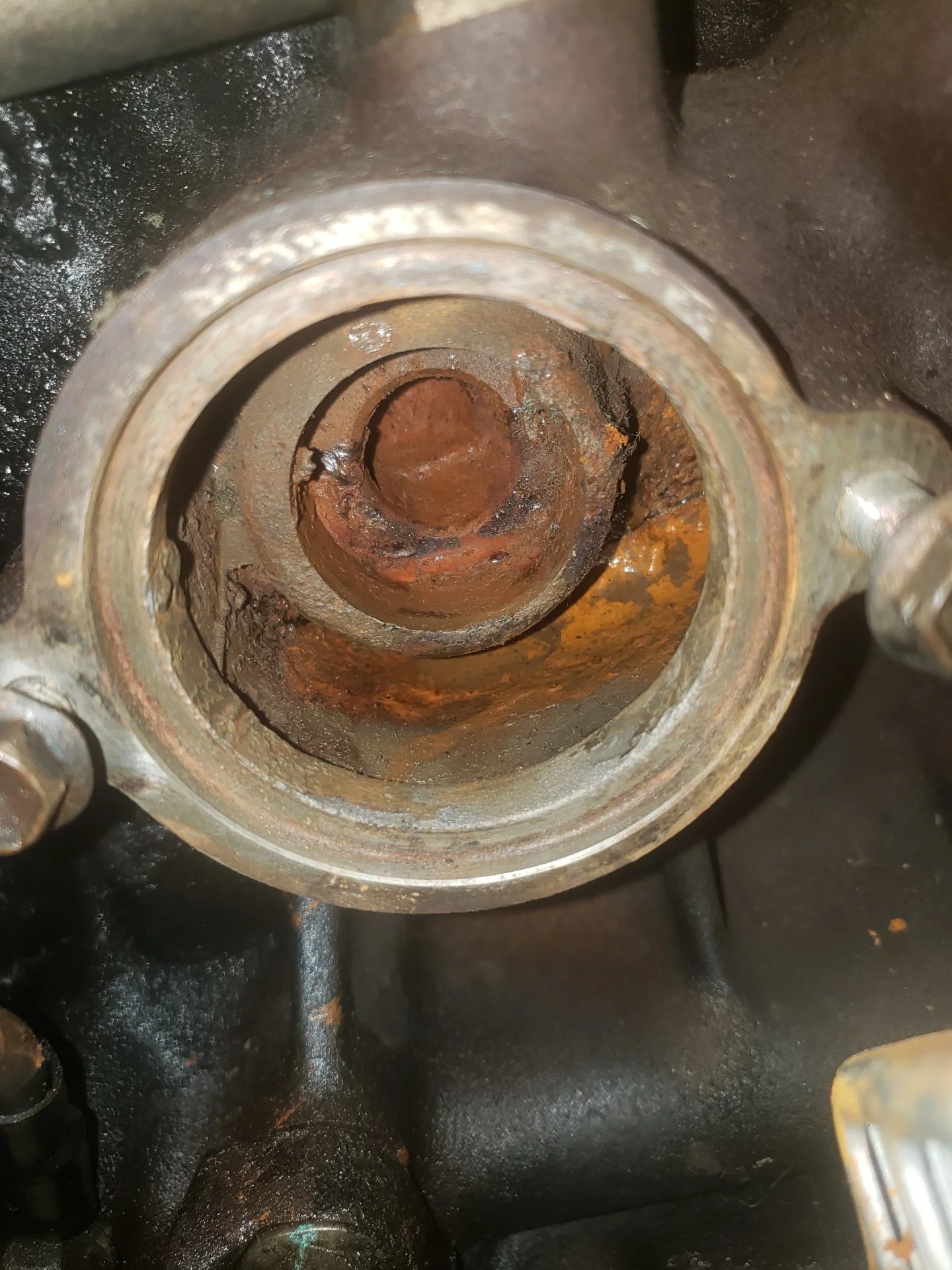

Yeah I'm hoping with a little work I'll be able to clean out the passages pretty well. Might even try a skinny brush on a drill. I too ordered all new aluminum coolant pipes actually by following your threadDang man! those are some REALLY nasty looking coolant passages. I did replace all the aluminum coolant passage pipes on mine as they were corroded and replacing them was fairly cheap insurance over a costly leak. I can't remember if the inside of the block looked that bad, maybe it did.

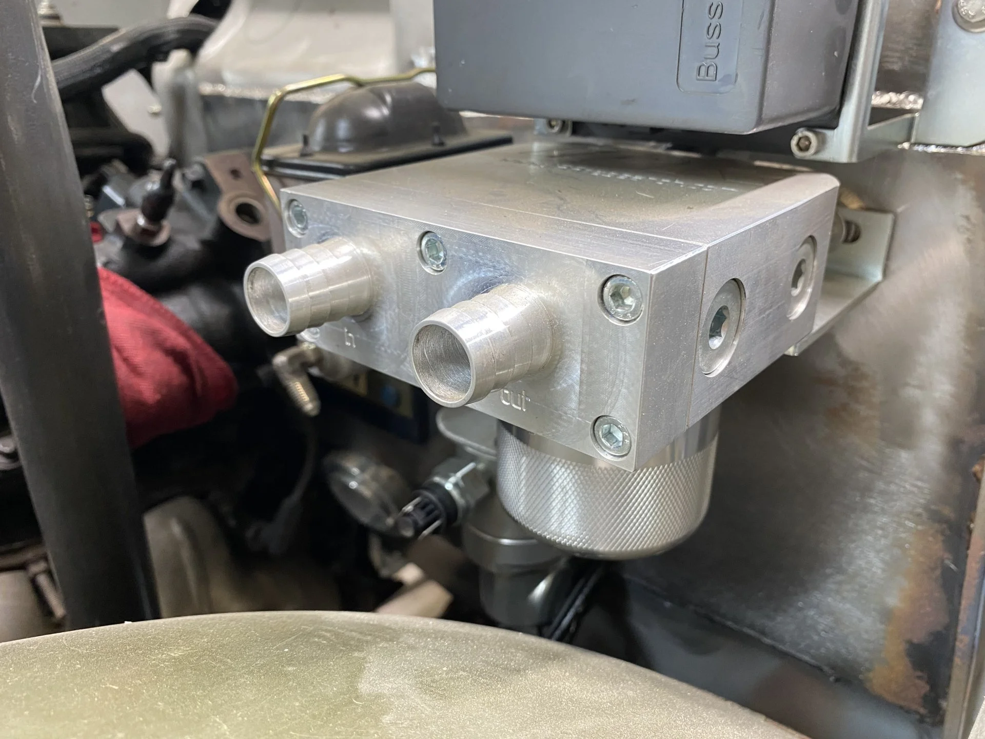

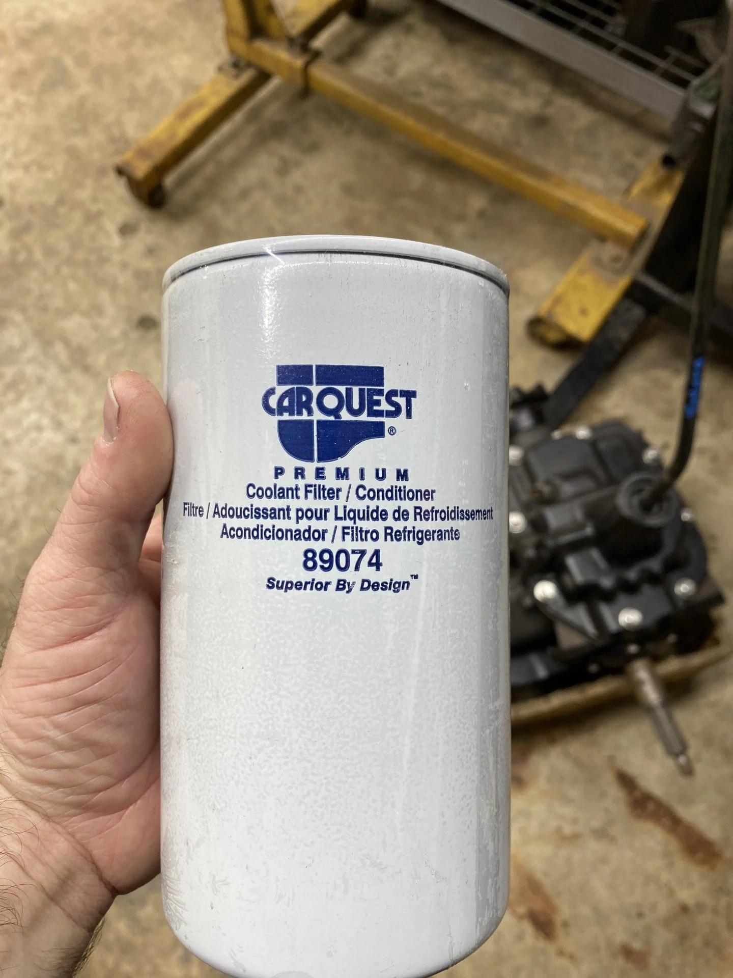

If it was me, I would definitely install a coolant filter as ALL kinds of junk is going to start coming out of that motor when you run it. I mean, it is going to be really gross. After multiple coolant changes, filter changes and nearly 70,000 miles, almost nothing is getting caught in my filter. However, I'm still considering doing an LC9 flush to really clean it out.

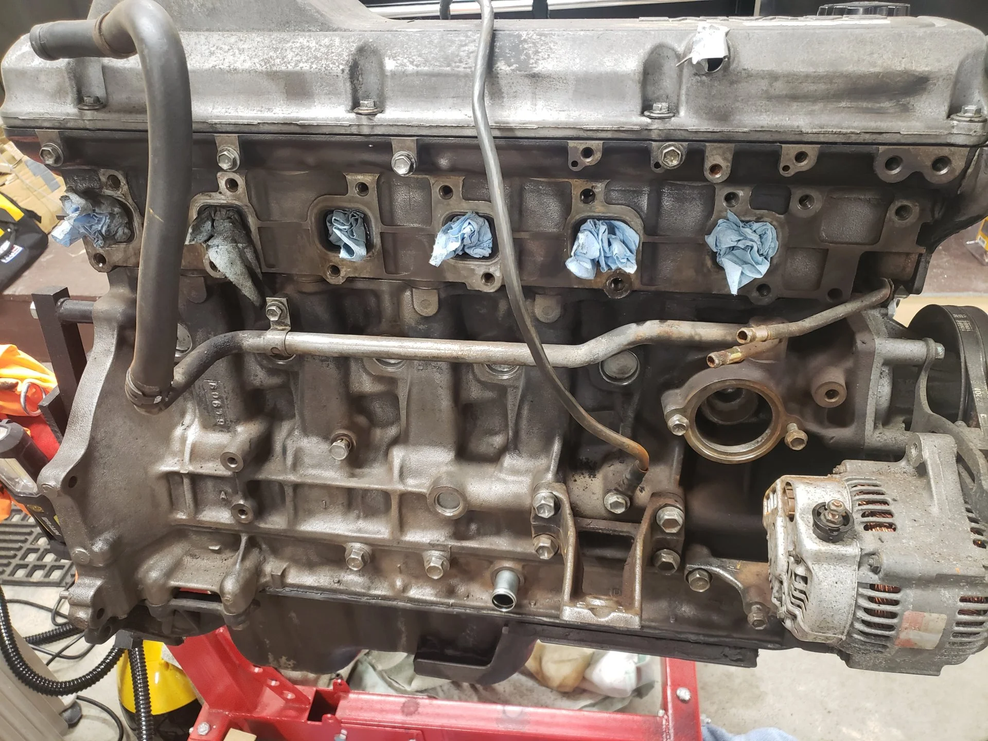

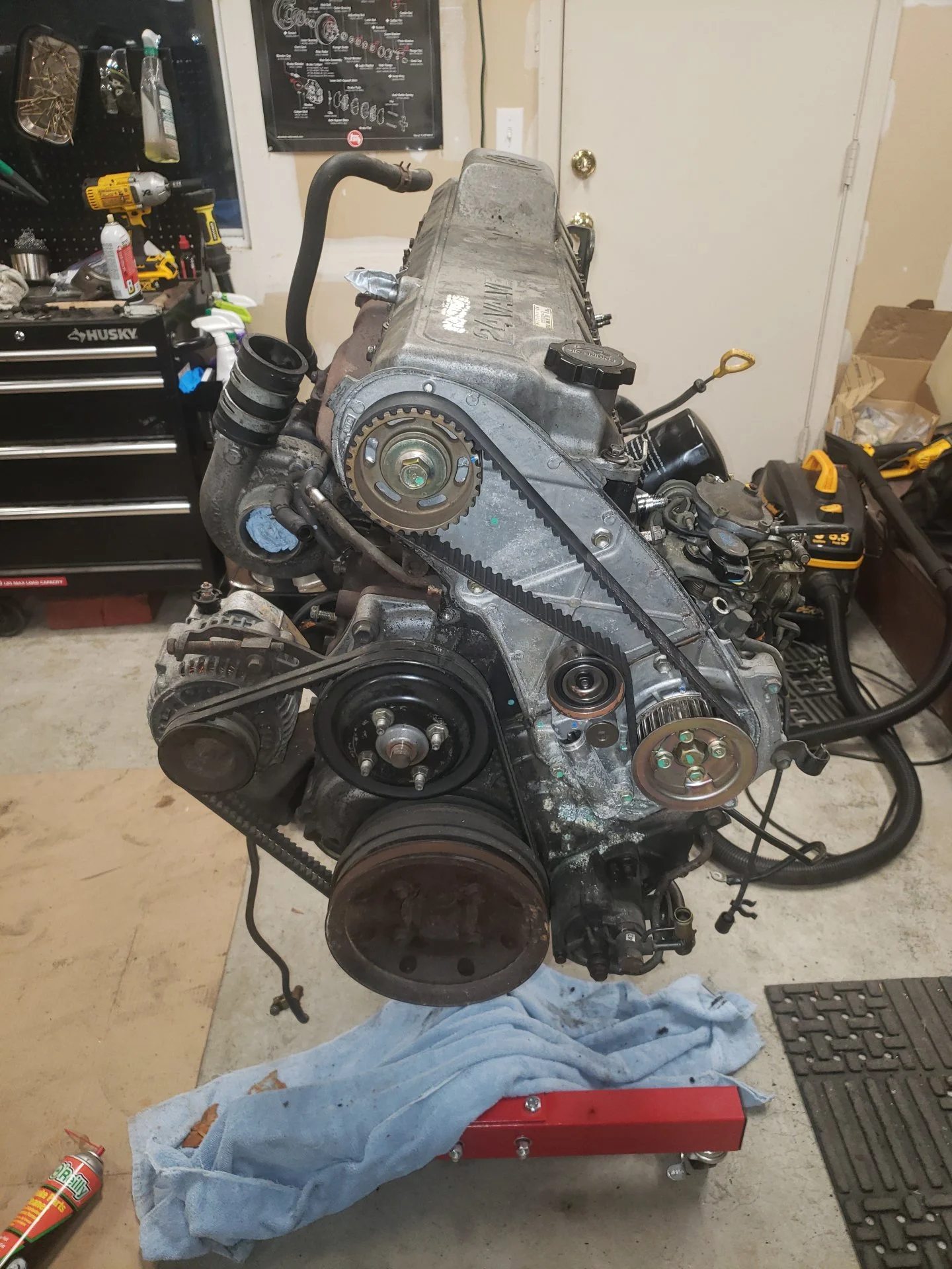

Good idea, its a 1.5 ton stand but next time I'll have a better stand. I'll see if I can find one locally here too.I would consider a better engine stand. One with two lower arms. Not a single arm that Tees at the end. Gets dicey.

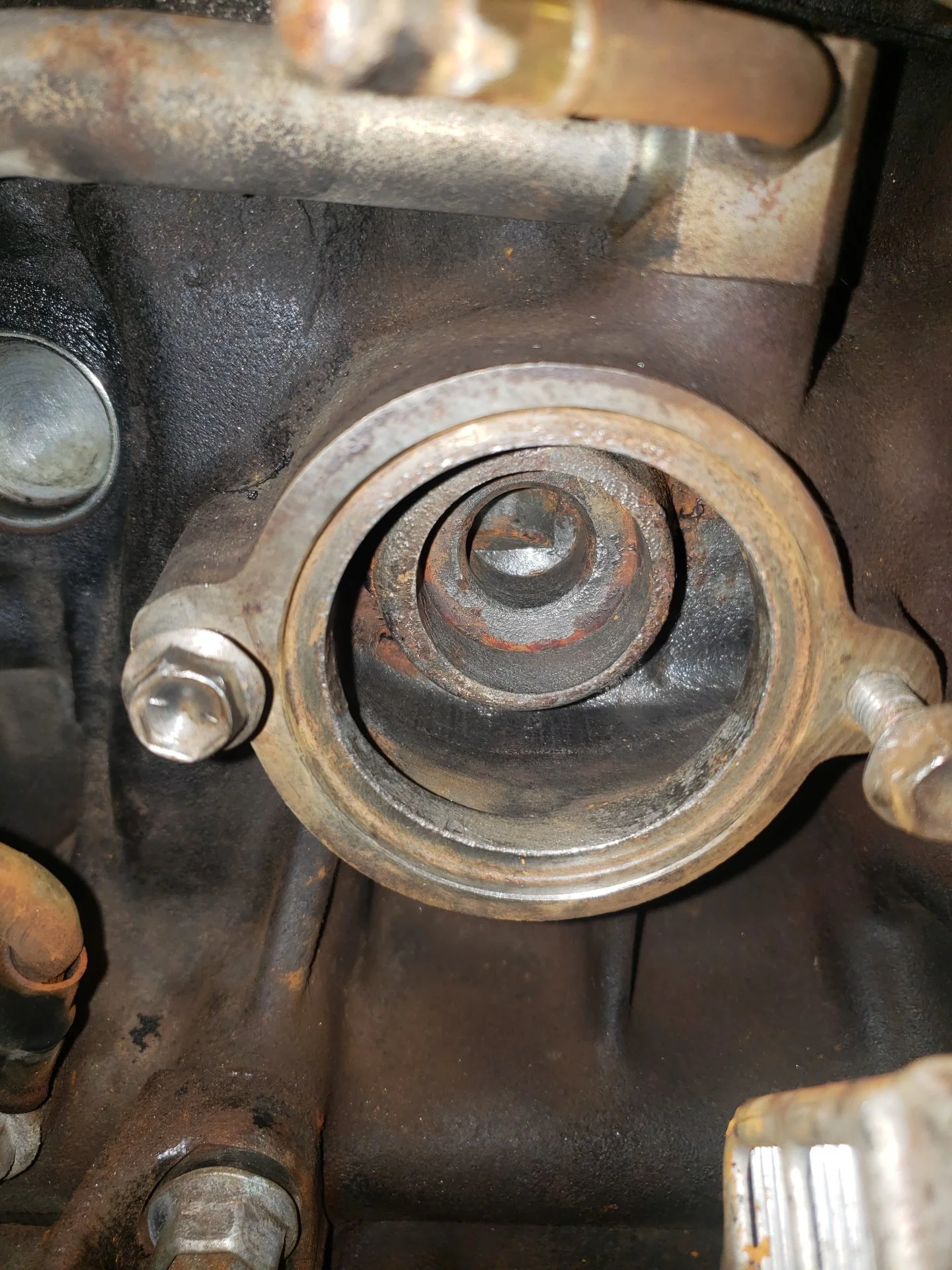

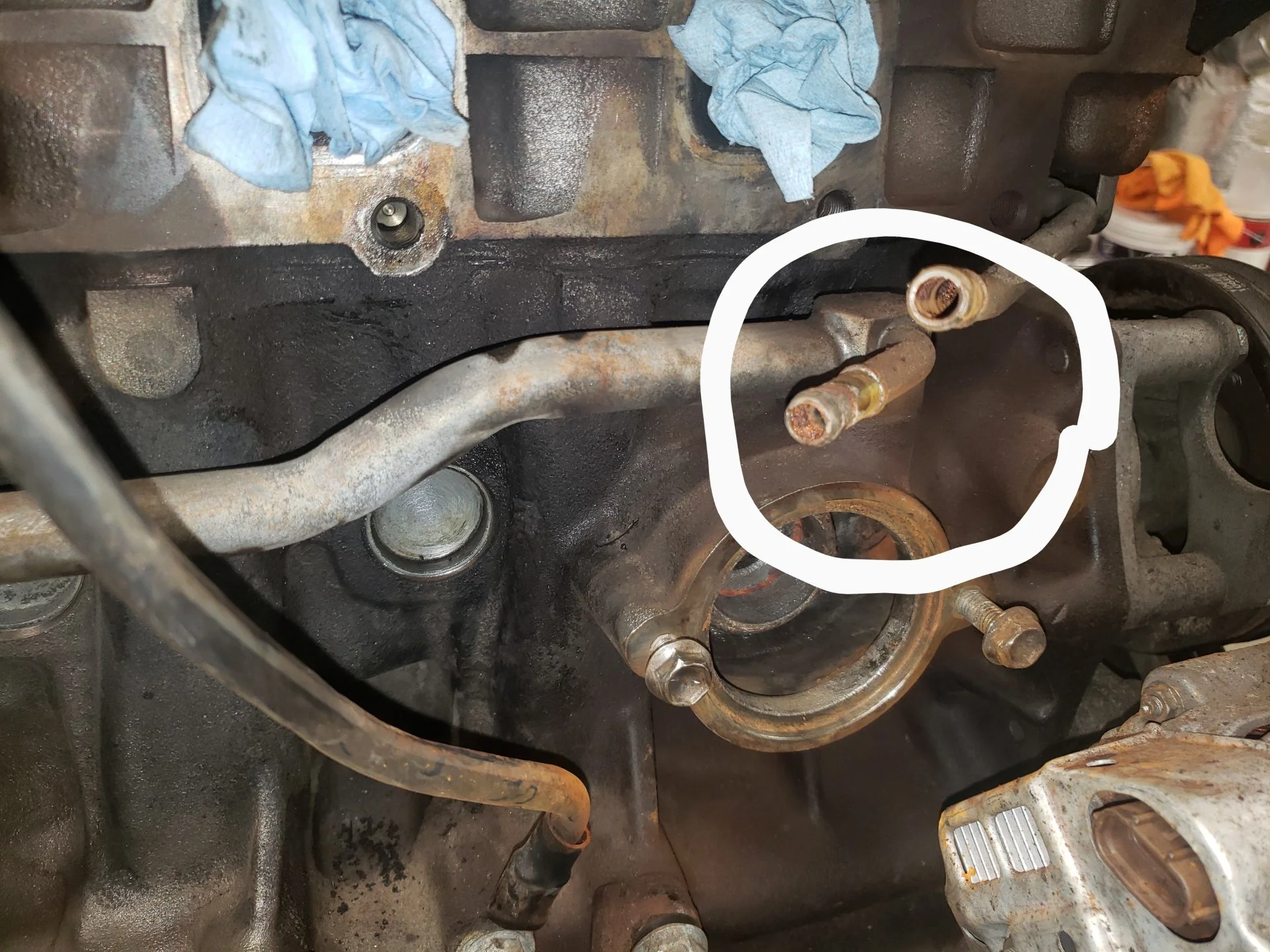

Oh, and can someone tell me how to remove the largest coolant pipe circled below? It's the one that is threaded into the block. I couldn't find it in the 1HD-FT manual.
Gotcha, found the part number for it.....16268-17020.I believe that fitting is a press fit into the block. I didn’t swap mine out
Aha! By searching all of 'mud I found the answer regarding removal and install of the pipe. Thanks @serenityGotcha, found the part number for it.....16268-17020.
So if I remember right you painted your block correct? Did you tape over this pipe?

I did paint the engine, I just taped over the portion of the pipe that the hose clamps on. My fitting was is decent shape or I would have swapped it.Gotcha, found the part number for it.....16268-17020.
