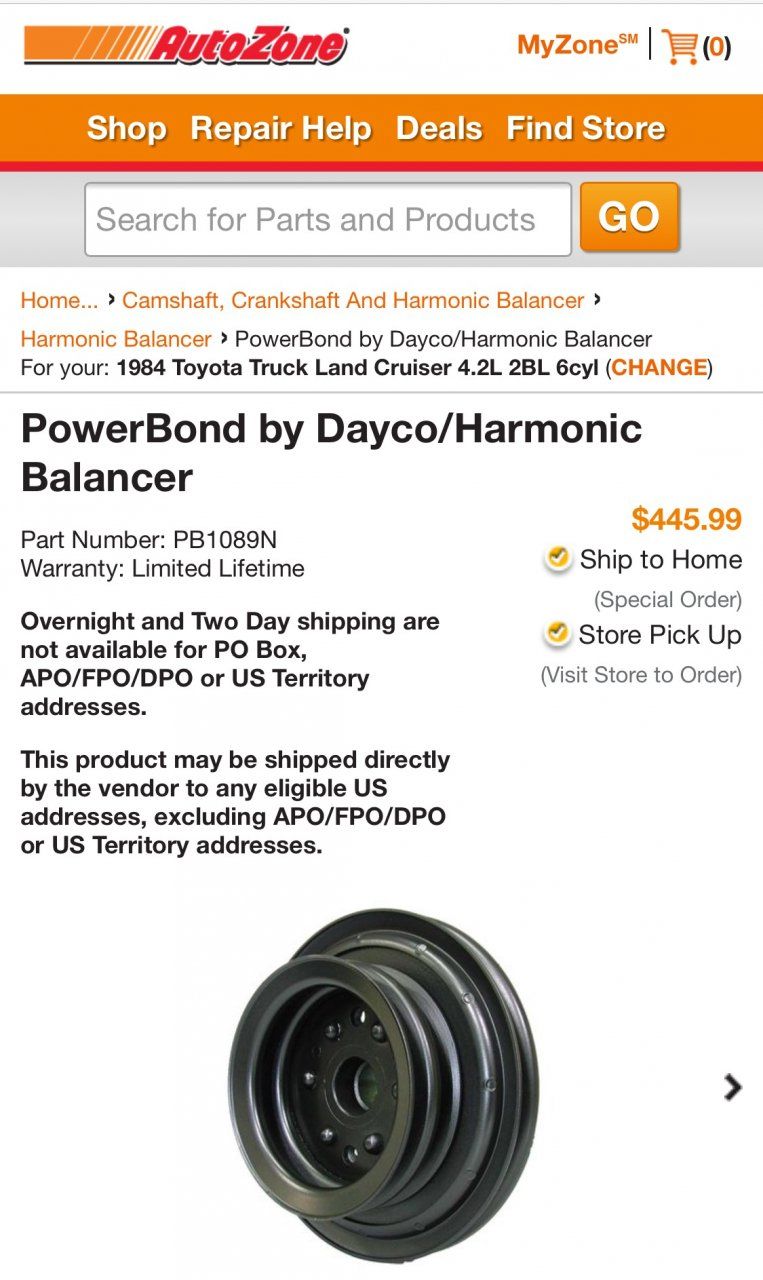

Also Autozone sells an aftermarket HB for your cruiser. I know nothing about any of these suggestions. I just mined them for you on Google.

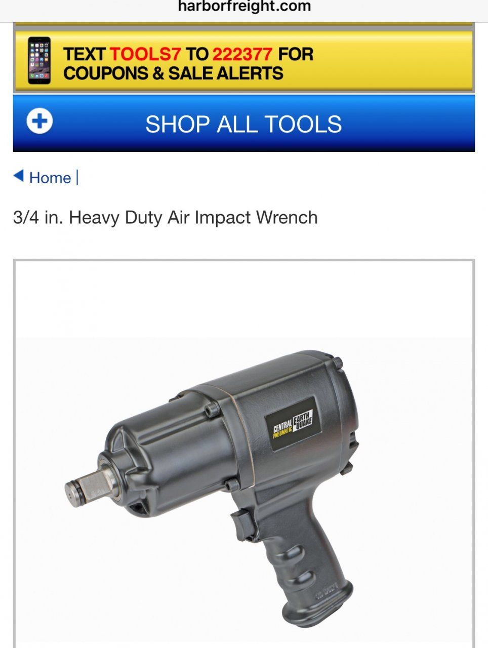

I bet my HF 1/2" impact would yank that out no problem. I have yet to see a crank bolt stand up to it.

Btw, who the s*** spends 450 dollars on a crank pulley!? That is a chunk of a repower right there...
