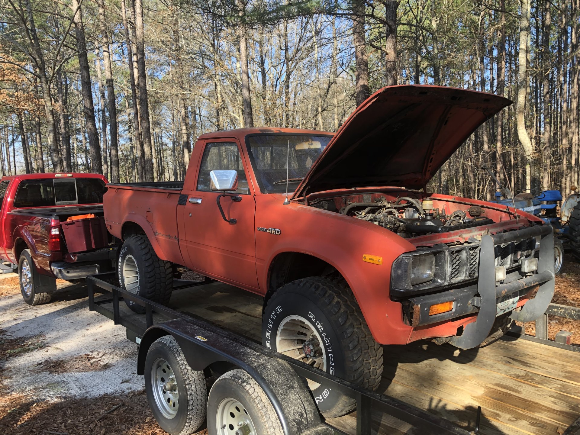

Some parts arrived...
Today my son is coming over to help me remove all smog equipment and install the weber 32/36 with spiral adapter and a fuel regulator.
Also we will be installing the block plates that I ordered, and fabricating the ones I should have ordered but didnt.
Im gonna go ahead and wish myself luck at this point, and report back later today once we get going...
Ok, sorta lost track of time, my son and I were busy all day...
Boom!
First was tearing out all the emissions crap, a little frightening for sure and about 20% into it I started to second guess if I was doing the right thing. There is a lot going on with the smog equipment, this milk crate full of parts is what was removed today...
After that was done I made some plates to block some holes on the exhaust manifold...not quite as refined as the ones from lc, but they will get the job done.
Installing the spiral plate and the weber was fairly straightforward...we did have to work at the throttle linkage a bit to get it to fit, instructions from weber were a bit vague. Air cleaner went right on.
We then mounted the fuel regulator, and ran new fuel line configuration. The fuel filter was replaced as well...
I didnt have the plugs for the manifold so I just used some vacuum caps to get by until I can remove the vacuum valves,bvsv etc. and install plugs.
Set the fuel regulator at 2.5 lbs
I ran a single vacuum line from distributor to the carb.
Double checked everything and then cranked it over, and over...and over... there is a longer fuel line and an empty fuel filter so a quick spray of starter fluid and it fired right up...I kept it running with the starter fluid for a few seconds as the filter filled up and then it started running on gasoline.
And it ran great!
Lets remember that when I drove it home it only had 3 exhaust manifold nuts (of which one was totally stripped out causing a huge leak) and a clothespin holding open the butterfly valve in the carb...it barely ran
I cant believe how good it runs now, we took a quick test drive and is has a lot more power than before...I have not tuned it yet, just running on the factory settings
