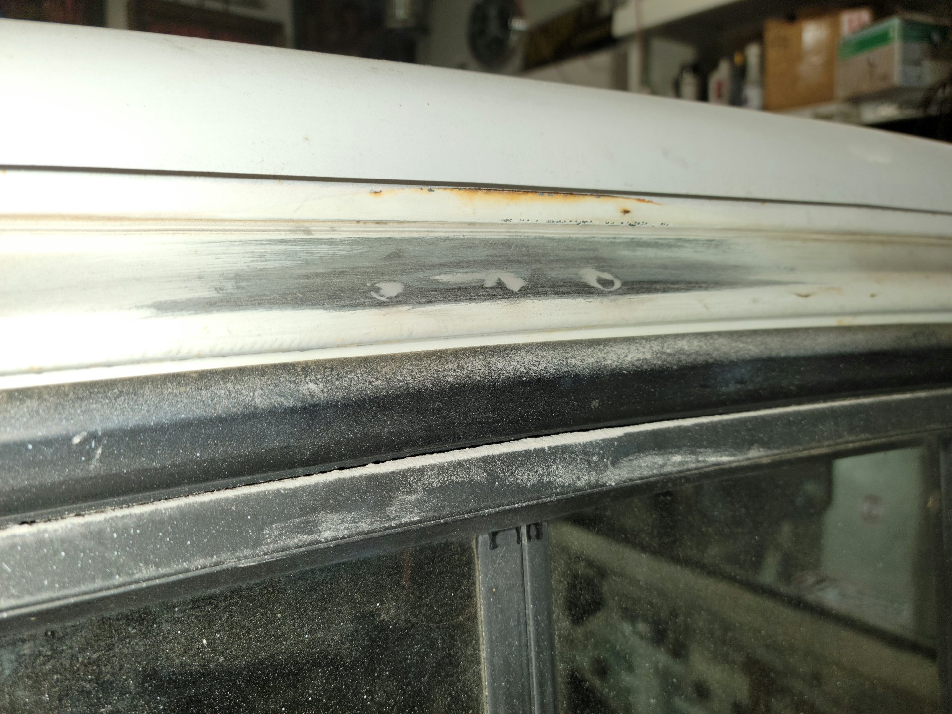

Next up, before headliner goes in, will be welding a few holes in the roof shut, someone drilled a hole in the center for a long gone CB antenna and 3 holes in the rear for a 3rd brake light.

We got the holes in the cab welded up and the first round of bondo applied.

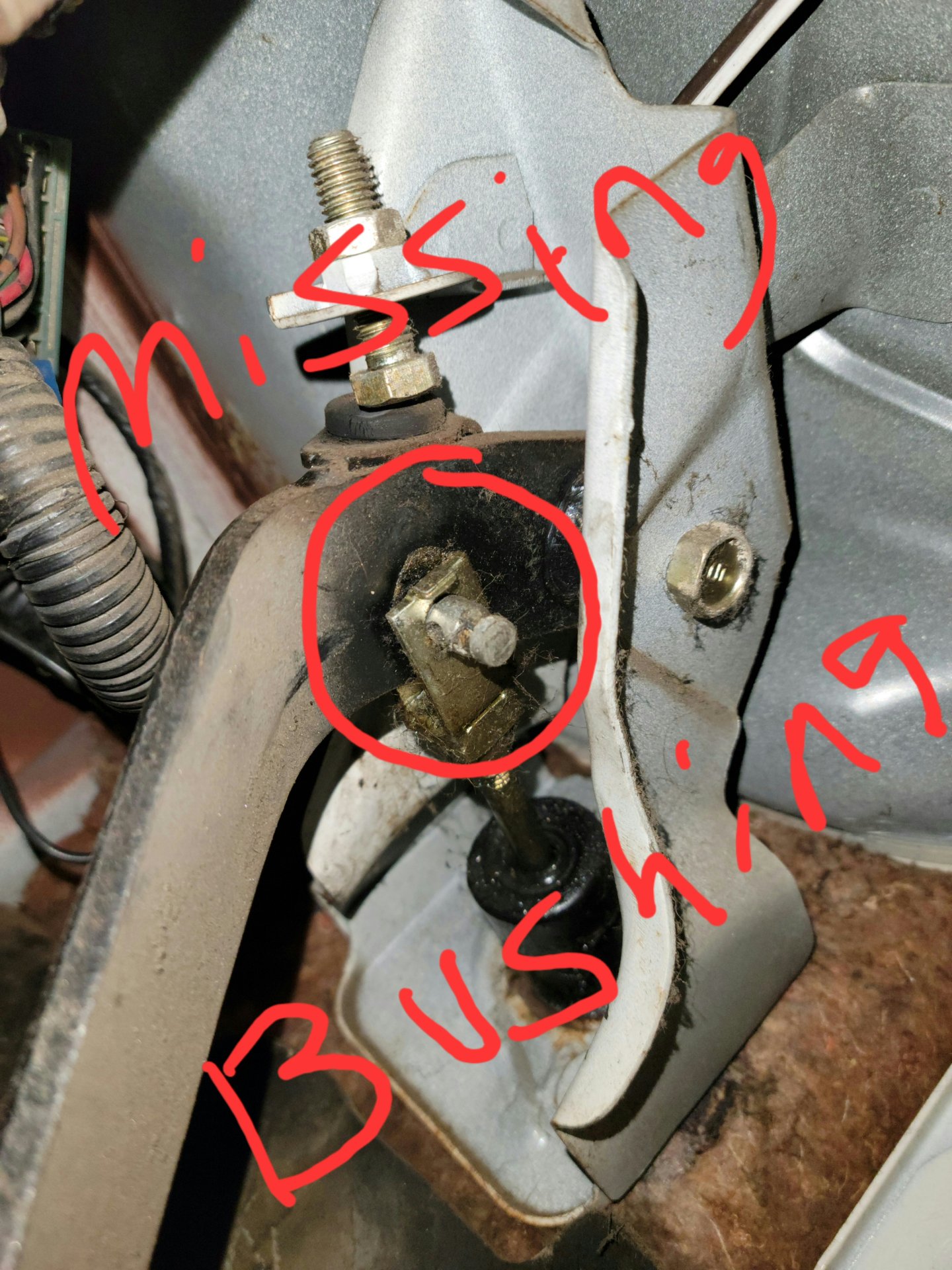

Had the squeaky, creaky clutch sound. Doing a bit of research I found it to be a common occurrence. I dis-assembled the cluch pedal, cleaned the bushings, rod, bolt and pedal itself in the ultra sonic cleaner...
During reassembly I noted the the smaller bushing for the clutch plunger was missing, I think this was the cause of the noise.
A new bushing is on order...

My ‘83 2wd 4 speed manual had a squeaky clutch and it turned out the be the slave cylinder. Just something to check, in case your bushing doesn’t take care of it.
I'll take a look, thanks.

Got the rest of the little details on the interior completed and installed the missing clutch pedal bushing. Time to start putting this girl back together.
