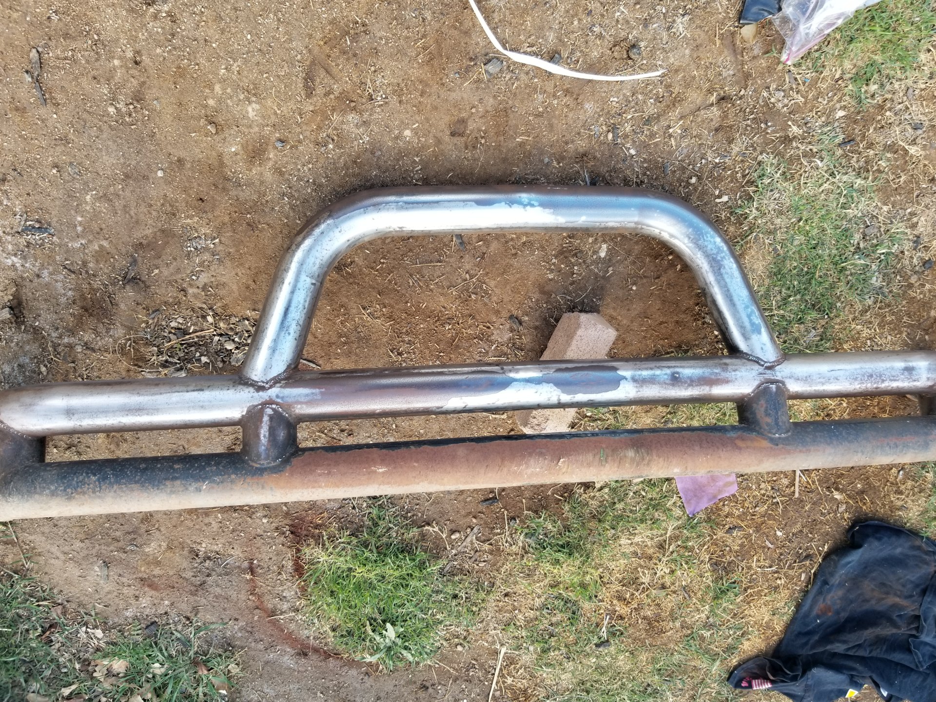

While waiting for the carb and other parts I started cleaning up the front bumper. There is a slight bit of rust pitting...but nothing too serious. It should look great once I finish preparing it and get some paint applied
