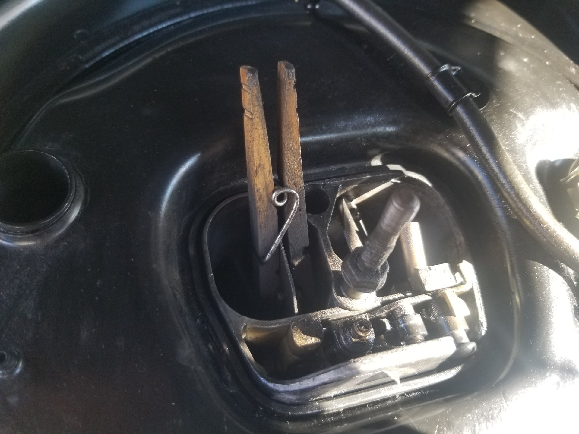

The seller told me the carb needs adjusted, but look at this pic I took after removing the air filter cover...yes, that is a wooden clothespin!

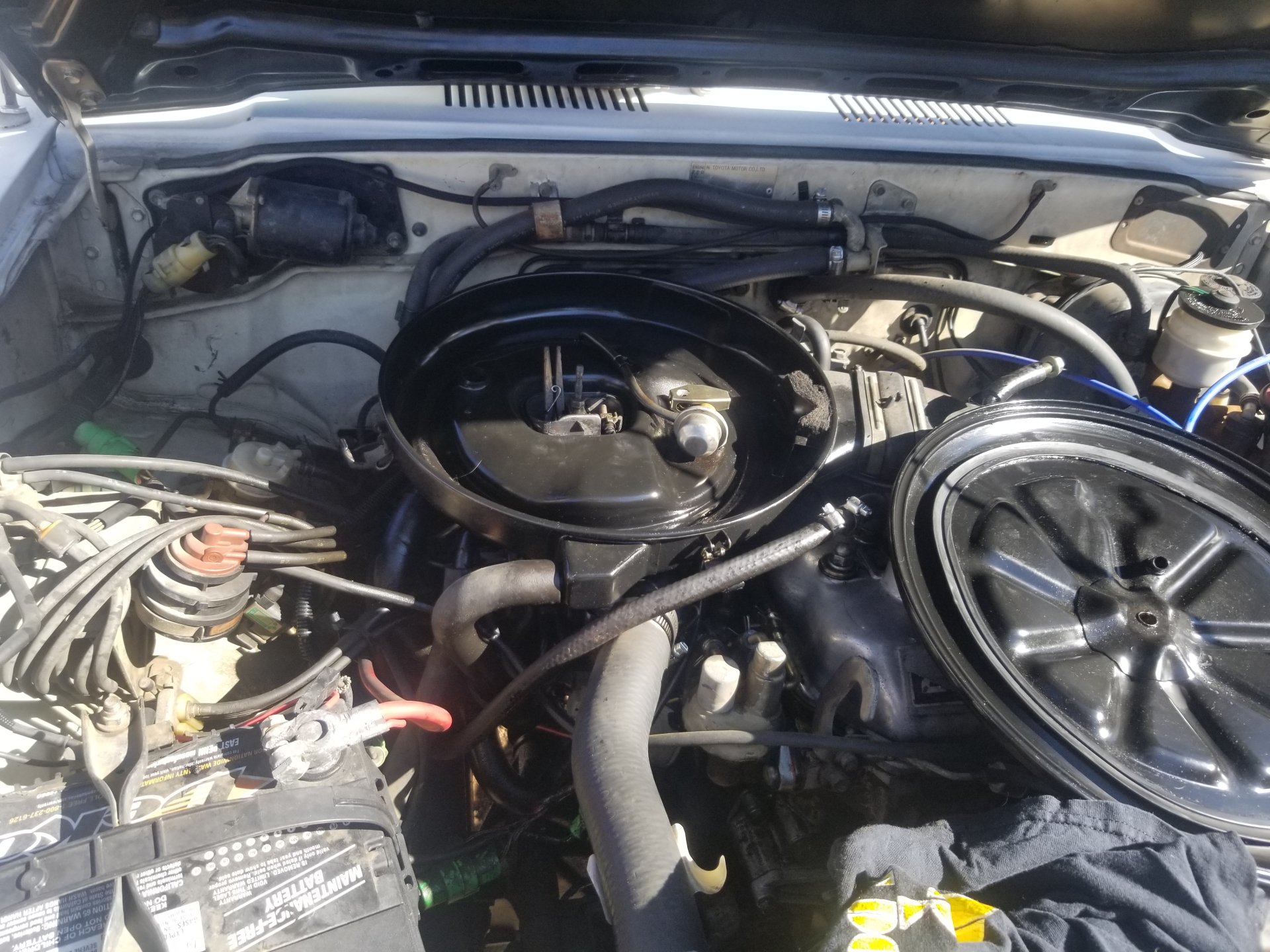

Speaking from experience, go and get a large roll of vacuum hose (you can't get the actual metric-sized hose Toyota used, and the size currently eludes me), and go one by one and replace every single piece of vacuum hose. All of it. Since you live in Kalifornia you'll have to keep the stock carb as you probably know. My other 82 with the stock carb (since sold) wouldn't idle and ran bad, after I replaced the hoses it was very much better. Idled smoothly and started easy.
I don't have an answer for the unique bit of engineering aka clothespin!

Anyways, underneath the air cleaner snorkel is a valve. That valve pulls hot air off the exhaust manifold when cold. It should have a foil hose off the manifold (by now, usually MIA). Make sure the valve isn't stuck, or it will pull hot air off the manifold all the time and make the truck run crappy.

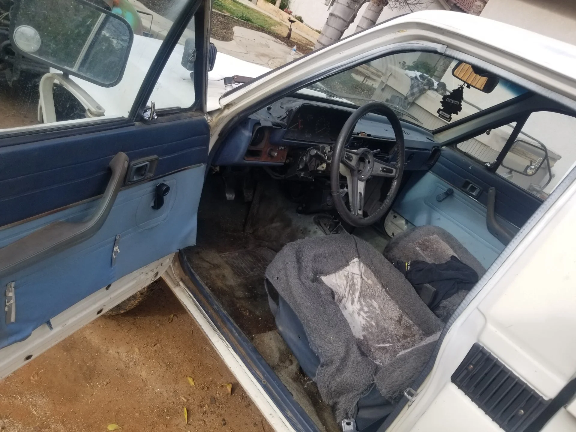

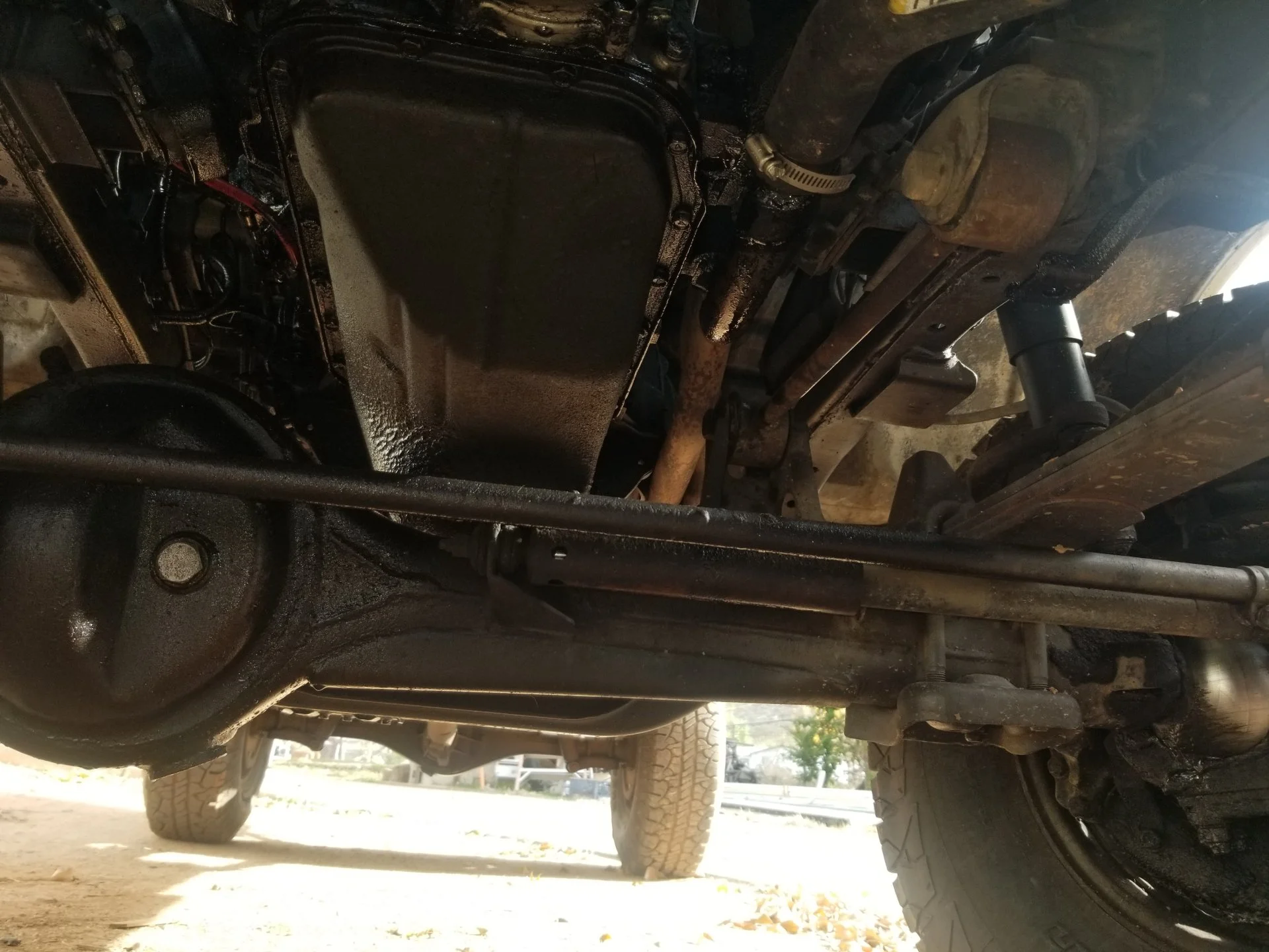

Ya, interior is a little rough. Your front crank seal is leaking. Like doh, uh?

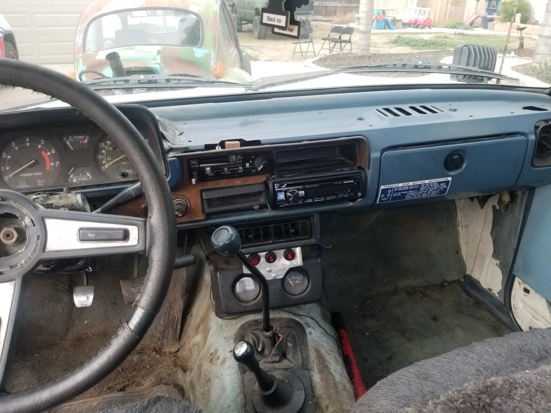

Yeah there's some interesting "fixes" there. You can still get the OEM dash pad brand new from Toyota. They're a little pricey but better than any of the covers (which you can't use, as you have NO dash pad). However, if you want to go that way, I'm about to replace the pad on my '82 and I'd be willing to part with the old one. It's blue, but that's not a big deal.
That hose from the top of the air cleaner attaches to the the elbow hose with the twin hose clamps. Can't tell where the other hose at the elbow goes, but not there.

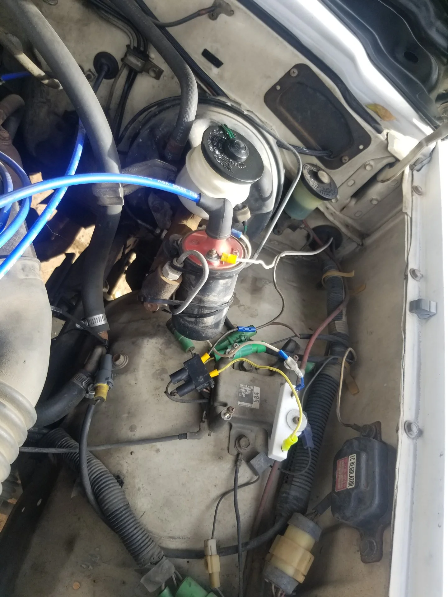

And that coil...
Actually I just notice you have a blue interior D'oh! So you're all good
Yep, I have some challenges ahead of me. I have about 2 weeks left to finish the latest pinball machine that I am restoring, after that I will turn my attention to this project.

Install correct coil
And that coil...
That hose extension ends at the front axle, not sure what the theory is there but I will get it corrected
Im glad to hear that there are still new interior parts available...does anybody know if the steering column parts are available?

Not sure about whether the column cover is still available. My go to guy for Toyota parts is Mike Bingham at Cabe Toyota in Long Beach. Very knowledgeable about older Toyotas.
Column covers aren't that hard to find, but old ones are very fragile. All the sunlight beating down on the plastic for 40 years...
