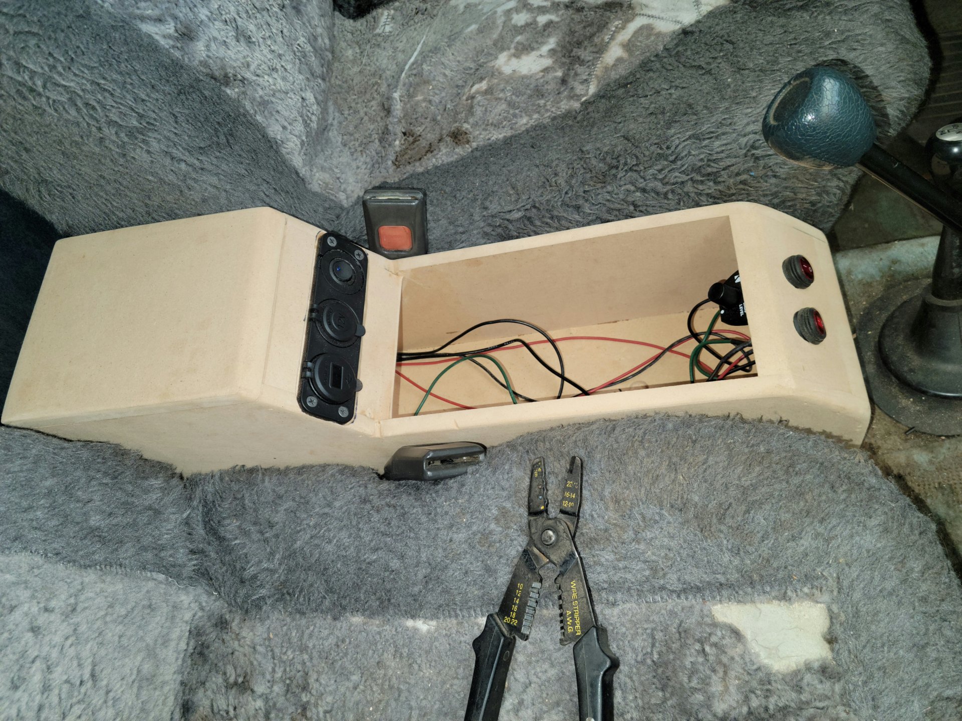

I had not been able to wire the KC lights yet because I had no place to put the switches that did not involve hacking the dash up or mounting some type of switch plate. I needed a center console for a few reasons as there was only a small coin tray between the seats so I had no where to put my phone, water bottle etc.
I also needed some usb chargers and wanted a "cigarette" lighter style socket that our camping kettle plugs into that did not require the ignition to be on. I decided to build a center console that had the KC switches, the bass control for the powered sub, the usb/power socket and some storage. I needed a fuse block to power the lights,sub,radio,and the outlets integrated into the console. Finally the console would be upholstered black to match the rest of the interior once I get to that point.
First I had to fish the power wire for the KCs through the inside of the roll bar tube, then completed the wire connections at the lights. That wire was routed into the cab.
I then built the basic shell of the console.
Finished the top part of the console and routed out an area to recess the power outlets
Put in 6 way fuse block and got all my wiring squared away.
Test fit everything

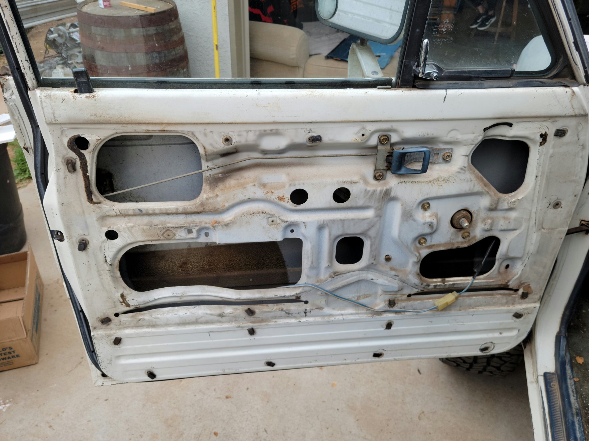

Here is the door panel...torn, stained, broken with part of it missing and a hole for a long gone speaker.
My concern is this area circled, the existing door panel has a vinyl flap that tucks under the window seal and around the door lock.

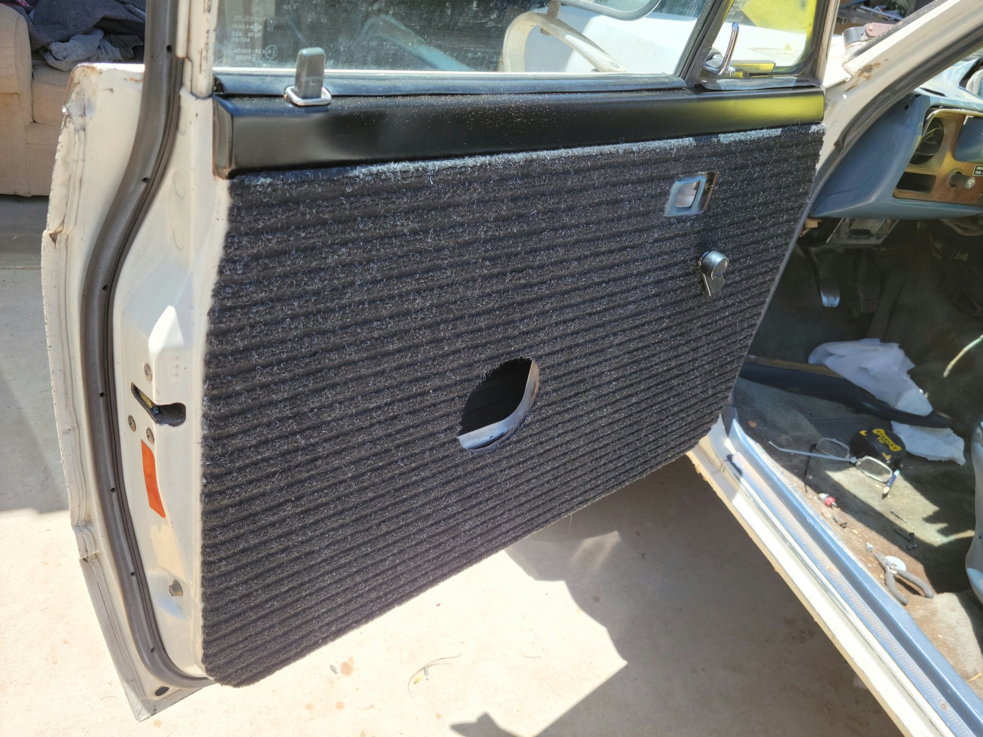

Located the best position for the speaker and proceeded to cut the hole for it.
Installed the panel clips to line up with existing holes and installed some T-nuts for the speaker
Coated the front of the panel and the back of the carpet with gorilla glue spray and positioned it using the ribs as reference to get it applied straight, then trimmed about 1.5" around the perimeter
Cut several notches in carpet to allow me to wrap the corners. Applied more glue to the edges of panel and carpet and pulled tight to backside and stapled. (Sorry, forgot pics of this step)
Test fit...

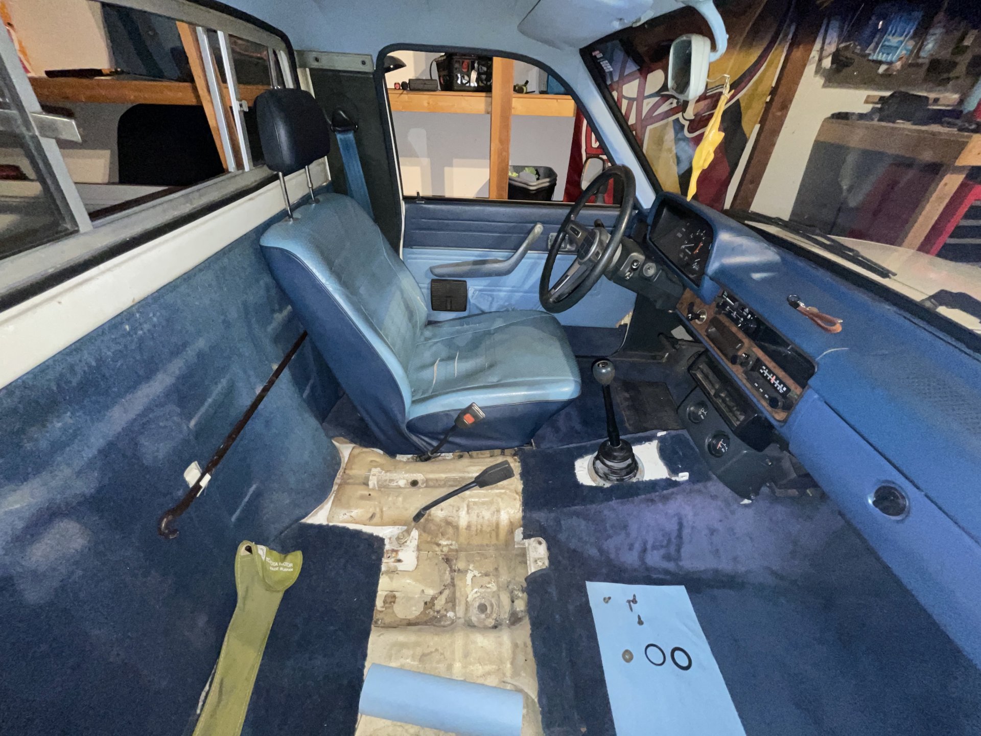

While waiting for some watersealer to dry I started to remove the old carpet, seat belts etc in preparation for the new carpet. After I removed the shifter boot I figured it was the best time to replace the worn bushings on the shifter arm.
The old upper bushing had disintigrated
long ago, with just crumbled bits left...
The lower bushing on the knob was worn, but not as much as I thought it would be.
New bushings
Reassembled, and the shifter feels as tight as prom night.
