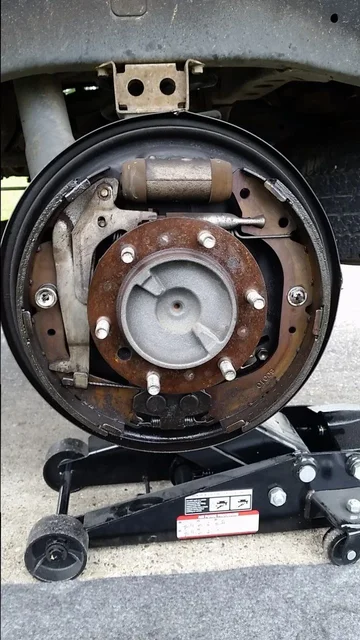

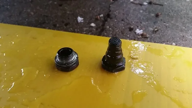

Weekend progress:
New soft brake lines - Mr T
Rear drum cylinders - Mr T
Diff fluid changed
New magnetized hex head plugs - Mr T
Mil Spec battery cables in
Beer in hand admiring work

Diff oil & rear drum cylinder change:20140628_155219.webp 20140629_132059.webp

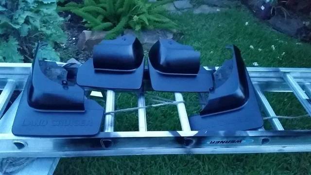

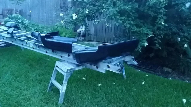

Pulled the plastic rear bumper cover & mud flaps today. Found some Rustoleum paint thats formulated specifically for this application.
Havent reinstalled yet, but everything looks good. 20140715_203232.webp 20140715_203213.webp
Havent reinstalled yet, but everything looks good. View attachment 917782 View attachment 917783
I've been thinking of doing this, but wasn't sure which product to use. My rear bumper pieces are mismatched and the color difference bugs me. Can you take a pic or send me a PM with the info of the product you used? Thanks!

Don't forget to do the white lettering!
This truck is great, and this is an inspirational thread.
You have me considering to add the rear bumper panels back.
I have to fix the body rust first though.
Keep up the great work!
I think it made my rig look 5 years newer.

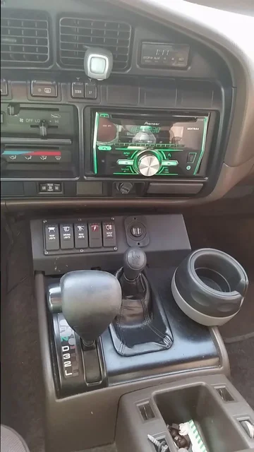

Also began instalking switch panel. Im almost done with the exhaust system, when those leaks are patched I'll install the TRE's ive got & do the axle rebuild.
When thats done I'll finish the rack and wire all the LED's 2014-07-16 22.53.16.webp 2014-07-16 22.52.40.webp 20140716_182655.webp 20140716_181822.webp

Tell me about that switch panel. That looks nice, I'd like to add something similar to mine.

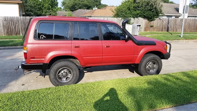

So,
Just got jome from around a 400 mile road trip. My impressions:
The engine runs smoothly, and seems to have a little more power on flat roads. The infamous kickdown cable needs to be properly adjusted bc I did struggle on hills. I couldnt maintain 70mph without dropping down a gear & darn near had to push the pedal to the floor before it kicked down.
With the ac on full blast the temp gauge never waivered, even in 100 degree Texas heat.
I averaged around 11.5 mpg.
The check engine light is still on and throwing codes for faulty O2 sensors. I have replacements but the nuts are welded on. Once these are replaced I bet I can pick up some mpgs and hopefully a little power.
All in all, I'm extremely satisfied with the rebuild.
