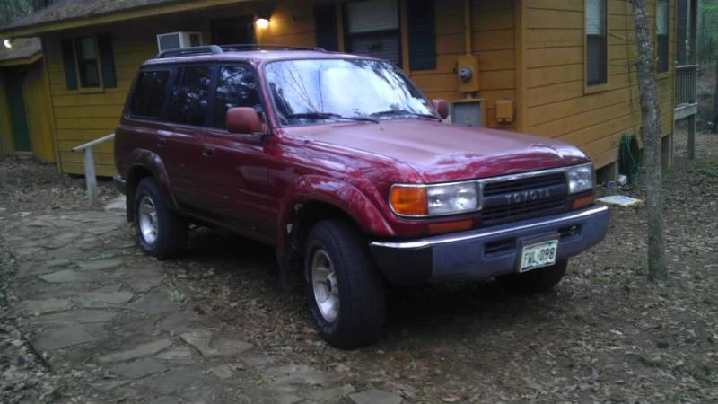

New (to me) 92 & documenting my build thread
First, I want to extend a thank you to Summit Cruisers for all of his guidance. Looks like I've got my hands full and an empty wallet ahead...
So, she's a 1 owner 1992 FJ80 with cloth interior & towing package. Oil & ATF look super good, as well as coolant & power steering fluid.
She does have several leaks, notably in what looks to be rear main seal, speed sensor?, T-case, and a front engine oil leak i cannot find.
Steering is pretty loose, and brakes are down right scary (maybe because my daily is an IS350?).
The valves haven't been adjusted in Lord knows how long. There's also an annoying exhaust leak.
The Radio lights up and displays a station but no sound comes through the speakers. Rear windows don't work, passenger rolls down but not up.
AC works, cooling system works, fan clutch is tight, interior is immaculate.
Please evaluate my maintenance plans & feel free to chime in

At the deer "camp" first day of ownership!
She hauled 2 guys and a lot of gear about 100 miles like a champ. carried my tree stand and feeder from the cabin to the shooting lane - off road adventure #1
