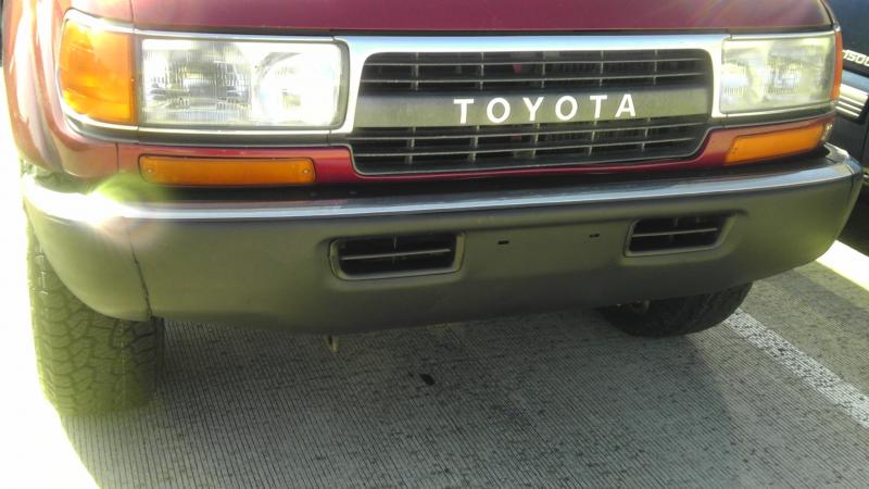

Duplicolor Spray on Bedliner - Bumper & Wiper Arms

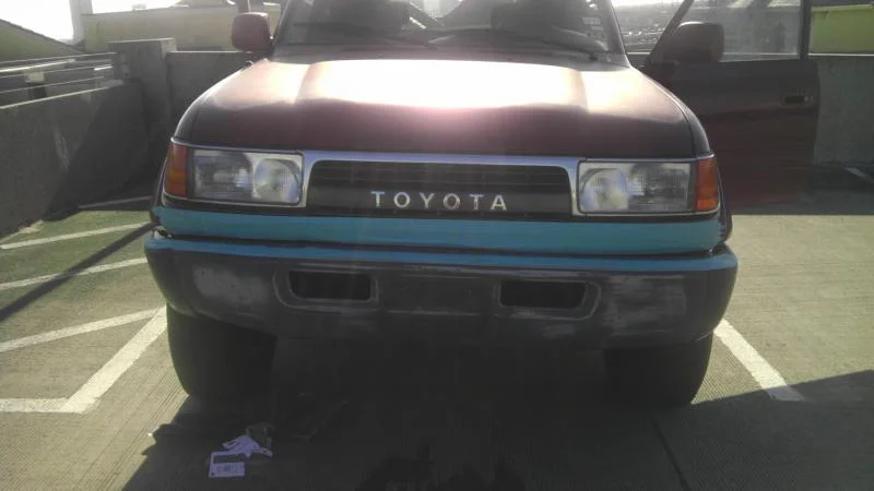

Bigezvol request a how to, so here's my first attempt!
There's an Autozone about 2 miles away, so i picked up a couple cans of duplicolor spray on bedliner as well as some 3M sandpaper and solvent & auto masking tape.
Once home, I removed the license plate and the vents in the bumper.
Next, I used the course sandpaper to sand away the chips in the bumper's finish, and a couple of rust spots where the paint was completely gone.
After this initial sanding, i switched to the next finest grit and spent an hour or so smoothing out the bumper surface.
I cleaned the surface with solvent next, and finished up with the fine grit sandpaper.
Now that the surface was ready for paint, i masked off the chrome strip on the bumper, and masked off about 6 -8 inches of the lower grille trim, grill, and headlights.
Following the application guidelines on the can, I sprayed 2 coats of duplicolor on the bumper. It used up an entire can! This is the important part: I drank a frosty miller light. don't skip this step!
A couple hours later, it had cured. Of course, it was sunny and 80 degrees out. Depending where you are this cure period may take longer. I removed the tape, took some pics, and drove to the deer lease!

Forgot to mention, I used this stuff on my H3 and it held up pretty well to DD use, but every time I used the bumper as a slider it scraped off so I had to reapply. I also used it on my spare tire for the blackout look... pics of FJ80 and Hummer to follow.
Here's a few more pics of the process, and my masking job.. I ended up taping the headlights for good measure.

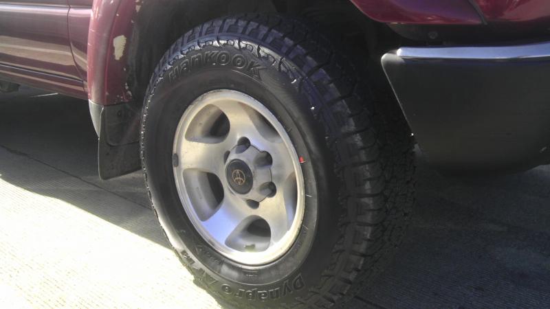

New Hankook 285-70-16 and H3
Picked up some Hankook AT's which look waaaaay too small. Once the Beast is running right I'm going to need 33's and OME 2.5!!

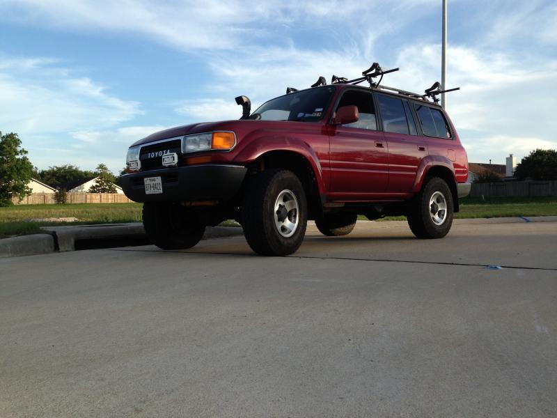

Yakima on, no kayaks yet :(

Finally got around to lifting her today. Didn't get the caster correction completed, but did shocks & springs. Only took 2.5 hours - EZ job.
What helped:
No rust
Sprayed b12 chemtool on all bolts every day for a week as slee suggests
Good Impact wrench
Competent help.
I think rides the same (medium) as stock. Can't tell a difference, except she's 4 inches taller.
Installing the rear
End result
