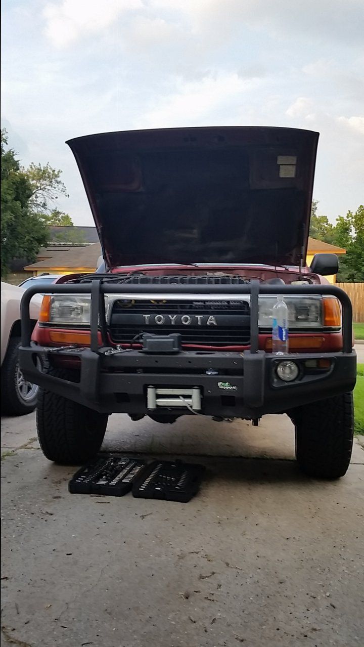

Got off work today a bit early, and had some time to work on the 80. Dad & I jumped the ECU and got code 22 this time. No other codes?!?
Anyway, Advance Autoparts had the engine coolant temperature sensor in stock. Purchased it & headed home to install, which was a breeze. Used a 19mm socket after breaking the plastic end off. It came right out with a bit of green Cruiser blood (coolant).
If you need to change this sensor, unplug the 2 xonnections nearest and break off the plastic plug to remove the old one easily. Also helps having a stubby ratchet w swivel end.
New sensor in olace & a couple mins later?
No CEL and the engine purrs like a kitty. Idle is silky smooth, though still a little high.

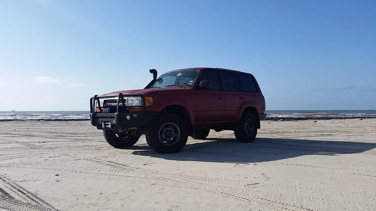

Family had a beach house down on Galveston island this week so I saddled up the cruiser, loaded the kayaks and headed down.
Took a couple poser shots cruising the beach.

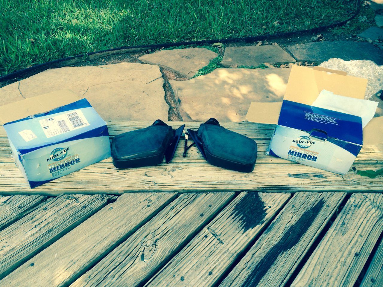

Wife was in a terrible mood, so I spent the day outside monstalining my mirrors!
