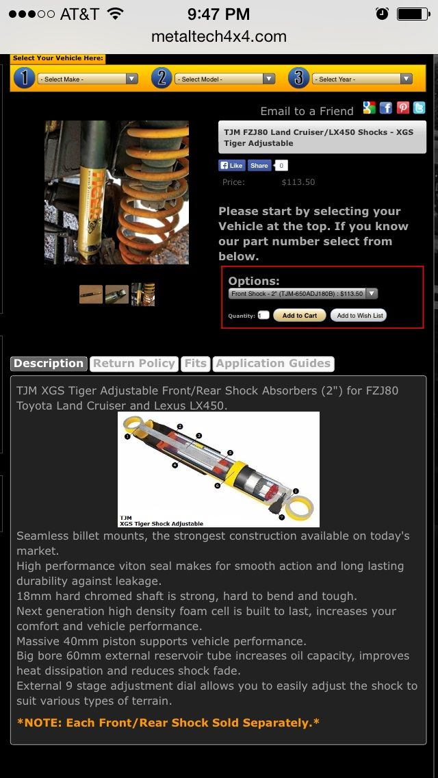

Here's the shocks I got, purchased mine gently used off a fellow 'mudder.
Will be installing them next weekend.

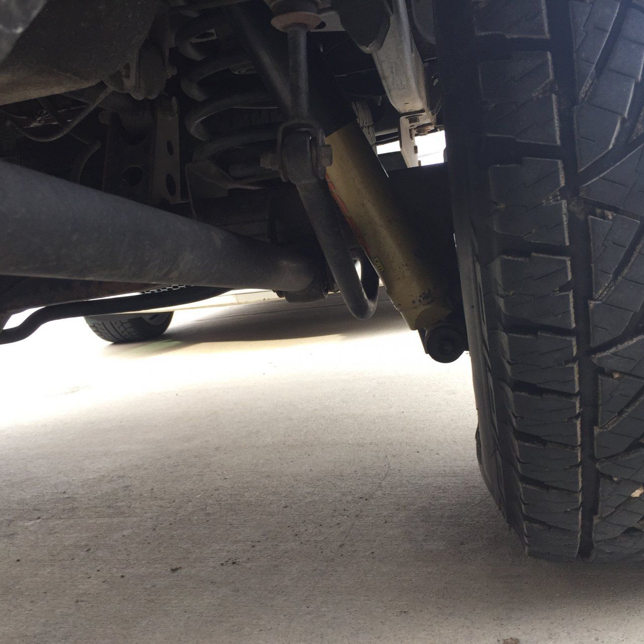

TJM Tiger - adjustable shocks
TJM adjustable shocks finally installed on the rear. Will do the front next weekend:

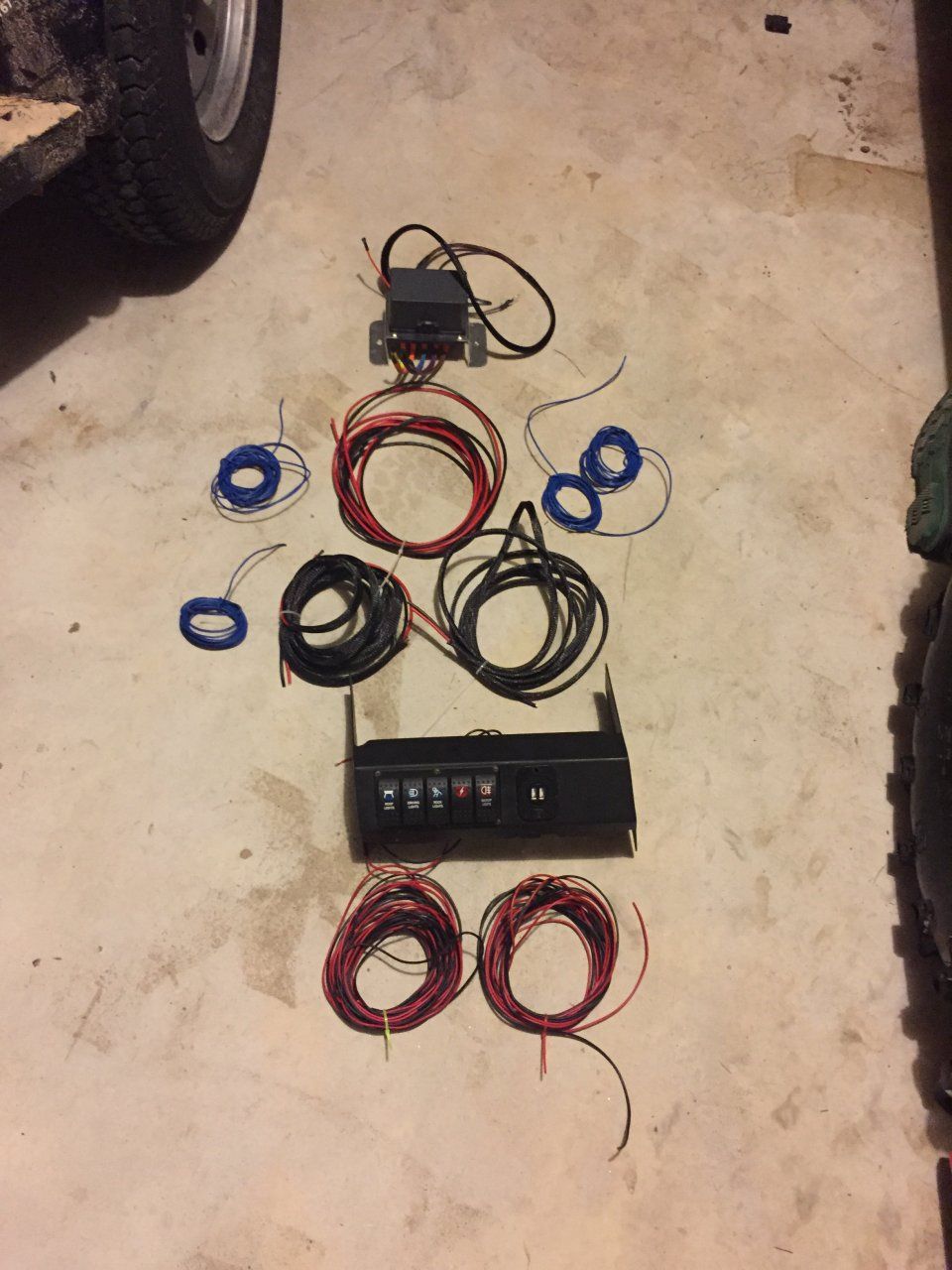

Laying out wiring so the install is plug & play.
12ga shrouded wire for the front 24" bar
Sides each get 16ga - will be shrouded as well
Rear also gets 16
Blue wire is 14ga for lead from rocker to relay
Buss man relay bank & dirty parts switch bank in pic.

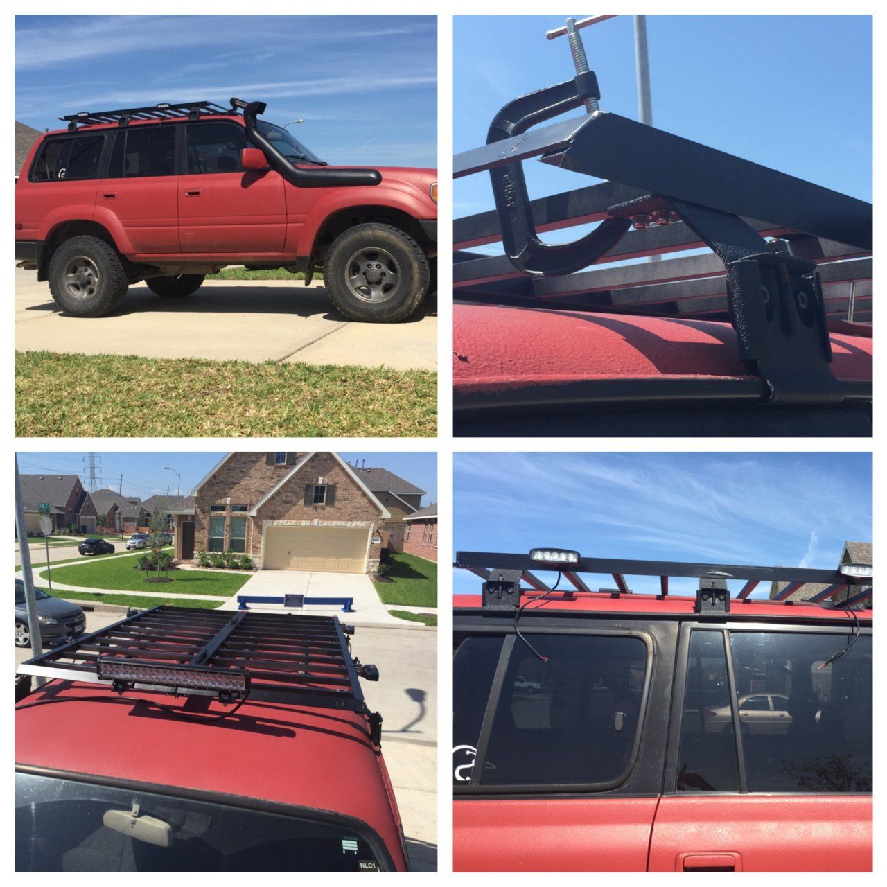

Finished painting & mounting my CMoose rack. Looks almost like I envisioned, and seems sturdy. I need to add a fairing & some anchors because I plan on hauling hunting gear in 2 Hardigg med chests strapped up there. Kingsville is a long way from Houston So it's got to be sturdy.
More comprehensive pic.
Btw: use a c-clamp to match up the rack to the gutter mounts. It saves a lot of hassle.
