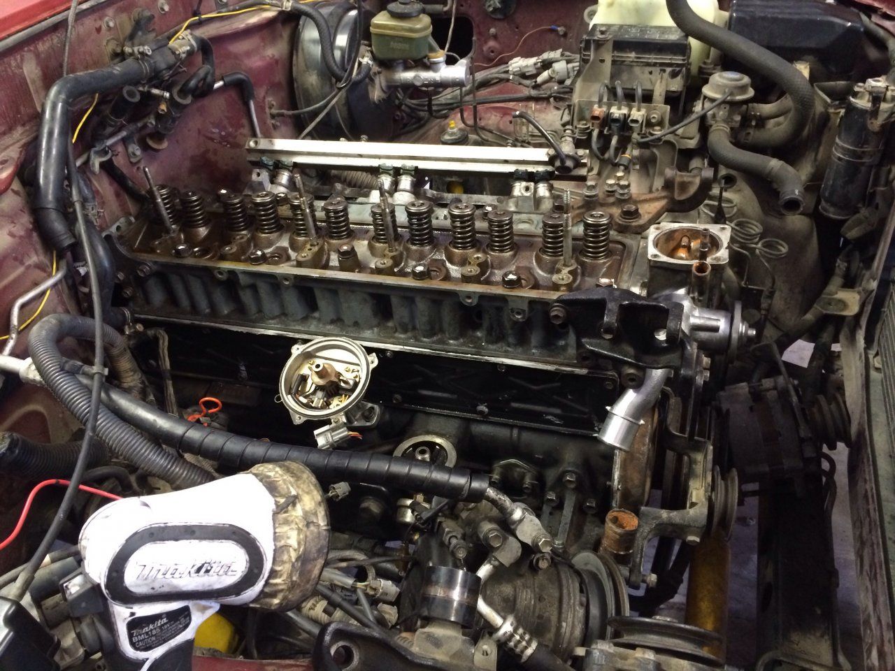

Well, I finally had the time to pull the motor and assess the failure & damage. Def a blown HG @ cylinder number 4.
Not a big deal since we didn't drive but a couple hundred yards afterwards - all cylinder walls look good.
Biggest issue? PO installed a block from a 62 series. I really don't know what this means yet, some of the parts I purchased will have to be exchanged.
The B34ST has now been renamed:
Frankenstein.
Some pics
Head off & being broken down for refresh.

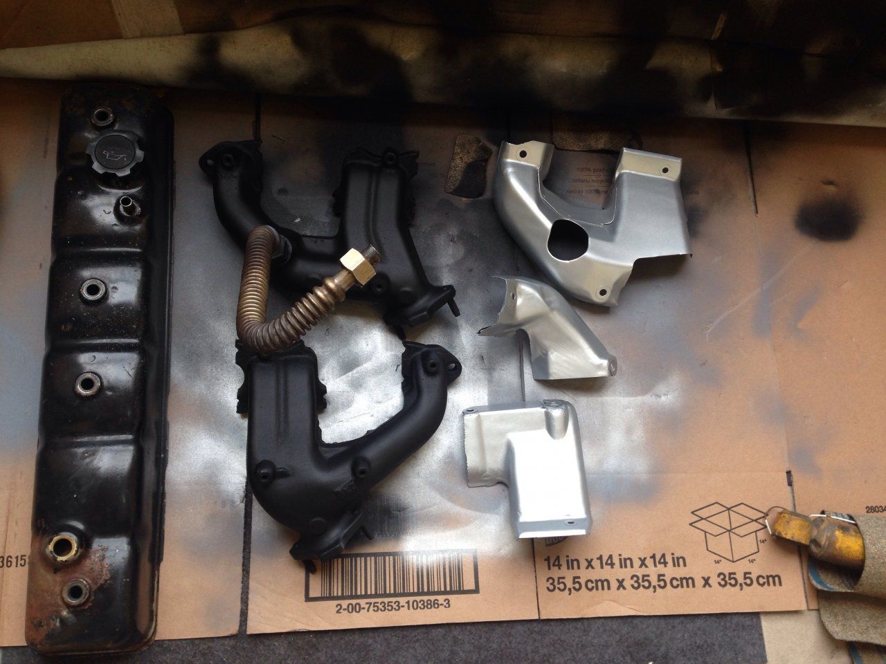

While the engine is at the machine shop, I've had the weekend to sand & grind the rust off of the exhaust manifolds & heat shields.
Today I start on the valve cover.
This thing should look great & run even better when she's all back together! I'm beside myself with excitement.
Moar pics
Finished, time to bake these jokers in the oven
