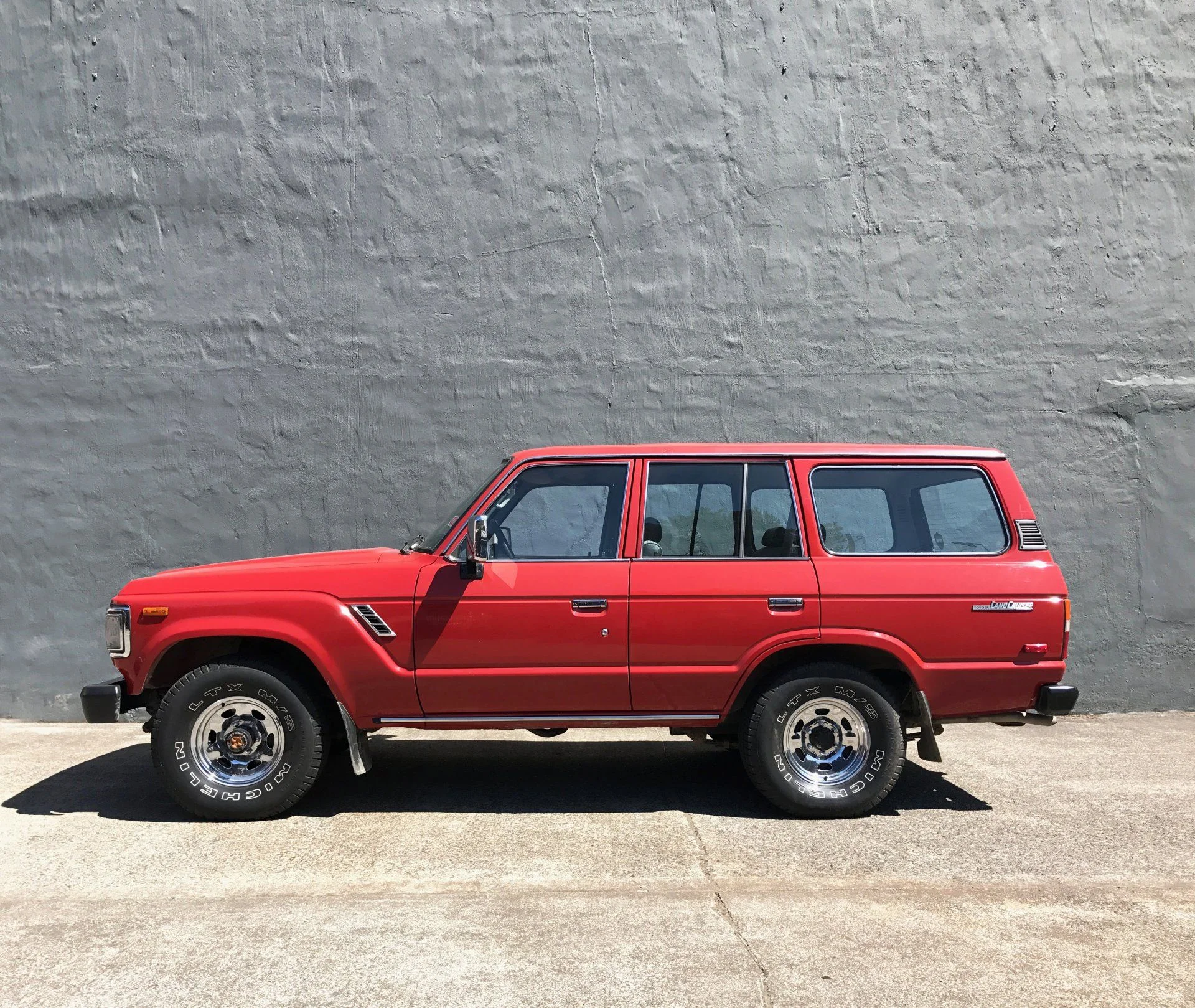

Thanks everyone for you comments! This is all good stuff and super helpful!
So far she's running great, and it looks like I'm already running 31s. Heres a better picture of how it's currently sitting. I will keep you guys posted. Thanks again!
