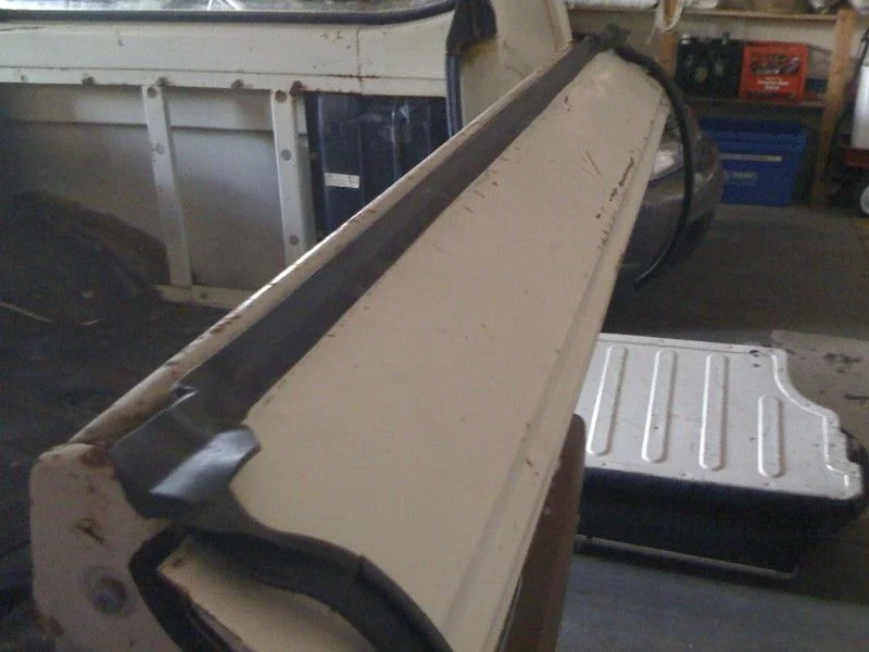

Yesterday was a big day because I was able to get the tailgate fully functioning! I had installed a new (big $$) outer window seal, only breaking 2 of the plastic buttons in the process. I basically disassembled the entire electric motor assembly trying to get it working and hotwiring it directly to the battery at different times to get the motor spinning in both directions - it finally did. So it's all put back together, the window's in, my fabbed replacement handle is in, it's all hooked up and it all works! I was excited that after some fiddling, the electric door safety switch works and I managed to re-hook up the mechanical safety latch that doesn't allow the door to be opened unless the glass is fully down. The window lowers w/either the key in the tailgate or the switch on the dash - it's a miracle! We'll see how long it lasts, but for now, I'm a happy guy as the tailgate was my first BATTLE ROYAL when I first started this project, so it's nice to have conquered it finally. It did trip the circuit breaker a few times when testing the raising/lowering function, so that is working too and I didn't add an extra fuse to replace the door safety switch.

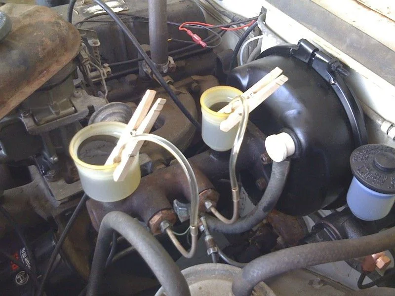

A few other things: Installed a rebuilt brake booster, did a proper "bench bleed" of the master cylinder and spent some time measuring and drawing the tailgate handle parts in case I ever get motivated to create some more finished looking replacements. It's a bummer you have to basically disassemble the entire window mechanism to get at those parts. Major PITA to replace/fix etc...

few pics:
new brake booster & "bench bleeding" MC set up.
big $$ strip of rubber!
