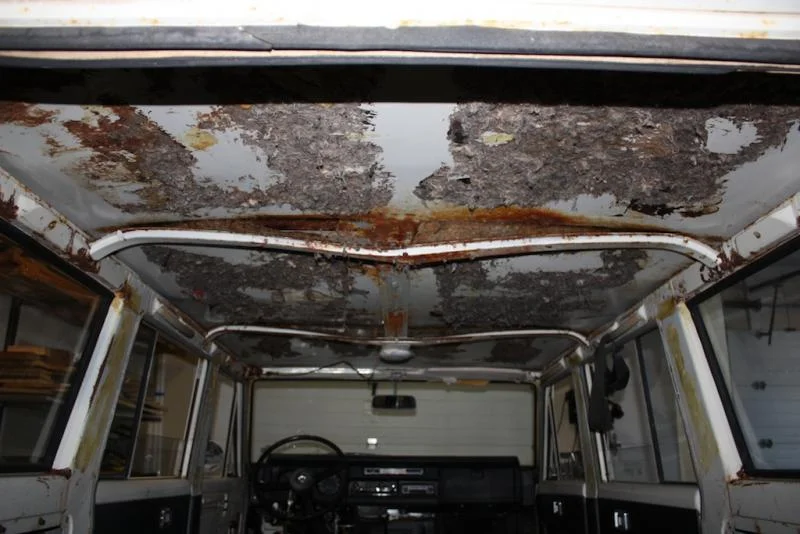

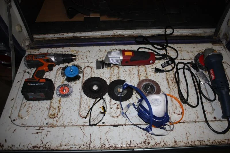

Little update. . . I've had 2 of the most physically hard days working on the 55 yet. I started on the roof & the interior and most of my time was spent scraping the old matting and glue off the underside of the roof - what a gnarly undertaking. I can barely lift my arms over my head! Holding either the electric oscillating tool (which worked great) or the grinder over my head for 2 days while kneeling or sitting on a milk crate inside the 55 just about did me in. I'm really happy with how it turned out, but boy, it was a lot of work.
It's hard to tell from the pics, but the roof was really munched in and pretty wavy. I laid on my back inside on the floor and used my feet & legs to push the major dents/waves out. It's not perfect, but it's way better. I think adding an extra support or 2 back in will help it keep it's shape.

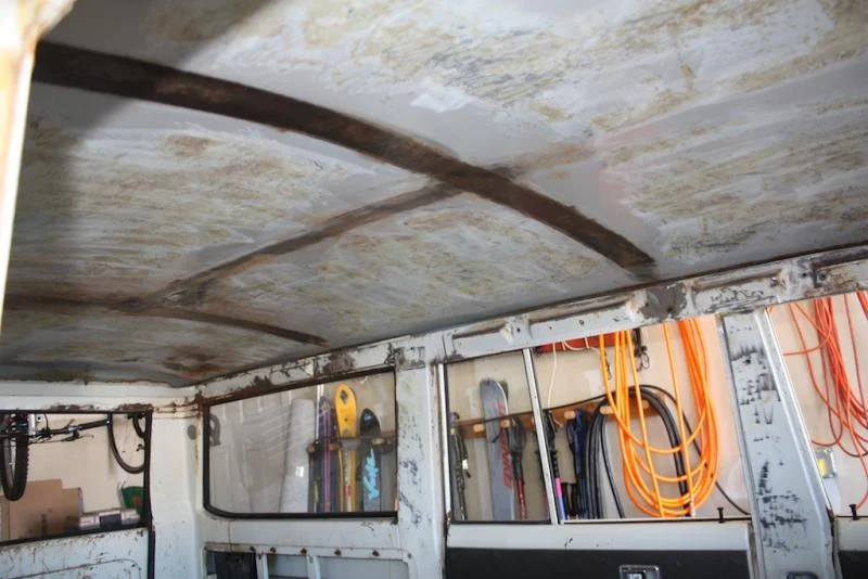

I decided to cut out the 2 roof supports and I'm glad I did. It was easy to grind the welds and get them out, and it made it soooo much easier to clean up the underside of the roof w/out them in the way. It would've been impossible w/them in there. I'm not sure what I'm going to replace them with - mine are pretty bent up. I have a few ideas, but need to do some head scratching and investigating.
I had to take breaks to allow my arms to recover a bit, so I've been popping off the interior door panels and lubing the opening/closing mechanisms, the locks and the window regulators. 2 of 4 now work really well, nice and smooth.
Here's a few photos of what I started with inside & outside, some of the tools of choice.

These pics show what I accomplished after day 1, the final all clean roof, and the 1 rust hole I've found so far that needs a patch.

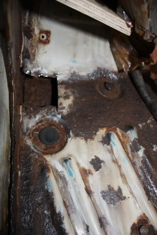

The rust hole is in the driver's side floor board, right near what I'm assuming is the body mount? It was a small hole, maybe as big as a quarter that I had to hit w/a wire wheel to uncover. I cut it open and the entire inside was PACKED w/fine dirt/sand. I cleaned out the interior, cleaned up the hole and will weld a patch over it the hit it w/some POR15 - my rust paint of choice. I also plan to paint over a few other spots on the floor that are showing some rust - some big scale, but no other holes yet. . . hopefully that will at least slow the cancer down a bit.

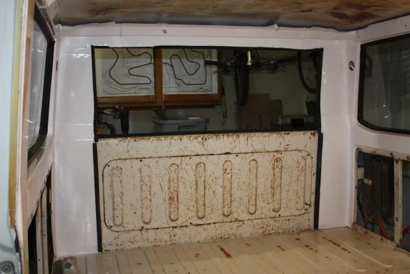

End of the week update. . .

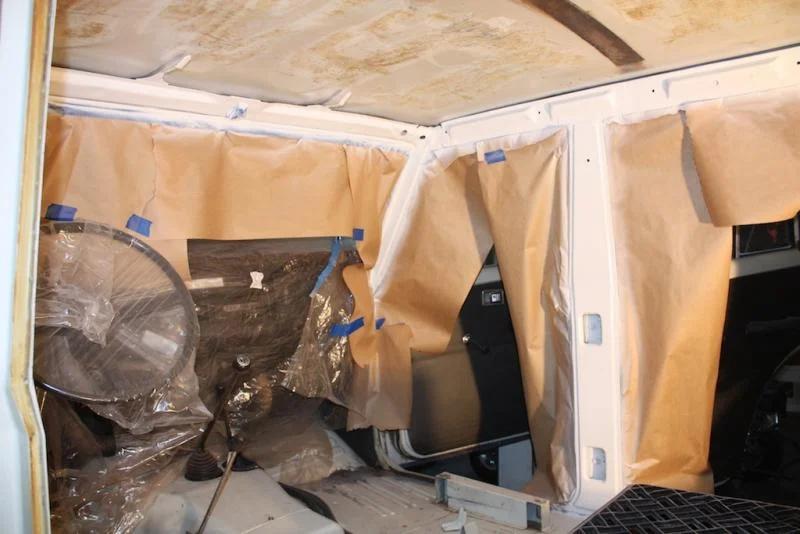

Today I finished some light sanding and prep work so I could paint the interior - just the sides as the roof is getting carpet and the floor still needs some light welding/patching before getting POR15'd. Most of the prep work was in masking off. I kept it pretty simple, but it looks pretty good. Hopefully it'll last at least for a bit. . . we'll see.
I had a few more pics of the prep, but my wife swiped the camera part way through the day and erased them. . . look at the previous post for "before" pics!
Next up is welding on the floor, POR15 on the floor and carpet on the roof. . . then we ride!

Little post-weekend update. . .

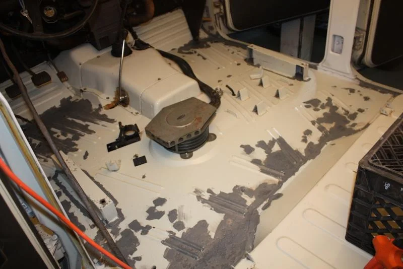

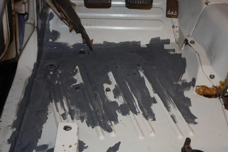

The rust hole in the driver's floorboard grew as I poked and prodded further (of course!). I probably could've/should've cut out a much bigger piece, but I tried to keep it manageable. There is still some structure to what I left, but it is definitely thin in spots and not easy to weld to in others. I feel a bit guilty for not digging deeper, but I decided to draw the line. While it's in great overall shape, I don't have any ambitions for the 55 other than a fun, around town beater so it doesn't have to be perfect - that's my rationalization at least. I can always go back and replace bigger sections later. . .
So the interior sides are painted, rust/hole patches are welded in, the floor is spot-POR15'd, the roof is ready for carpet and new supports. . . I also finished popping off all the door panels and lubing the locks and opening mechanisms - they all operate like butter now, very nice!
Just about to put in what is hopefully my last big parts order for a while - door body mouldings, a plastic dash cap cover and a few misc. little pieces. . .
Here's a few pics: one of how nice the newly painted sides look next to the tailgate which I didn't paint, and a few of the spot-POR15'd floor - decided to go w/gray as that's what I had the most of. It'll be covered up by the mats anyway.

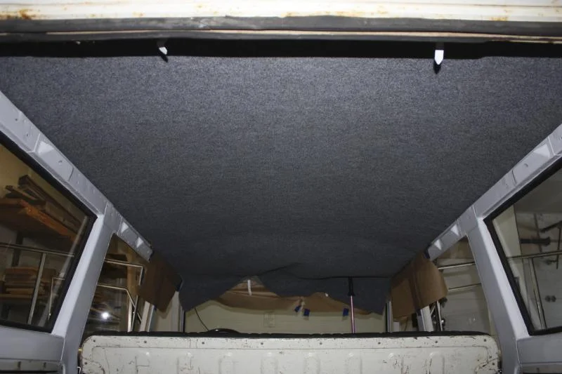

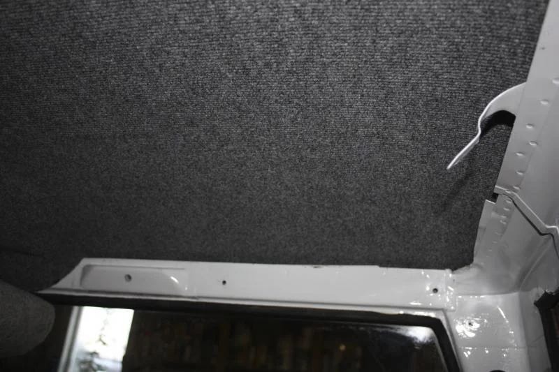

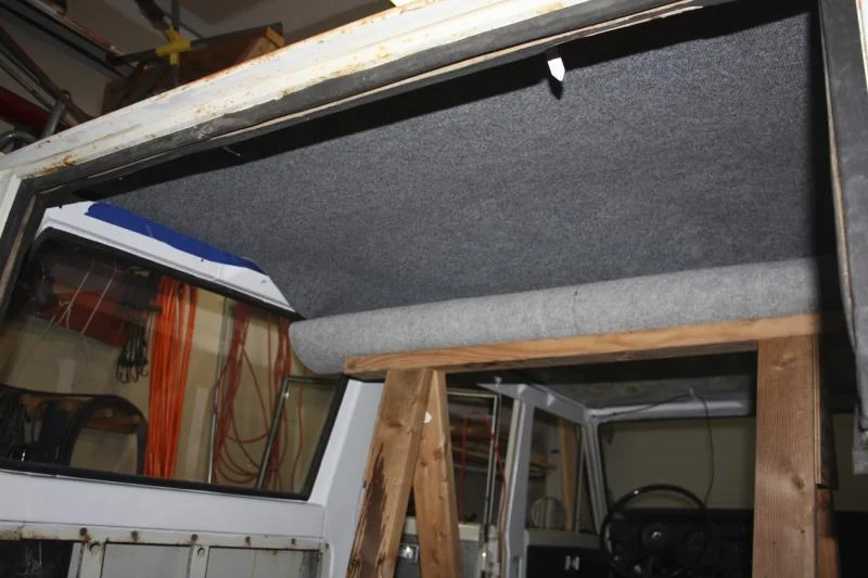

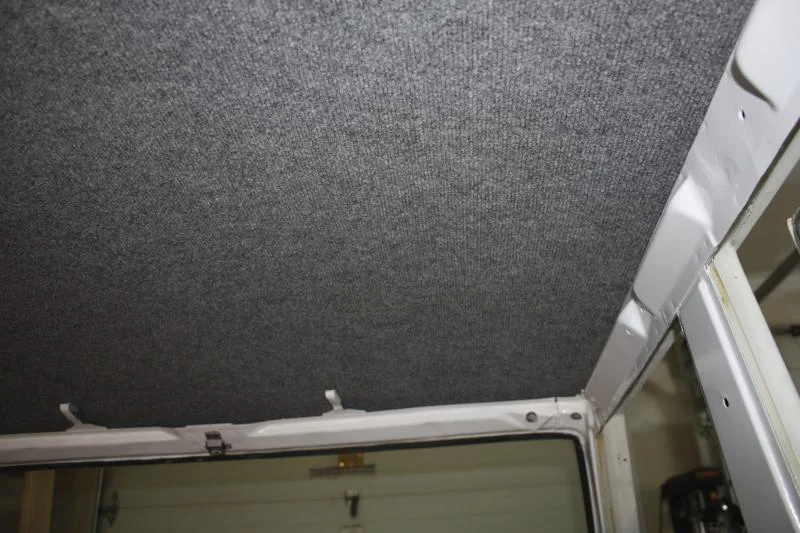

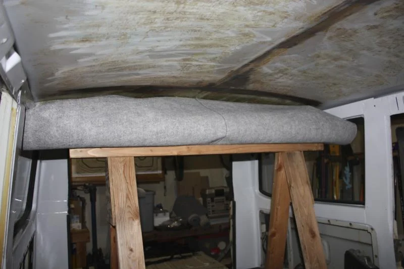

Big day! Headliner is in! It took a little head scratching and a big leap of faith, but the end result looks pretty good I think - I'm happy with it. Having something on the roof lessens the tin can effect by a large amount too, which is nice.
It was a bit of a struggle as a 1-man operation, but with some jimmying etc... it was doable. After cutting the carpet to fit width-wise, I drew a line down the center of it and a matching line down the center of the underside of the roof. Because the carpet has ribs/lines, one thing I was nervous about was having them be wavy or angled when you looked down the entire thing from the tailgate. Having the lines to match up was a BIG help. Even though I strayed by about 1" from front to back, it's not something that's noticeable - at least to me. There are a few sections that I could unglue and restretch because of small wrinkles etc... and I may do that if I get motivated - just not right at the moment.
A friend came by and made an excellent suggestion - to put some "U" channel black welting around the metal lip at the top. That's on my long term list as I think it will finish off the roof well.
Here's some pics of the process:
I used a sawhorse at the beginning to support the roll; I started at the back and worked my way to the front. First finished corner looks good!
One more in progress pic & a few of the finished lid; This was indoor/outdoor carpet from Home Depot BTW!:

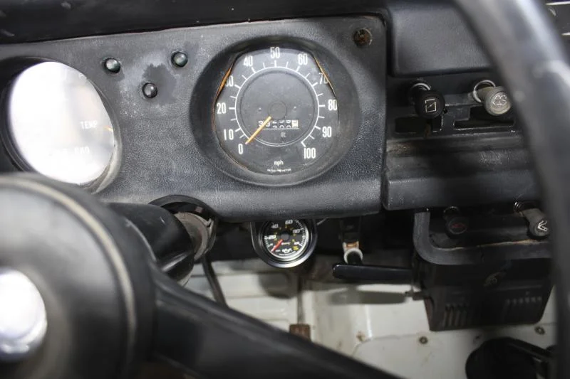

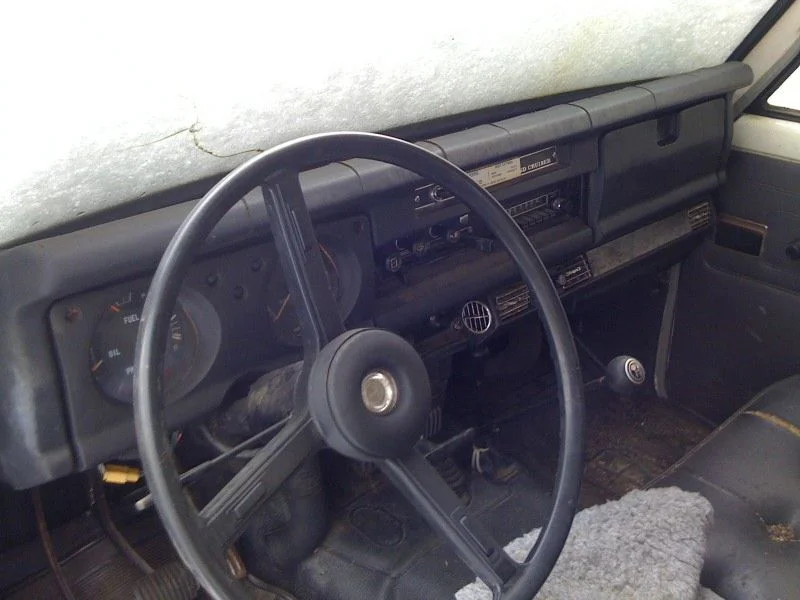

Thanks to Nick for motivating me to post some pics of the dash. I'm getting to the point where I need a break from working on it and just wanted to get the dash done, so that's why my motivation was low and I'm a bit short on pics. . .
I started by troubleshooting the fuel level and temp gauges, neither of which were working. I pulled the fuel level sender, cleaned it up, checked that there were no shorts in the wiring to the gauge etc... By the end, I'd completely removed the glove box, main dash pad and the gauge cluster/pod. I took the gauges apart and gave them a full cleaning. The part of the dash that hold the gauges was haggared too, so I glued all the vinyl back around the openings and filled in some gaps w/epoxy & some body filler etc.... Then gave the whole thing a few coats of primer and then a few coats of semi-matte black. It looks brand spanking new!
The dash had about 10 major cracks through it which I filled w/epoxy, then sanded down the high spots. I bought a plastic dash cover which required a good deal of trimming in the center to fit. I think the later 55's have a different center section where the back window switch is located. It was hard to cut up a brand new dash cover, but it doesn't look too bad.
In the end, I'm totally happy w/how it all turned out. All the spots on the interior I've touched up really make the spots I haven't touched up stand out!
I'm going to try to stop working on it for a bit so I can catch my breath and give my check book a break too. I'm happy w/where it is at the moment - reached my immediate goal of getting it safe, drivable, somewhat habitable and back on the road and by some minor miracle, I've reached my budget number at the same time!
So after I change the trans./transfer case/diff. fluid this weekend and give it a quick tune up again, I'm hoping to stop for a while. . . but know I probably won't be able to! There's still the matter of the interior rear panels, fabricating a cool rack, touching up the exterior and the rust on the roof, ohhhh and I found a 2F and 4spd. trans. that's only 1 1/2 hrs/ away from me that's fore sale. . . : ) : )
IT WILL NEVER END! But that's OK.
A few "before" pics of the dash first, then a few "after" pics.
