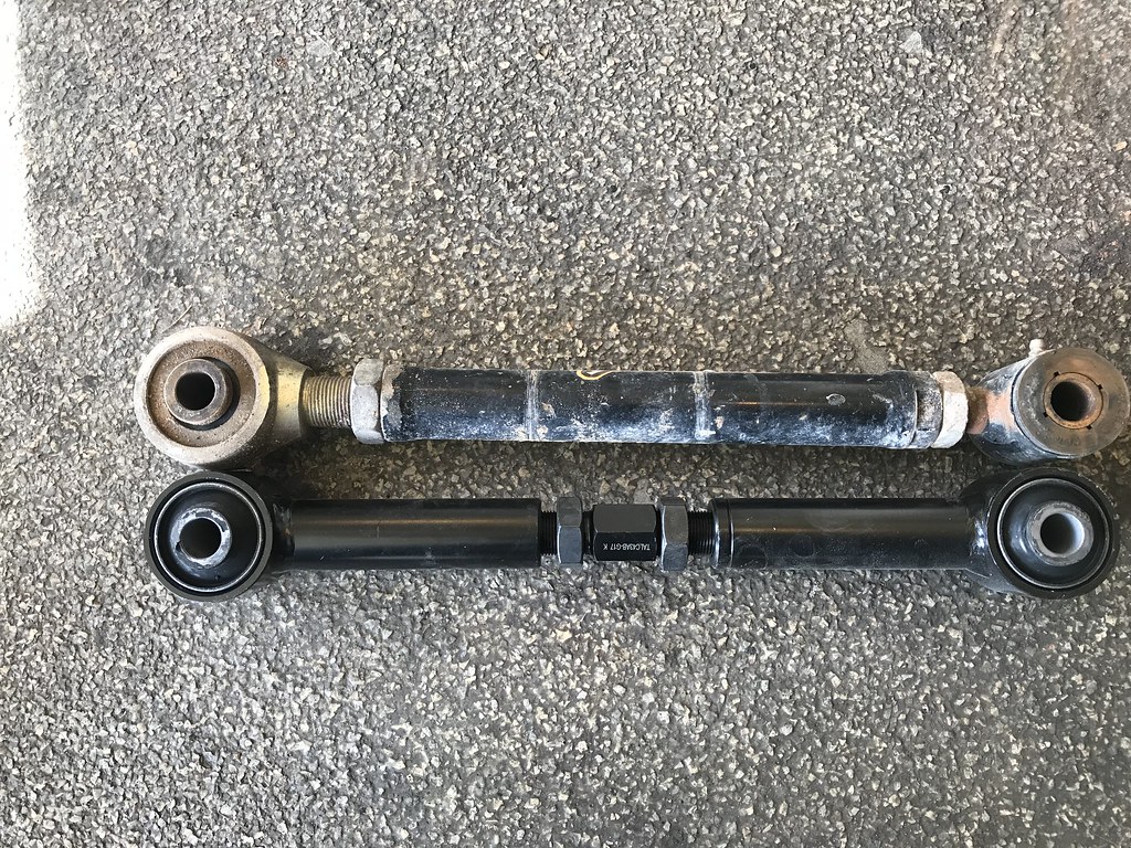

I'd have to disagree with that. I wheel/work with Richard quite a bit, and he's been dicking with those joints since about the week after he put them on the truck. The last thing those joints have been is neglected. The bottom line is they don't work for his use, which is a DD/moderate rock-crawler. Right from the start they had issues unrelated to maintenance. But besides that, any part that requires constant maintenance is bound to fail.
I can’t argue with you there because, yes, eventually, all parts wear out or fail including rubber bushings.
What is on the other end and the condition after 15K
The other end of the arm had sleeved poly bushings that were still in excellent condition.
This is what the arms looked like when they were pulled to get swapped for Blackhawk arms.
Top is TT arm, bottom is Blackhawk.

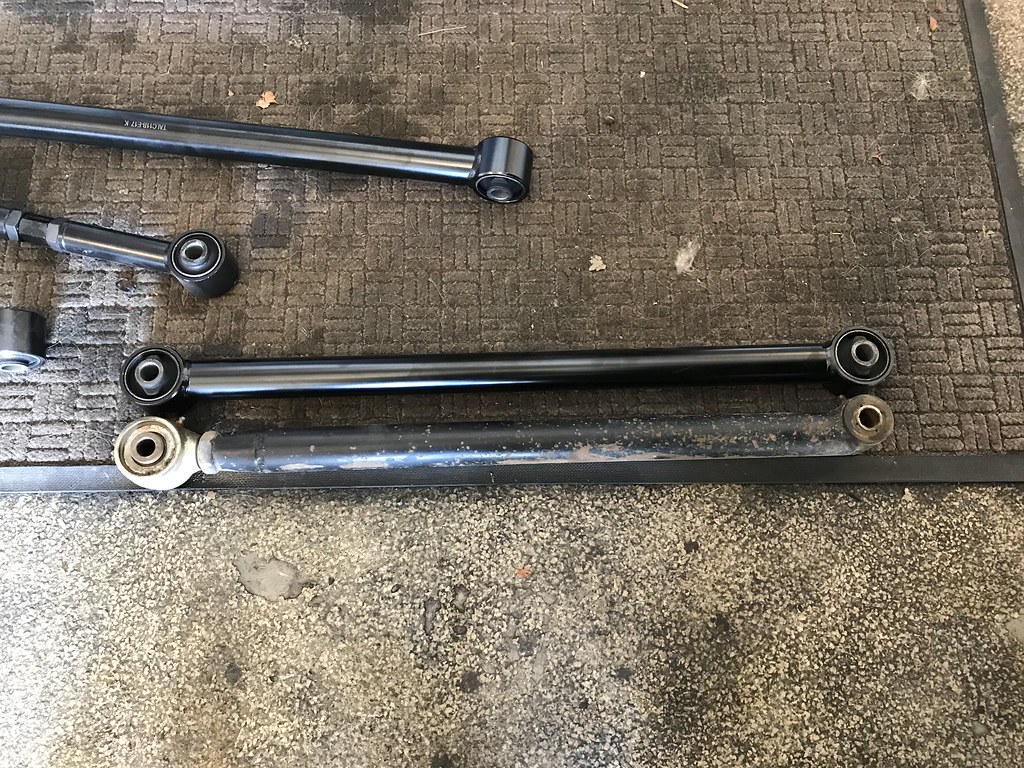

Top are here is Blackhawk and bottom is TT.

These are the TT arms on the same day as when they were pulled after about ~15K miles. Just a bit a cleanup and fresh paint, but the joints still looked solid as well as the poly bushes.
