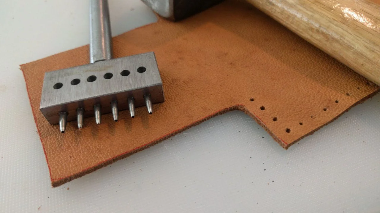

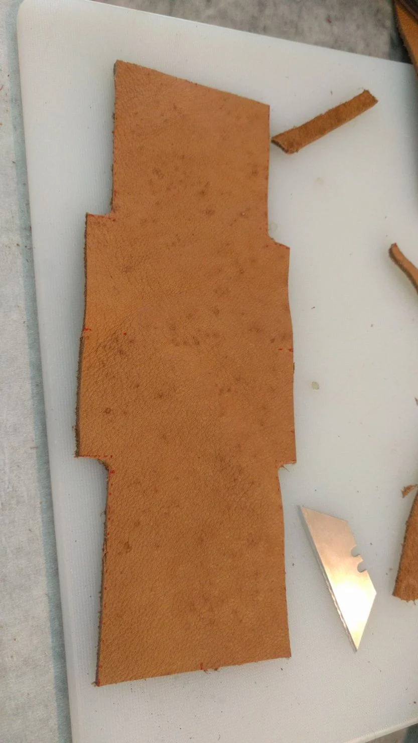

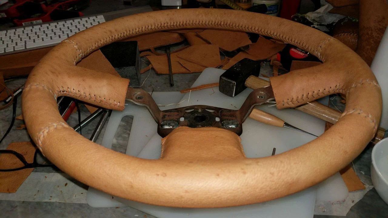

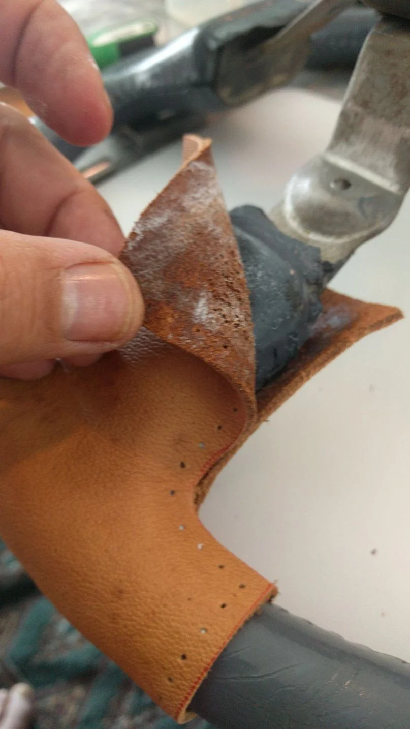

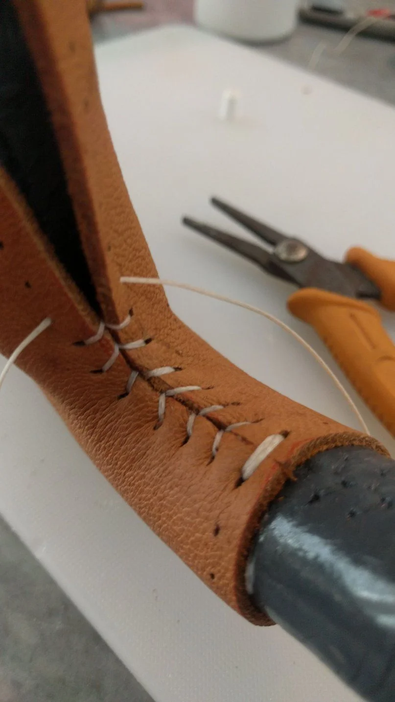

I've had a couple of different adventures with steering wheels. The first thing I tried was buying a real leather cover on amazon for my model 100 rustbucket that requires stitching it on. It takes 2-3 hours (at least that is what it took me) but the results were overall pretty good. I did find that it is absolutely necessary to glue to the old steering wheel--otherwise it never quite feels right.
For my '93 model 80 I wanted to try to do the leather work myself. So I went to the junkyard and bought a decent wheel and got it put on the truck, taking the old, sad leather-covered one off. First I tried cleaning and re-sealing the old leather. The results were 'meah..' So I then stared at this thing in my apartment for a month or two. I've made things out of leather before, and I have the punches and thread and so forth, but the shape of a steering wheel is rather daunting.
Finally one weekend, fortified by a couple of beers, I just started:
full
full
full
full

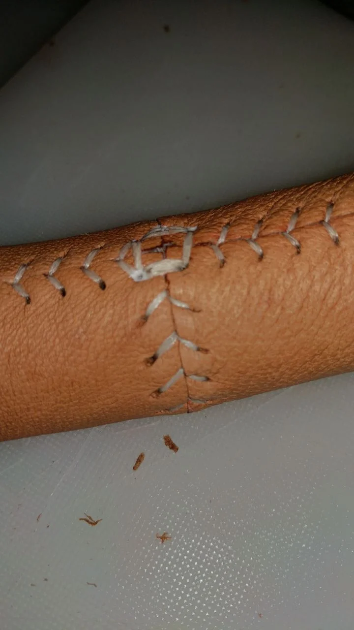

I taught myself to do the 'baseball' stitch by watching a bunch of youtube videos and then making mistakes. I will skip a lot (and do a longer post later in a separate thread), but here is the finished results:
full
full
It was very satisfying to do this. The wheel is going on El Wahsh now. Will post a photo of the wheel in-situ. BTW, this is camel leather. I drove to the leather tannery set up by the Abu Dhabi government and its a pretty cool and modern facility. And they let you select your own skins.
Yes, this took a long time. And the results are not perfect. But I like it a lot. If I do another one--my 1998 model 100 could use it--I will do better.
I should mention that I deliberately added another layer of leather over the existing leather--I wanted a thicker steering wheel.
full
full
full
full
full
full

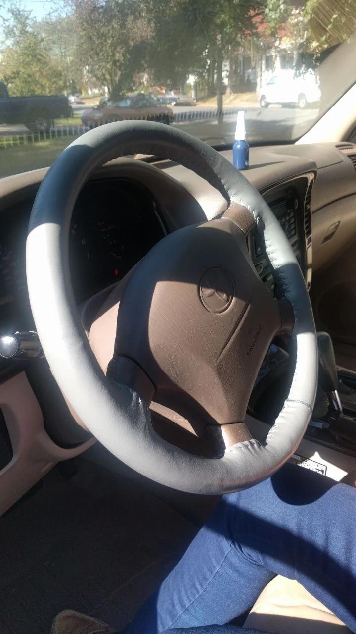

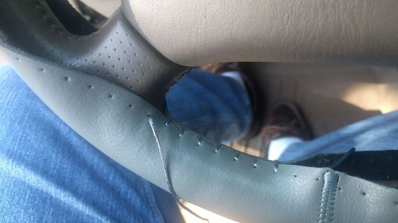

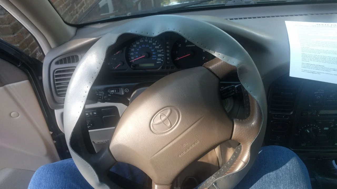

The photo is a little misleading. On the LC wheels I've seen the four stalks that go outward from the hub are all leather covered. The cover they are showing is basically just a strip of leather that goes around the wheel. Available from Amazon for a few bucks. The result is fine, but not original looking IMHO. I did this on my 1999 rust bucket ebay mistake truck.
Here's the one I used, but if I did it over I would have picked another color.
And here's a few photos:
