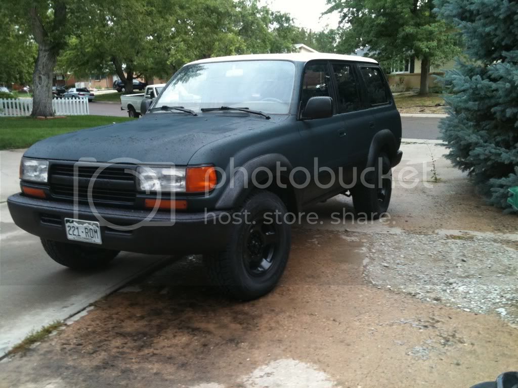

***UPDATED to save you some time. The paint color has been decided.
White top, I like the contour lines Summit Cruisers used.
6M1, Dark Emerald single stage.
Black bed liner on flares, rockers, bumpers.
Wheels, rear air deflector and all front end chrome will all be flat black.
FJ40 emblems.
Removal of roof rack and air deflector.

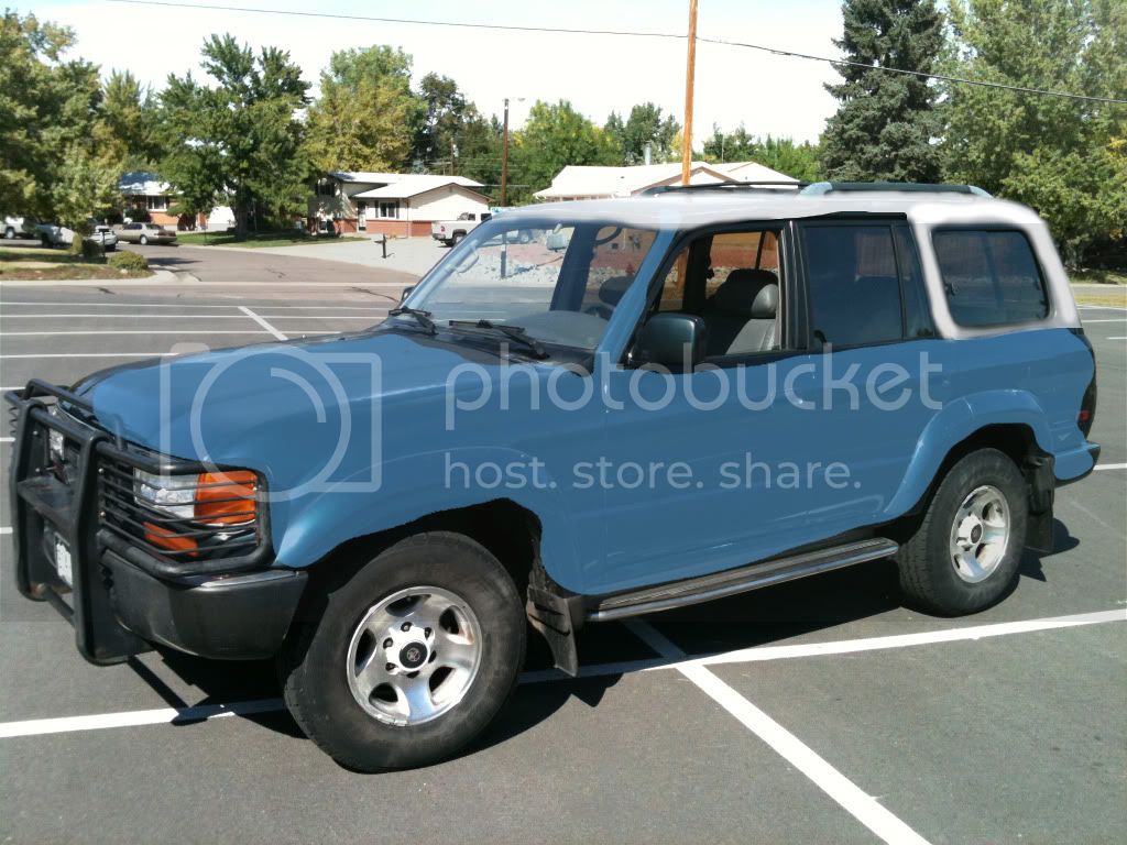

fj60/40 Smurf Blue with a White top....Battleship Gray steelies

Blue and white like this? 5 minute photoshop job. Ha ha... it looks awesome.. hope I can paint better than I can photoshop...
Hmm.. I screwed it up.. too much rum. Too much white on the back end, it's supposed to have blue to the roof.. oh well, I'm not wasting another 5 minutes fixing it.
