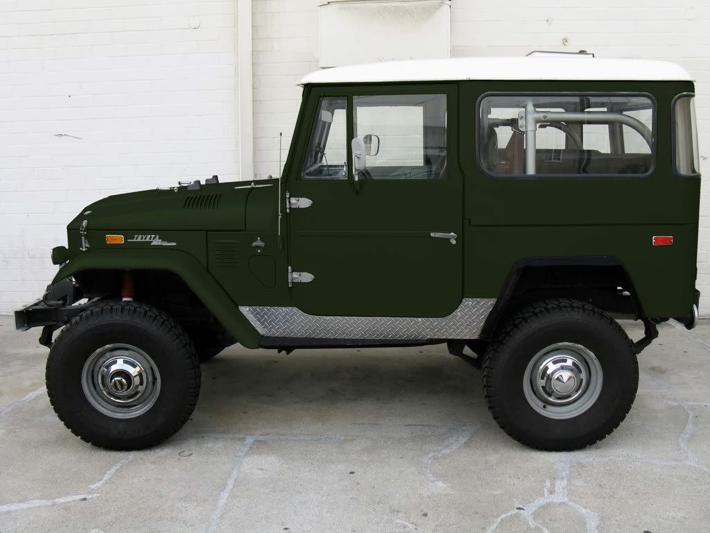

I vote for some shade of green, Olive Drab, Vista Green maybe, Kawasaki green? Check out this thread on pirate Here's a teaser (ya, it's a 40):

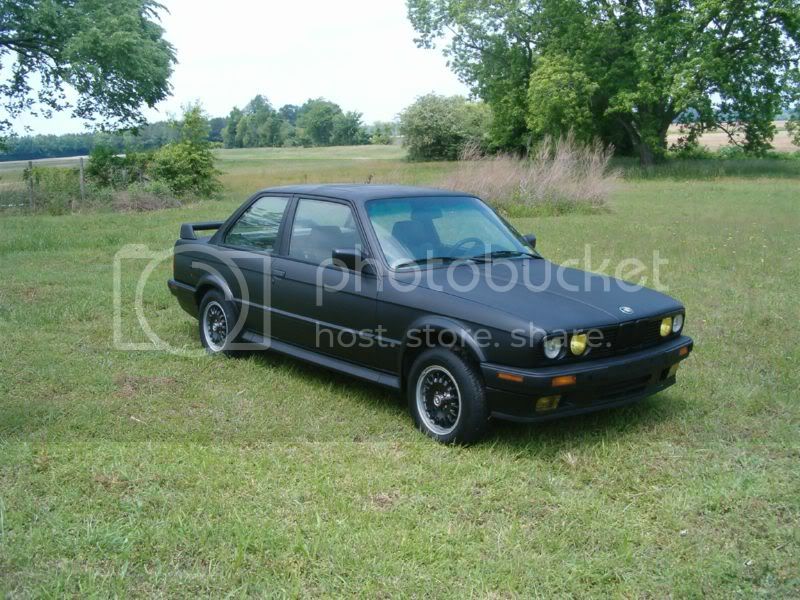

My vote is John Deere Blitz Black... Super easy to spray and super hard. Another bonus is the jams won't look so out of place.
Here are a few examples of cars painted with it:
That is awesome info. Once I destroy the clear coat black I have now I am reshooting it with that stuff.
