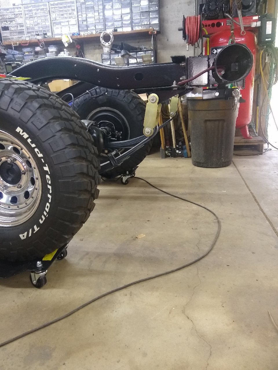

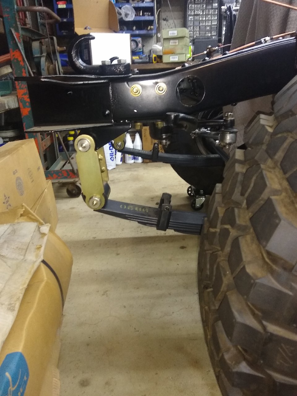

I installed this 2.5" OME lift a couple years ago. The shackles are MAF dog bones (IIRC). The angle is "ok".

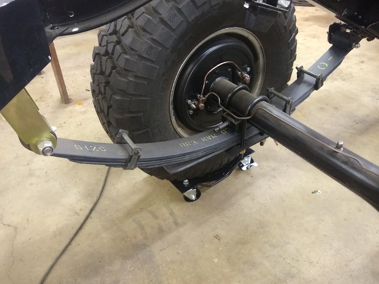

Still have no definitive answer to these shackles. Reckon I drop the tub on it. Sounds like I'll be pulling a leaf out to be honest which sux.

Ah, Rosie the load leveler!Throw a dozen/twenty bags of sand, mulch, something, in the back and let it ride for a couple of months. Ten years of travel in a few weeks. Two big girls will work also, just get the wife's blessing first.
Yeah, think that's the plan. Get the tub on then load up on sand, let it sit all winter, revisit in the spring, start from there. In lieu of two big girls, I asked the wife if she wanted the job,..didn't go over to well!Throw a dozen/twenty bags of sand, mulch, something, in the back and let it ride for a couple of months. Ten years of travel in a few weeks. Two big girls will work also, just get the wife's blessing first.
I'm voting for the shellacking, for sureHi all. In the middle of a frame off, getting ready to set the tub hopefully soon. I installed 4 new OME medium springs, 2.5" lift on the rig early spring (I've lost the tags with model numbers) so I can land the frame. I've been staring at these shackles all summer knowing something is wrong, and now it's come to roost because I don't want to set the tub with them like this. I think I did it right? The shackles are obviously pointing the wrong way. Granted there's no weight on the rear, but I had a 800 pound weight on it for a month, still the same. I'm 165 and bouncing on the bumper can barely get the rear to move. Set the engine, front didn't move,..much. I've searched hi and lo for info, the last thing I wanted to do was post pics and get a rap on the knuckles from you all, but I need a solution here. Not currently running a hard top sop hardly no weight gonna be in the ass. If it needs to be fixed, I'd rather before I set the tub. Either they are really,..springy or I'm gonna take a shellacking here. I'm readyView attachment 2817236View attachment 2817237View attachment 2817238View attachment 2817239
