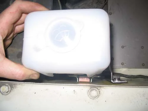

I also posted a pic of the windshield washer fluid res. setup. I was able to use the original location by simply rotating the assembly and jerry-riggin'/attaching it to the battery tray. Now I have the room I need and I can tap into the original harness/wiring setup.

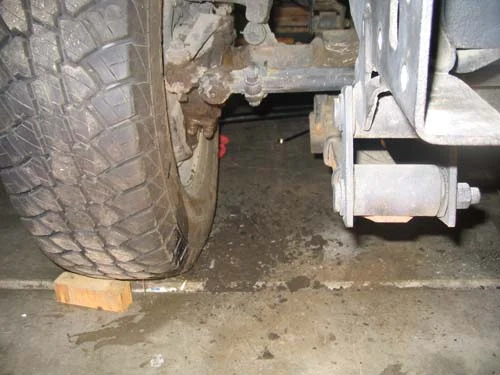

Took a couple hours to scrape mud and crap off all the front and rear axle and suspension components. Filled up the radiator with coolant and fixed a leak or two. Temporarily spliced a couple wires my buddy instructed me to connect before I tried to start the rig. I loosened the valves a bunch and then finger-tightened them. I tossed a battery in and then thought about all the connections and engine components and systems before I put the key in the ignition-and tried starting her up! After I calmed my nerves I gave the old gal a try. The gear reduction starter spun the engine like a champ and she had wanted to come alive but I have no fuel getting to the carb yet. I cranked it over a few times, a little longer each time. I swapped in a new fuel filter and cranked the engine a bunch more, trying to get fuel through the lines to no avail. I did not see any oil coming from the rocker arms which made me even more nervous. She popped and coughed but never really ran. I did however notice that I have a serious exhaust leak at the header. Stupid shat has given me more trouble than anything else on this project. I ran out of time and energy this weekend and may not be able to work out the bugs anytime soon...:( OINK!

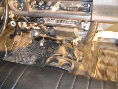

I finally got the tranny lever to seat properly. The two pins that help hold it in place are kinda loose. One is real bad the other not so bad. Aren't those pins supposed to be soild/not move? That allowed me to finally toss the floormats and stuff back in the truck to finish up the interior. Minor accomplishment but it sure feels good after all this time.

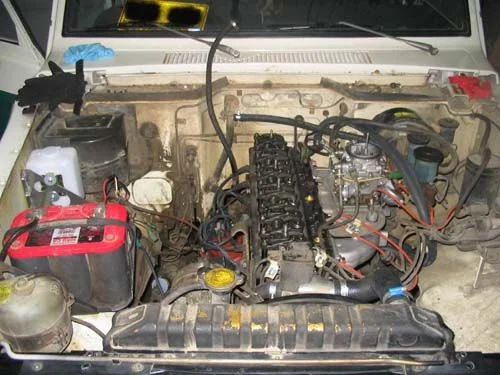

I also realized when I first tried starting her up that I had a bad coolant leak. I did not use any RTV sealant originally, just new gaskets (I thought I heard that was the way to do it, :) )on the thermostat/housing. So I disconnected the coolant hoses, removed the thermostat housing, cleaned all the surfaces, and then replaced the gaskets with new ones and RTV sealant. Threw it all back together and it apparently doesn't leak anymore, let's hope so.
I re-tourqed the manifold/header bolts to hopefully deal with the major exhaust leak I also realized I have after tring to start her last time. We'll see if that did it soon enough. I'm not holding my breath.
After dealing with that I tried getting oil up into the valvetrain/rockers in order to prime all the engine's moving parts and to be sure I put everthing back together OK. First I tried cutting a screwdriver and placing that in a drill and then spinning the oil pump that way (after removing the distributor...). It seemed to be working well enough but I bagged that idea and put things back together and tried spinning the engine with the starter (and no spark plugs) to try and get both oil to the top end and gas to the carb.
I now have oil pumping up through the rockers which is great news to me, BUT I do not have any gas in the carb yet. I tried spinning the engine for a long time like folks suggested and nothing happened. No gas at the fuel filter. I tried jacking the back end up a little, disconnected the fuel line after the filter-and nothing. Maybe I should try before the filter? Next I'm busting out the Hi-lift to jack it higher maybe. Anyway, I guess I'll try spinning it some more or I think I will 'prime' the carb and gas lines with some gas and see what happens...
