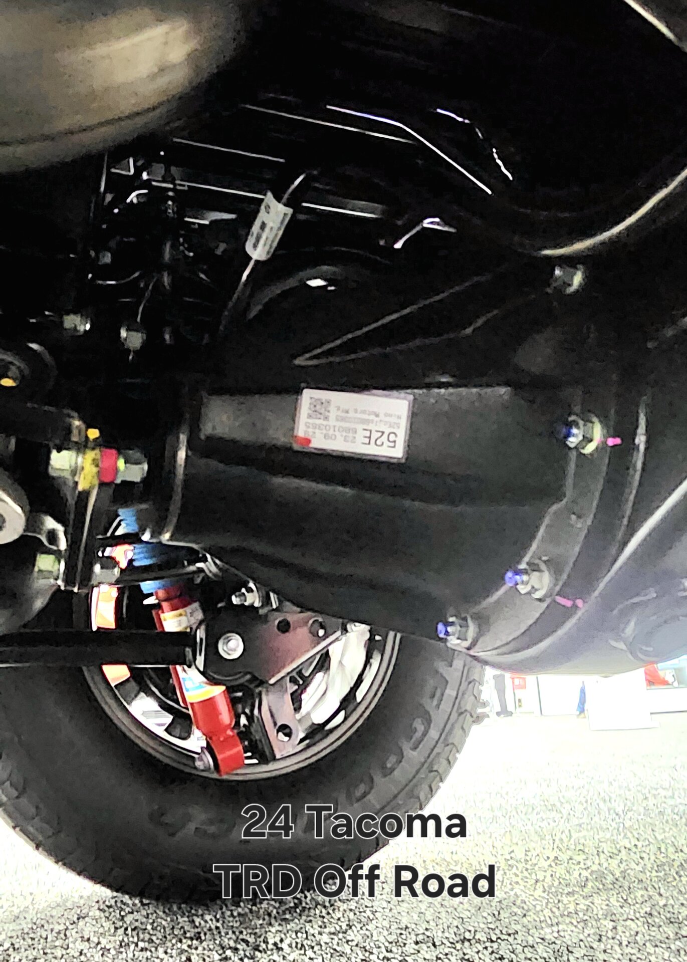

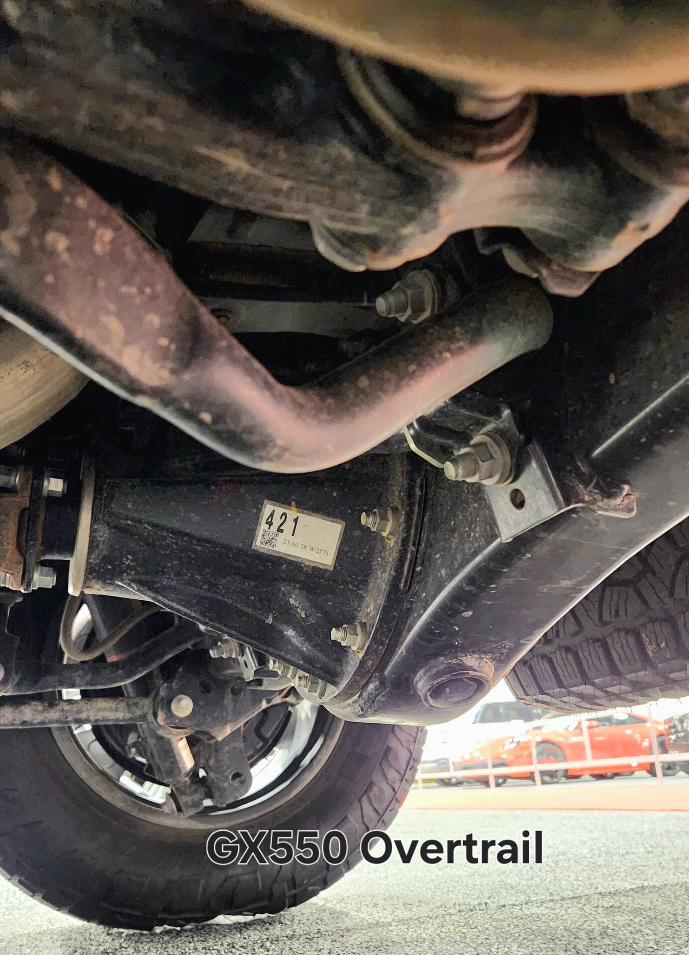

Only visual is the bottom rib location seems to be different.
The pictures are really interesting to me.
I think it's pretty obvious that the Taco and GX are different differentials, probably different housings. And it's also clear that neither is similar to the current 8.2. So it must be a new 8.2 if it's an 8.2, but it's also not the same as the 9.5 in the GX.

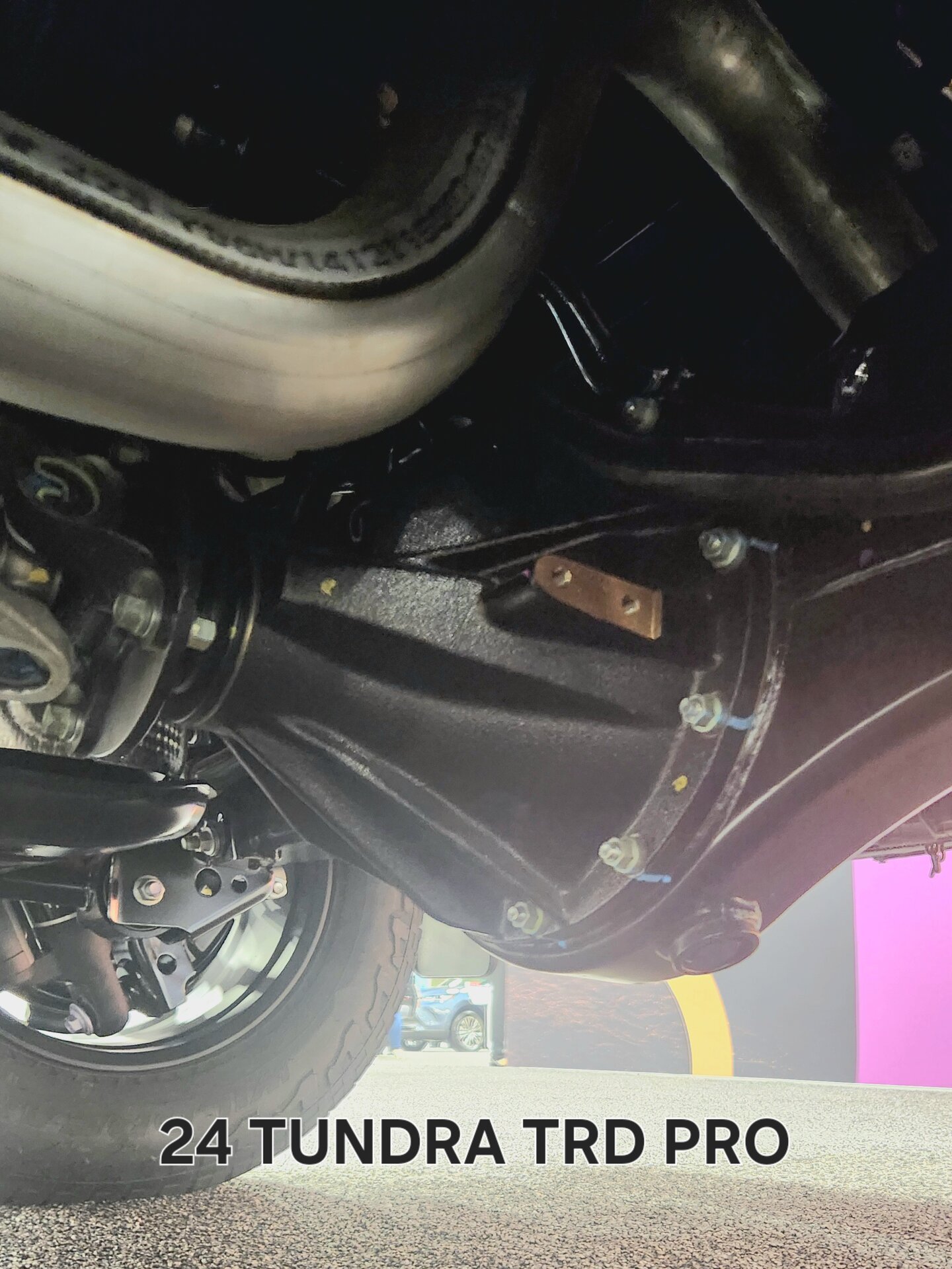

What stands out to me is that the Taco diff has a shorter pinion and a larger drive flange. The bolt spacing looks roughly similar to the 10.5" with the giant bolt flange. That might point toward inter-operability on drive flanges and shafts on the Tacoma - but why?? Also it's going to be a rock magnet. If you play too hard - it's a bummer to hit hard enough to collapse the crush sleeve more and end up with a bearing preload issue. (done that - :( )
Also - oddly the drive flange on the images above for the Taco and 9.5 have non-circular drive flanges on the diff, while the tundra has a circular one. This makes me think that the pre-production models might have non-standard parts and/or there may be different version of the 9.5 that we can't necessarily identify easily via pictures because they use different housings/components. That would be super odd, but at least I can say pretty confidently that the drive flanges on different between the LC300 and Tundra 9.5 axles. The Tundra 9.5 and 10.5 use the circular flange. The LC300 uses the star shape. In other images of the Tacoma it has a circular drive flange.

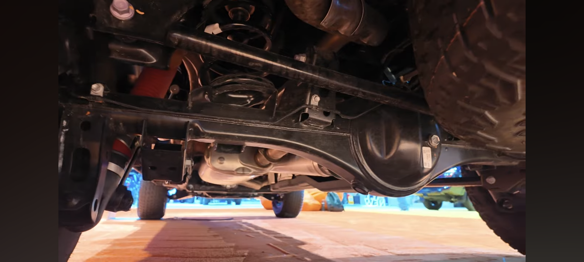

Compare:
vs:

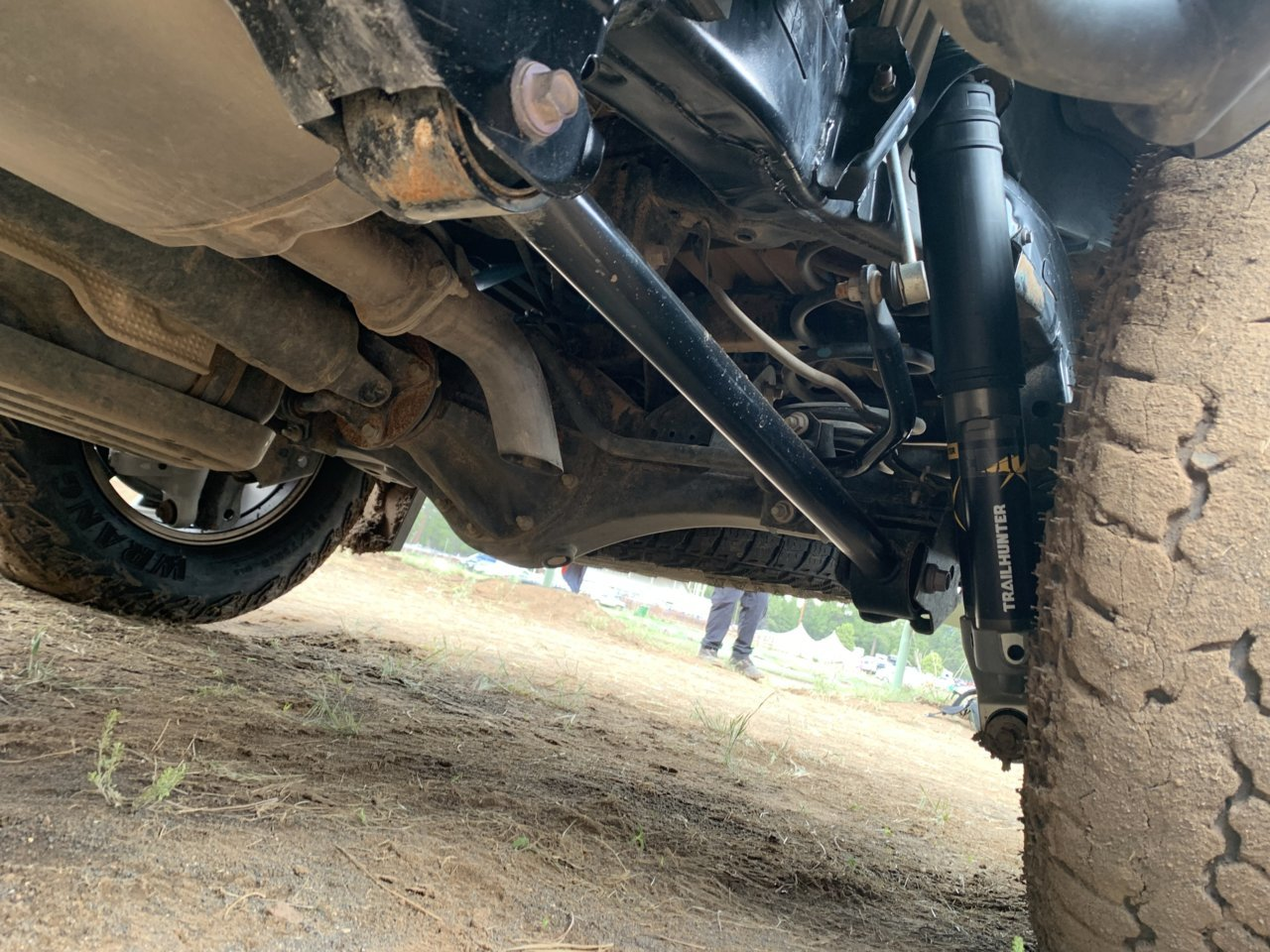

Trailhunter Tacoma pre-production circular flange:
TRD Pro Taco (circular flange)
