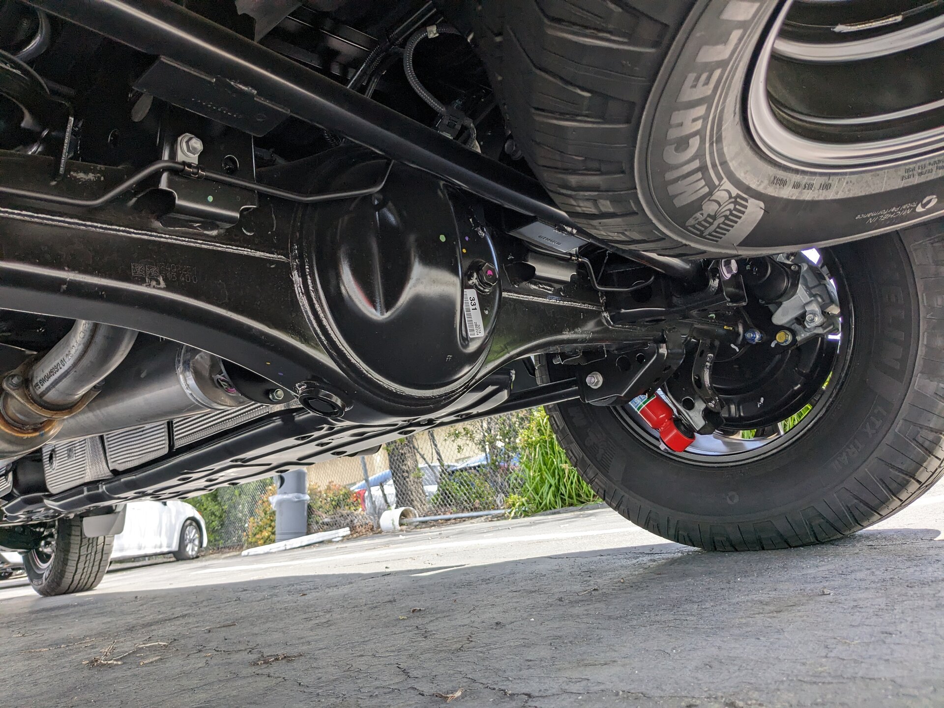

Is it just me, or is everything on the LC 250 more light duty compared to the GX 550? Not only the diff size, but look at the width of the drive shaft, shocks, pan hard bar, link connections. Holy crap did they neuter this thing to make some MPG’s.
The only thing better on the LC 250 is the Michelin spare tire :rofl:
Neither of those photos are of an LC250, in case you were curious.
First photo is a 2024 Tacoma TRDOR with the 8.2" that we saw on the Land Cruiser prototypes in SLC (and will be in the production vehicles as well).
Second photo is a 2024 Tundra TRDOR with the 9.5" that we find on the GX550.
The banana skin spare tire in the Taco gave it away. :banana:
