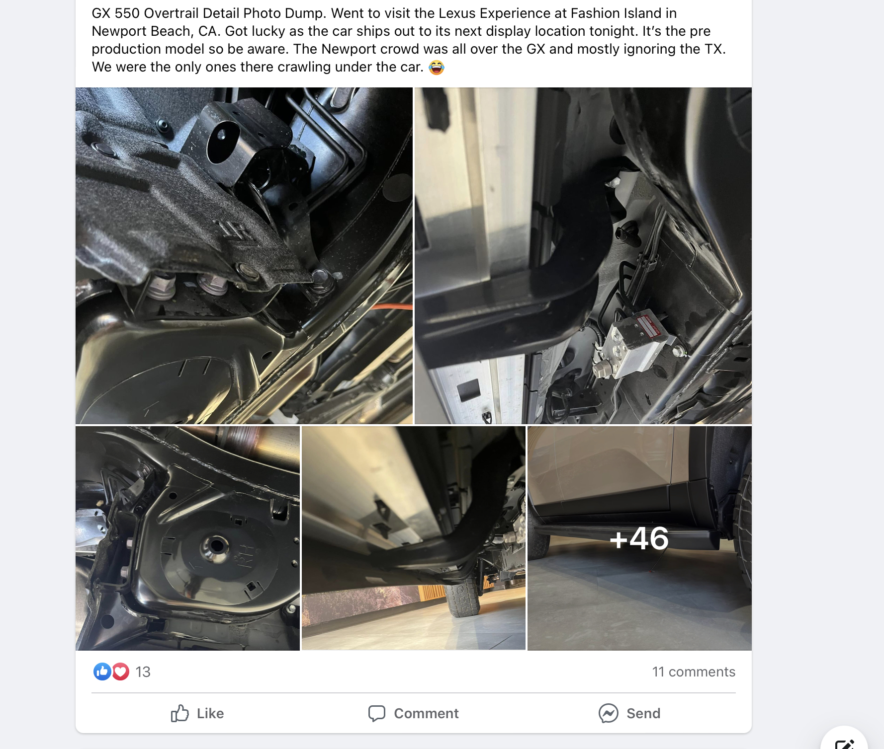

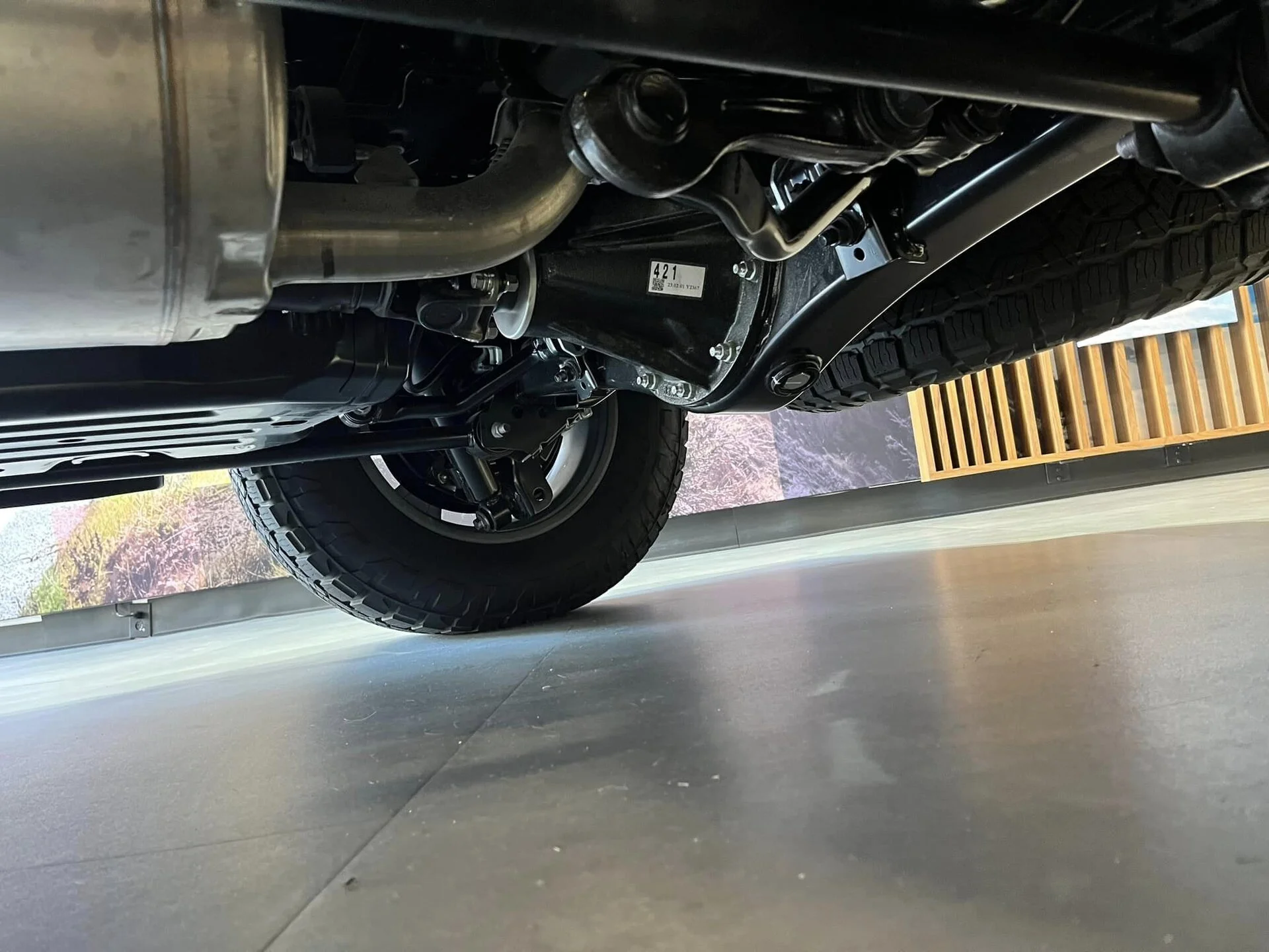

Quite a few underbody pictures in this GXOR post

Those are great photos! Thank you for sharing them.

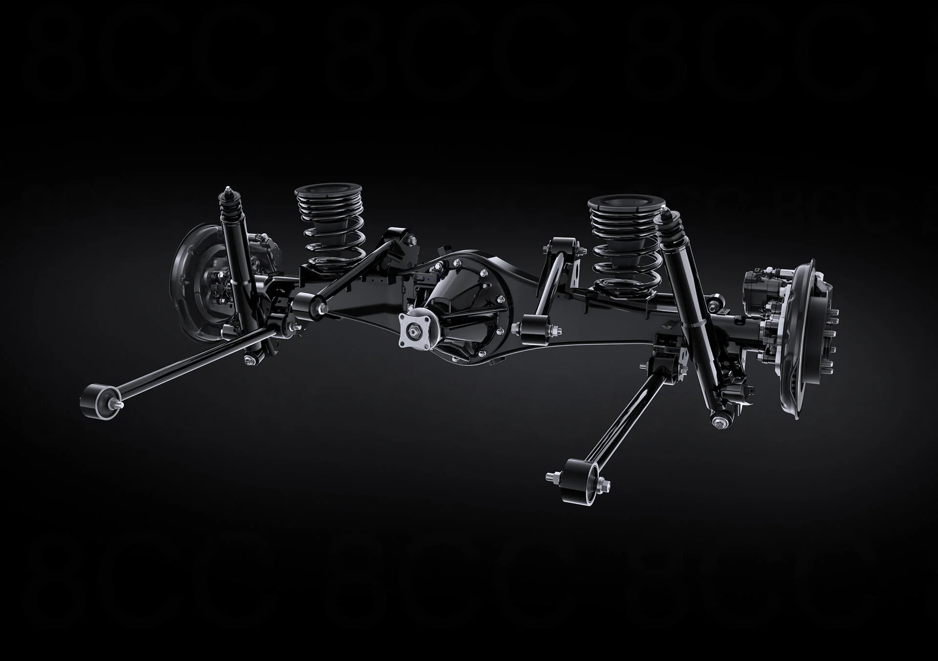

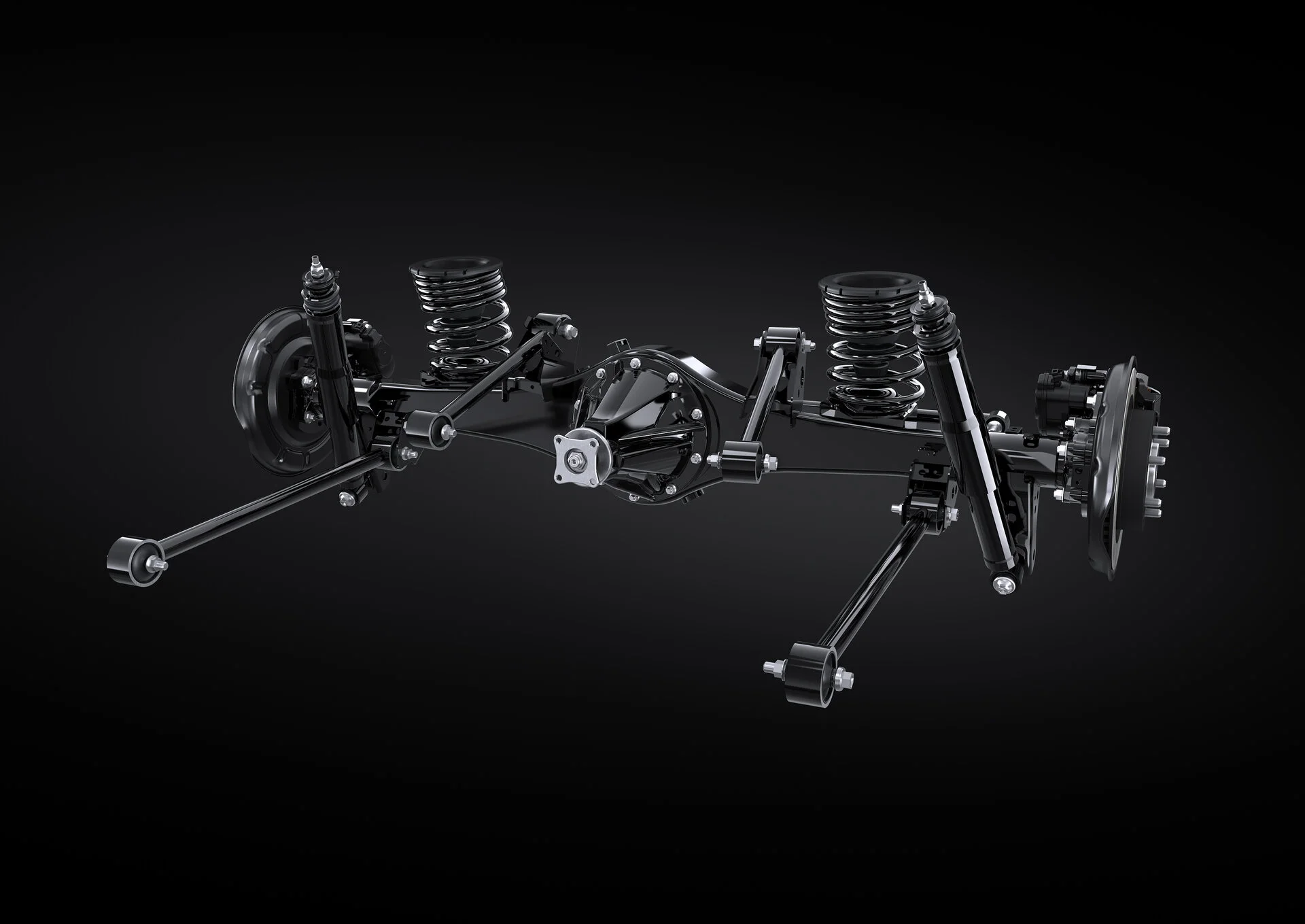

I notice a few differences from the official images of the suspension. For example the rear upper control arms are different. As are the front UCAs.
Other thoughts - spare tire offset to one side to make room for the rear exhaust resonator/muffler is going to be a problem for larger spare tires. I can see that rear muffler going in the bin pretty fast for anyone fitting bitter tires.
And the trailer wiring is in a poor location. That gets ripped off on the first obstacle on any challenging trail. So that'll need to be relocated ASAP for people who want to use in the dirt. The last GX/4R location was also a bit of pain up beside the spare - but it was very protected. Would be nice to see it just mounted in the bumper like every truck has been for 30 years. Not sure why it needs to be underneath.
It also looks really well sorted in general. From what I can see - it looks very heavily built with the bigger rear axle from the LX and the mounts look beefy for all the suspension parts.

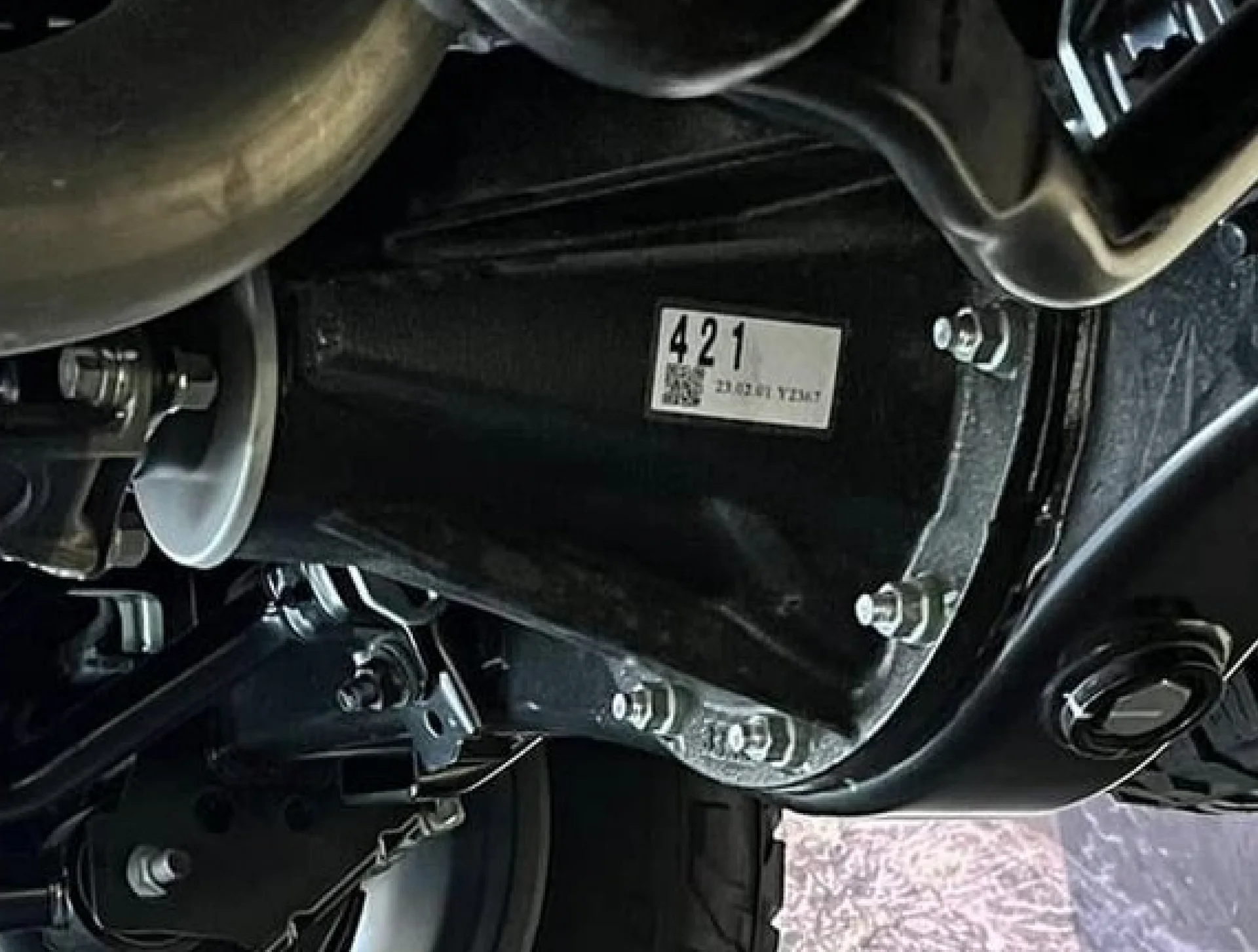

I wish they would give up the welded-on diff cover. (or at least make it beefier) Here in the land of salt and snow they melt away and a 50 dollar replacement becomes a thousand dollar repair.
I've never heard of this as a problem. Other than the c-clips on my FJ40 I can't think of any time I've ever wanted to take the cover off.

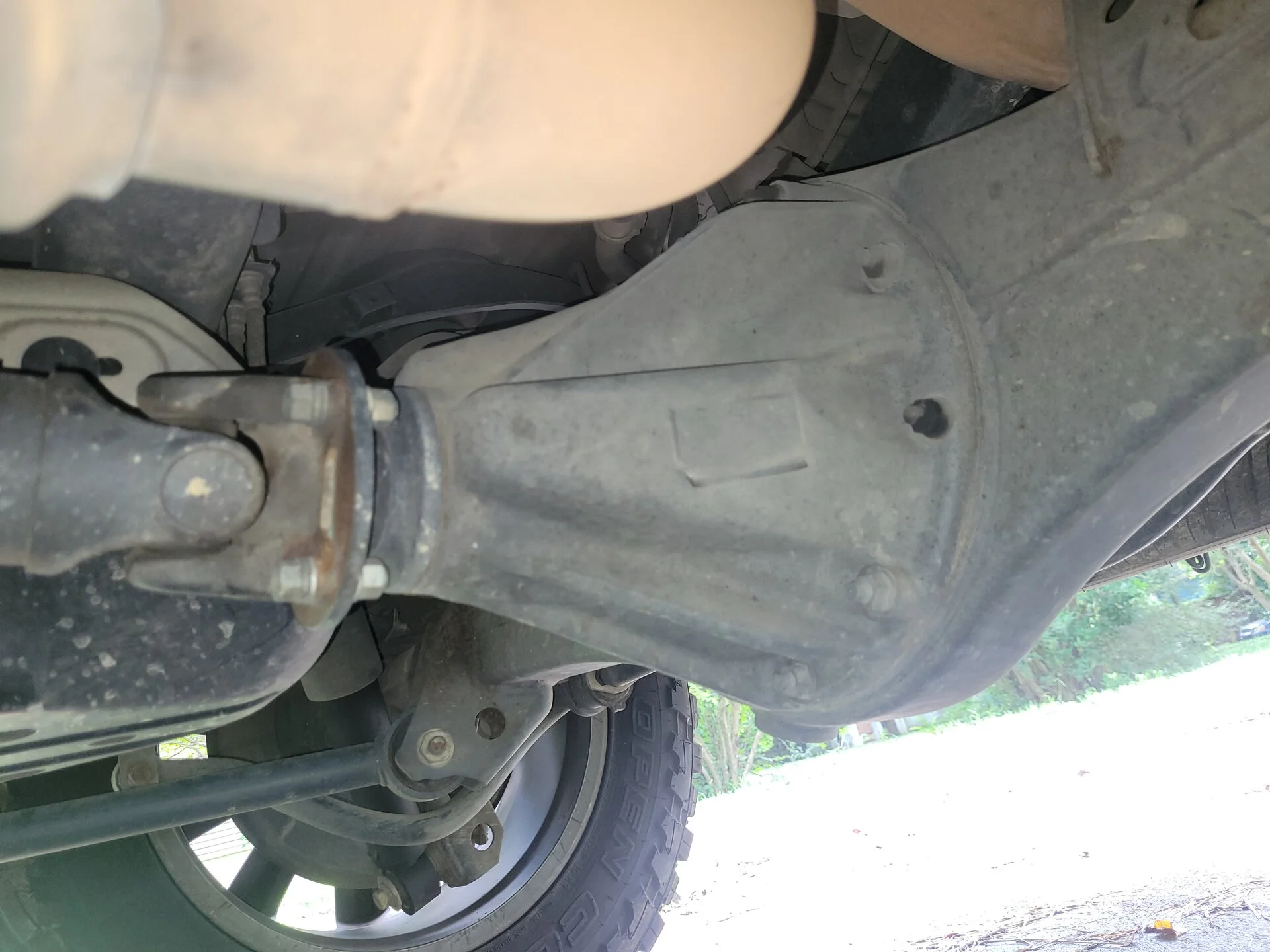

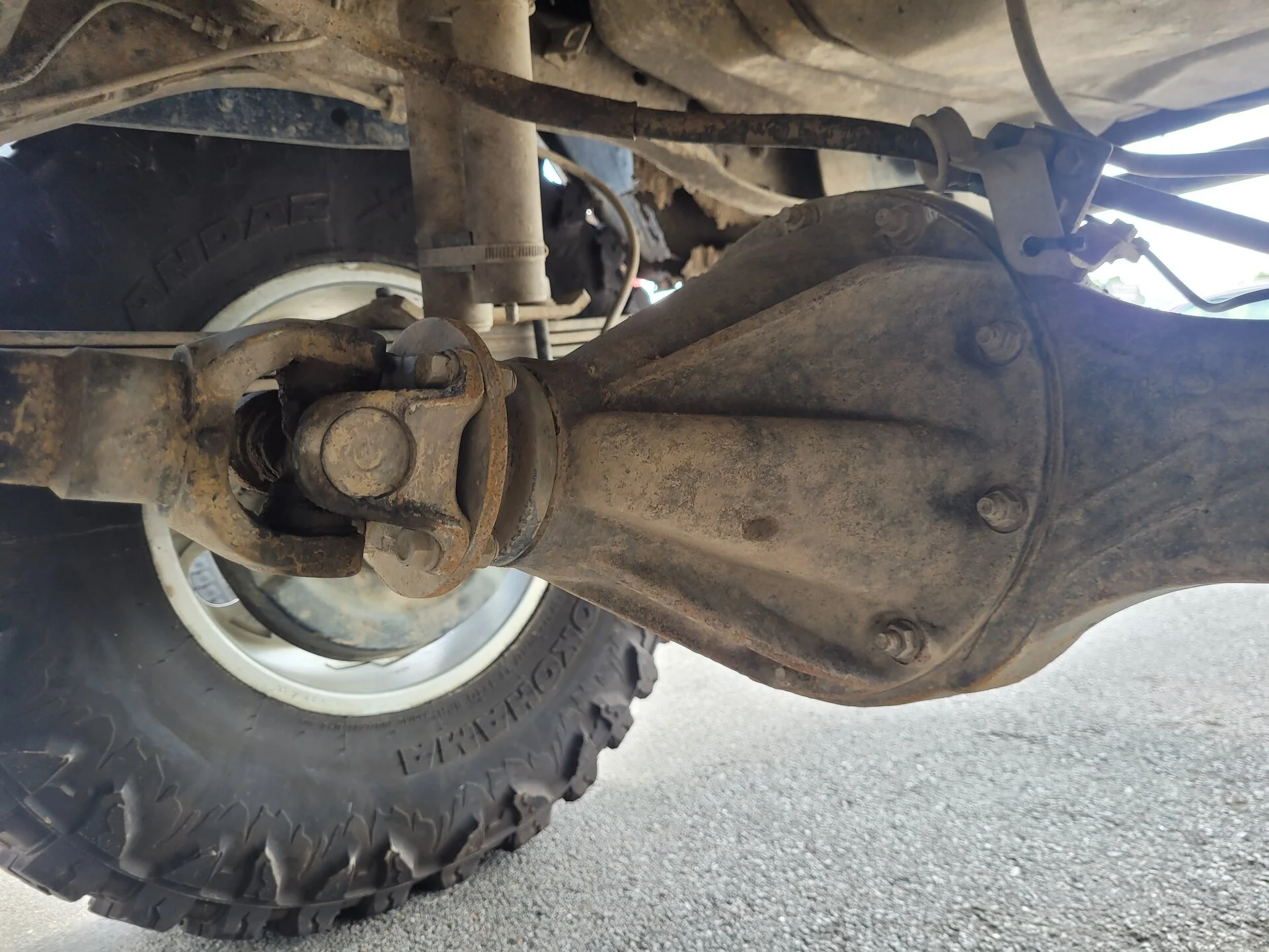

That's an 80 and a 200s rear diff.

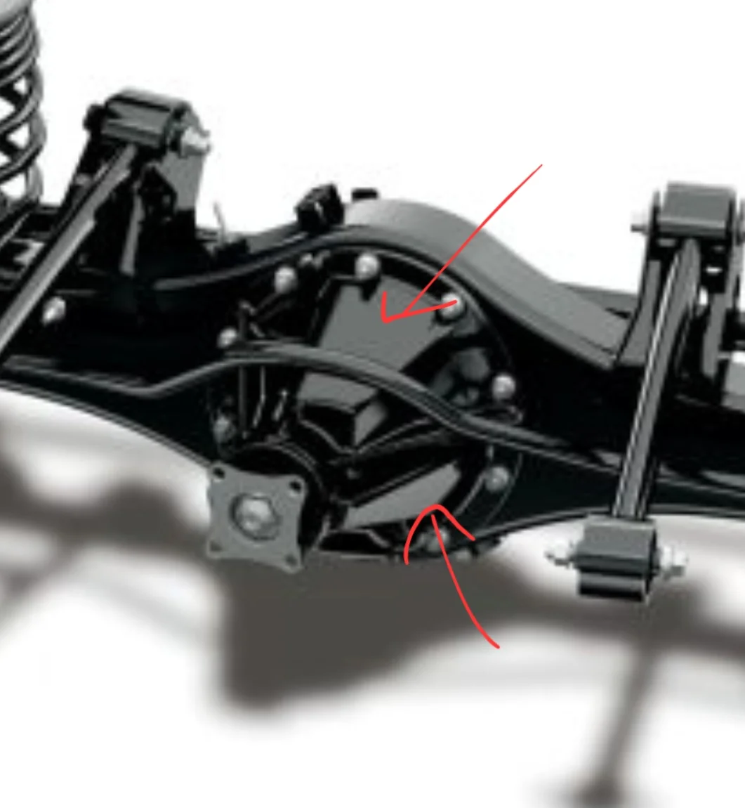

300s rear 9.5 diff, red arrows are the same large oil galleys seen in the 80/100/200's 9.5 casting:
Totally different castings to what' s shown under the 550. Doesn't help that neither of the preceeding Prado-based driveline got the LC9.5...they got either the 8.0 or 8.2.
*edit - the more I dig, the more it seems an 8.2 is used. Fine by me, still a good diff and lots of parts available.

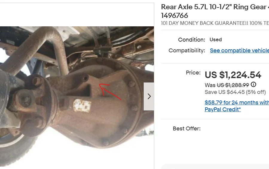

Pretty significant difference between those two...the Tundra has a mounting boss in the casting that the GX doesn't. Also worth noting, that's not the same boss seen in the old Tundra 10.5:
