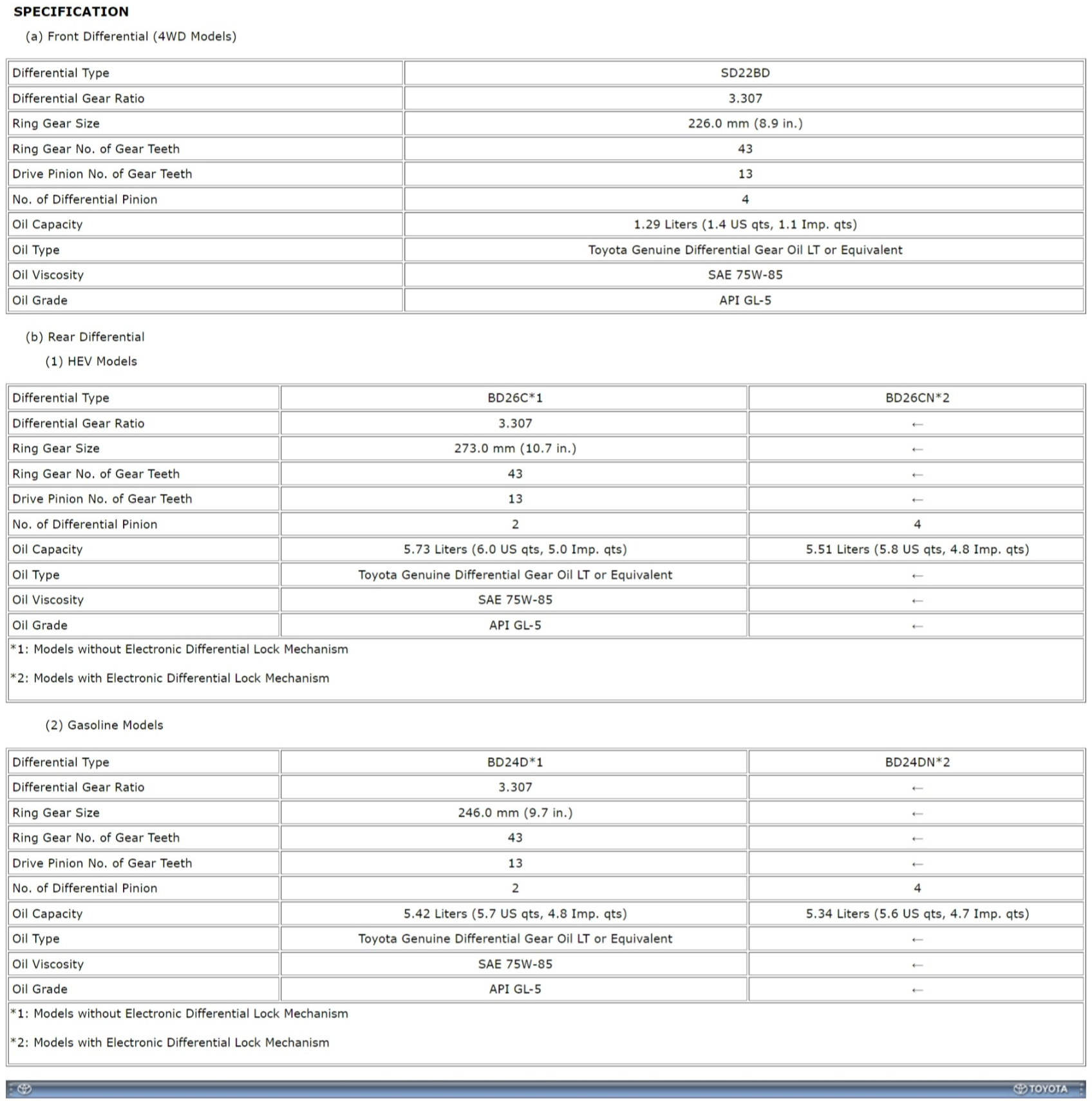

Just for folks who maybe didn't look super close - the 4.78 diff ratio is a different rear axle size. It's the 8.2" diff rear and 8" front clamshell rather than the 8.9/9.5 combo.
What's interesting is that those new parts might be direct swap for the current GX460/4Runner. So - maybe there is now a new OEM setup for those folks. But they don't fit the new LC250 in the USA version.

Am I reading all this right? Seems like the "TNGA-F" platform has a large truck scheme and a small truck scheme.
The TNGA-F platform allows Toyota the flexibility to have certain vehicles (Tacoma, GX550, LC250, 4Runner TBD)) running smaller diffs and others vehicles (LC300, LX600, Tundra, Sequoia) with larger diffs? They do not appear to be in fact identical has has been widely touted and publicized.
If I am reading this right the "Land Cruiser" as we know it in the US market isn't sitting at the big boy table anymore.
On the J252/GX550, what is the other front diff option? SD20D is shared between the LC250 (only option) and the GX550 at 8.2" but there's another SD22B (8.7") - but I don't see anything in the US materials showing a different front diff for the GX.
Also, it looks like rear diff on the overtrail GX is different from the LC250.
I'd really love a deep dive as to how these vehicles are different.
from the images above it seems the LC250 get smaller front and rear diffs than the VJA252 GX 550.
The above info I posted is for the global LC250 which doesn't get the hybrid T24A and includes the non hybrid variant of the T24A.
I had assumed maybe the US spec hybrid would get different diffs -
but if you see the specs for the global GX varient with the smaller engine ( T24A hybrid - same as LC250 engine ) it also has the smaller diffs.
So out of all the 250/252 series vehicles, the only one with the larger front and rear is currently the VJA252.
