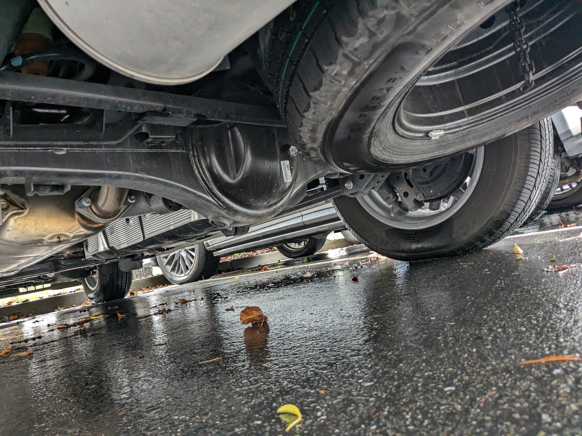

250 rear diff
Only a 1/4 fuel tank skid on the 250, wtf? My 4runner came with a full fuel tank skid.
Good catch. The GX550 has full length. I'm curious if that is production.
Looks the same as the 600?
I don't know.

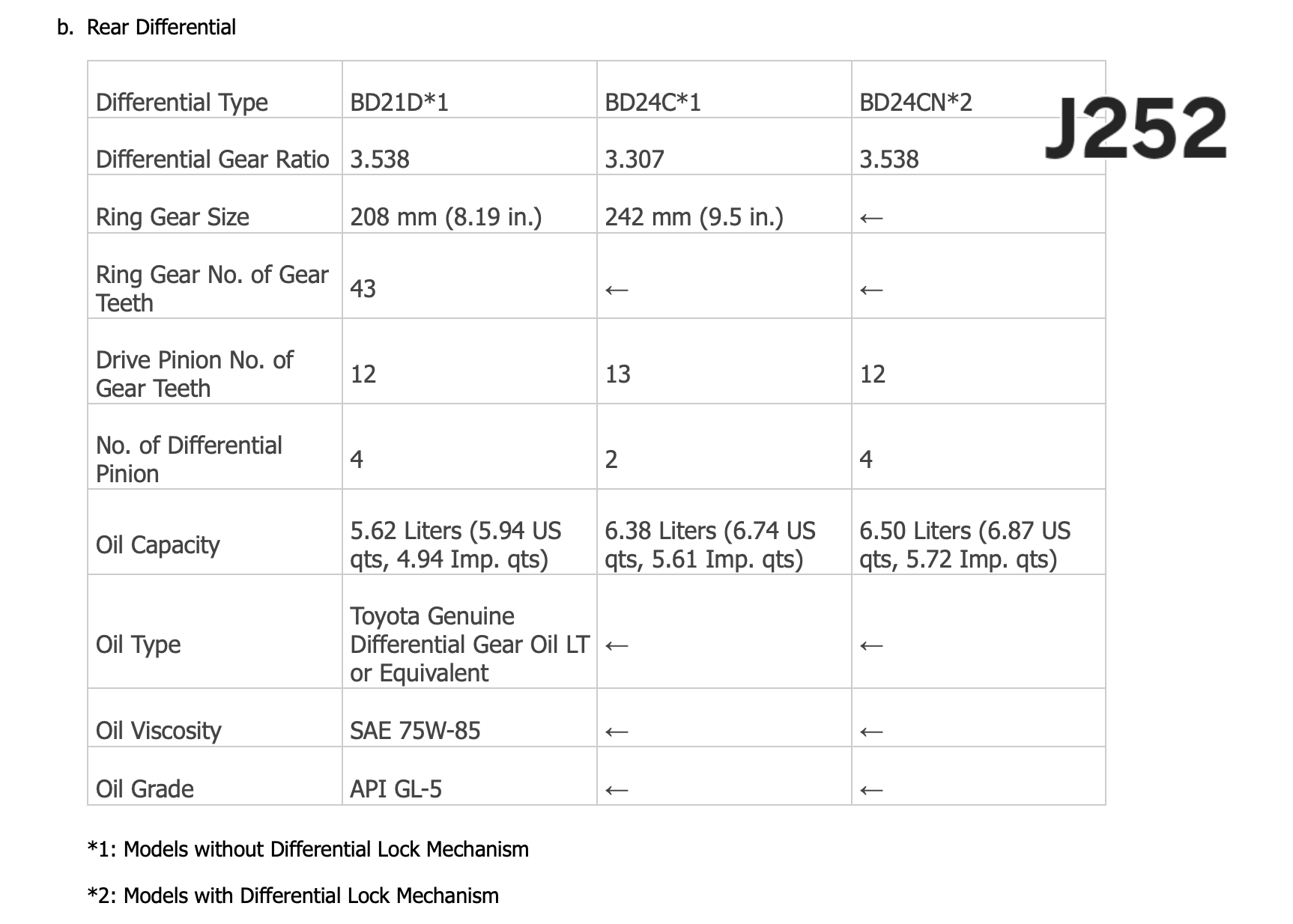

From the tech sheets posted previously and the photos, this is what I gather:
The hybrid Tundra (and maybe Sequoia) get the 10.7.
The gasser Tundra/Sequoia get the 9.7.
The J300, LX600?, most J252 (GX550) - likely all US models, and Trailhunter Tacoma all get the 9.5.
And then the LC250, some world market J252 (GX550), and the rest of the Tacomas get the 8.2.
We still haven't seen anything production for the 250 as far as I know but all of the photos of pre-production units appear to not match either the 9.5, 9.7, or 10.7, despite statements from others.
Perhaps the lower power and smaller engine (4 cyl) are going to bring the 8.2" rear diff but there appear to be exceptions (like the Trailhunter Tacoma). As I understand it as well, the J120 and J150 had the smaller diffs (8.2") so it wouldn't be unheard of to carry that on for the light duty platform.

Also worth noting that the current 8.2 rear axle does not have a multi piece welded design. Also the drain plug is on the other side - so if this is an 8.2 it's not using the old housing. It's a single stamped housing. All of the newer diffs look like a 2 part top/bottom with more square profile beam and welded on plates at the diff cover along with the welded on diff covers. A lot more parts and processes involved in the new rear axle manufacturing. Curious why the change.
There is another OEM gusseted 8.2 OEM housing, but it's still quite a bit different from the new LC250:
This start to make sense. The only one that would get 9.5 BD24 is TRD sport MT with open diff and TRD off road MT with locking diff.
All the Hybrid and other would get BD21 and line up with Land Cruiser.
Sherrod Brown is not wrong it would get bigger diff, but only on MT equipped. MT are a lot harder to drivetrain due to more shock loading.

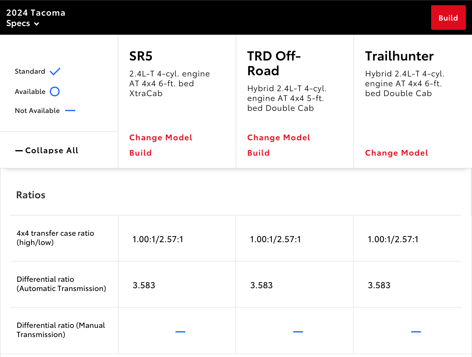

Based on the spec sheet above, for Tacoma, gear ratios denote size among locking diffs, where the only 9.5 locker, BD24DN, is 4.3 ratio, and the 8.2 locker, BD21CN, is 3.583. Toyota’s website lists a 3.583 ratio for the Trailhunter and TRD Off Road hybrids; unless the spec sheet or website is incomplete/incorrect (such as those trucks using BD24CN, which is 3.583, like the GX, or another larger locking diff with 3.583), those hybrids, both with locking diffs, presumably use BD21CN… Unless I’m missing something (entirely possible).
Edit: I was apparently missing the fact that the Tacoma spec sheet is in fact incomplete and does not include diff spec for hybrid models.
I don't think the parts spec sheets include the hybrid yet. Toyota is years behind on all of this and I think that may be part of why it's such a train wreck of a rollout. The max torque on the rear end will be in 4lo in some off-road scenario. I think the auto would be just as hard on it as the MT. Probably more torque than the little flywheel on the T24A has to drop. But I'm just guessing.
Ah, I see - I was missing something. Thanks.
