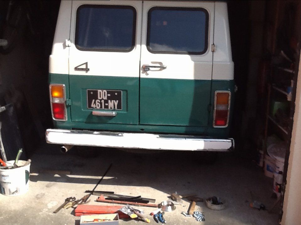

Hi, As I waited the weather is cold to fix the doors an it did not really get very cold, I did nothing more. as I will not be able enjoy my piggy during this task I prefer to be lazy. But for the next spring it will be done . i am thinking hard to make a rear bumper who look oem as much as possible. And strong.
I'm guessing that with the ingenuity you've shown so far and some steel channel cut and boxed in the right way, you'll be able to make a really nice substitute. I'll be watching!

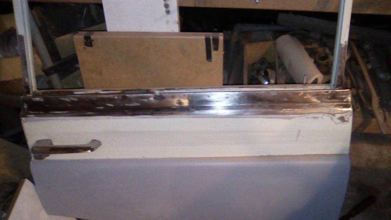

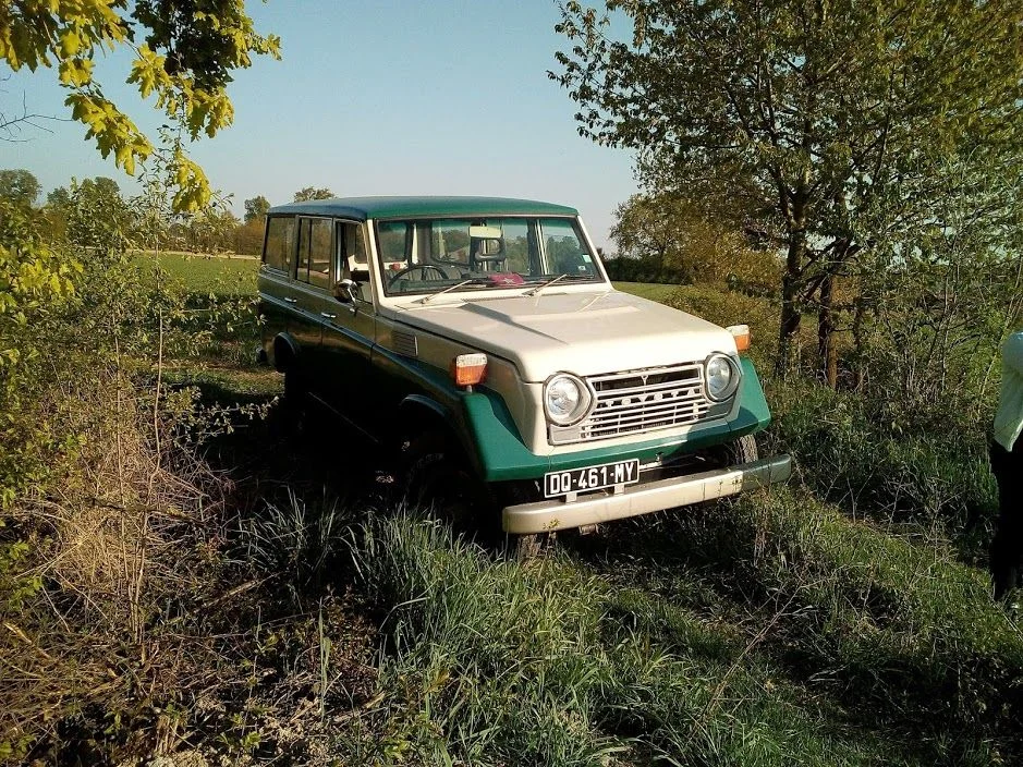

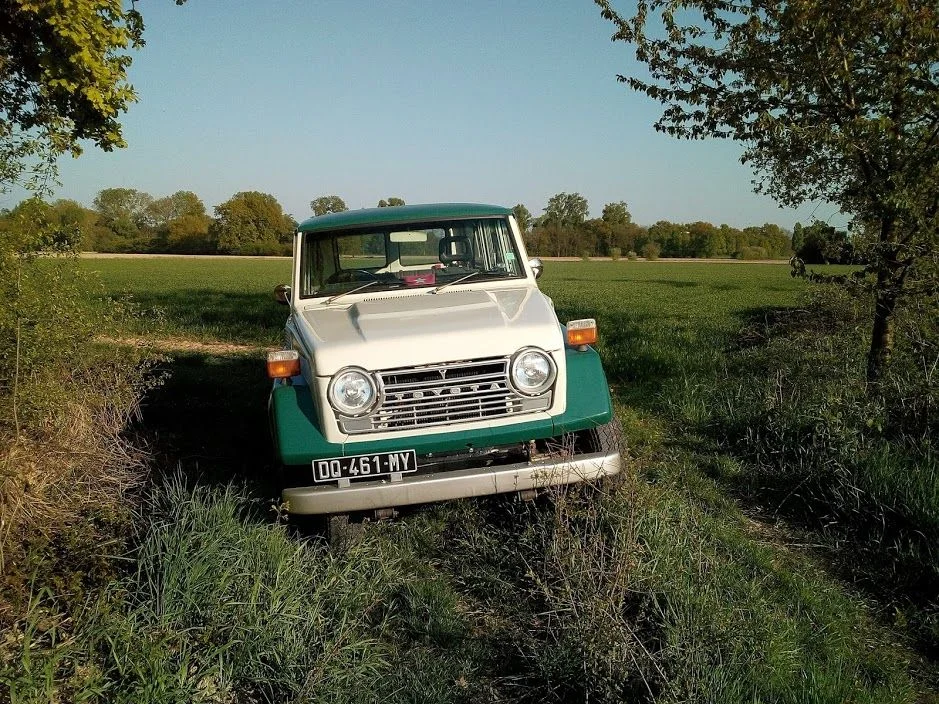

quick update. finished right doors, installed yesterday, and made a small trip to hear the engine purr. then a car wash.
tomoroww I will get new mirrors, then I' ll have to install driver glass.

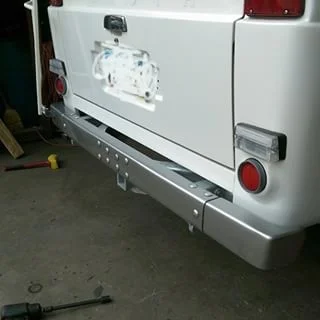

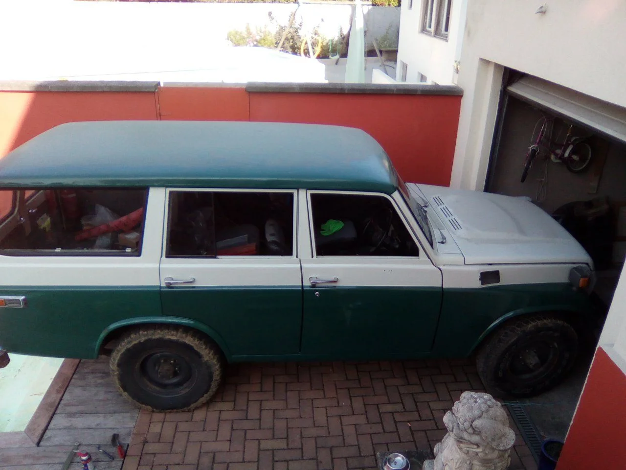

Update. Finished the left doors and the rear bumper made with a front lj 70 bumper. A huge work. Cut in lenght cause it was too high. Then made it wider with a modelled part welded in the middle, and changed the angle of the side parts. Much cutting, welding, grinding, sanding. It is the most oem like I could do. Quite happy. Some pictures
Perhaps, but I think your one is stronger than mine. Anyway for my use il will be ok.

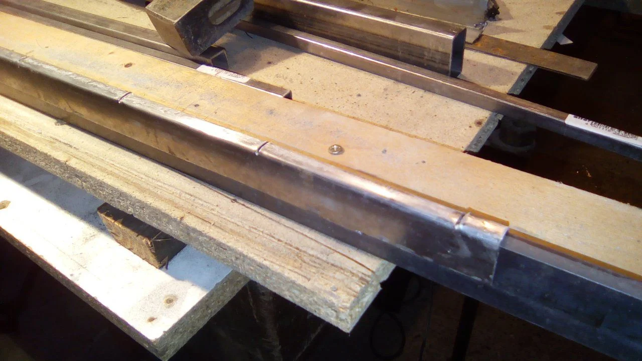

Hi brisvaganbj42. For the roof I reused the main part, I just replaced the edges, then put the reusable part on the new parts and welded it. Not a very nice job but I did my best. I am still thinking on building one in fiberglass, but it needs a to builld a model in any material, then a mold, then the roof. Much work and much time.

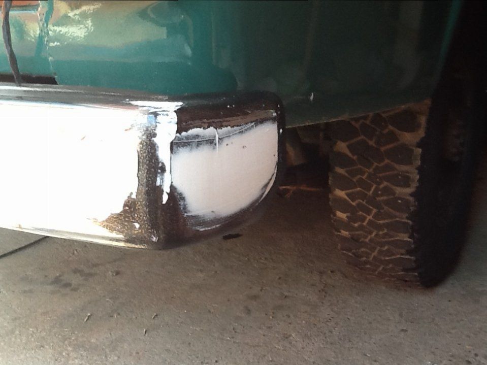

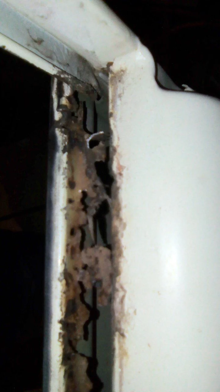

Repared the front bumper and new paint. I am still for a solution to spray rustol, a kind of rustoleum we find here in the roof channels before reinstall a .headliner. Any idea?
