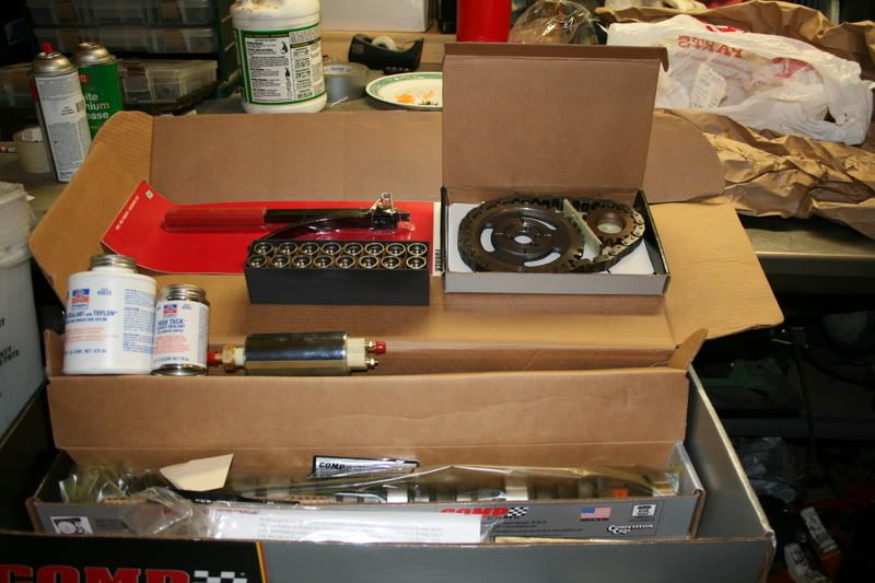

Just ordered this:
COMP Cams SK12-210-2 - COMP Cams High Energy Cam and Lifter Kits - summitracing.com
and
COMP Cams 7812-16 - COMP Cams High Energy Pushrods - summitracing.com
I cant see paying $300+ to go the beehive route at least on this build... I think this is a good medium ground for my motor. I also have to remember that I will be still running toy junk under there for awhile. The comp cam calculator has the motor at 360hp and 410ftlbs. :). I can live with that. :D

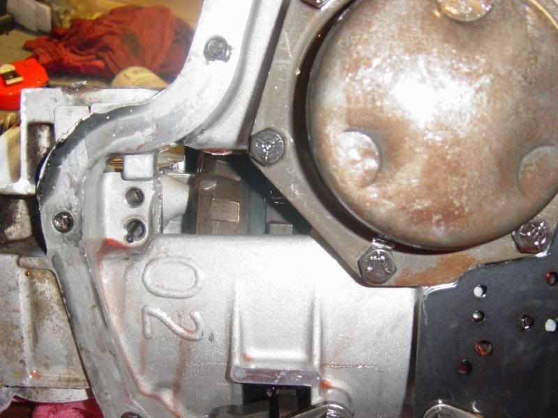

So I had some time tonight so decided to start pulling apart my th400 to swap the output shafts. I bought a later model th400 with a round bolt 205. To make everything work for a 203/205 I had to get the right output and adapter. I'll still have to swap the input on the 205 but that'll be another thread. Anyway... I found a good thread on pirate to follow along on and went for it:

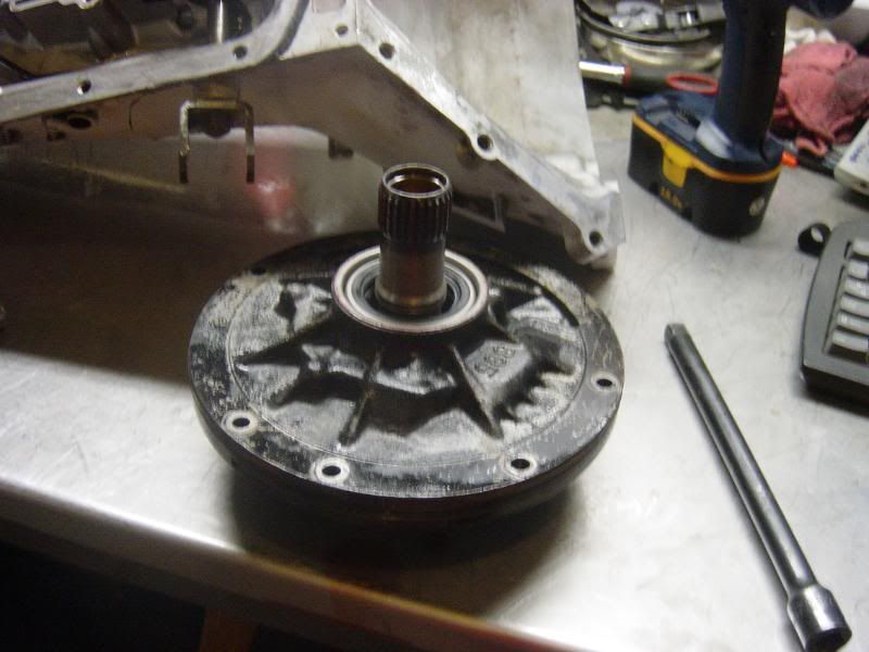

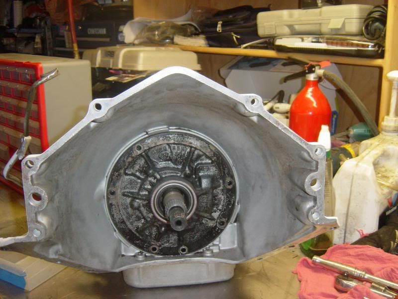

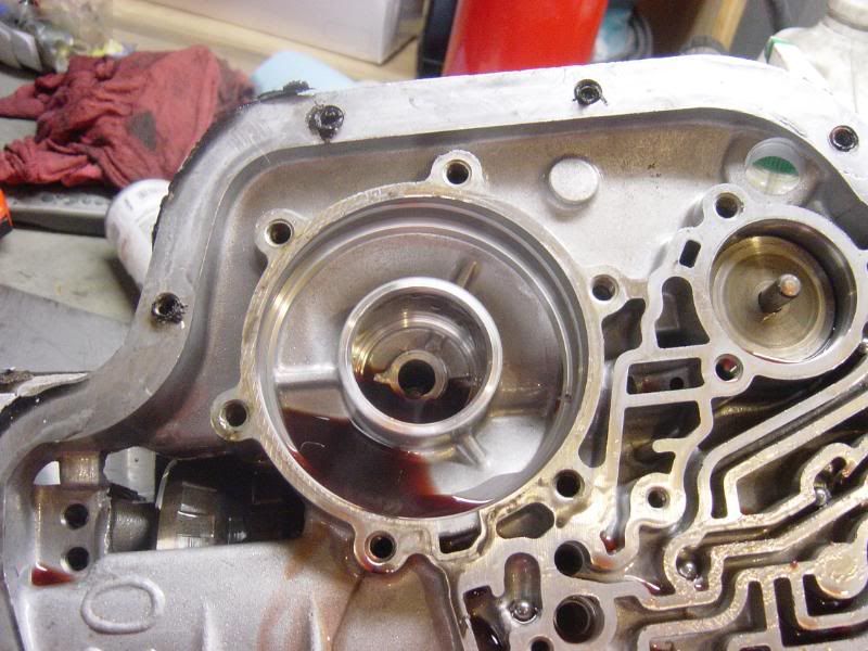

removed the pump bolts:
I reached up with the back of my ratchet and ever so gently popped out the pump:

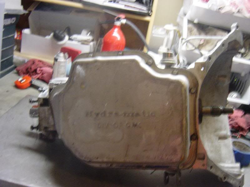

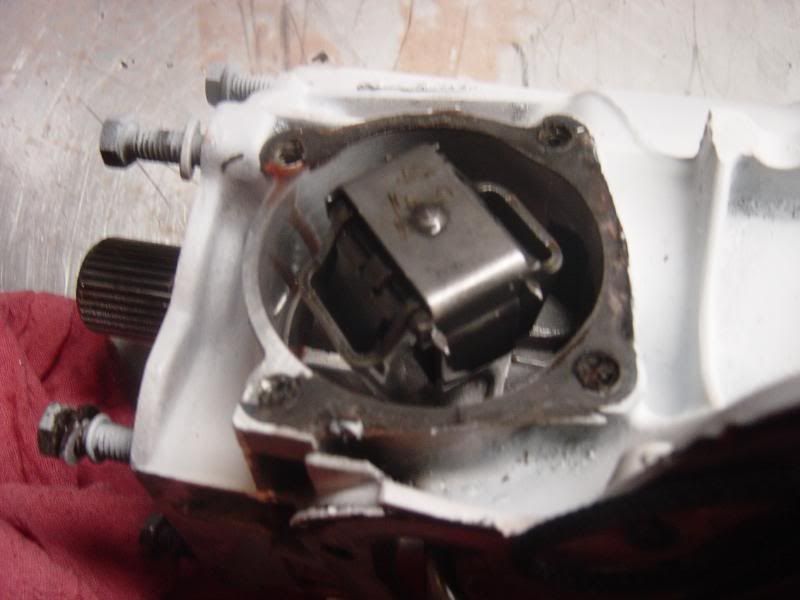

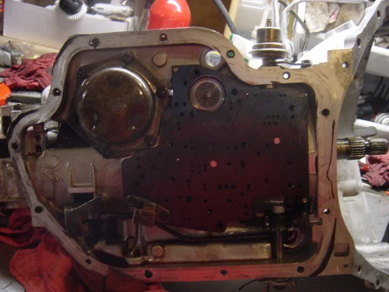

next I pulled the pan:

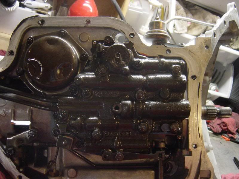

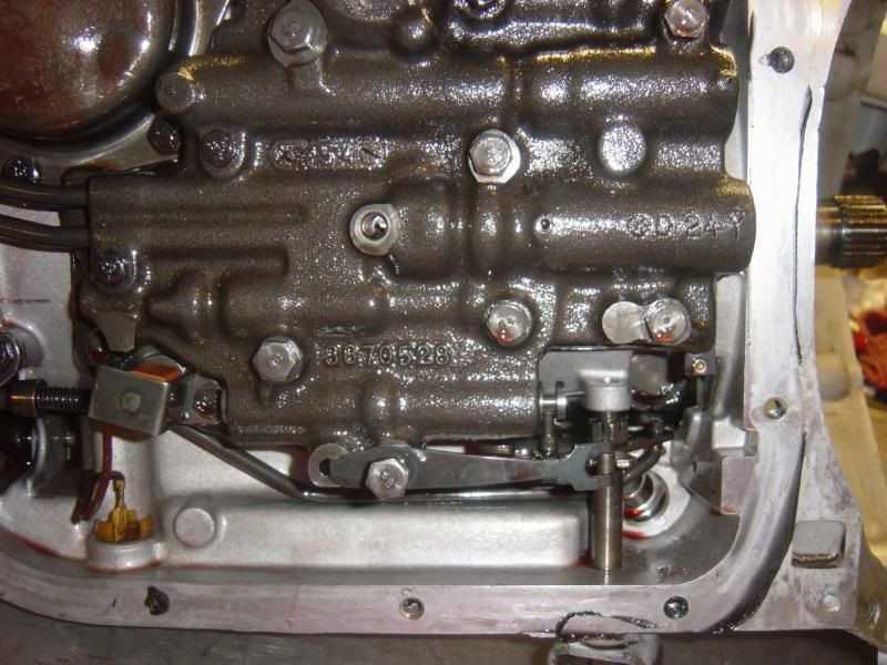

which exposed the valve body:
and the roller thingamagig:
speedo:
then pulled the valve body... the suggested way was to do them evenly:

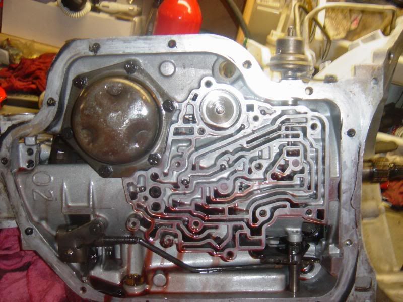

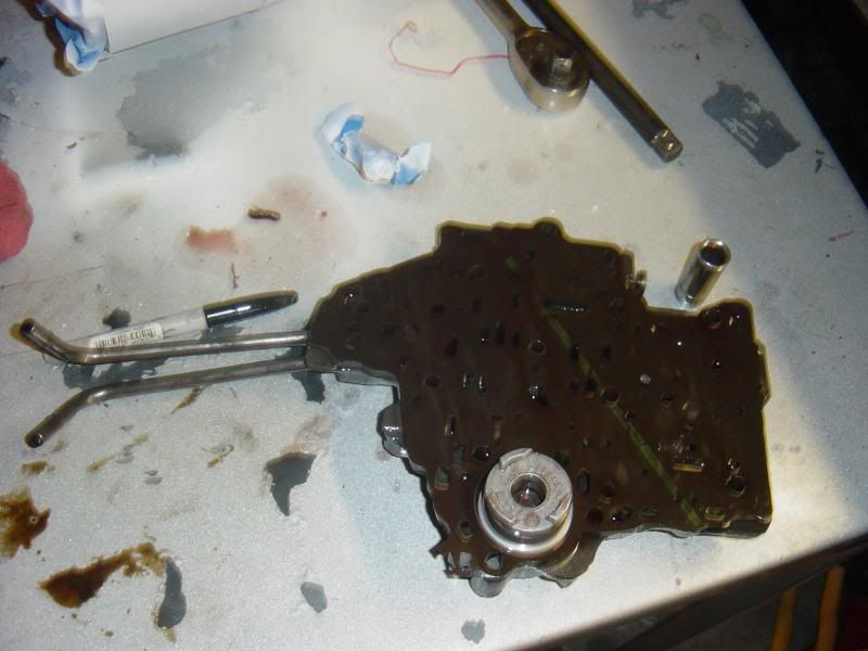

valve body on the table:

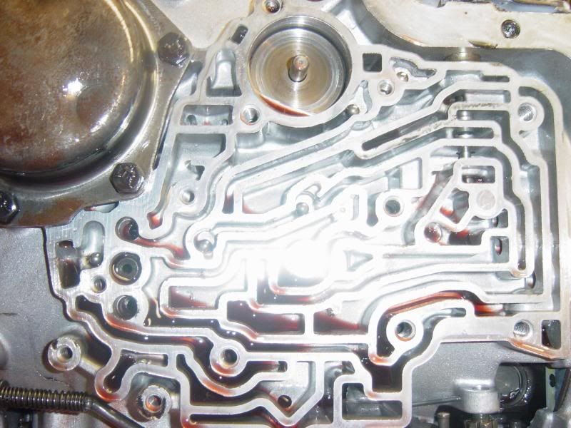

and what's underneath:
lots of little paths and steel balls:

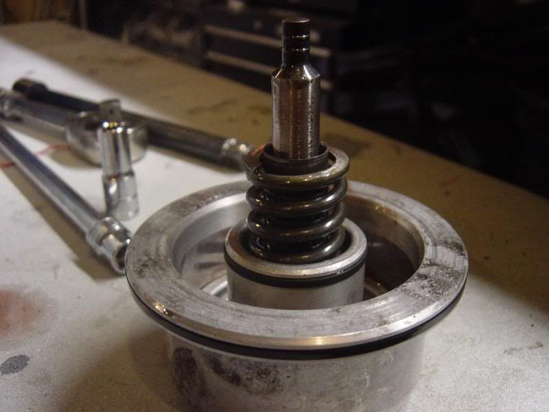

removed the servo:

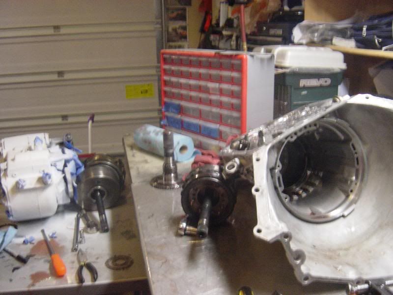

now it got interesting... I tried to pull everything out in chunks.

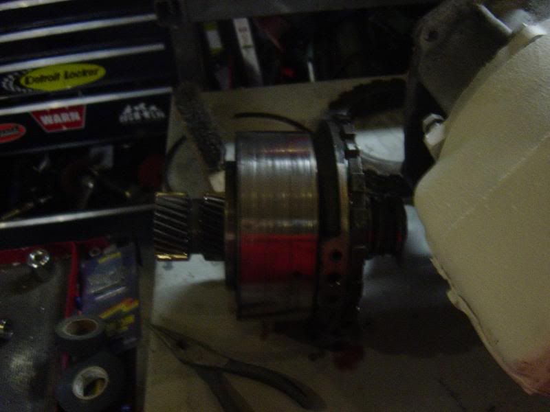

First was the foward clutch which came out pretty easy:
and out
and then the direct clutch. it was also pretty easy to remove:
I forgot to take a picture of removing the band but basically there is just a little pin to move and then it come straight out...

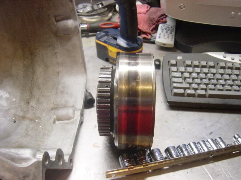

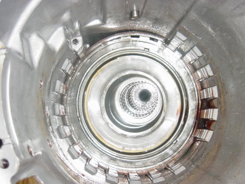

then the intermediate clutch. Kinda tough to see but there is a snap ring that you have to move past the little stops:

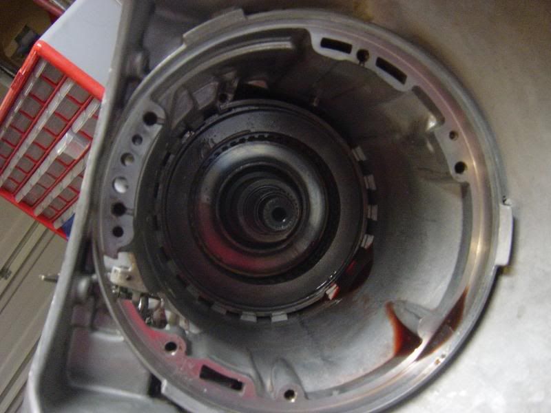

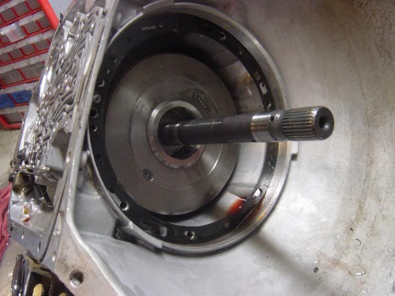

then the biggest pain... the center support snap ring.
but I won:

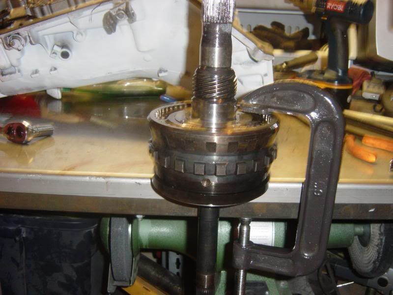

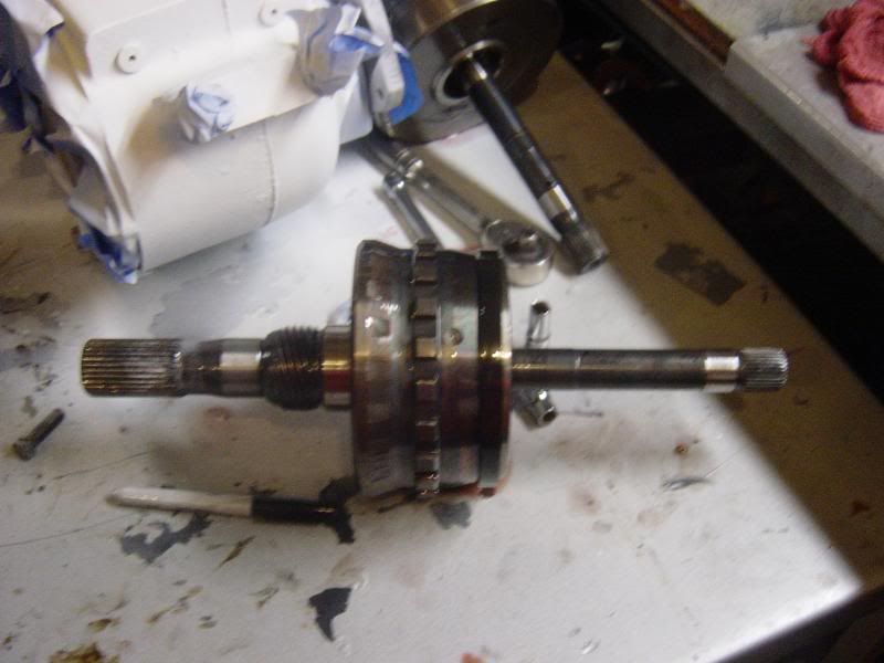

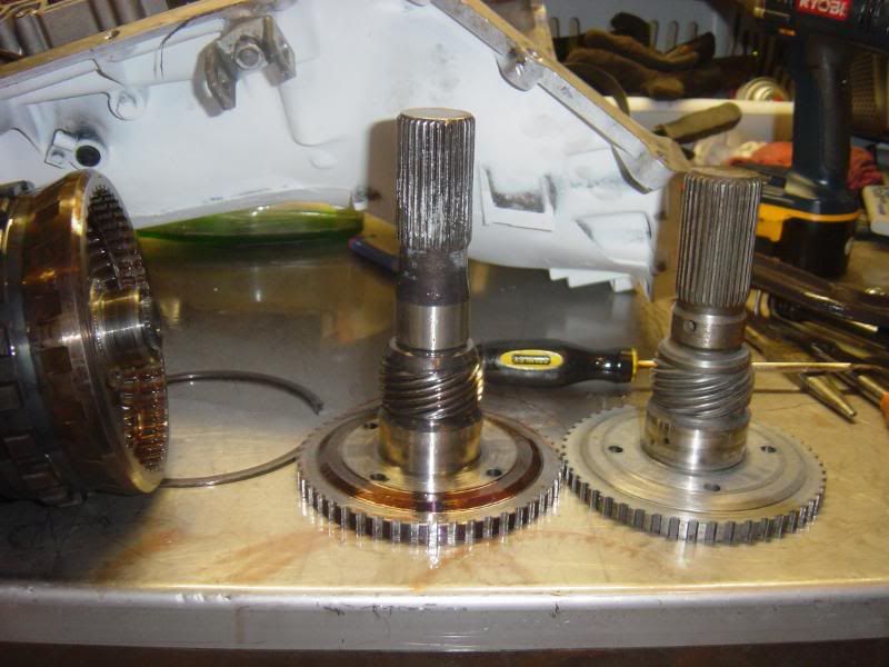

then I took the planetary out and removed the snap ring and switched the shafts:
planetay with the long shaft

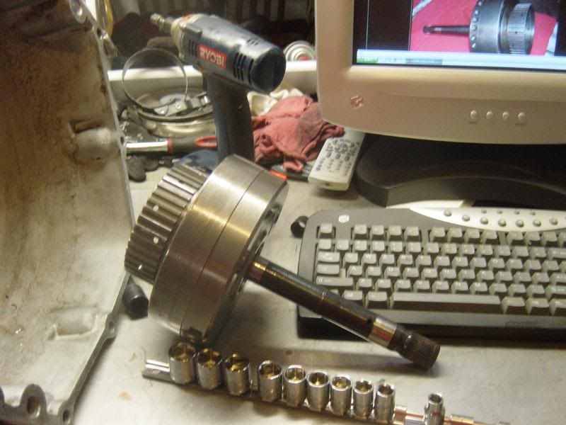

the guy on pirate clamped down to remove the snap ring so I did the same thing:

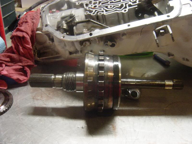

the two shafts compared:
new shaft installed:
