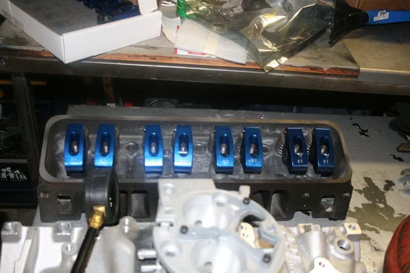

yeah, that was the downside to the vortec heads but for the price I paid for them I'm happy. I'm really after bang for the buck power on this build. I'll check out the comp cam page. I'm getting more and more motivated to get this motor done.
Cool, I think you'll be happy with those rockers. I'm not too fond of the blue, but atleast they wont be in plain sight.

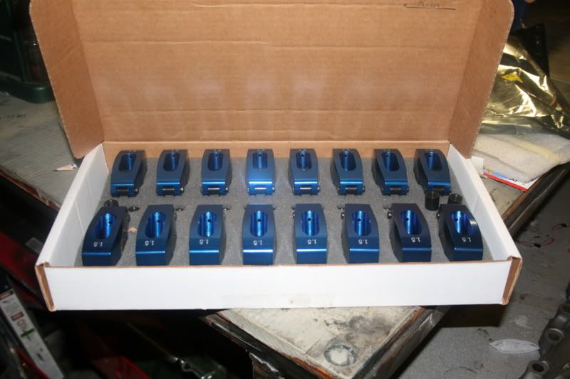

some new parts showed up...
Thanks for wiping the drool off of them before shooting the pic. Have you named each one yet? ;p
