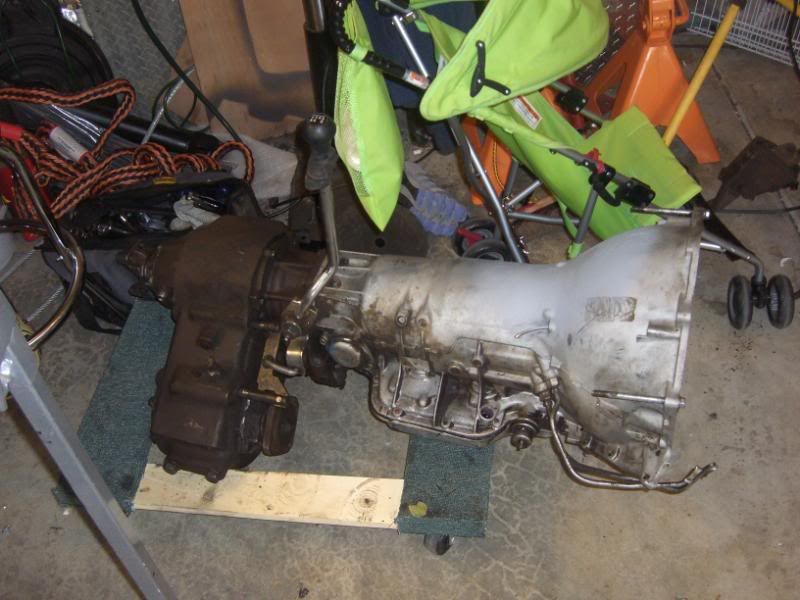

Nice pile of parts! No problem on cluttering my thread, its was already pretty bad
