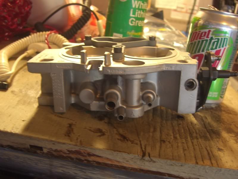

so I was looking at my new throttle body and my old throttle body and realized that the ports are different.
New:

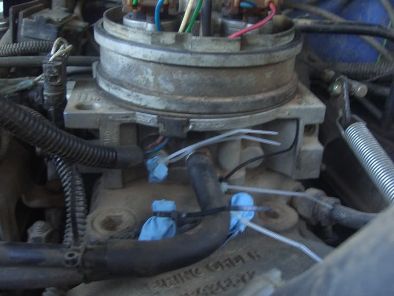

Old (and no one make fun of my redneck vacuum port plugs) :)
So what is the port on the new one (furthest right)? I lost the egr vaccum port and gained what?
Thats pretty wierd, on my old and new TBI's I have all 4 ports. the one on the left is used for EGR and the one on the right is used for the aftermarket 700r4 vacuum swith I have. Not sure what it would be used for stock.
They are both straight vacuum so I would not worry about it if you have no use for it.
I just went and looked at my collection of 4 tbi's and all of them have all 4 ports except one has the one on the right not tapped. There must be some special app that didn't need 4 ports.

If that hole comes out above the throttle blades it should get ported vacuum, which is good for dizzy advance among other things (none of which i can think of).
I would think the large port on your new TB would still work fine for your EGR.
Also, although i like the shop towel vacuum plugs, i dont think that they would actually prevent air from passing through. You might want to actually plug them so you dont tune your motor to run with a little vacuum leak.
