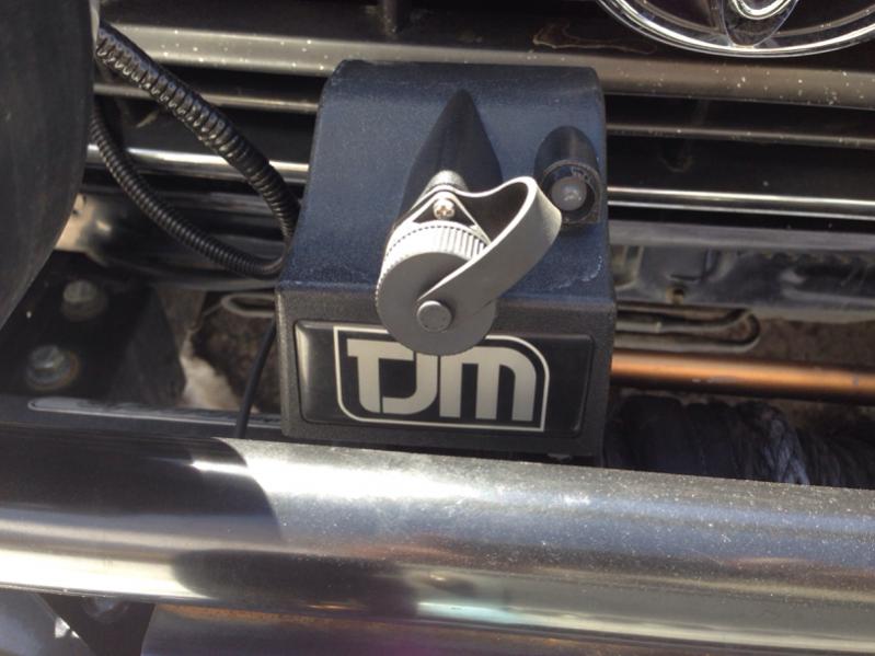

A few small details..the IBS dual battery monitor...relocated winch controller.. heated seat switches and cleaned up my messy wiring behind the bumper

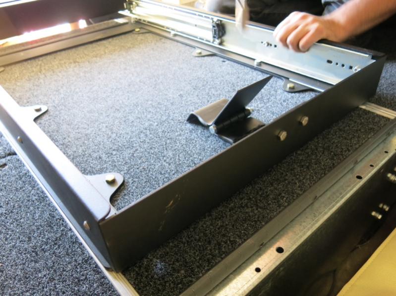

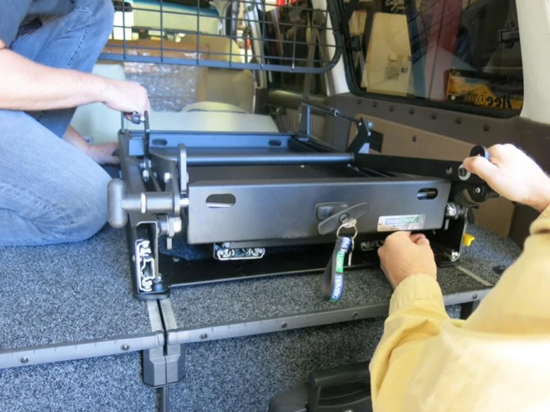

Stopped off at Slee for a new Slee built heavy drag link... and to install the Load-Spotter drop down fridge slide from Tembo Tusk....for the Engle fridge..
Now, you will have to get this $weet barrier and divider setup. It's the next logical step of the sickness.
I have the barrier but not the divider.... Did you build it or buy it?
Lou
I got both the barrier and divider from ARB.[/QUOTE
I'll check and see if I can use the divider with my barrier.. Are you in AU? That's a drop slide...right? That slide is not available here
I got that slide - platinum drop slide, from Slee. I think they sold out. I am in Oregon. The divider won't work with the Speski barrier. It would not look right anyway. I have one of those collecting dust.

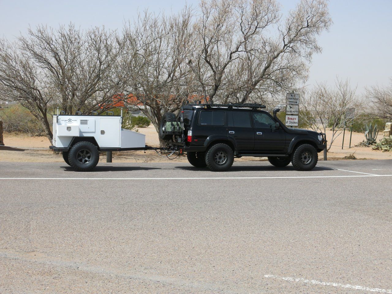

Well I spent about 14 days driving my 80 in Co, NM, AZ, TX, then home to Va.... When I arrived at Slee to pick up the truck Christo indicated that I had a aftermarket radiator and I might want to install a OEM once I got home....on the way to Phoenix I did notice the truck was running a little warm and at one point climbing a 6 miles pass temps ran up to 226....at which time I turned the heater on to help keep it cool... I was aware the 2UZ runs hotter then my old engine but was not comfortable with the temps knowing I was about to pull a trailer home from AZ..
So leaving Phoenix with the trailer...and on the first big climb temps went right up to 220 and I pulled over and called Slee...Christo recommended I remove my XS900 lights and license plate which pretty much blocked the grille area and I headed out. The truck now ran about 208-213 which was much cooler but i was looking for cooler temps. I called Sewell Lexus and ordered the OEM radiator knowing I'd go right through Dallas and the fact that Christo recommended a tech he knew. The other reason for using Sewell is I work for a Lexus Dealership and Sewell discounted the radiator plus I got a Lexus loaner for the day...which was pretty sweet.
Leaving Dallas and back up to HWY speeds the temps were right at 197 running 79-85 mph and I was a happy camper the rest of the way home
