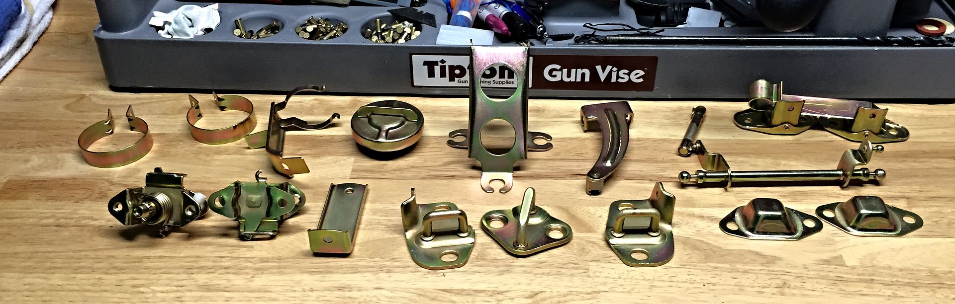

Got a few parts back from the plating shop:
Shane
Parts look great.
You'll never remember where everything goes :lol:.
Man - already hit the panic button, lol. Pretty sure I'm in wayyyyyyyyy over my head :bang:

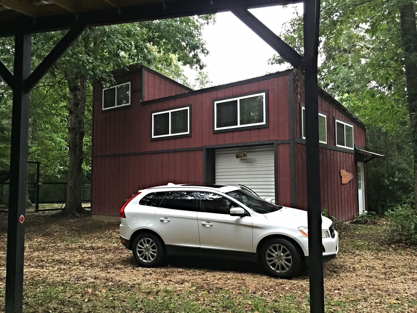

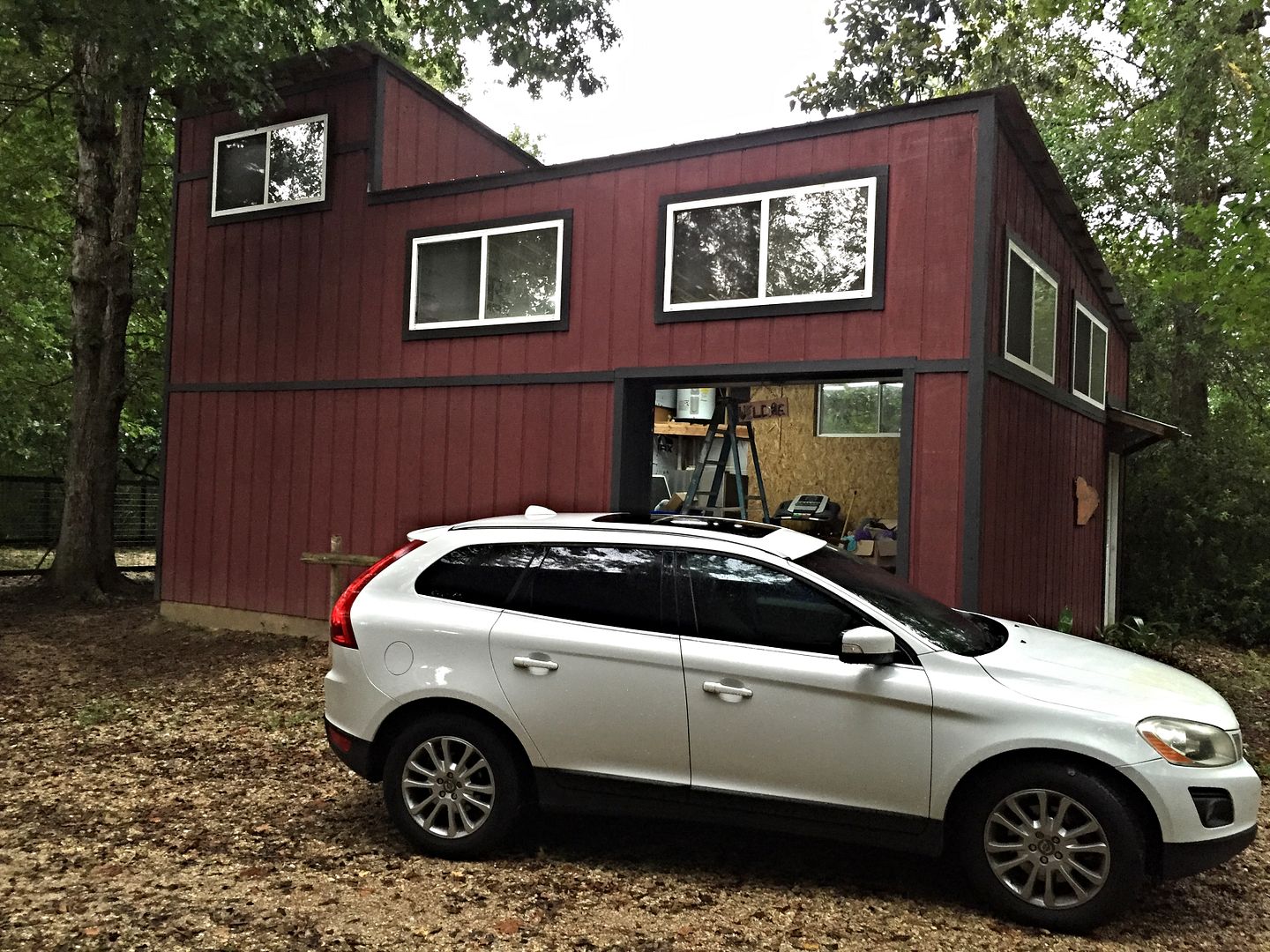

Seller's accepted our bid, woo hoo! Inspection & appraisal scheduled. If all goes well, closing date end of September. 4.78 acres on the river and outside city limits = weapons training every weekend. Here's a few shots of the highly anticipated, so stoked about, and will probably be the death of me. . . .drum roll. . .Shane's GARAGE!

Congrats on the house and property Shane :beer: You just bought yourself a second job (property maintenance) but it's the best job you'll ever do. Just stay away from buying a bunch of horses and you will be good!!
@NCFJ: Much appreciated but it's too late - 430 horses are in the plans but will be stabled under the 60's hood, hehe. The property is 100% yet. Waiting on inspection/appraisal and then final finance approval. And actually looking fwd to the property managing vs. city living. I'll give you a buzz in the next few days. . .hope all is well.
