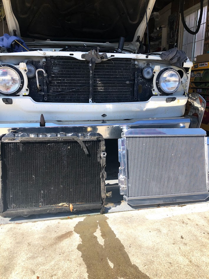

I'm headed into a local radiator shop this week to likely get mine replaced. It's leaking around the fill nozzle point and every time I patch it, it pops up in another spot.
I have the FJ62 with the trans cooler lines needed, but I'll let you know what the shop and I decide on for replacement since it's a similar part for the FJ60. Going into it, I'm leaning CSF, but we'll see if they have other recommendations.

Just checked with the shop, we're going to pull the radiator out to see if it can be salvaged, but we're leaning CSF to replace. I think the parts confusion may be that the FJ60 radiator sans trans cooler lines is no longer made, but the FJ62 one is and you just put the 62 radiator on the 60 and plug the cooler line ports.

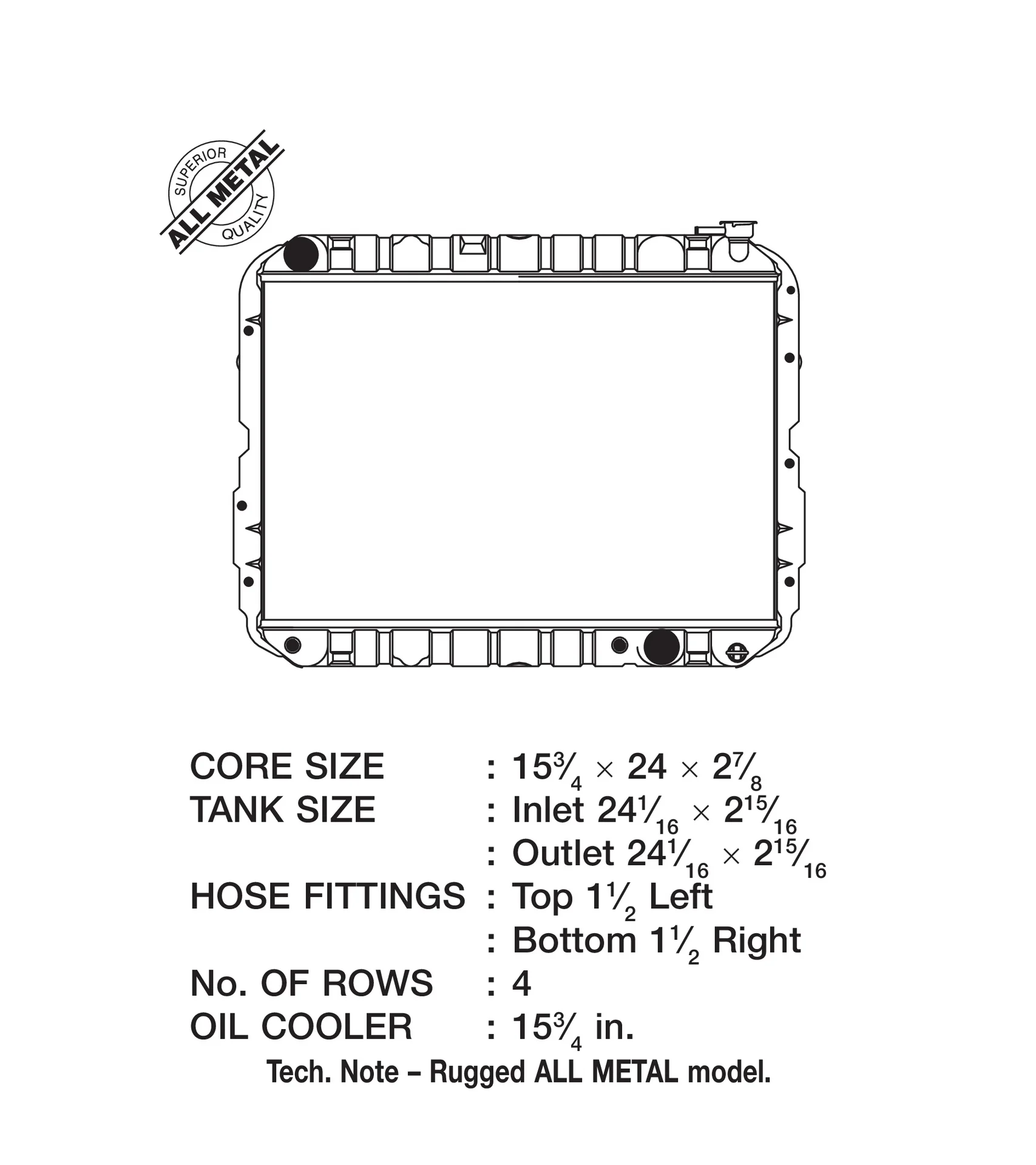

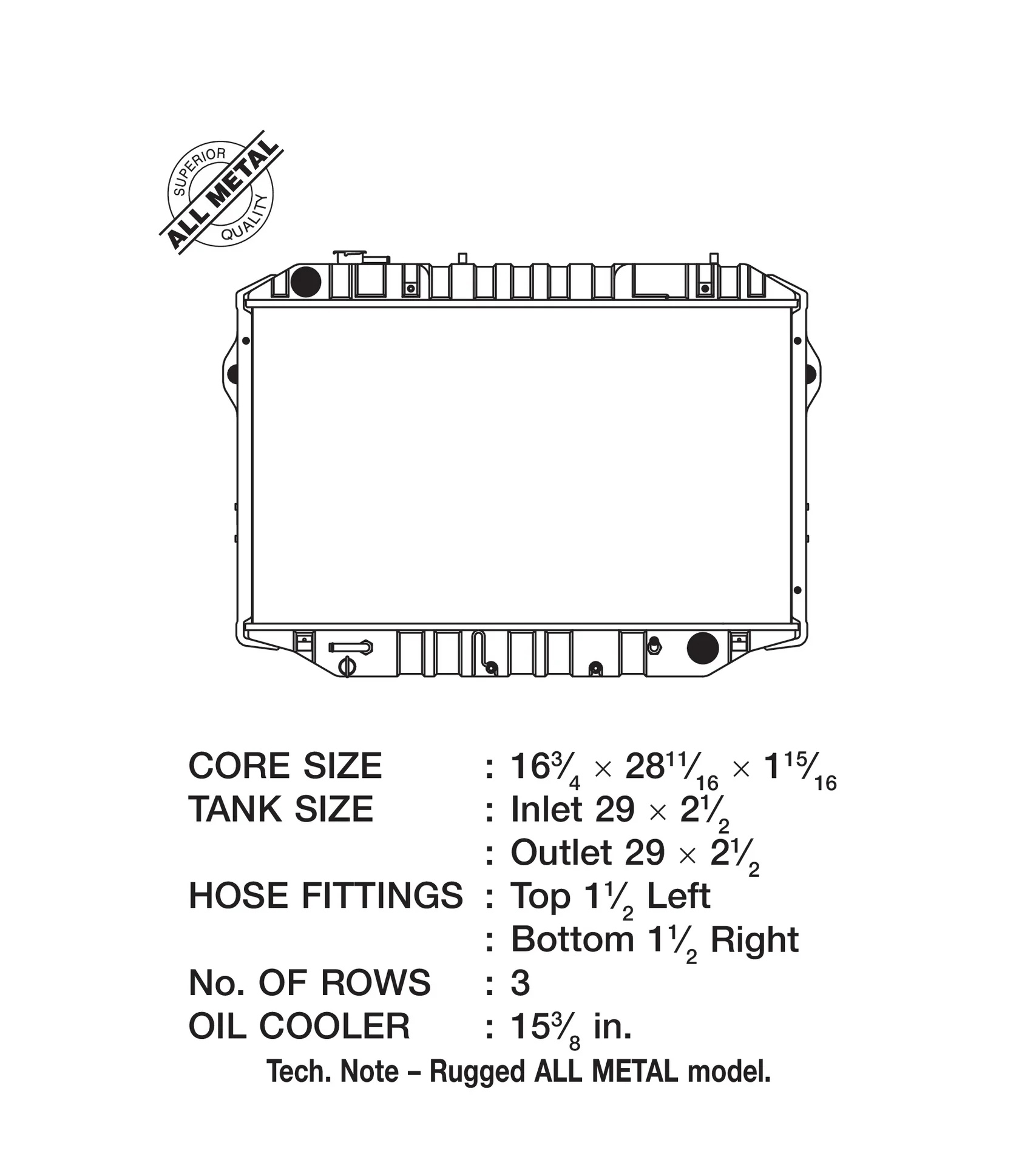

Correct. CSF hasn't sold the FJ60-specific Radiator for quite a while, now. They list the 2708 Radiator for both FJ60 and FJ62.
The 2709 WILL NOT BOLT UP to your FJ60 - It's for a later FJ62. I don't know the difference.
Other than the various Aluminum Radiators, I don't think there are any other Brass Radiators available, now.
Now I'm curious about the 2708 vs 2709 variations. Is it the mount points if both have the trans cooler ports?
I don't know the difference. If you look on the CSF Website, linked above, it has schematics and details of the different units.
