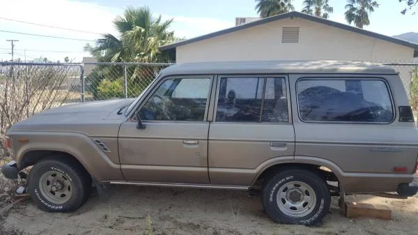

I'm looking at purchasing a mid-80's Land Cruiser that has spent the last two decades sitting in the desert. I know the trans will need work (reason it hasn't been driven) and engine will not be turning over after sitting this long. There are no known modifications to the vehicle such as lift, etc. I'm not very concerned about rust considering desert storage, anything else I should look out for that would be a make or break deal?

From the one pic I see, it looks pretty straight and dry to me. You can drop a 5-speed transmission in it (huge upgrade) for around $3k if you're doing the work yourself. You can get a used, but operating 4-speed replacement for a few hundred bucks.

If you can get some pics of the under carriage and engine bay, we could tell you more, but rust free cruisers (even high mileage) runners, sell for $7500-$10k all day.

20 years is a long time. You could have rusted out freeze plugs, a bad radiator, a frozen-and-split block, the fuel tank could be a rusty mess. Many/all engine gaskets will leak. It doesn't appear to have (ahem) been professionally prepared for long term storage.
This is a major project, if your goal is a 100% totally reliable FJ60. I think $1K-2K is about right. Are you massively handy with a wrench? - If not, I would skip.
