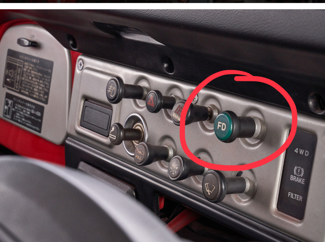

Yes, there is a FD engagement on nearly all 4x Series, early, mid, late, etc. Some examples:
Early vacuum operated on the dash:

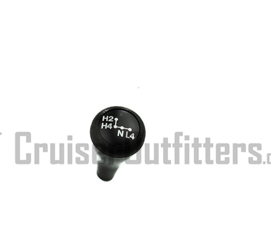

The typical ‘L’ pattern H2-H4-N-L4 mechanical case:

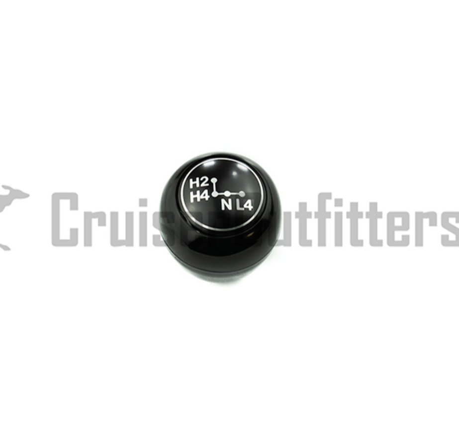

or the later version found in the 4x with fully mechanical Tcase shifting

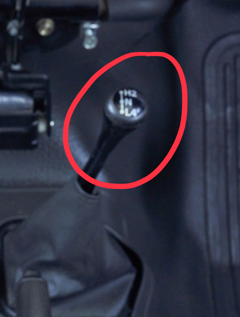

And floor shift for H2 to L4
