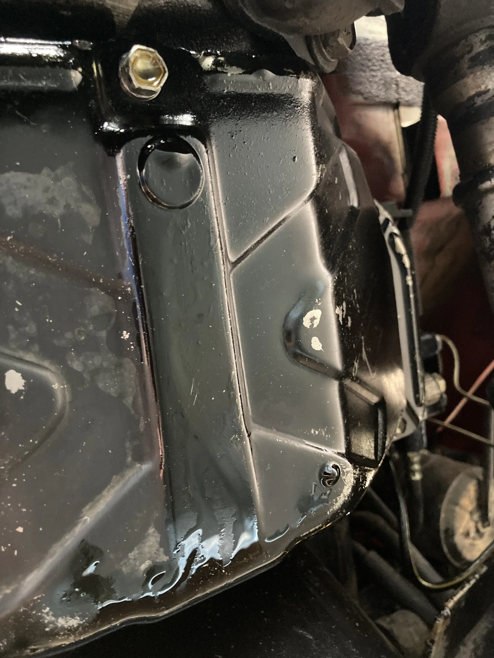

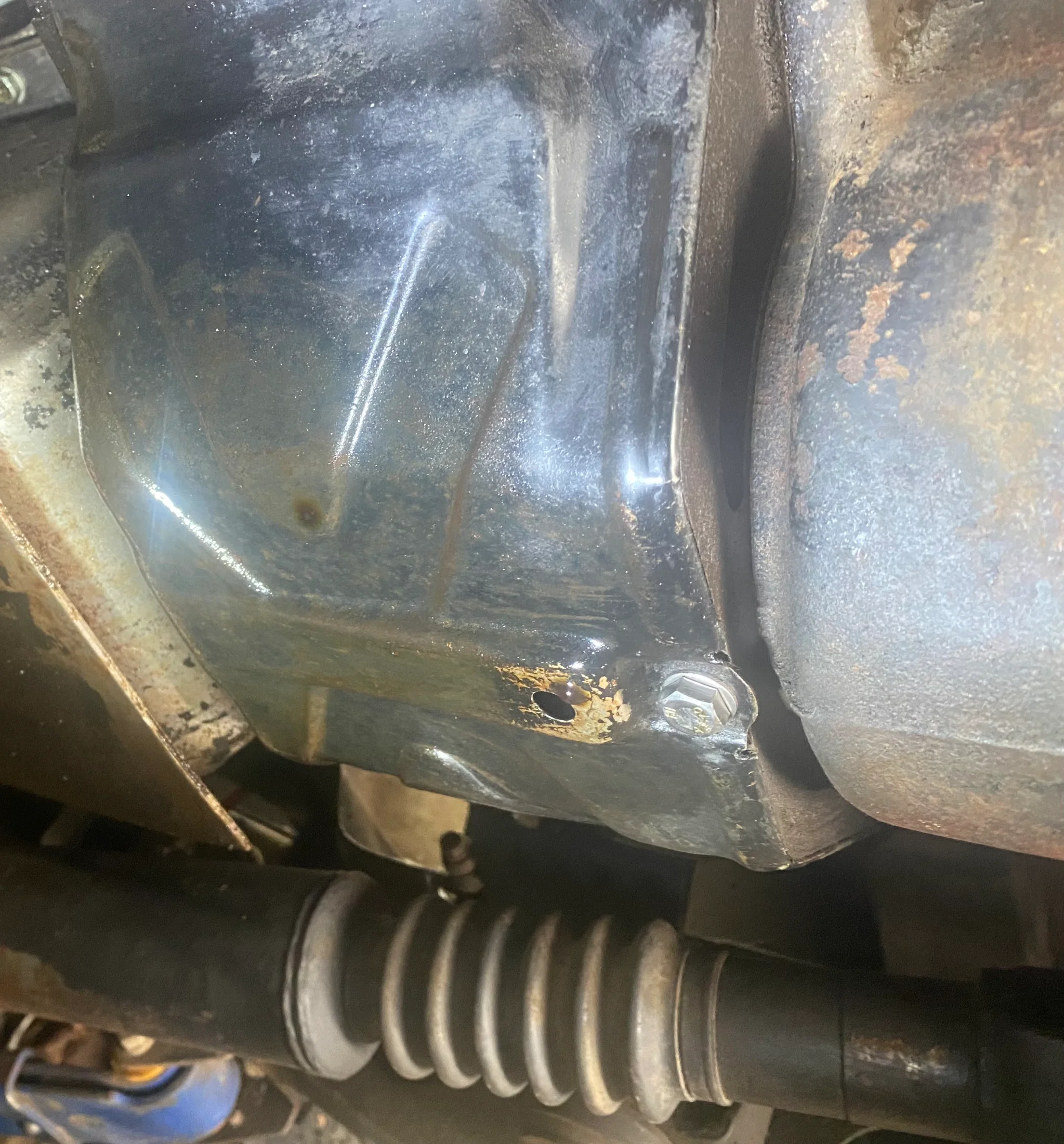

Is this where you would see those drips?? I’m getting a few.

+1 on the " are you sure it's the rear main seal?"
There is an oil galley pressed in welch plug on the back of the 2f block that is known to fail and send oil down to come out looking like a rear main seal leak.
Easy to overlook it if you don't know to look for it
What is the best way to see that plug?
+2.
A valve cover gasket leak at the back where you can't see it can drop oil back there too.
Only way is to separate the bellhousing from the engine....
This is just the first result on dozens of threads about this issue. I just link it so you can see the plug I'm talking about. There are other threads that go in depth about how to seal it with the correct plug and or JB weld on top....

if the OP removes the bellhousing cover and looks inside that will help determine where the leak could be coming from
